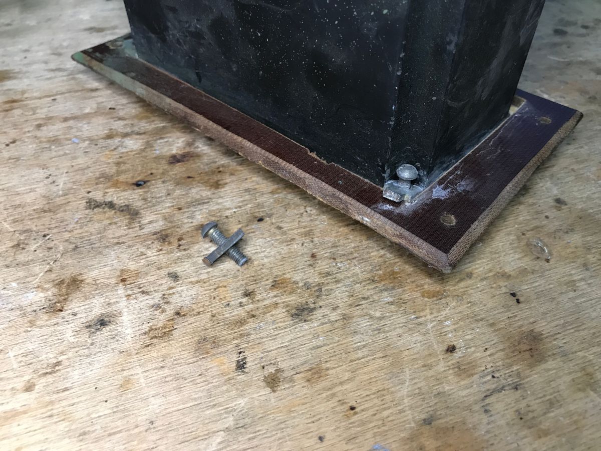

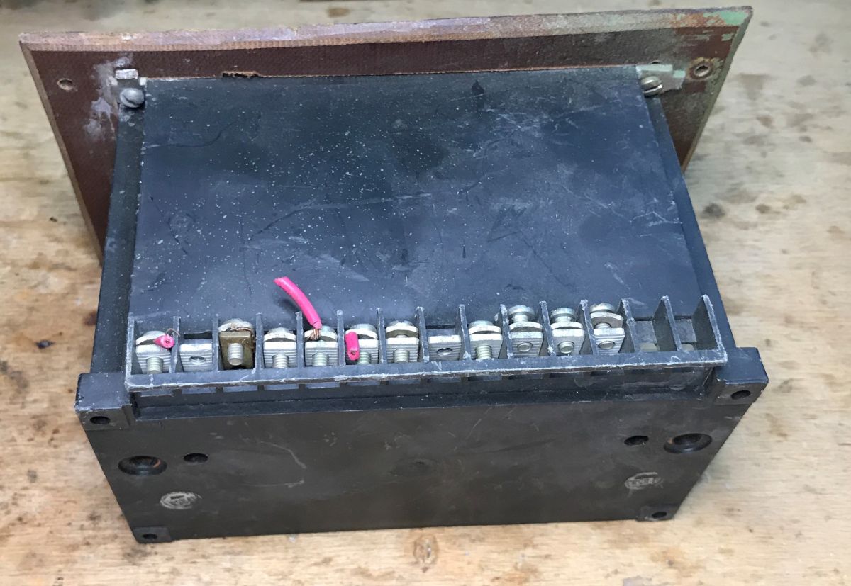

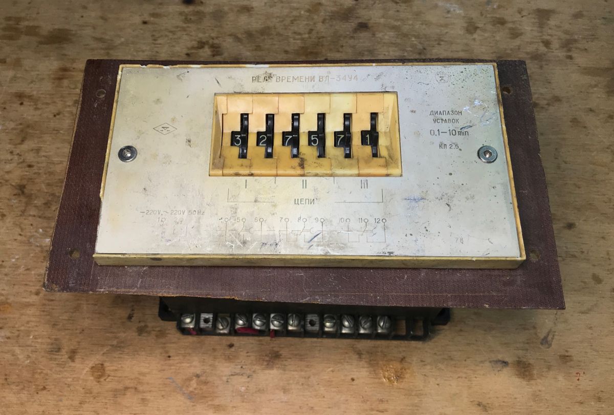

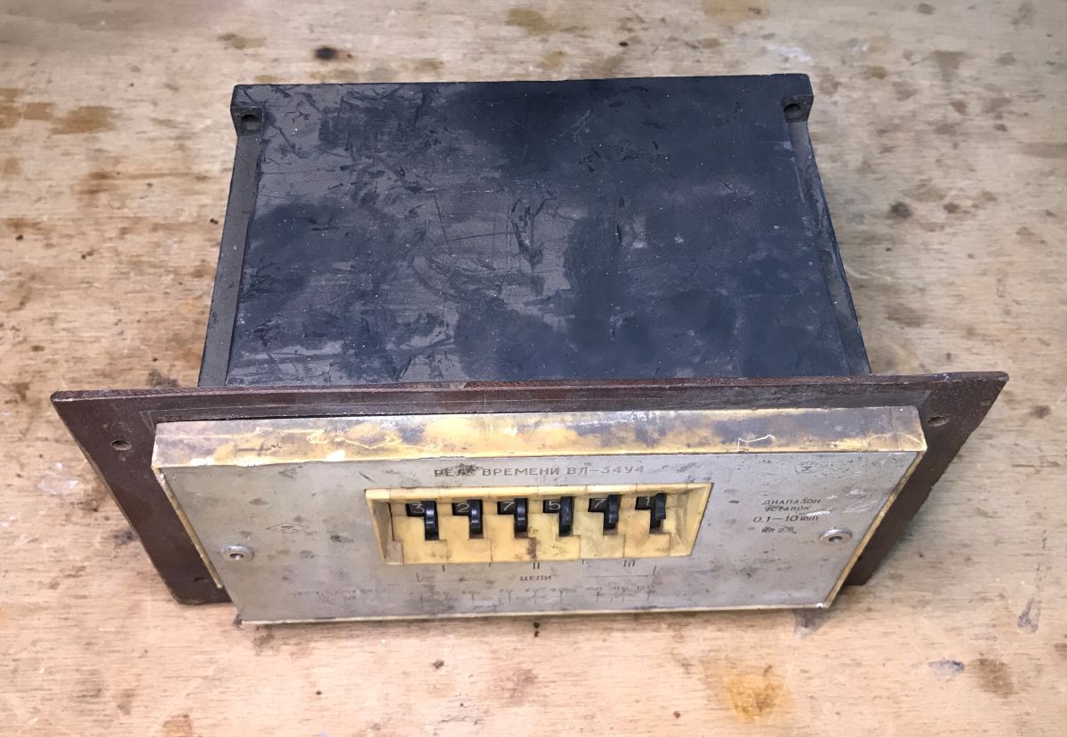

    Here’s a little curiosity for today. This piece of kit is completely outside my field of expertise and not from my era, but it might still be worth a look – an old triple timer dating back to the days of the USSR. The whole thing is built using semiconductors. Time to take a look inside.
    Retro triple time relay - VL-34UKHL4 - gallery from inside

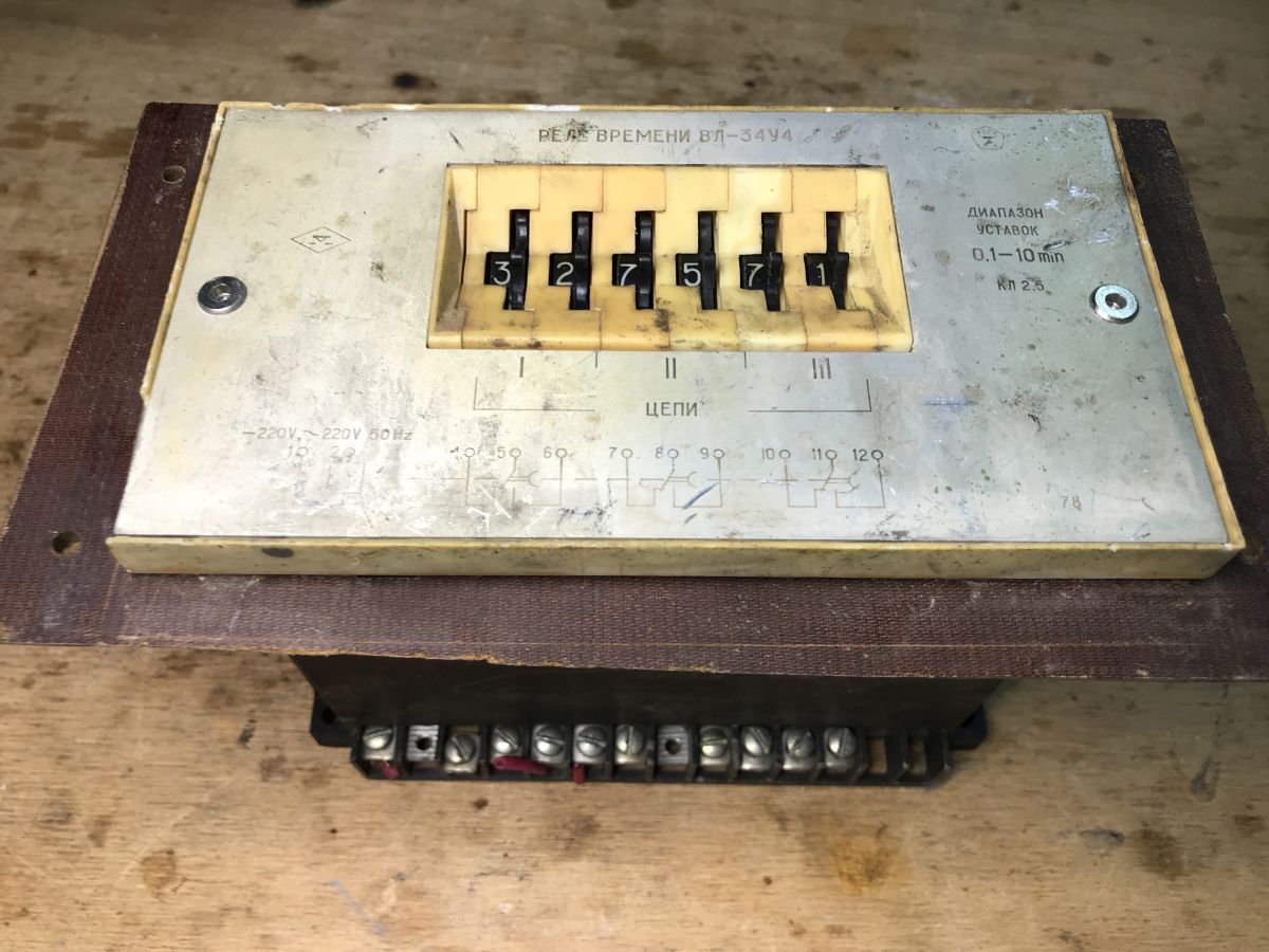

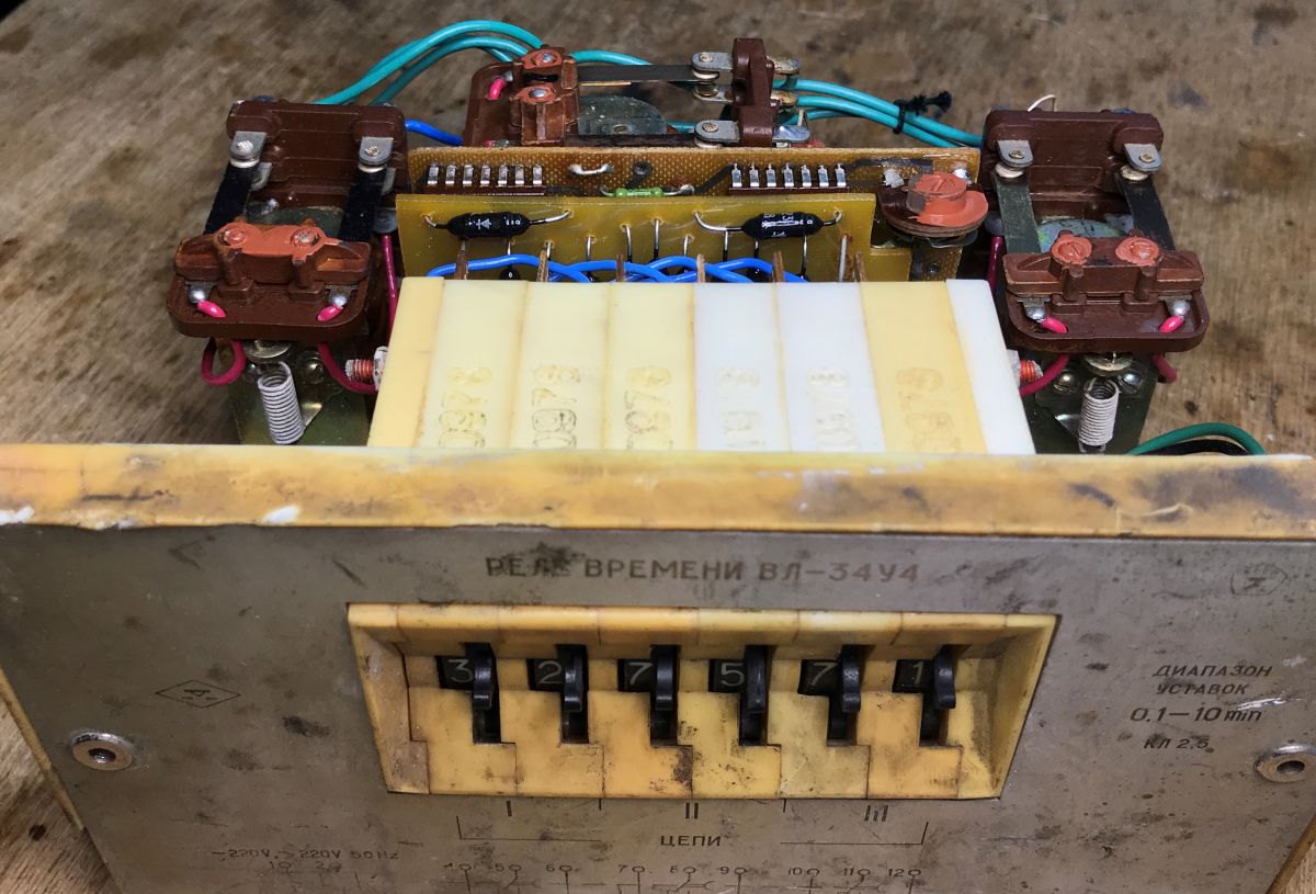

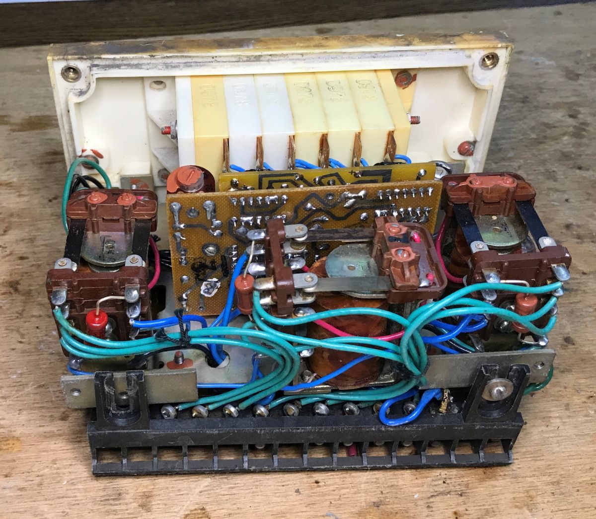

    On the front panel, we can set three separate relay switching times. Just below, there is a diagram showing the internal connections and indicating which terminal screw is the common contact, normally open and normally closed. Let’s take a look inside:
    Loose screws on a wooden workbench next to a partially disassembled electronic device

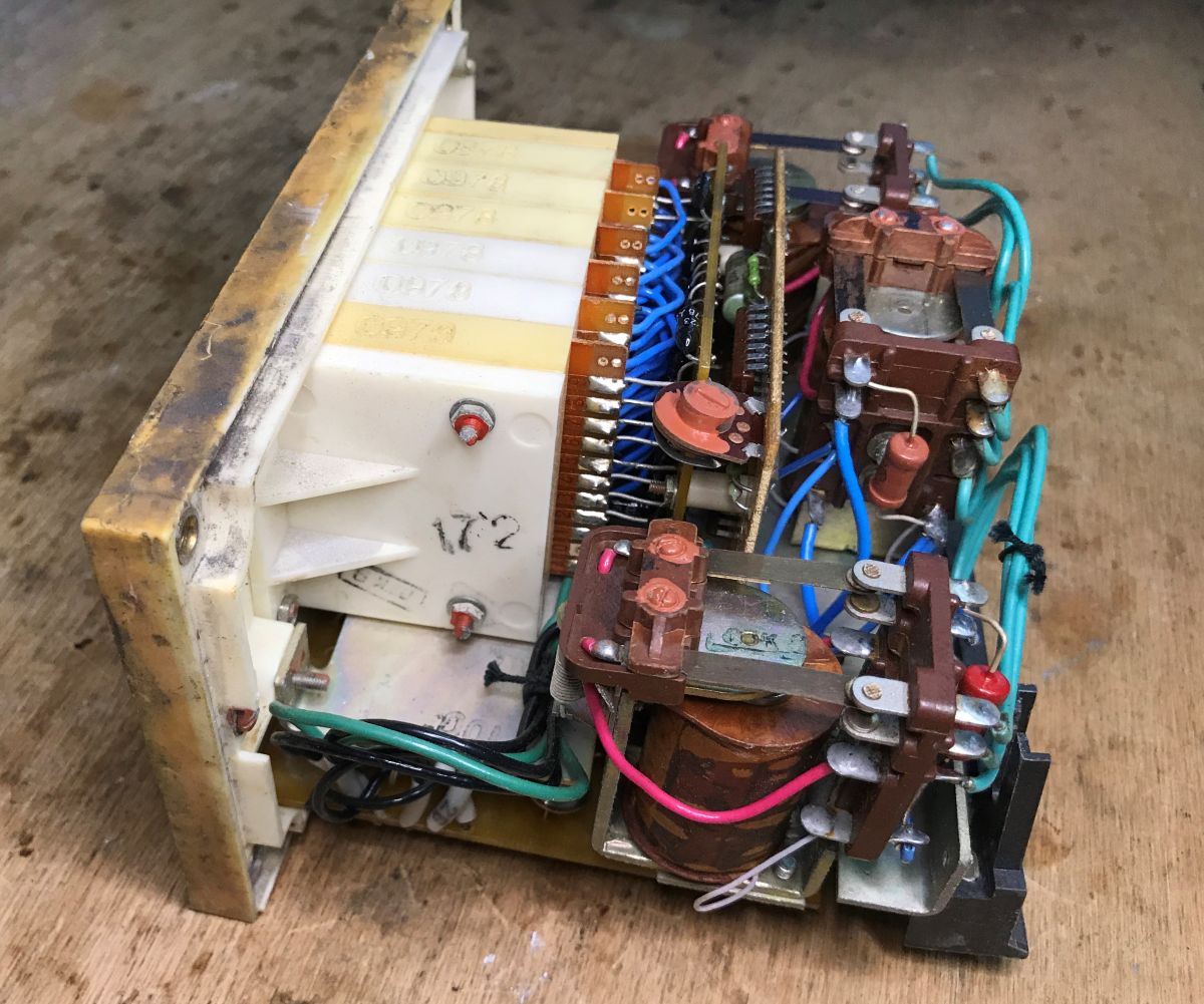

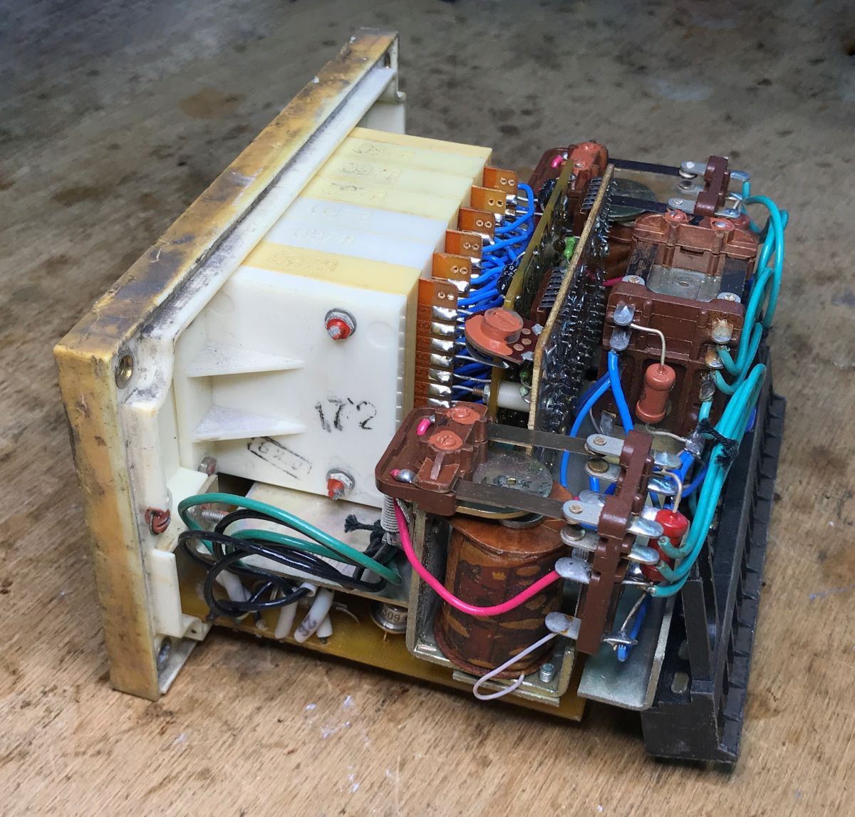

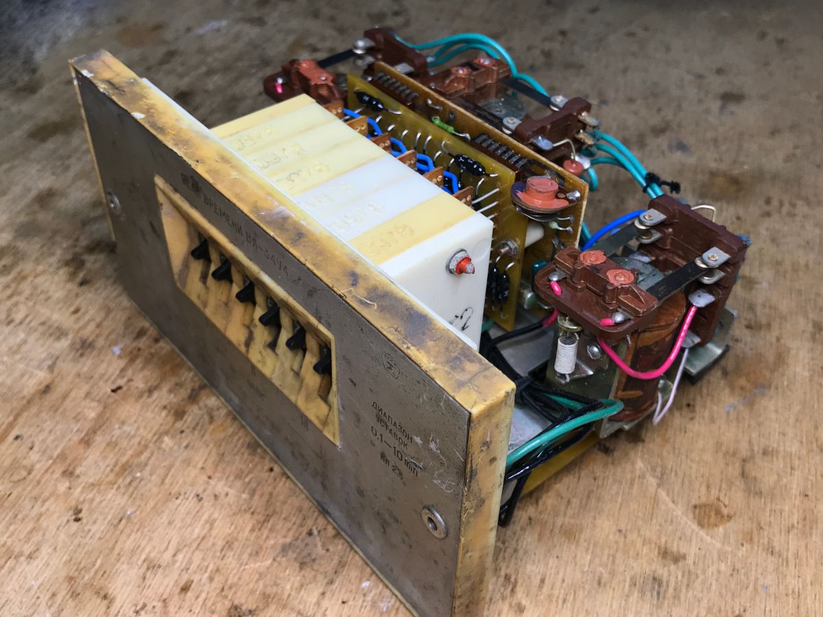

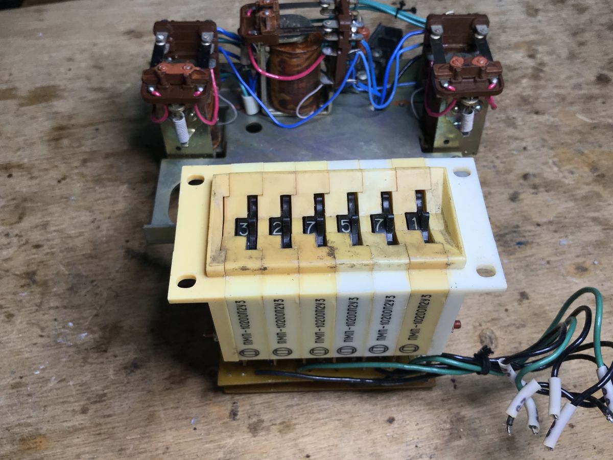

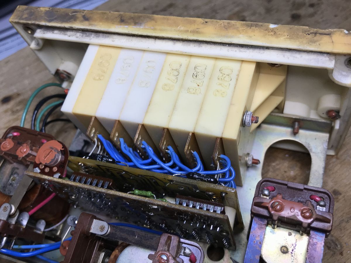

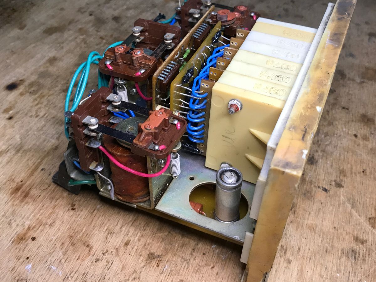

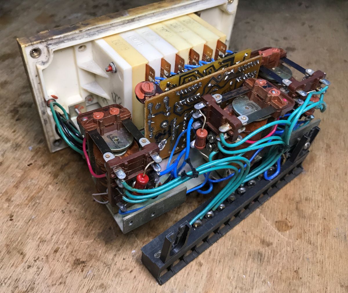

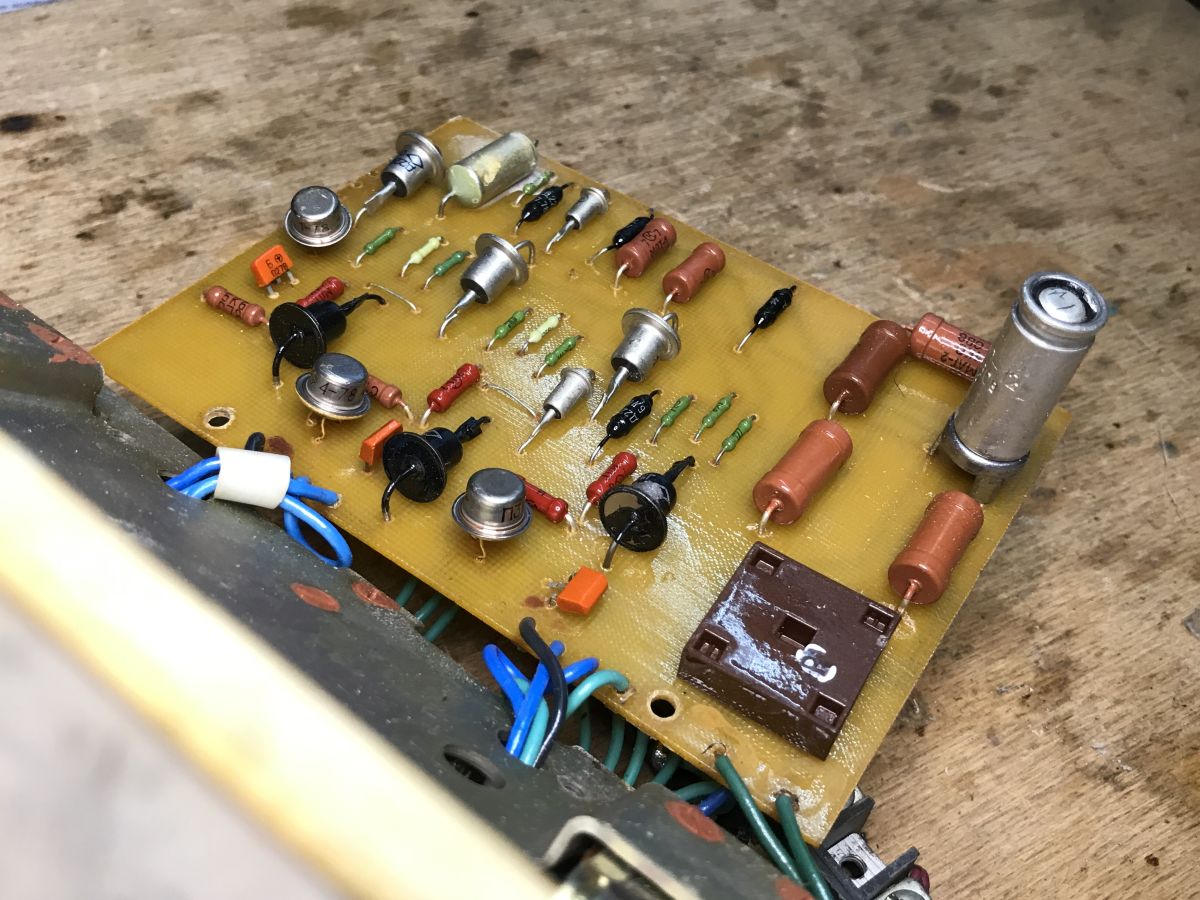

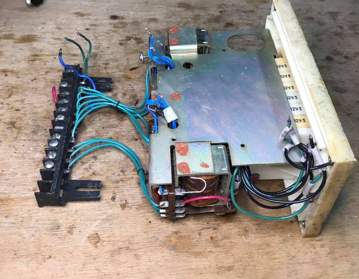

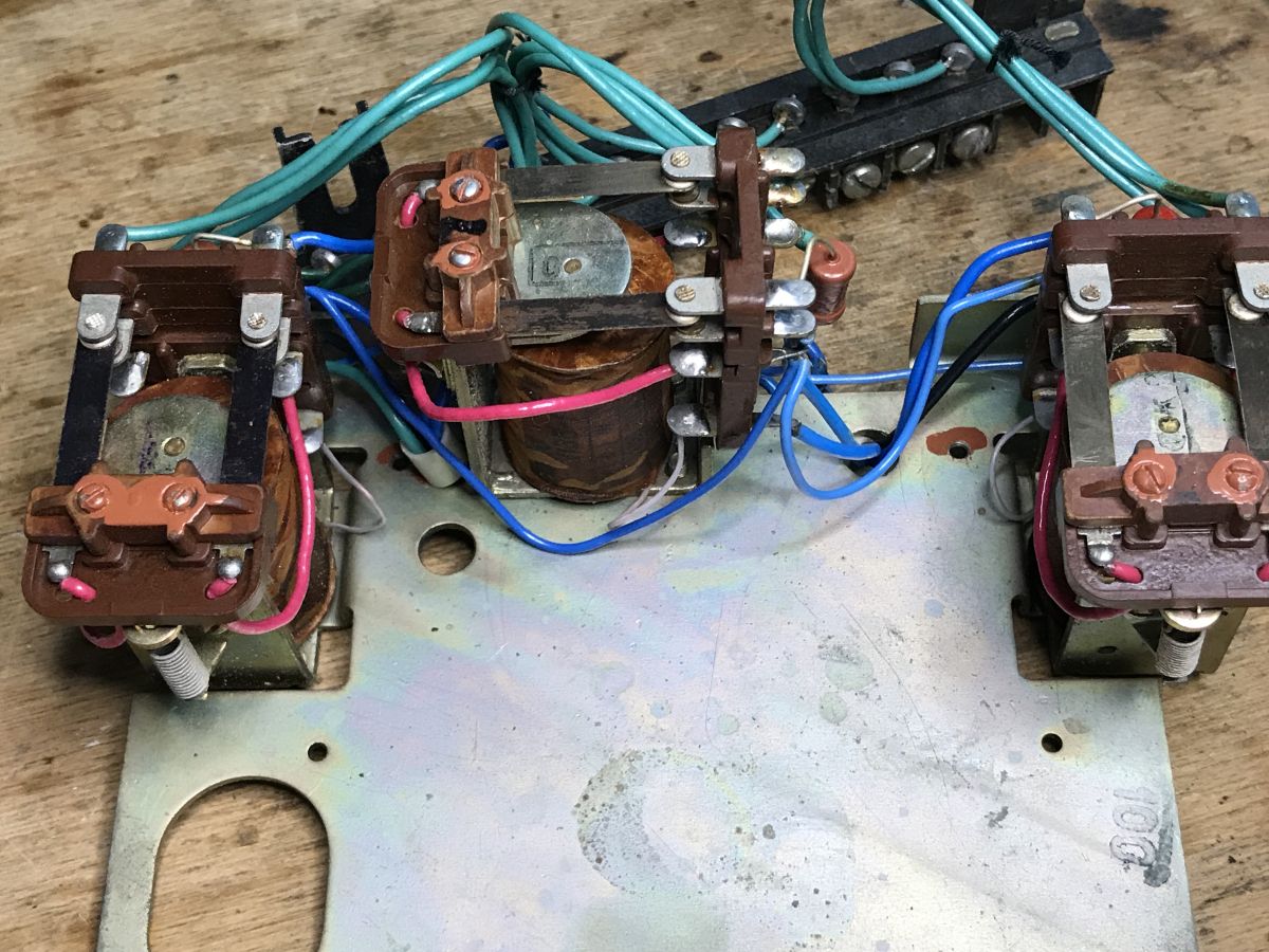

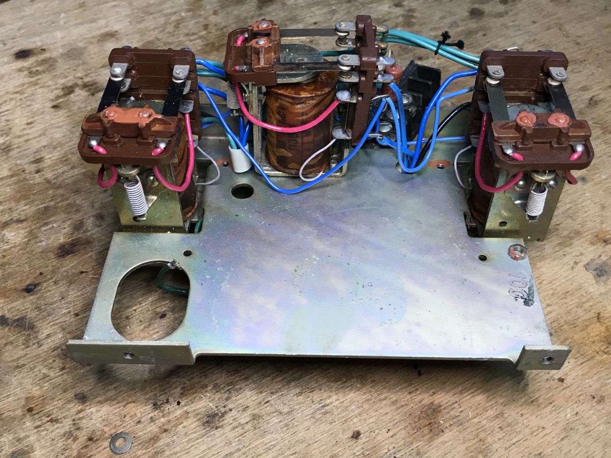

    Inside, we can see three separate relays and two control boards. On one of them is a potentiometer protected by paint, presumably for tuning.
    Inside a time-relay module: PCB, three relays, transformer, and wiring connected to a screw terminal strip
    Interior of an old relay module with a circuit board and wiring on a workbench
    Interior of an old time relay with visible relays, circuit boards, and bundled wiring
    Inside a time relay module: three relays, a PCB, and bundles of blue and turquoise wires
    What surprises me most, however, is the size of the components. The relays there bear no resemblance to today’s compact solutions. Overall, there is also much more mass, and consequently more raw material.

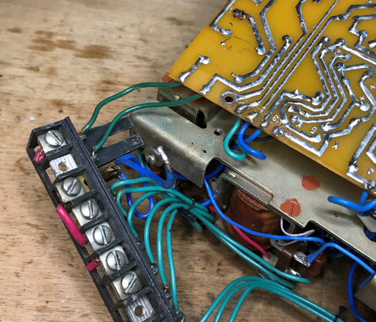

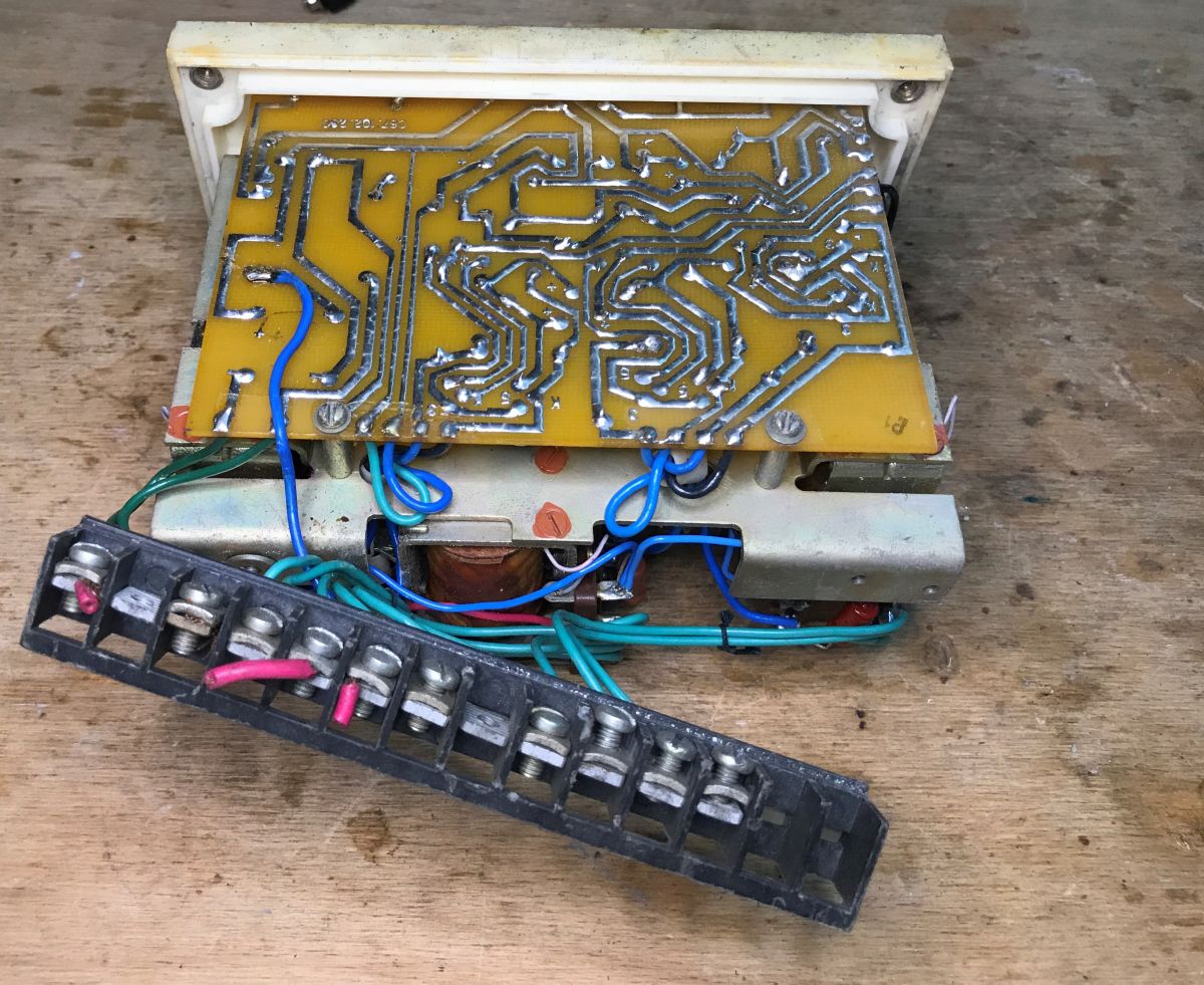

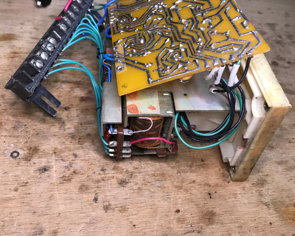

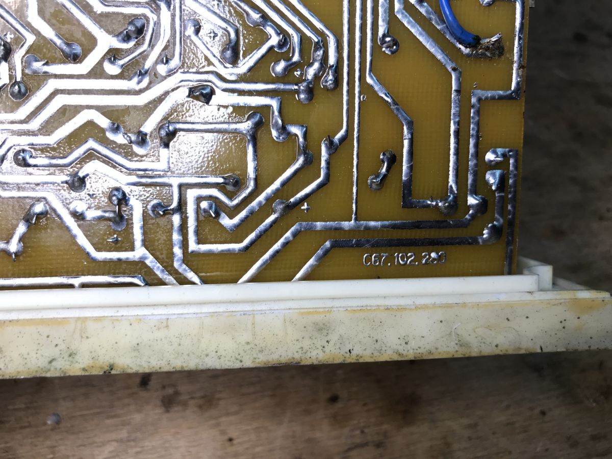

    Progress with dismantling and part number from the circuit board - C67.102.280:
    Inside an old time relay: three relays, a PCB, and a bundle of blue wires beneath a screw terminal strip
    Exposed PCB with tinned traces and wires mounted above a metal frame, with a loose screw terminal strip in front
    Close-up of PCB underside with tinned traces and the marking “C67.102.280”
    Device interior with circuit board, transformer, and wiring harness on a wooden workbench

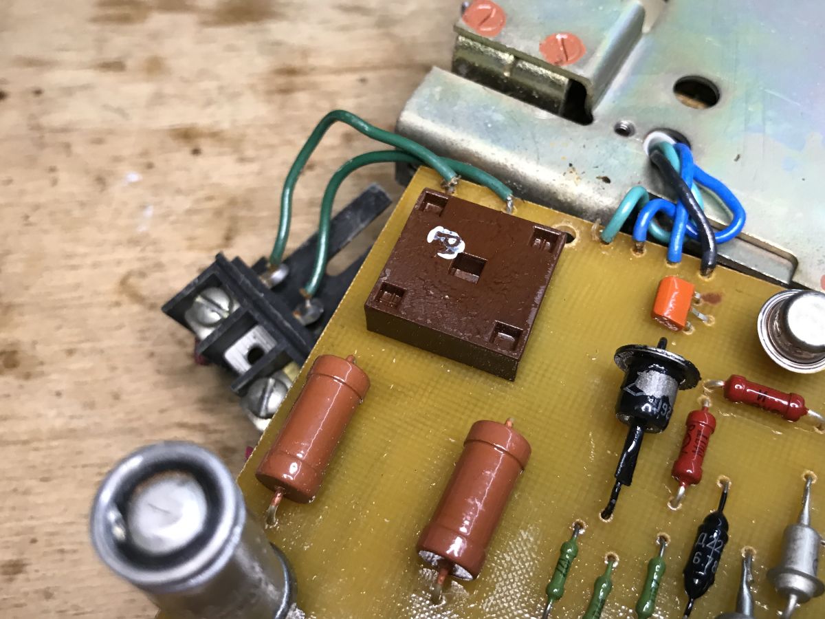

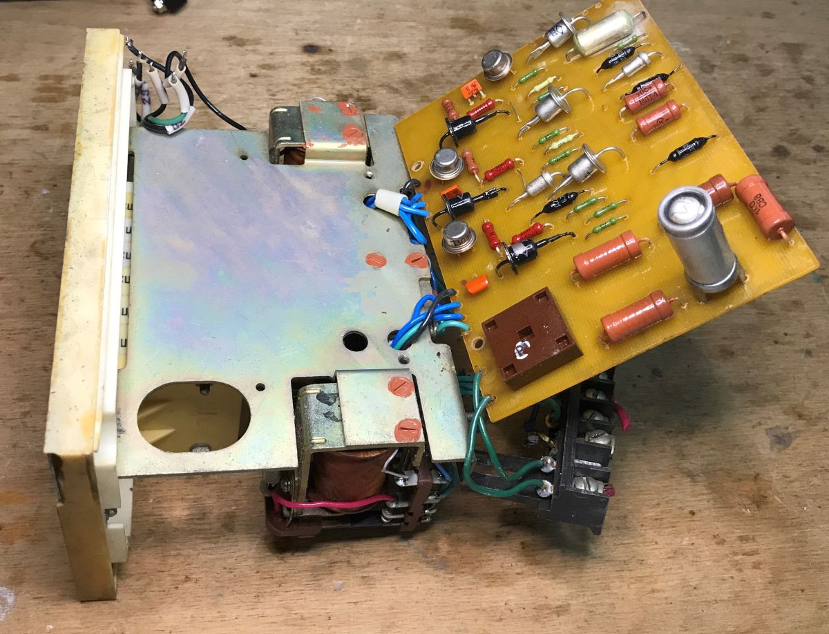

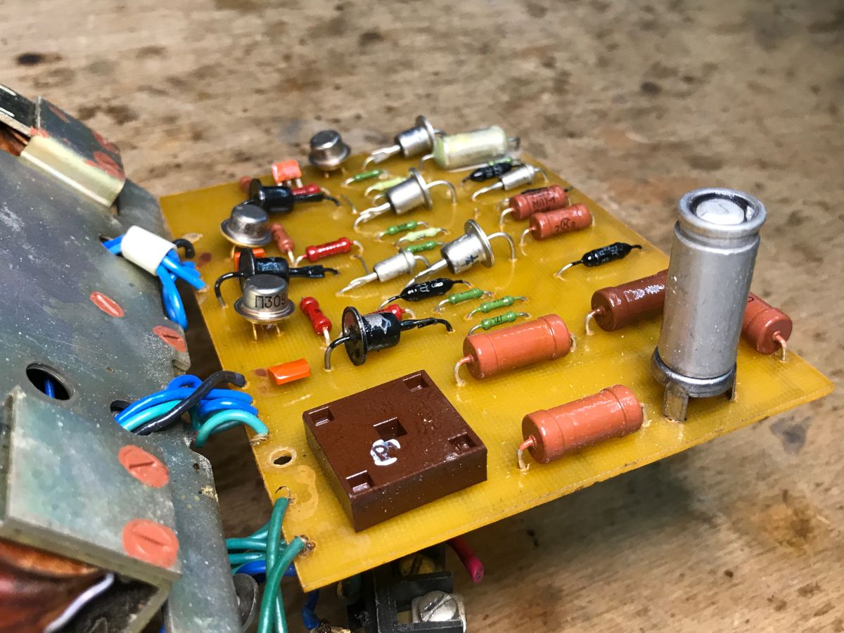

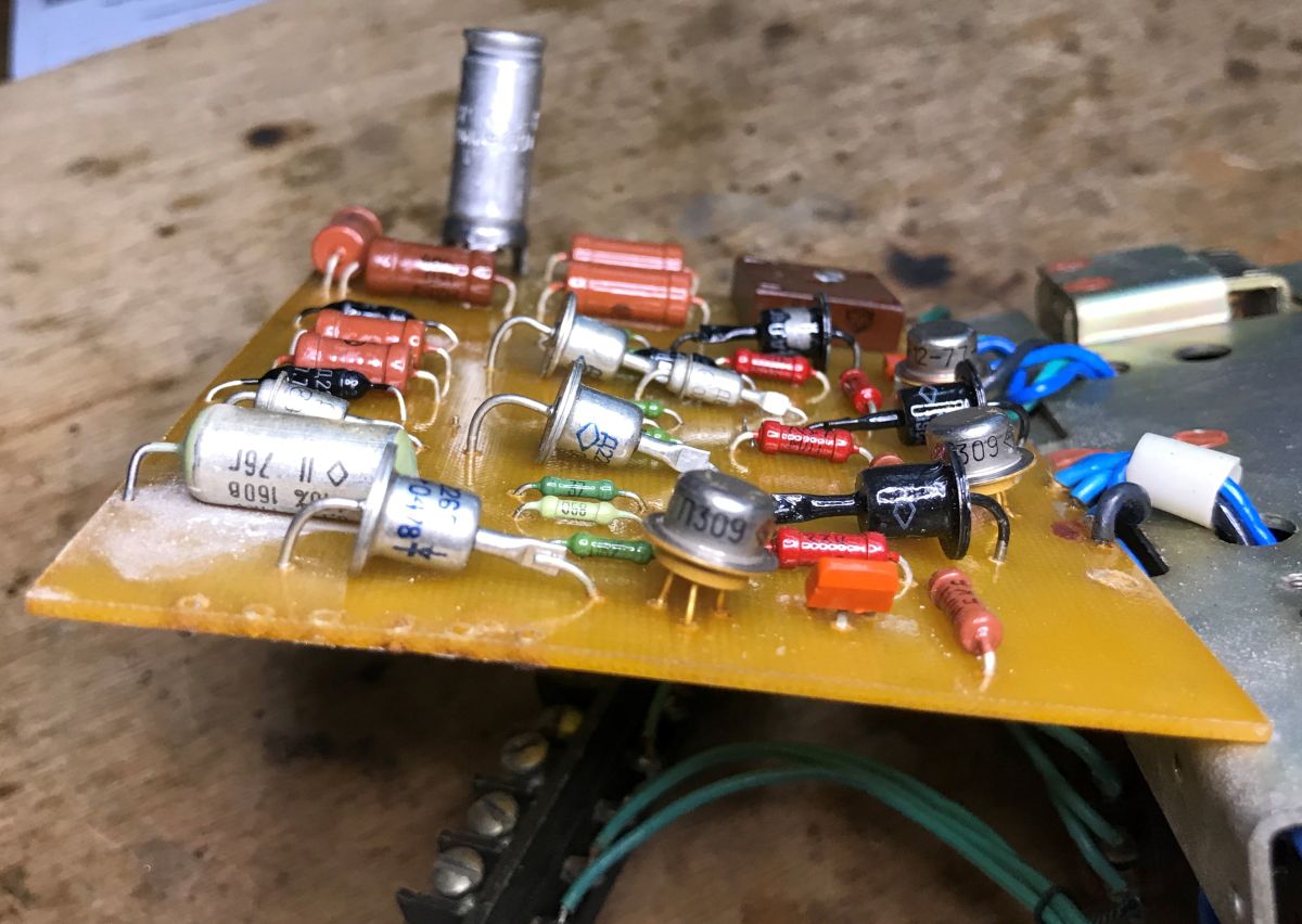

    Dismantling of the board, on which a rectifier bridge, a large electrolytic capacitor and characteristic resistors can be seen. Although the time setting itself is mechanical, the counting is already carried out by a semiconductor.
    Disassembled relay module with metal frame and PCB with a capacitor on a wooden workbench
    PCB with through-hole components and wires, photographed on a wooden workbench
    Close-up of a PCB with through-hole components and a large metal can capacitor
    Close-up of a PCB with through-hole components and wires on a workshop bench
    There is no label layer on the board, and all tracks are tin-plated for durability.

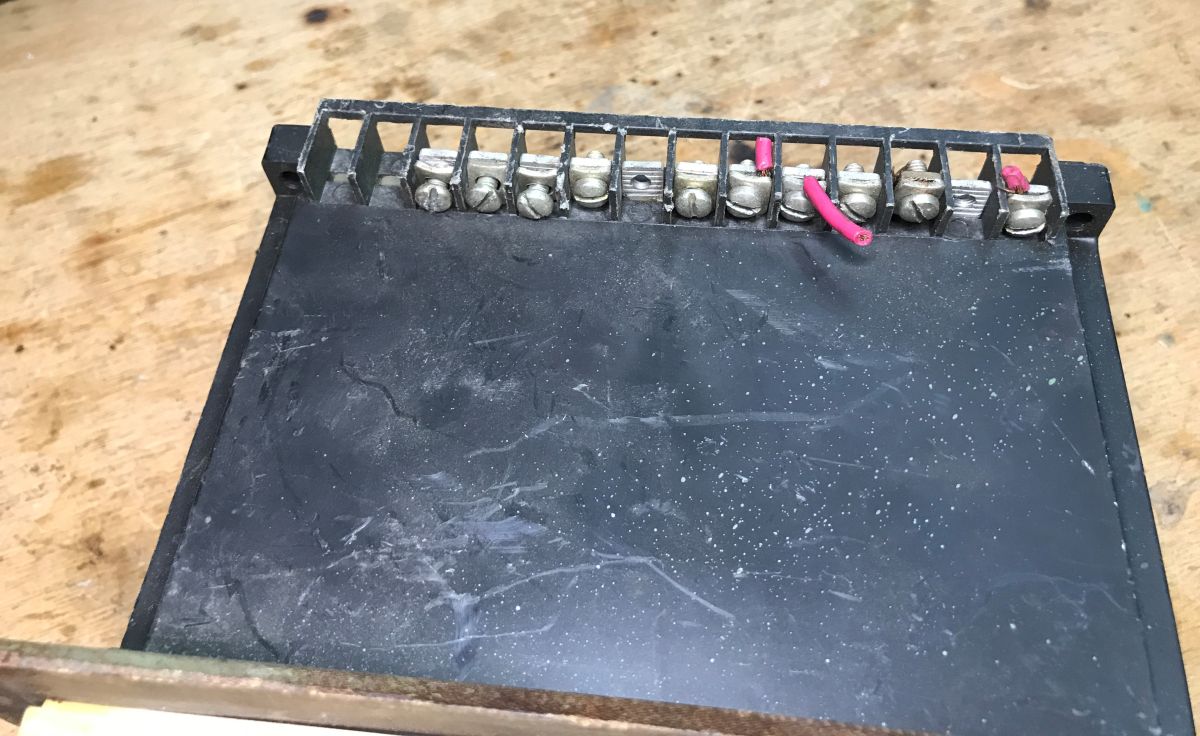

    Close-up of device internals with PCB, screw terminal block, and bundled wires on a wooden surface
    Close-up of a PCB with components, wires, and part of a metal device enclosure
    Opened relay device with metal cover, wires, and a screw terminal strip on a wooden workbench

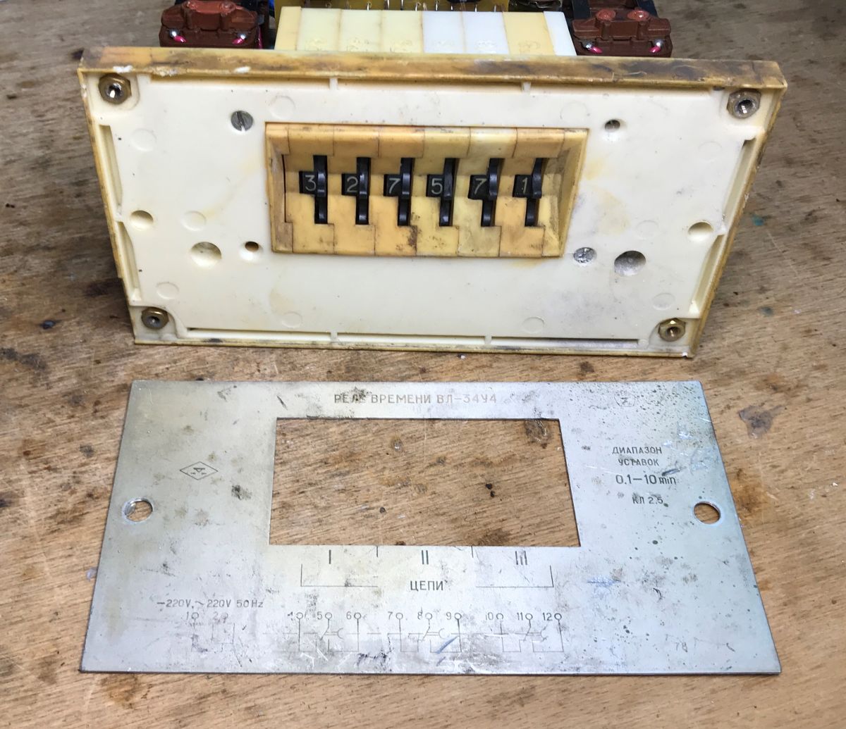

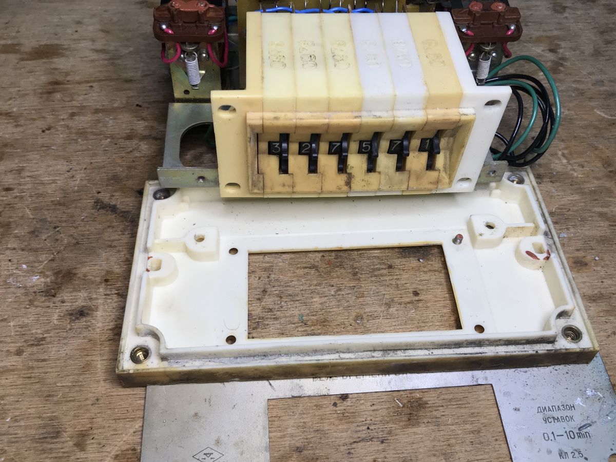

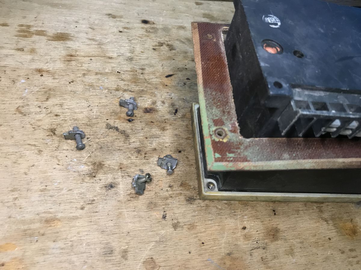

    Removing the front panel and separating the mechanical components:
    Disassembled timer relay panel with number sliders and a metal plate with Cyrillic labels on a workbench
    Disassembled module with digit switches and wires on a workbench, with housing parts nearby
    Inside of a device with three relays and a lever-based setting module on a workshop table

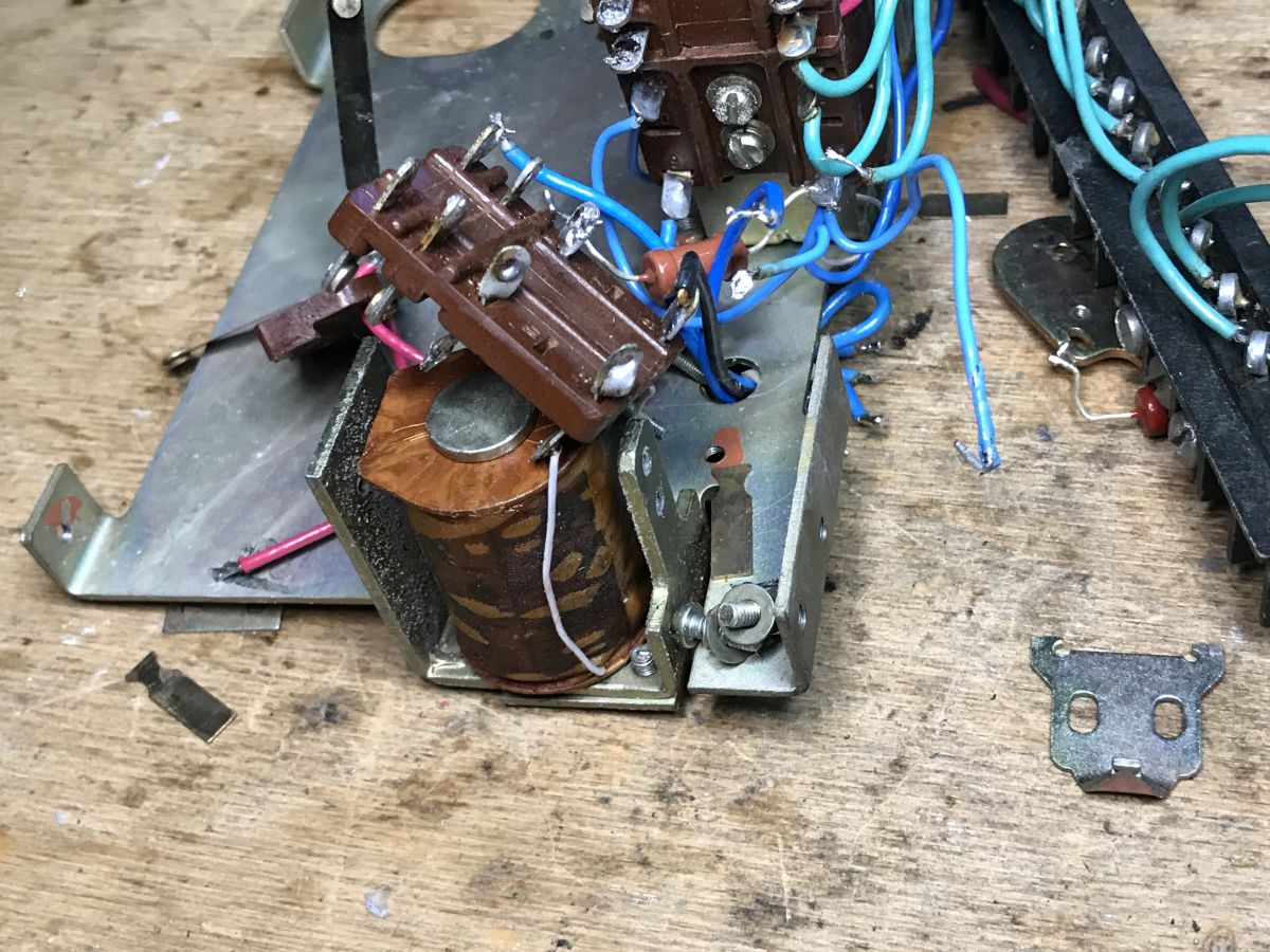

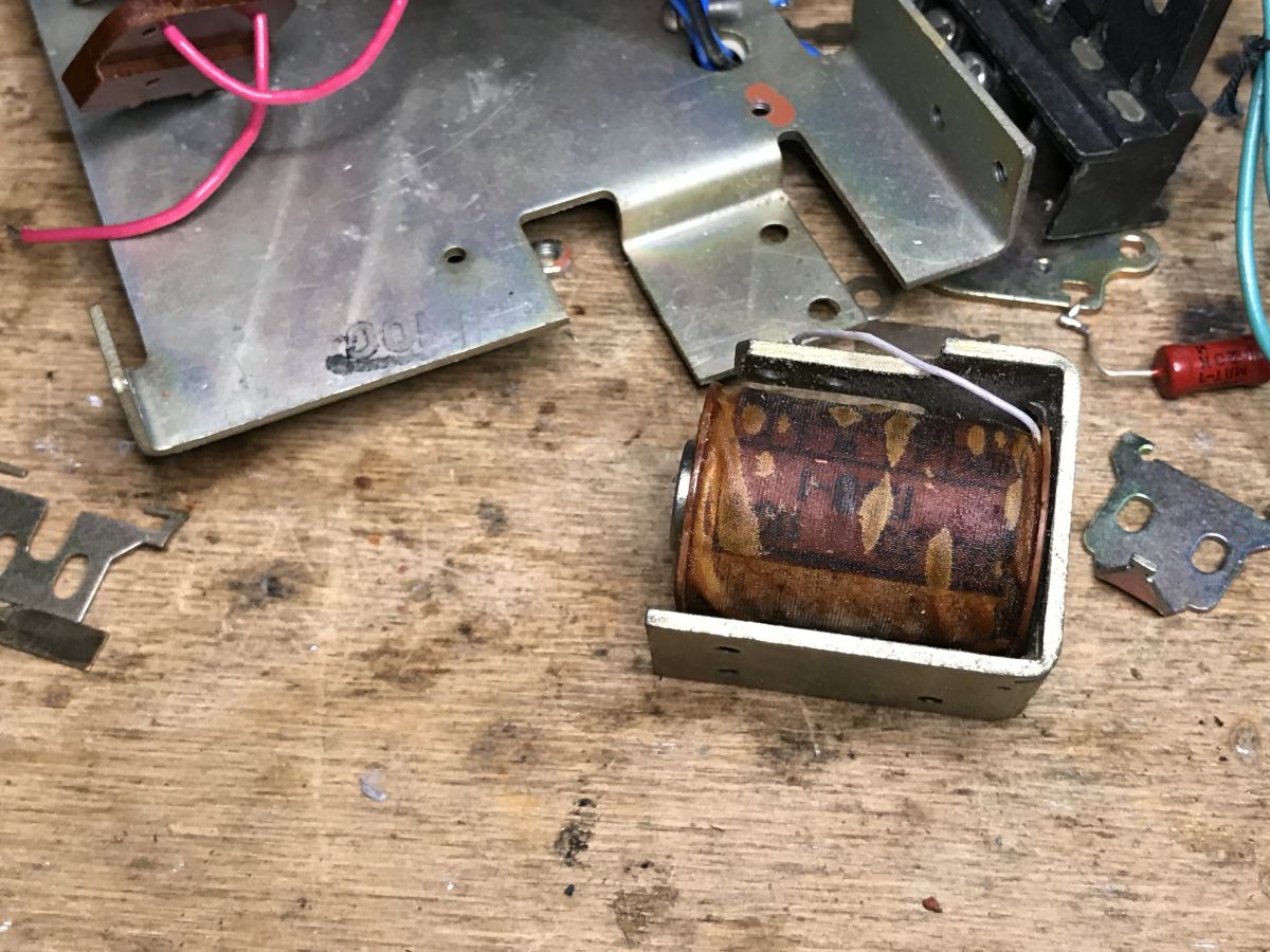

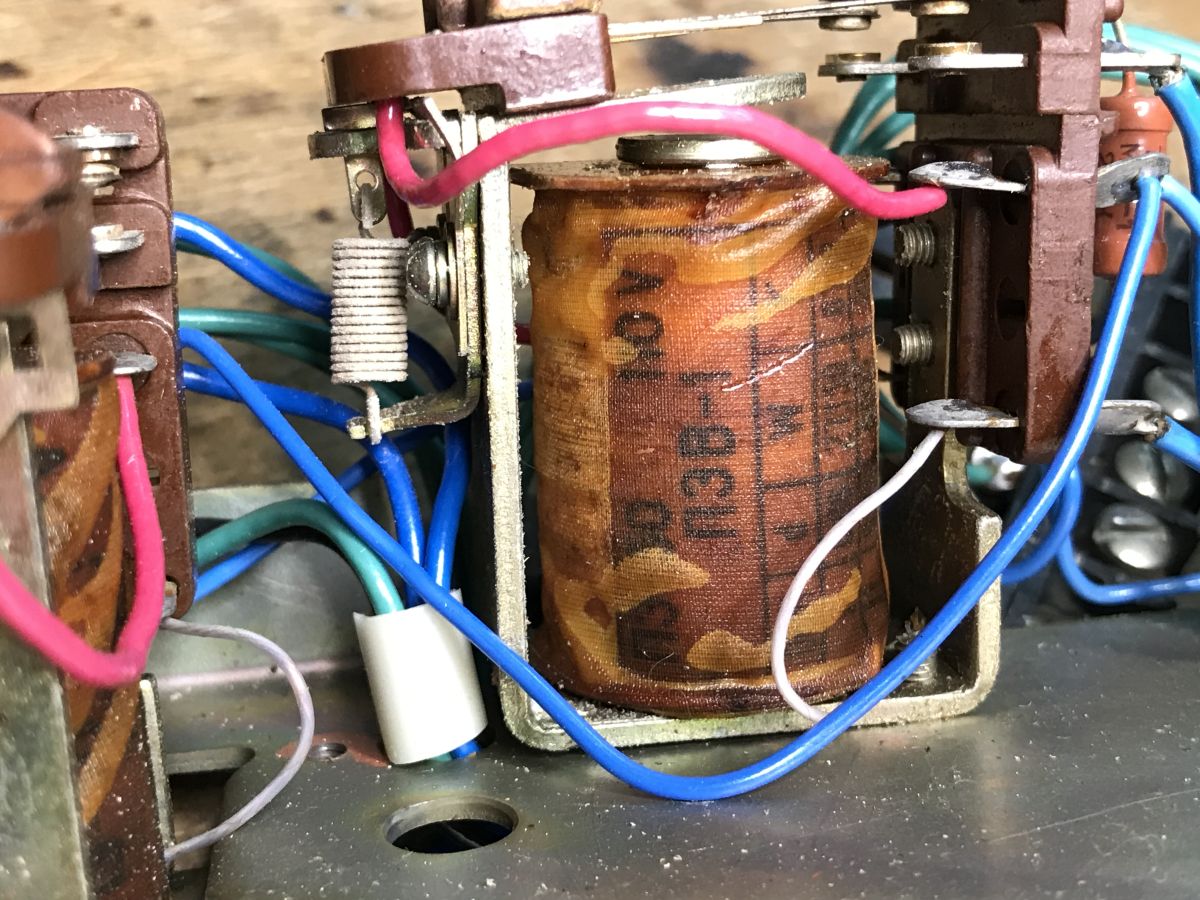

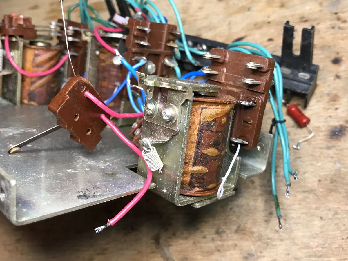

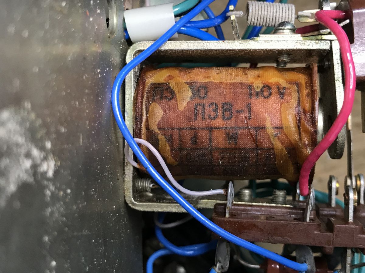

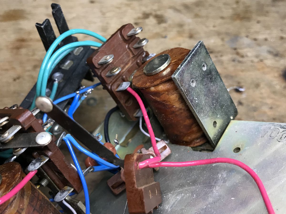

    Removing the relays:
    Close-up of a relay interior: large electromagnet coil with blue and red wiring on a metal base
    Close-up of a coil inside a device, labeled “110V”, with blue and red wires attached

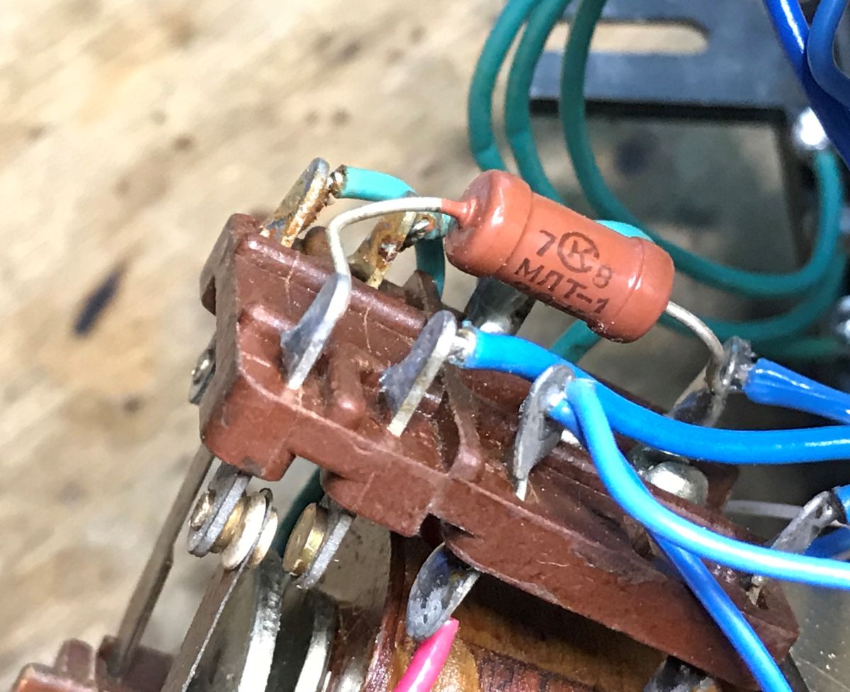

    Close-up of an electronic component marked “7Д8 МЛТ‑1” connected to wires on a contact assembly
    Three electromagnetic relays on a metal plate, wired with blue and green leads.
    Close-up of a disassembled relay with coil, contacts, and loose wires on a wooden workbench
    Close-up of a device interior with a relay coil, metal bracket, and colored wires on screw terminals
    Disassembled relay internals: coil, contact block on brown insulator, and blue wires on a workbench
    Electromagnet coil in a metal frame on a wooden workbench, with metal plates and wires nearby.

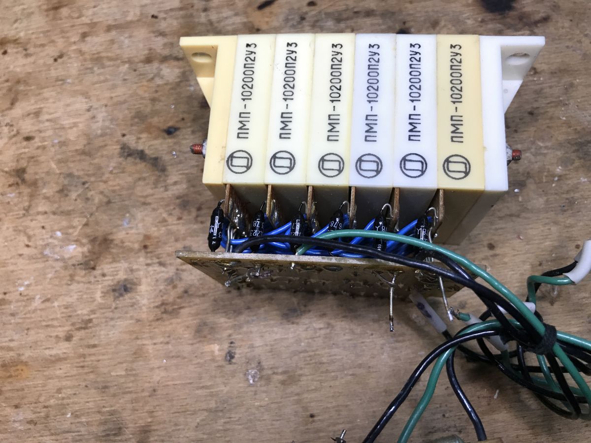

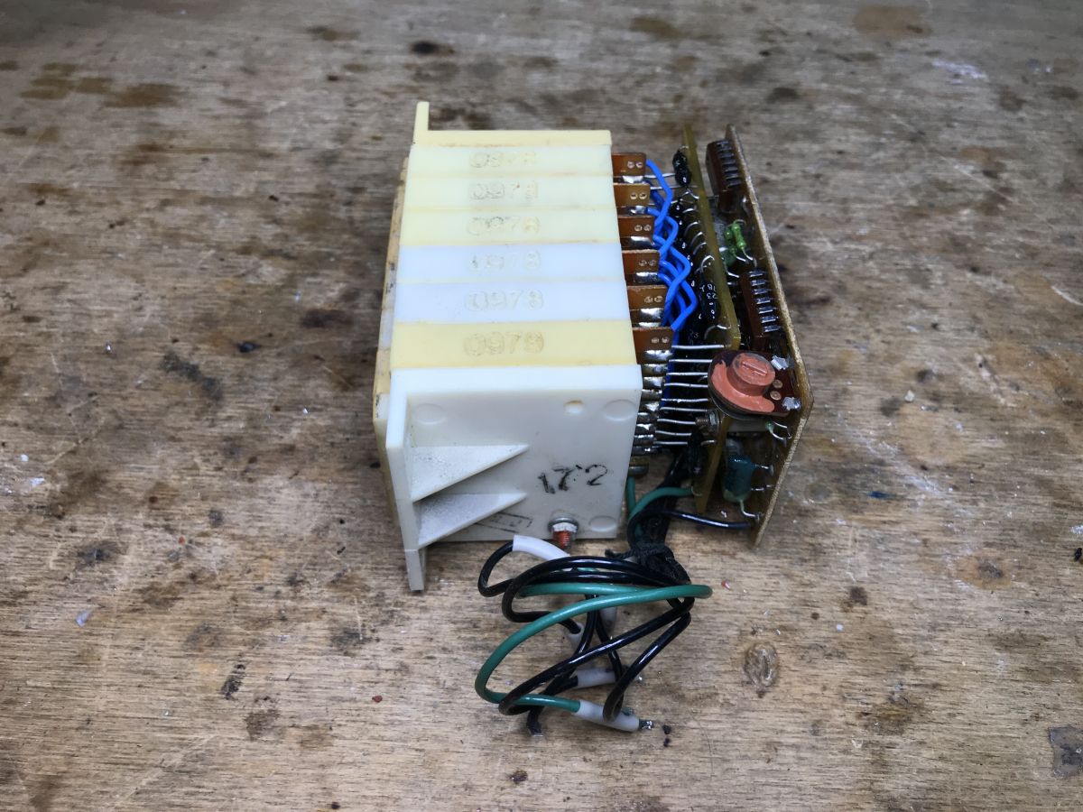

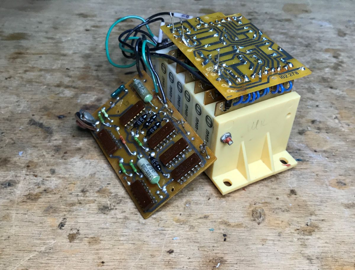

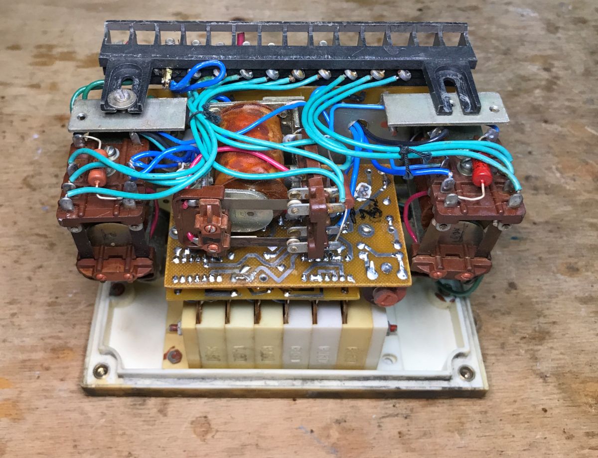

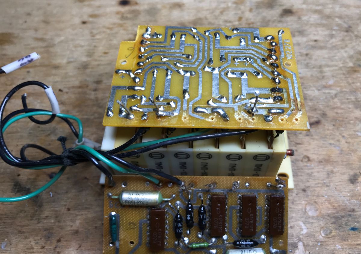

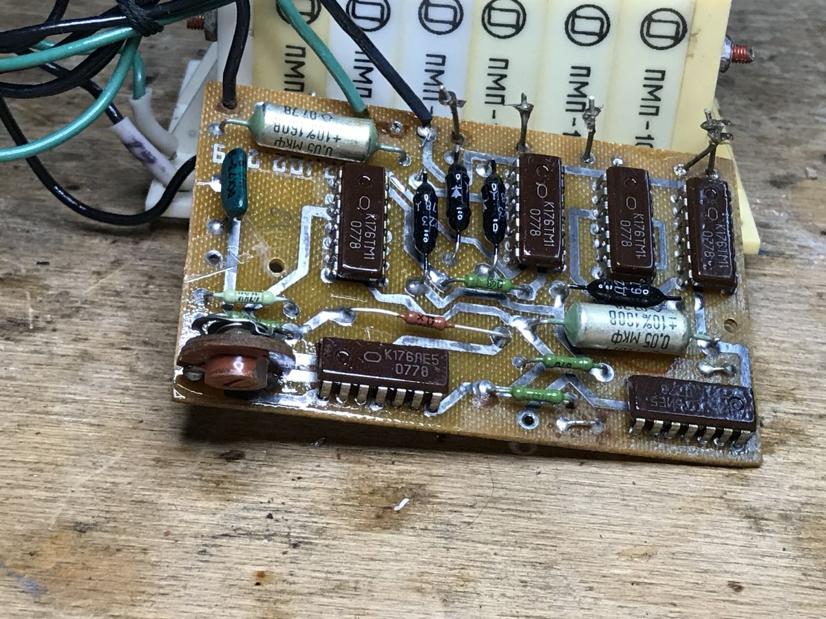

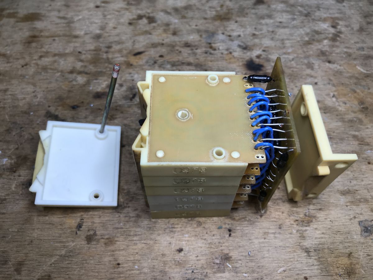

    Removing the meter module:
    Electronic module with a PCB and wire bundle on a wooden workbench
    Electronic module with a white housing and PCB with wires, lying on a wooden workbench
    Two circuit boards with components and wires beside a white terminal module on a wooden workbench
    PCB with K176TM1 and K176NE5 ICs and wires on a wooden workbench
    It is implemented using the K176TM1 and K176NE5 integrated circuits. I am curious about the component next to the potentiometer – is that a resonator from that era?
    Two stacked PCBs with solder traces, components, and wires on a wooden workbench

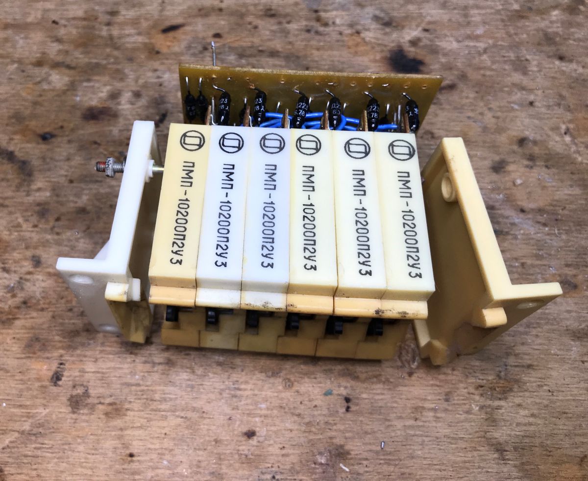

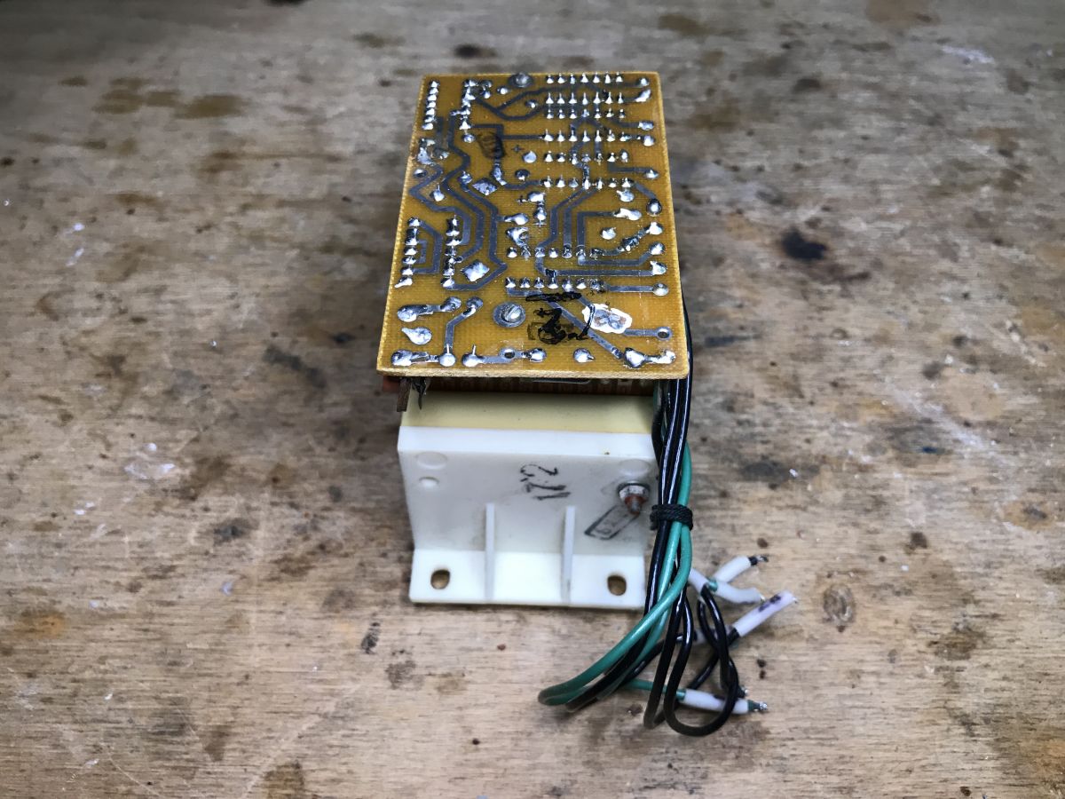

    Six white “ПМП-10200П2У3” modules on a PCB with wires, placed on a wooden workbench
    Module with six white relays and a PCB on a stained wooden workbench
    Disassembled relay module with PCB and blue wires on a wooden workbench
    I also wanted to check how the time is set, but the dismantling was interrupted due to the flood in 2024 and I did not complete the analysis, and the circuit board was lost. From what I remember, however, there were separate contacts for each pin, rather than a single resistive track.
    I found a similar device on this website: https://dzen.ru/a/X70JlQtK-AFJrFkT
    I had originally planned a more detailed presentation, including a schematic diagram, but the 2024 floods thwarted those plans and the equipment did not survive the clean-up.
    Therefore, I would be grateful for any additional information if anyone is able to identify the correct operating principle and the roles of the components inside?

    #2 21879217
    TechEkspert
    Editor
    Posts: 7232
    Help: 17
    Rate: 5609

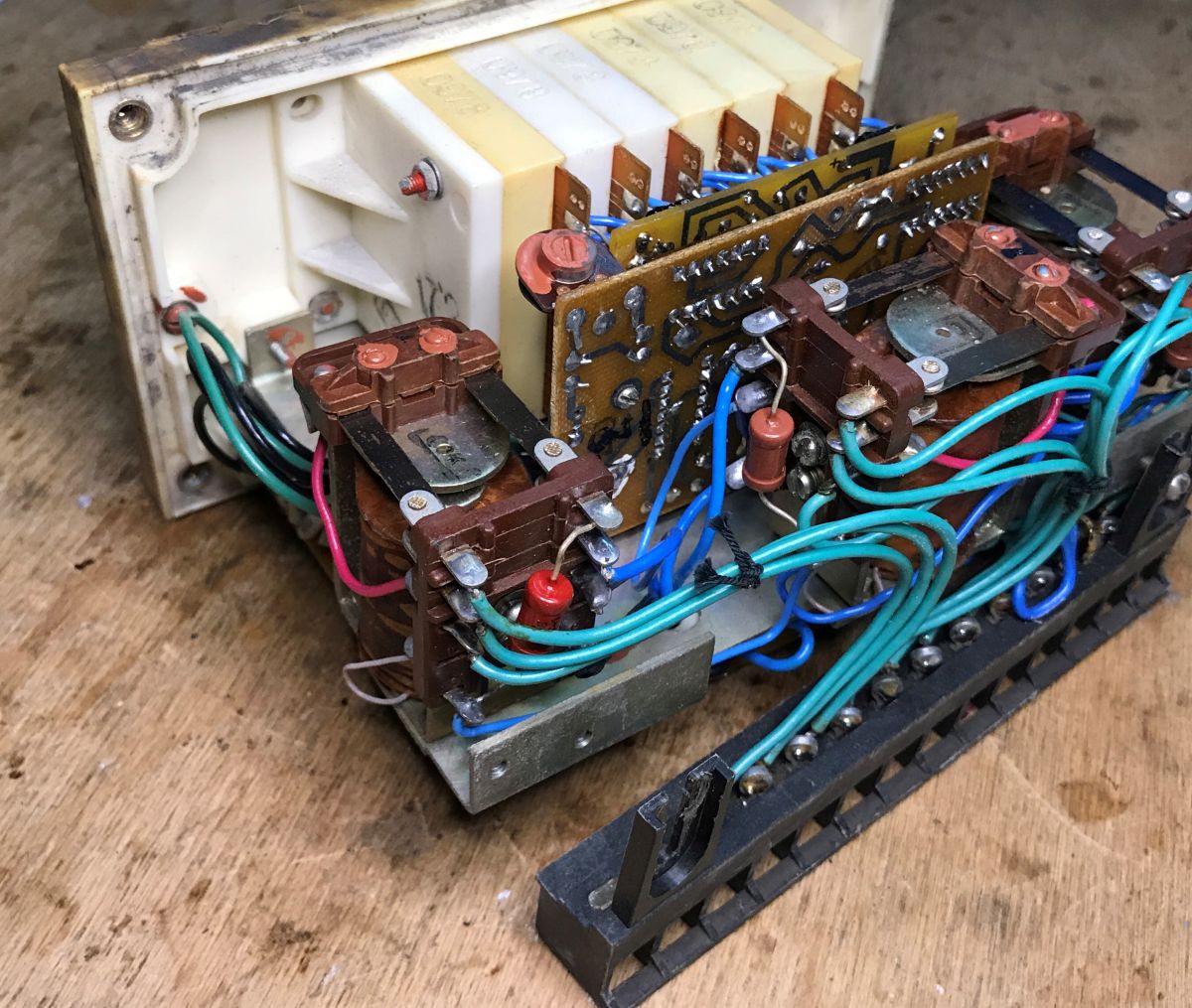

    Nothin' but nuthin' but nuthin' design :)
    MŁT resistors and relays without a case with the windings protected by a material soaked in some kind of impregnation.
    Typical Soviet rectifier diodes and red transistors in a truncated case are also visible.
    You may laugh but they used integrated circuits and the whole thing looks pretty good. Some of the KXXX circuits often had counterparts in foreign CD series digital circuits.
    https://www.embeddedlinks.com/chipdir/soviet/cmos.htm
    They used D flip-flops presumably as /2 dividers, while the K176NE5 was often used in timers such as loaders.
    Did they use a quartz resonator? Possibly, as the K176NE5 could have worked with a watch resonator.
    An RC generator would probably have been too unstable, it would also have been clever to use a 50Hz mains frequency but divisions matched to 32768 could have been more troublesome.
  • #3 21879619
    acctr
    Posts: 4554
    Help: 389
    Rate: 2021
    There is also the K176LE5, 4xNOR. The correct name for this chip with a generator in the Latin alphabet is K176IE5 rather than "K176NE5", which makes it easier to search for.
