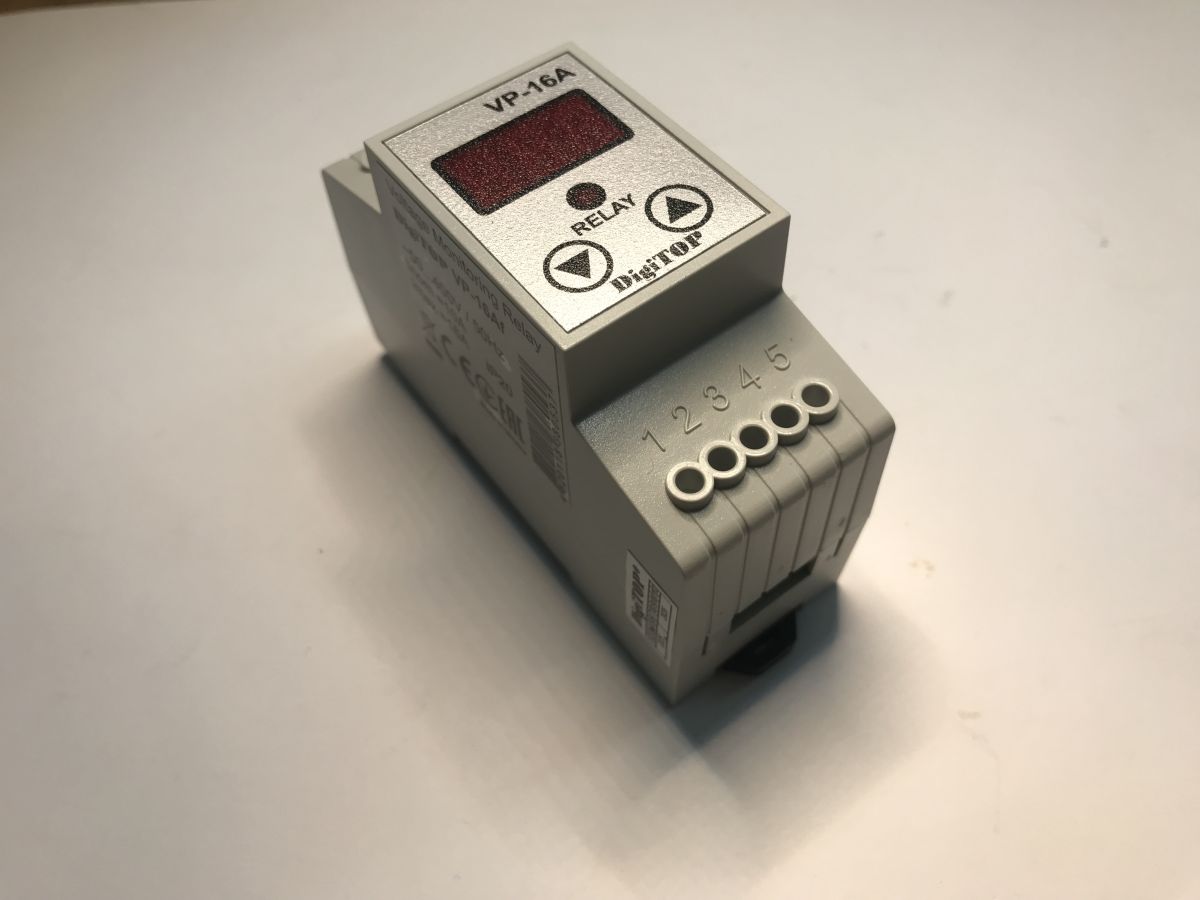

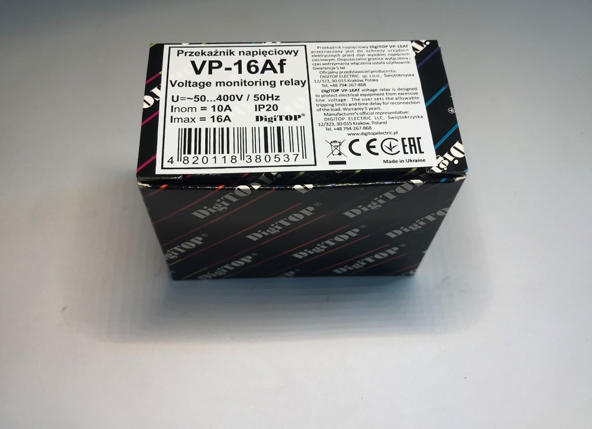

    Here I will introduce the DigiTOP VP-16Аf voltage relay designed to protect electrical equipment from excessive electrical voltage. It offers a simple LED display and a programmable setting for the upper cut-off limit, hysteresis and turn-on response time. The device is available to buy for around PLN 130.
    Minitest: DigiTOP VP-16Af voltage relay for photovoltaics Minitest: DigiTOP VP-16Af voltage relay for photovoltaics

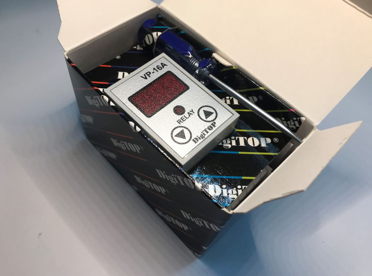

    Let's start with the unboxing and contents of the kit. We also get a small screwdriver in the box, which on the one hand is a nice, but also a strange idea. Rather, the person assembling this type of equipment has a screwdriver.

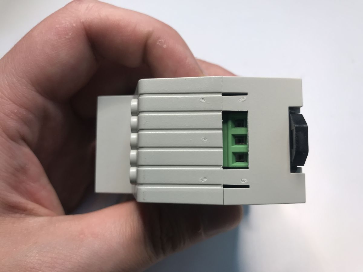

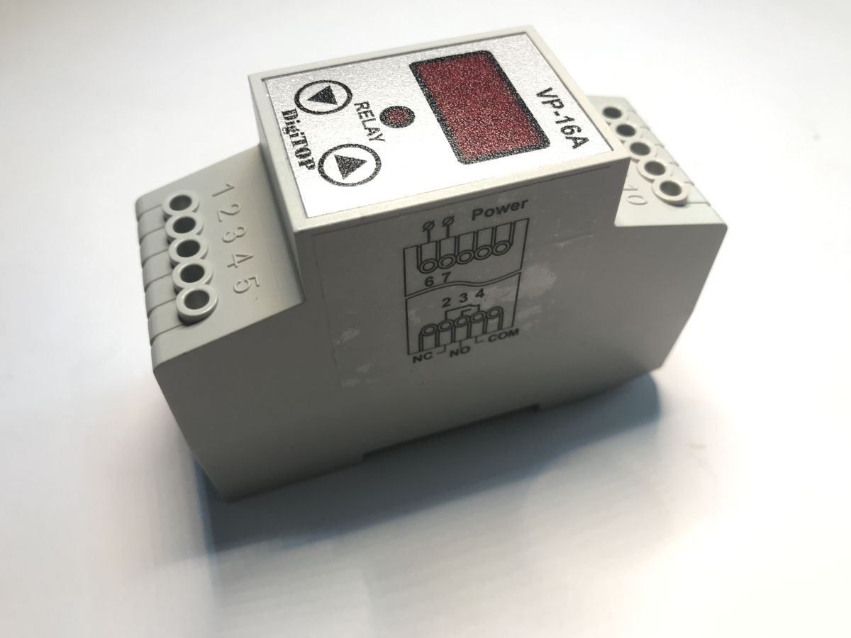

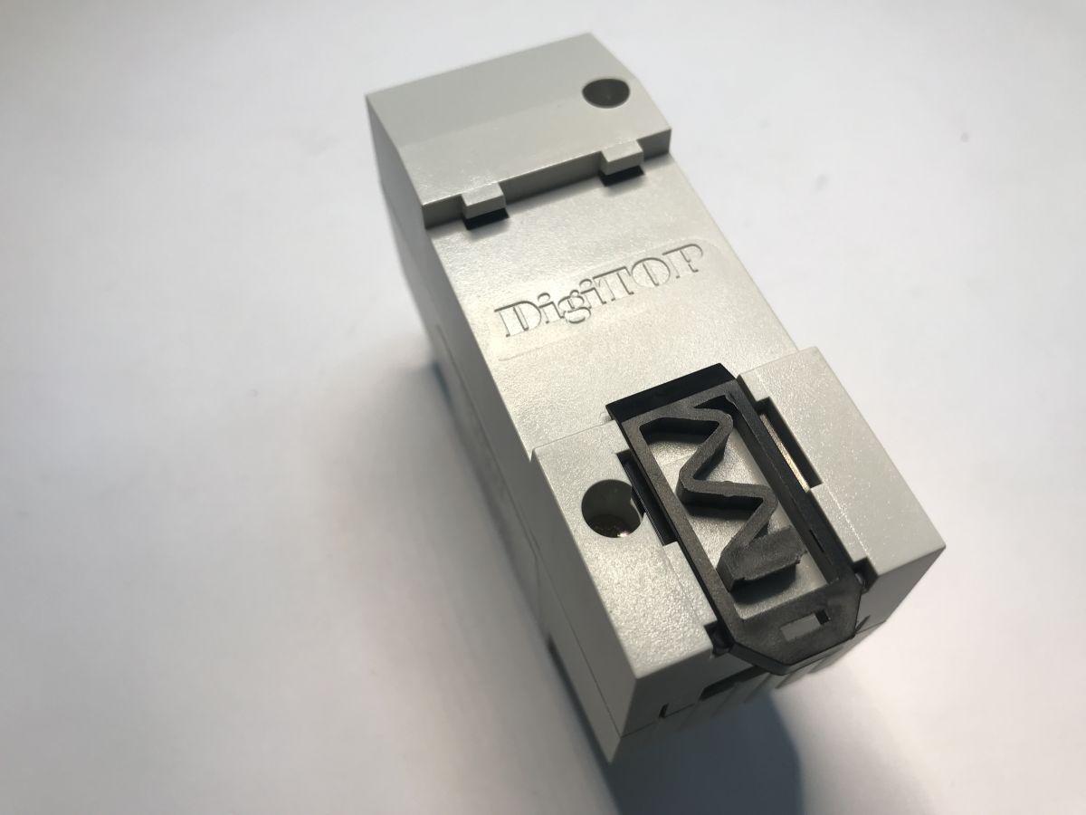

    The unit is DIN rail mounted. I haven't looked inside as there is a seal, while I think that a little bit these screw terminals could be more solid.
