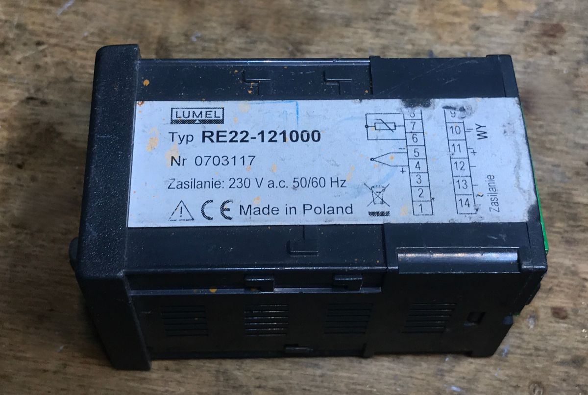

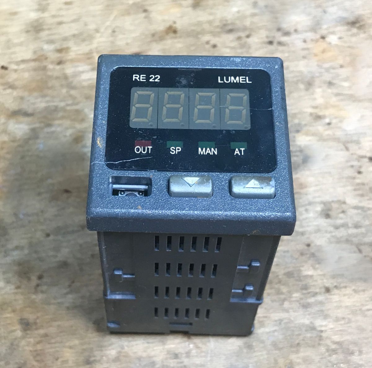

    I always look with curiosity at devices signed as Made in Poland, and this was also the case here. This tiny module with a four-digit display, four lights and three buttons is a temperature controller. According to the manufacturer, it is designed for use in the plastics industry, food industry, drying industry and anywhere else where temperature stabilisation is required.
    RE22-121000 Temperature Controller – Made in Poland – internal view RE22-121000 Temperature Controller – Made in Poland – internal view RE22-121000 Temperature Controller – Made in Poland – internal view

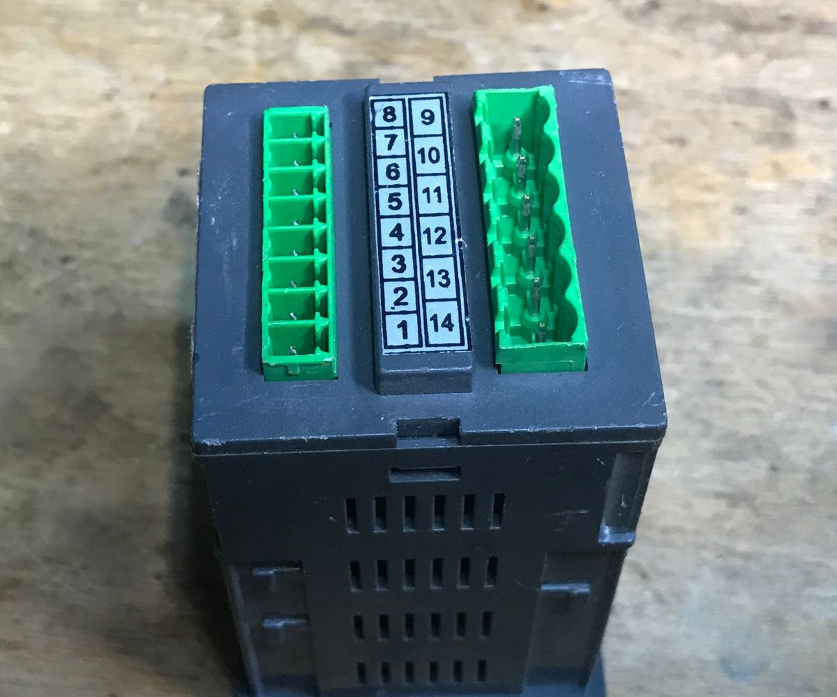

    The device works with resistance temperature sensors, thermocouples and standard analogue signals. Control can be performed in simple on/off mode with hysteresis or using a PID algorithm, the parameters of which can be set manually or selected automatically thanks to the auto-adaptation function. The relay output allows the direct control of small consumers and the settings can be password-protected. The entire unit is enclosed in an IP65-rated enclosure, supplied from typical mains voltages.

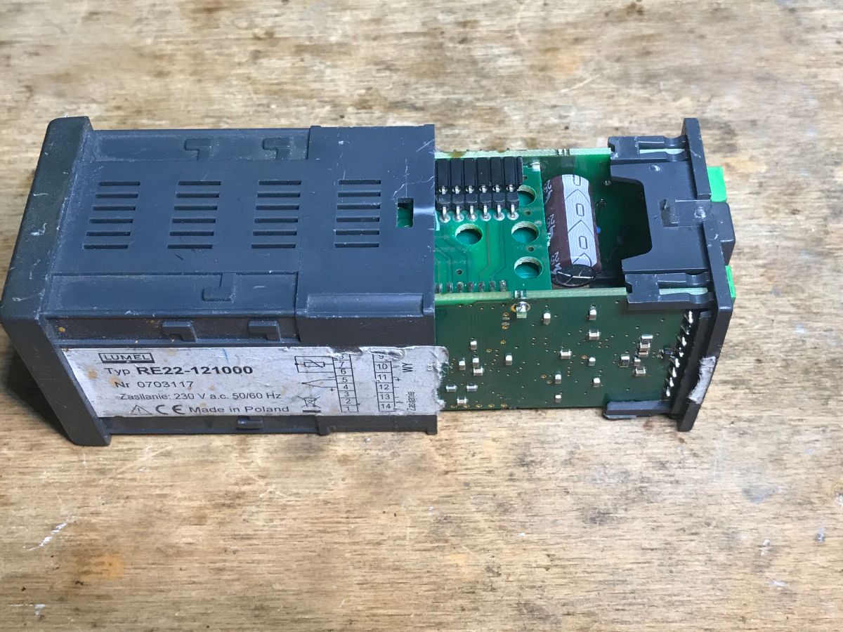

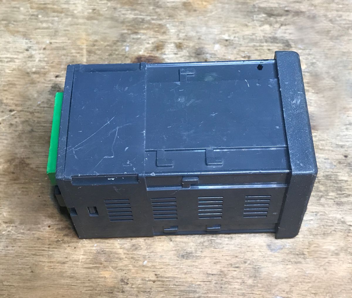

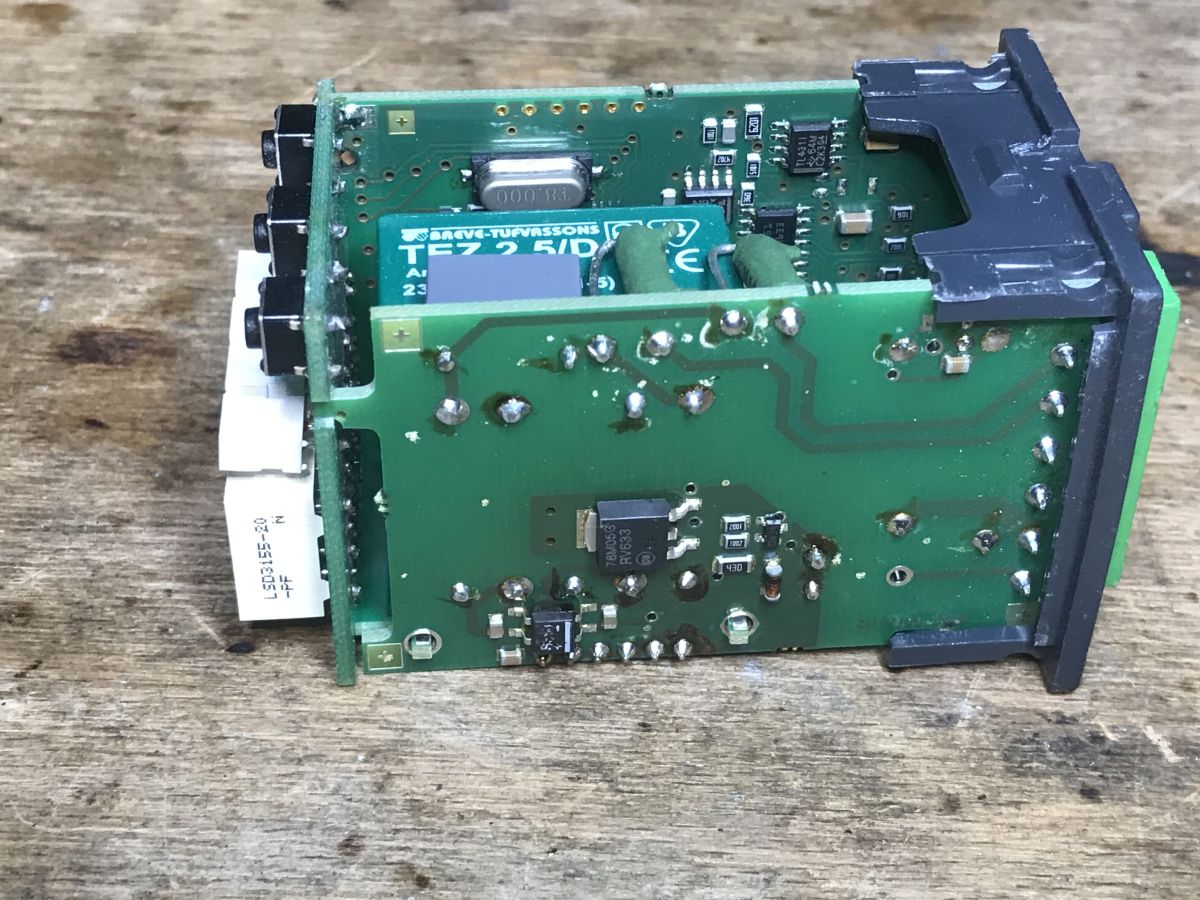

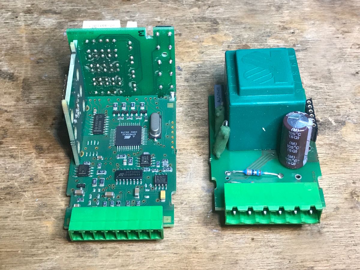

    We take a look inside to find out the secret of the compact design. The whole thing is made up of not one, but four laminate boards, cleverly fitted together on pin joints or simply soldered together (front panel with base). Primarily surface mount is used, although through-hole components are also available.

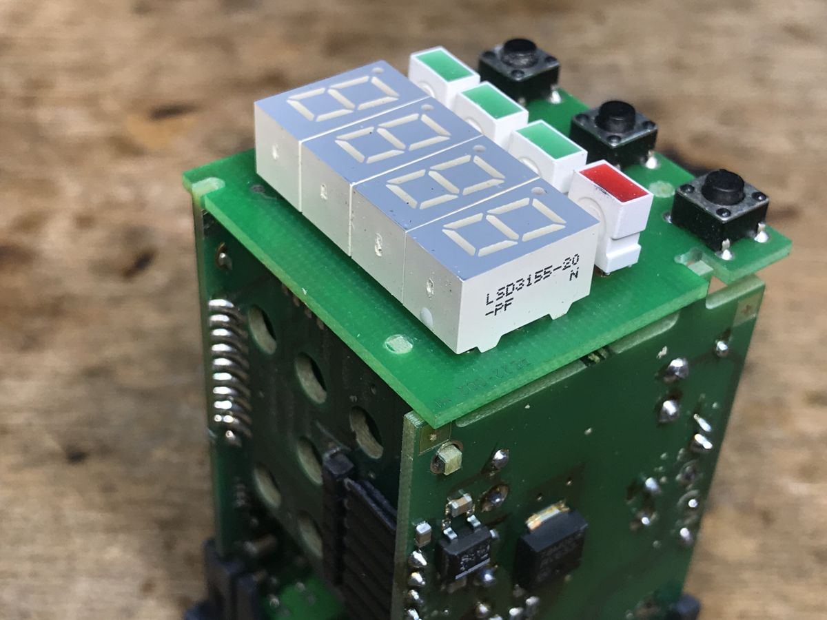

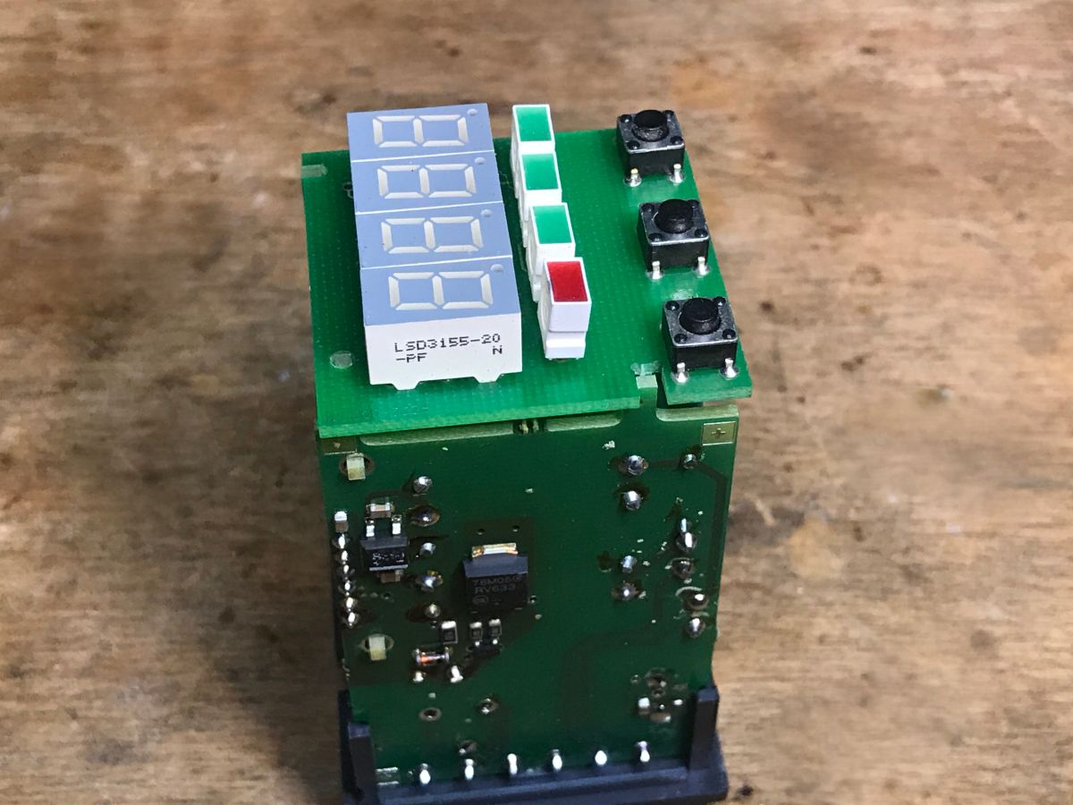

    The display is made up of separate digits - the LSD3155-20. The construction of the whole appears to be fairly simple and does not include unusual components such as a dedicated display driver with an I2C style interface.

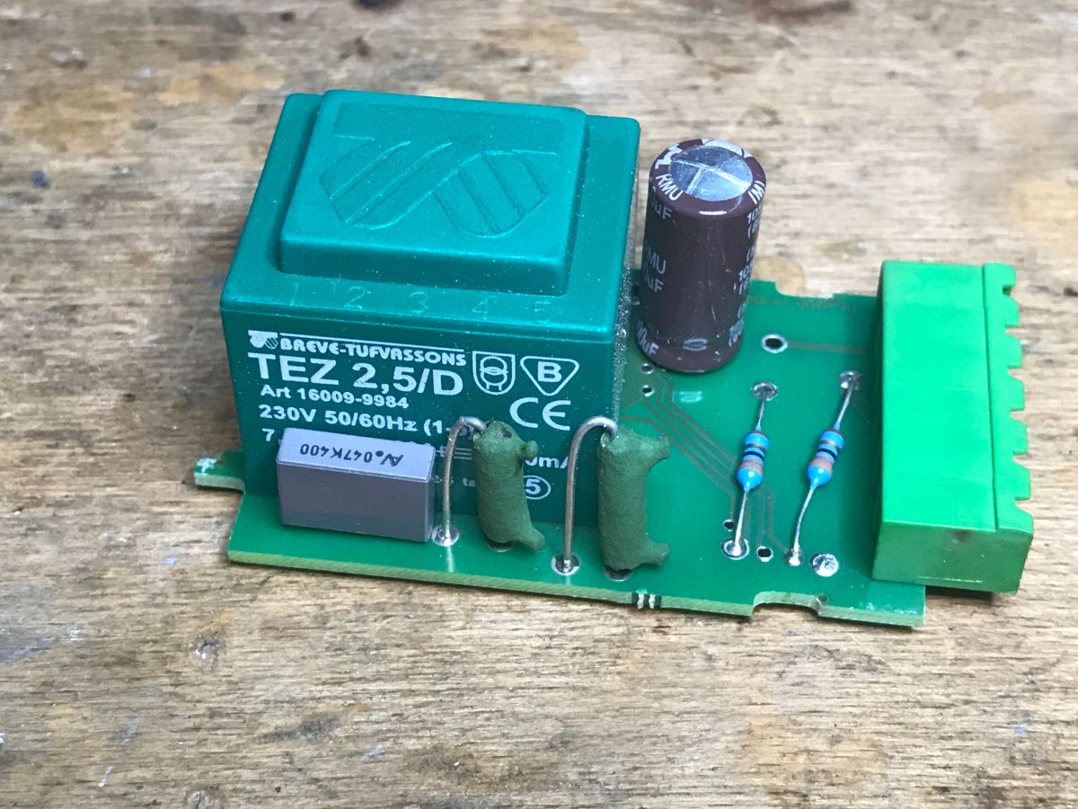

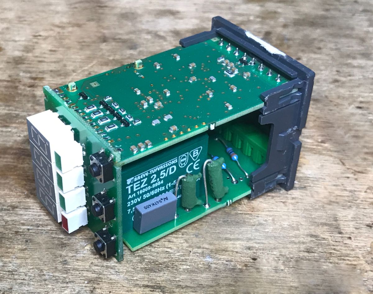

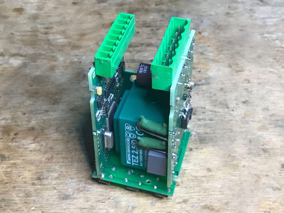

    The whole thing is powered by a TEZ 2.5/D BREVE-FUFVASSONS Art 16009-9984 mains transformer. As far as I can see, the power of this transformer is 2.0 VA and the voltage on the secondary side is 7.5 V.

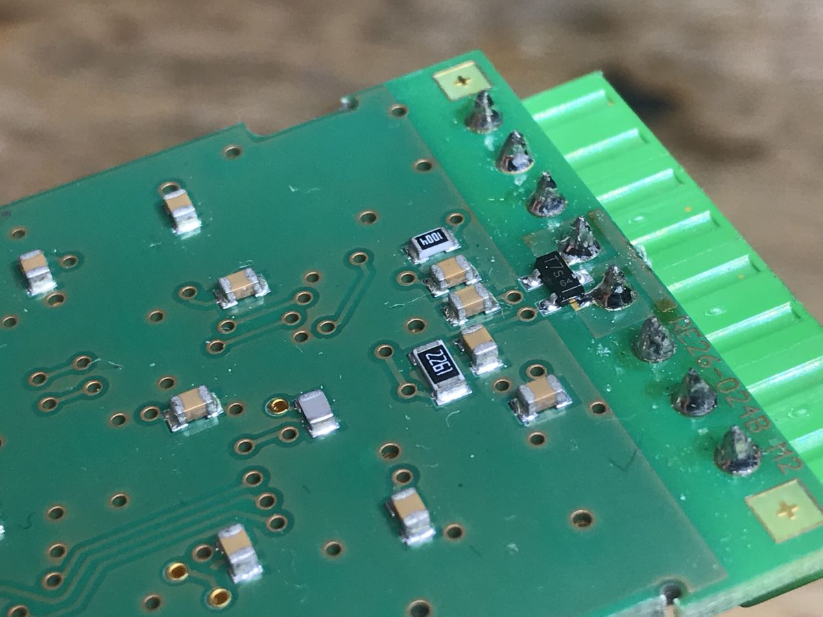

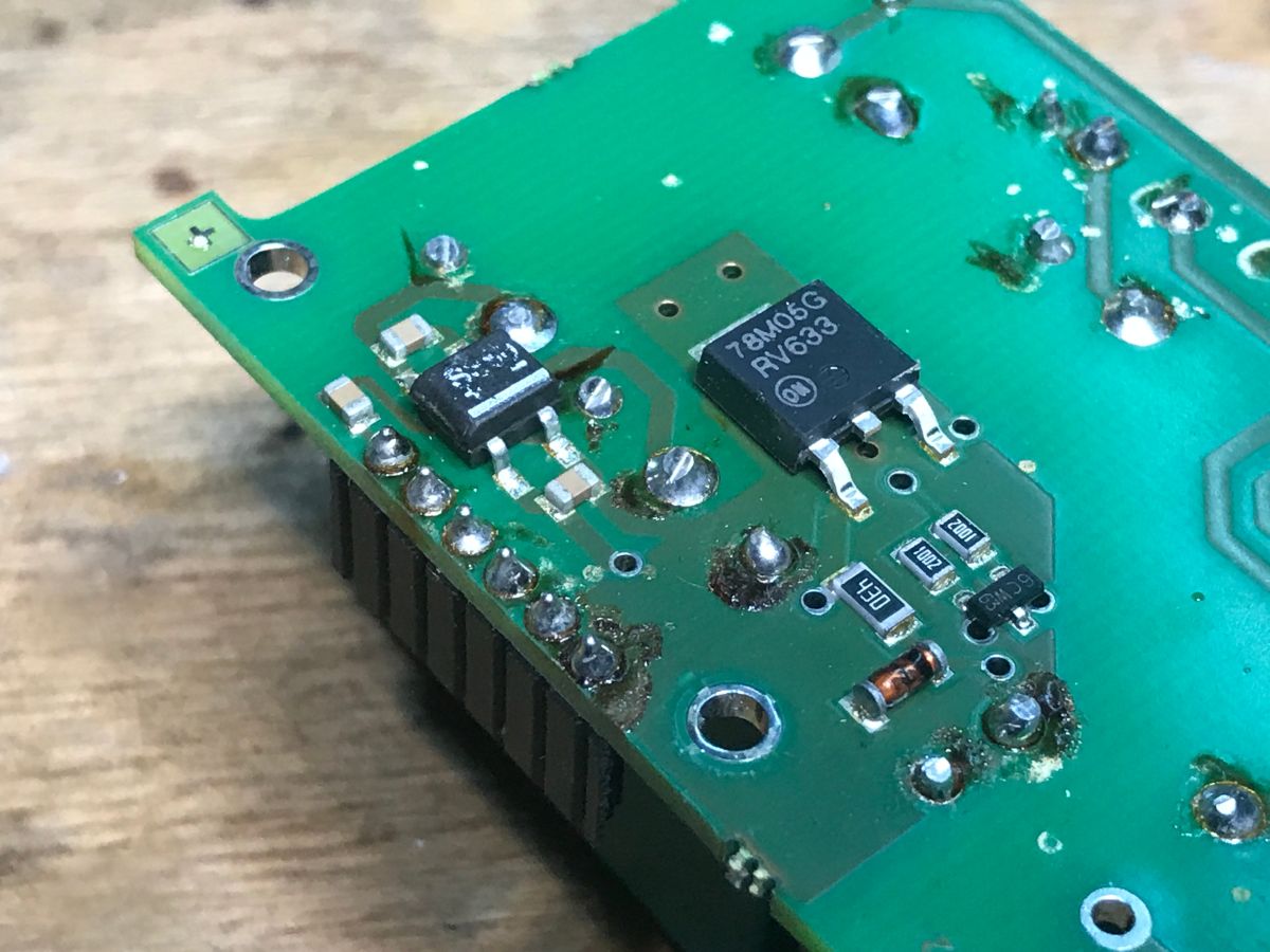

    In the power supply section is the immortal 78M05 stabiliser. The solder is a bit conspicuous because someone didn't clean up the rosin. It is by every point, suggesting that this is a leftover from the factory.

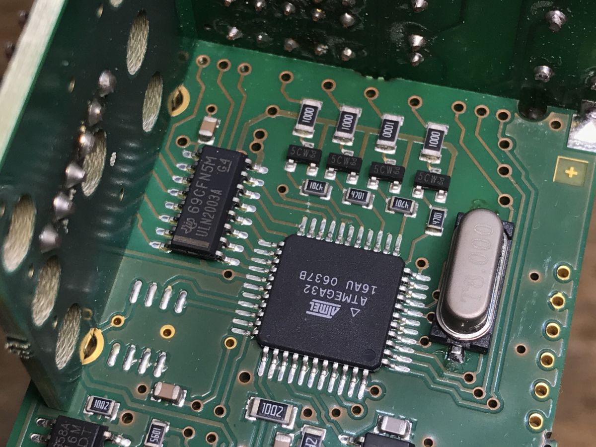

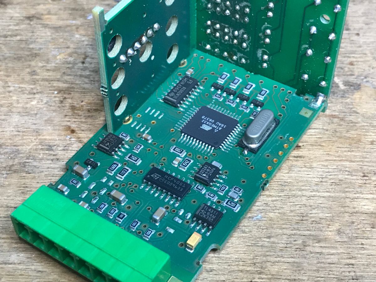

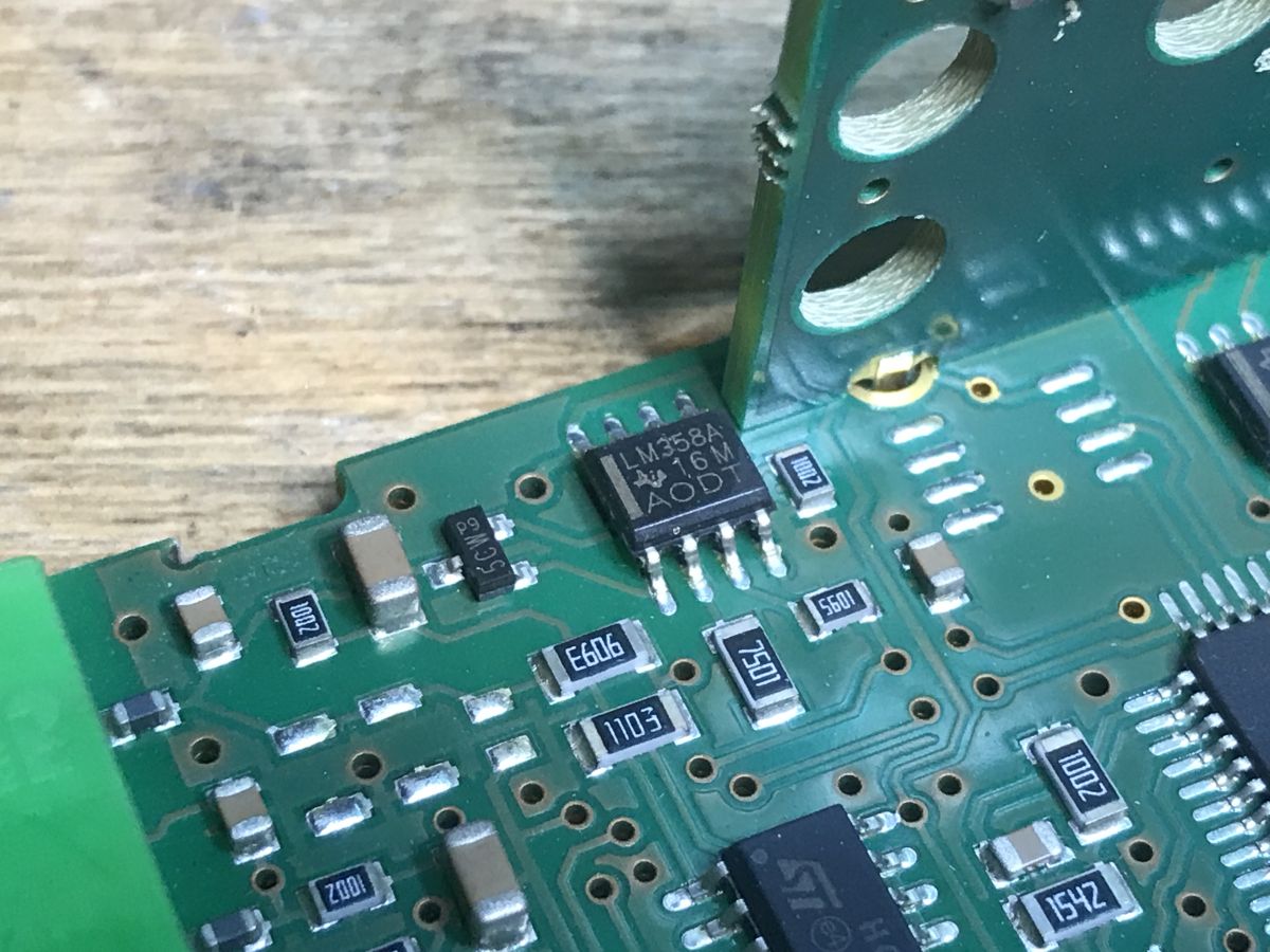

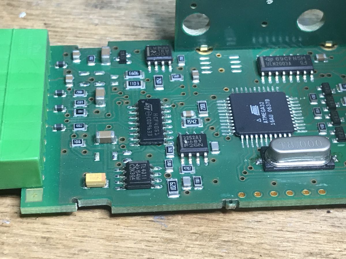

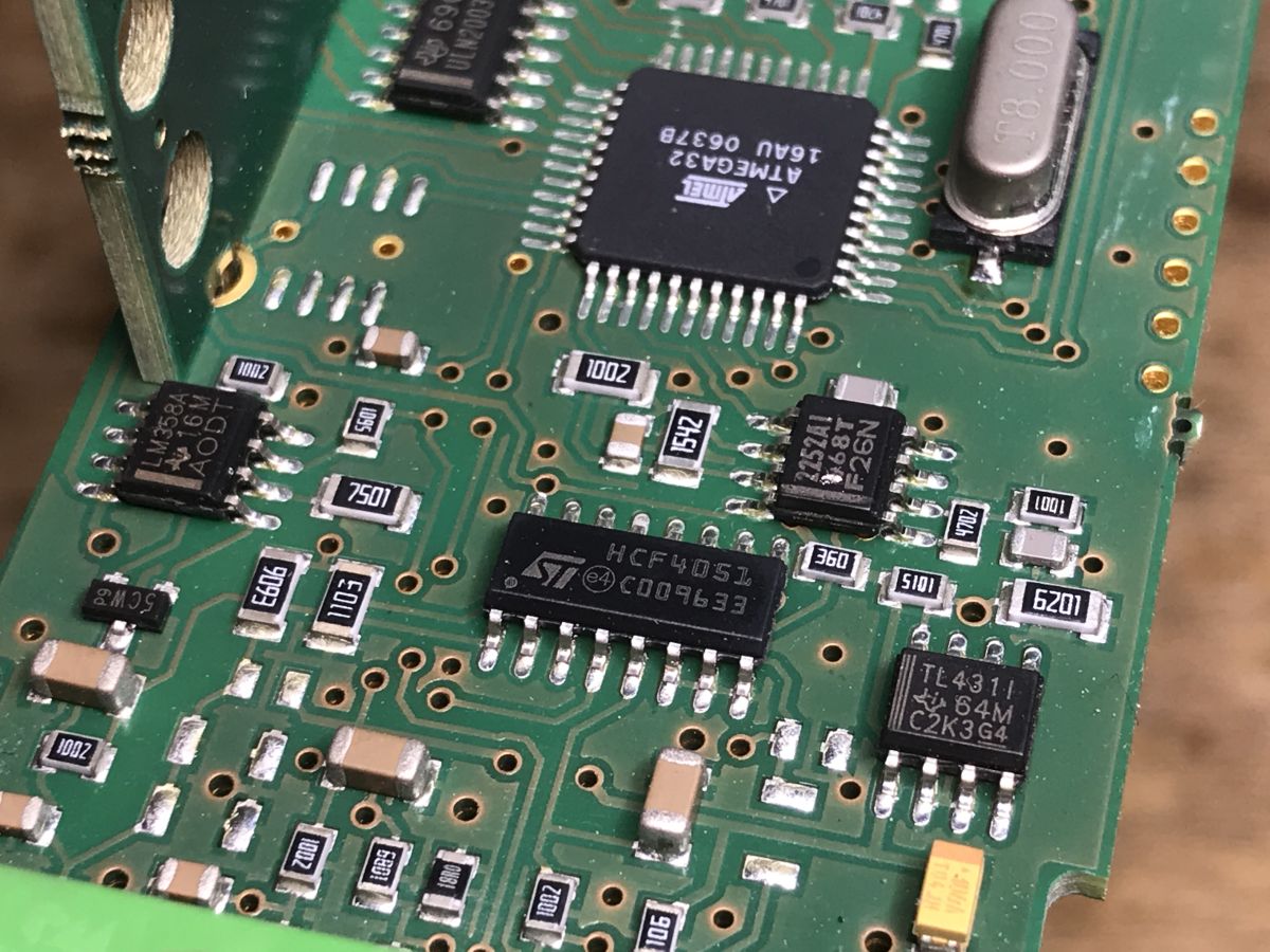

    At the heart of the module is the Atmega32. This is no surprise, it's probably one of the more popular microcontroller families with us. I was a bit expecting a PIC there, but looking at our forum they are less known though. Next to the Atmega you can see four transistors to control the separate digits of the display. Next to it is also a ULN2003 - probably also to control the displays, or more precisely the segments. In the measurement section I see an LM358 (operational amplifier), HCF4051 (multiplexer), TL431 (reference voltage) and a 2252A circuit that I don't recognise. Suggestions? I'm also surprised by the extra four transistors - there are eight in total.
    All in all, that will be about it. Apart from the solder, another capacitor caught my eye, it looks slightly faded, although the module itself doesn't have a switching power supply, so I'm a little more surprised than usual.
    The whole thing could probably be made to work, I can also see a programming port on the board, so you could make your own DIY based on this module.

    pawlik118 wrote:
    The transformer fuse is missing (although it is drawn on the sticker that it should be).
    And it probably is. In the transformer housing. Because it's a transformer sticker. German.
    pawlik118 wrote:
    on the sticker it is drawn that it should be
    I would read it like this: "on the sticker it is drawn, that it is ".

    Just Breve is a mould from Lodz, so Poland. The transformer does not have a built-in fuse, this marking suggests that it should be protected with a fuse of the value given next to this symbol.

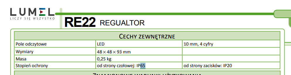

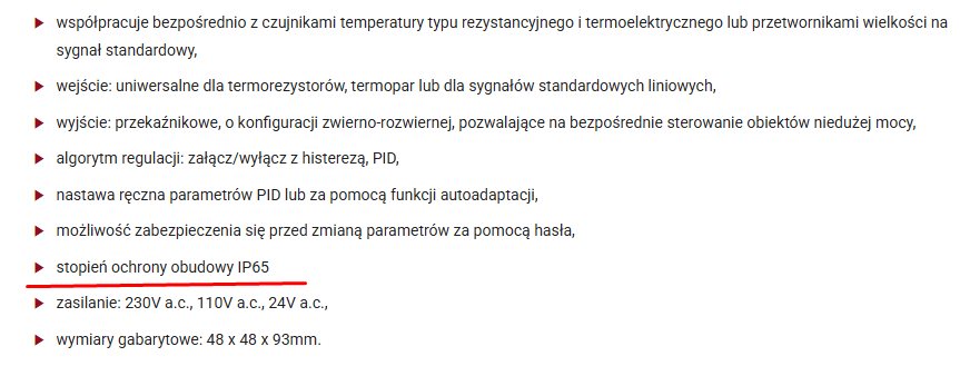

    Everything is enclosed in an IP65-rated enclosure, powered by typical mains voltages.
    Where does this information come from? IP65 is a dust- and waterproof enclosure, and you can see from the photos that it has large ventilation slots, the buttons are not sealed, similar to the connectors on the back.

    The specifications (including IP65) are from the manufacturer's RE22 website. I can also give you the current price of the product by the way - £349.
    Although the fact that it is only in the PDF that they specify that it is the front.

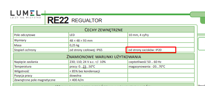

    Datasheet excerpt for “RE22 REGULATOR” highlighting “terminal side: IP20”
    Everything is in the specification when it comes to IP 20 from the contacts and IP 65 from the front.

    and layout of 2252A which I do not recognise. Suggestions?
    TLC2252 made by Texas Instruments, although you might want to make sure by checking the connections on the board.

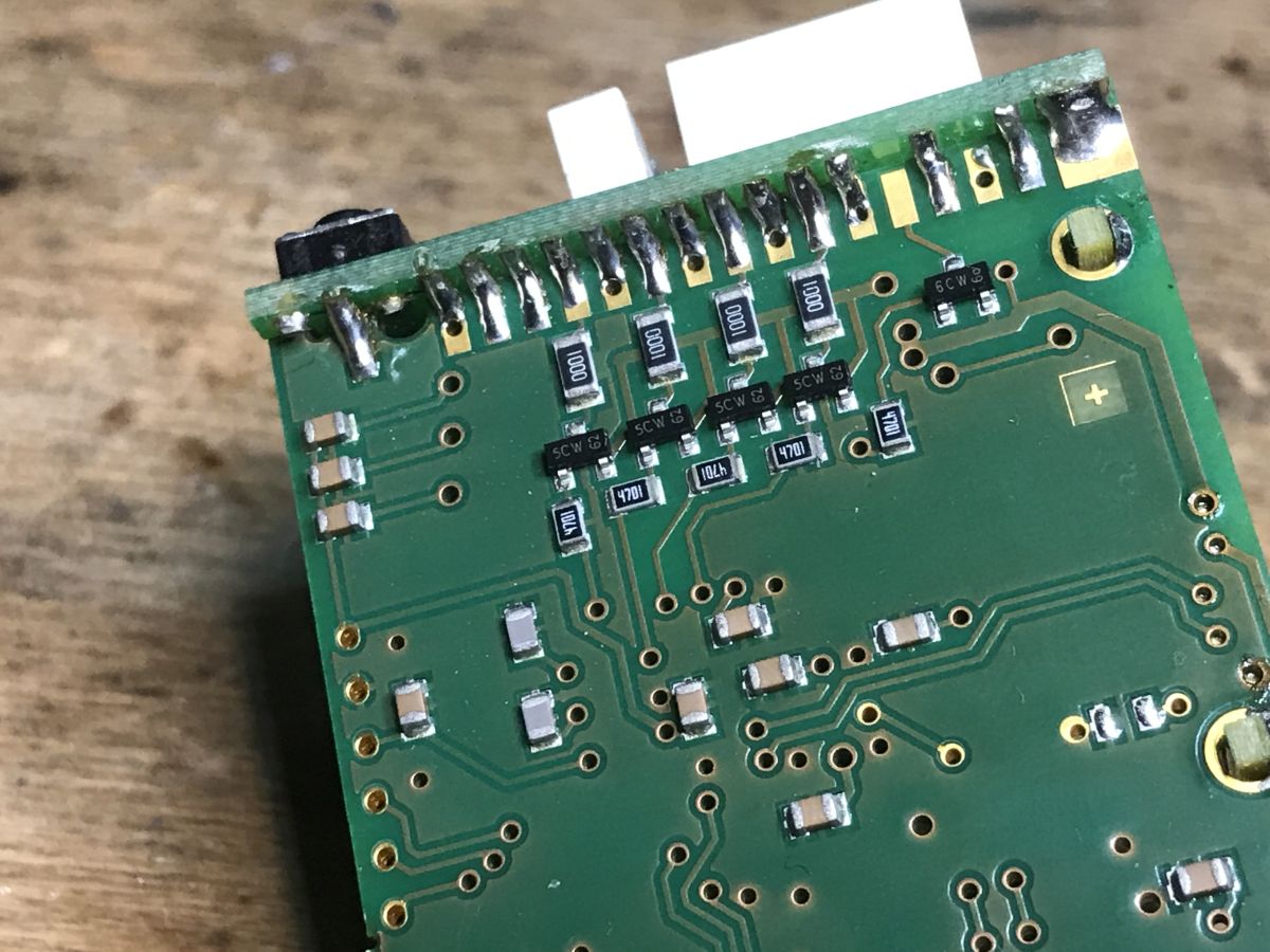

    Four segments + four leds on the panel ;)

    In addition to the solder, I also noticed a capacitor, it looks slightly swollen, although the module itself does not have a switching power supply, so it surprises me a bit more than usual.
    Happens if, for example, a rectifier bridge has short-circuited or a capacitor has been running at elevated temperatures all the time.

    with typical mains voltages.
    It always puzzles me why the 230V AC 50/60Hz designation is used on the housing when there are only a handful of countries in the world where the very unusual 230V AC 60Hz supply standard applies, and I doubt this regulator will ever be exported there.
    The more common standard for 60Hz is 110V AC.

    kris8888 wrote:
    Made in Poland but unfortunately probably not a single component inside was made in Poland. Even the transformer is not Polish. A pity.
    After all, this is a transformer made by Breve - a Polish company from Lodz https://www.breve.pl/
    A much nicer company to deal with than Indel, very good quality products.
    Happens if, for example, a rectifier bridge has short-circuited, or a capacitor has been running at an elevated temperature all the time.
    I see a different factor here. These units typically run either most of the time or virtually continuously. An example of a food storage unit must provide the correct temperature whatever the circumstances. It is not unusual to operate continuously for months or even years. Meanwhile, such electrolytic capacitors have a nominal life specified at 1000, 2000 or 3000 hours of operation. In my opinion, this is where natural wear and tear has occurred. With the thesis of the reason being the increased temperature, I cannot agree. Standard electrolytic capacitors have a permissible operating temperature of 85°C.

    And actually, something confused me about that company name on the transformer. I've had no contact with their products so far.
    There is also some Swedish shareholder there from what I read, but I think it's a minority one.
    Mateusz_konstruktor wrote:
    Then such electrolytic capacitors have a nominal life specified at 1000, 2000, or 3000 hours of operation. In my opinion, this is where natural wear and tear has occurred. With the thesis of the reason being the increased temperature, I cannot agree
    It is just that natural wear and tear in the temperature range generally manifests itself as drying out or leakage of electrolyte through the seals around the leads and consequent loss of capacity. The capacitor casing is rarely swollen in this way, unless the capacitor belongs to a so-called "black list" of capacitors with a faulty electrolyte which has caused this type of effect.
    It is not unusual to operate continuously for months or even years. Meanwhile, such electrolytic capacitors have a rated life of 1000, 2000, or 3000 hours of operation.
    The regulators I have installed have been in service for over 20 years, at a minimum of 10 hours a day.

    The service life of a capacitor, e.g. 2000h (4 months), is determined for the maximum operating temperature and with a slight deterioration in parameters (capacitance and ESR). Reducing the temperature by 10 degrees increases the life by 2x. That is, for operation at 40C, there should be an estimated 128,000h (14 years). Nevertheless, in this circuit the capacitor conducts almost all the current as it is charged in the sine peaks and discharged all the time, although the current should not be large because the trafko is low power. I also happened to have a whole series of Samxons which all "exploded" well below the estimated life, just some manufacturing defect in the capacitors.
    https://www.megastar.com/content/pdfs/RMU_Series.pdf

    I come with specifics.
    @pawlik118
    Daewoo Electronics is the name used since March 2006.
    However, there was Partsnic between that date and December 2000.
    It is also possible that the Partsnic logo was temporarily used just after the name change to Daewoo, and which is the logo on the unit in question.
    We are not sure if any of the technical data has not also been changed.
    Here we have a Partsnic-branded capacitor, a product of the company of the same name and operating in South Korea.
    The model is an RMU, designed for a maximum temperature of 105°C.
    The so-called load life is 2000h at 105°C.
    There is also an important piece of data here: this is a product from some twenty years ago, with many consequences.
    kris8888 wrote:
    Only that natural wear within the permissible temperature range generally manifests itself as drying out or leakage of the electrolyte through the seals around the leads and consequent loss of capacity.
    This is exactly what worn out, or even damaged, electrolytic capacitors encountered by me in domestically manufactured products from many years ago look like. I am referring here to all sorts of "Unitry and Kasprzaks". Meanwhile, in western products, I find such specimens bulging at the top, and this in transformer power supplies. There must be some detail in the design of old Polish capacitors, although this has never been the subject of my research.

Why would an electrolytic capacitor look slightly swollen in a transformer-powered controller that does not use a switching power supply?
A slightly swollen electrolytic capacitor still indicates ageing or stress, even in a transformer-powered design. The author flags that part as unusual because the controller uses a mains transformer, a 7.5 V secondary, and a 78M05 regulator rather than a switching supply. That makes the swelling more noteworthy, not less, because it suggests component wear despite a simpler power section. [#21879622]
How can you identify an unknown IC on a controller PCB by tracing connections and comparing likely parts such as the TLC2252, LM358, and HCF4051?
You identify it by matching its pins to the surrounding circuit, not by package code alone. "HCF4051 is an analogue multiplexer that routes one of several input channels to a shared path, making it useful in mixed-sensor measurement circuits." In this board, the unknown 2252A sits near an LM358, HCF4051, and TL431, so tracing power, inputs, and outputs is the fastest way to confirm whether it is the TLC2252 suggested in the reply. [#21879846]

What is the LSD3155-20 display used in the RE22, and how is it driven without a dedicated I2C-style display driver?
The LSD3155-20 is the individual digit display element used to build the RE22’s 4-digit front readout. The post says the display uses separate LSD3155-20 digits and notes there is no unusual dedicated I2C-style display driver. Instead, the circuit appears to use direct multiplexing from the Atmega32, with transistor switching for digits and a ULN2003 for segment drive. [#21879622]
