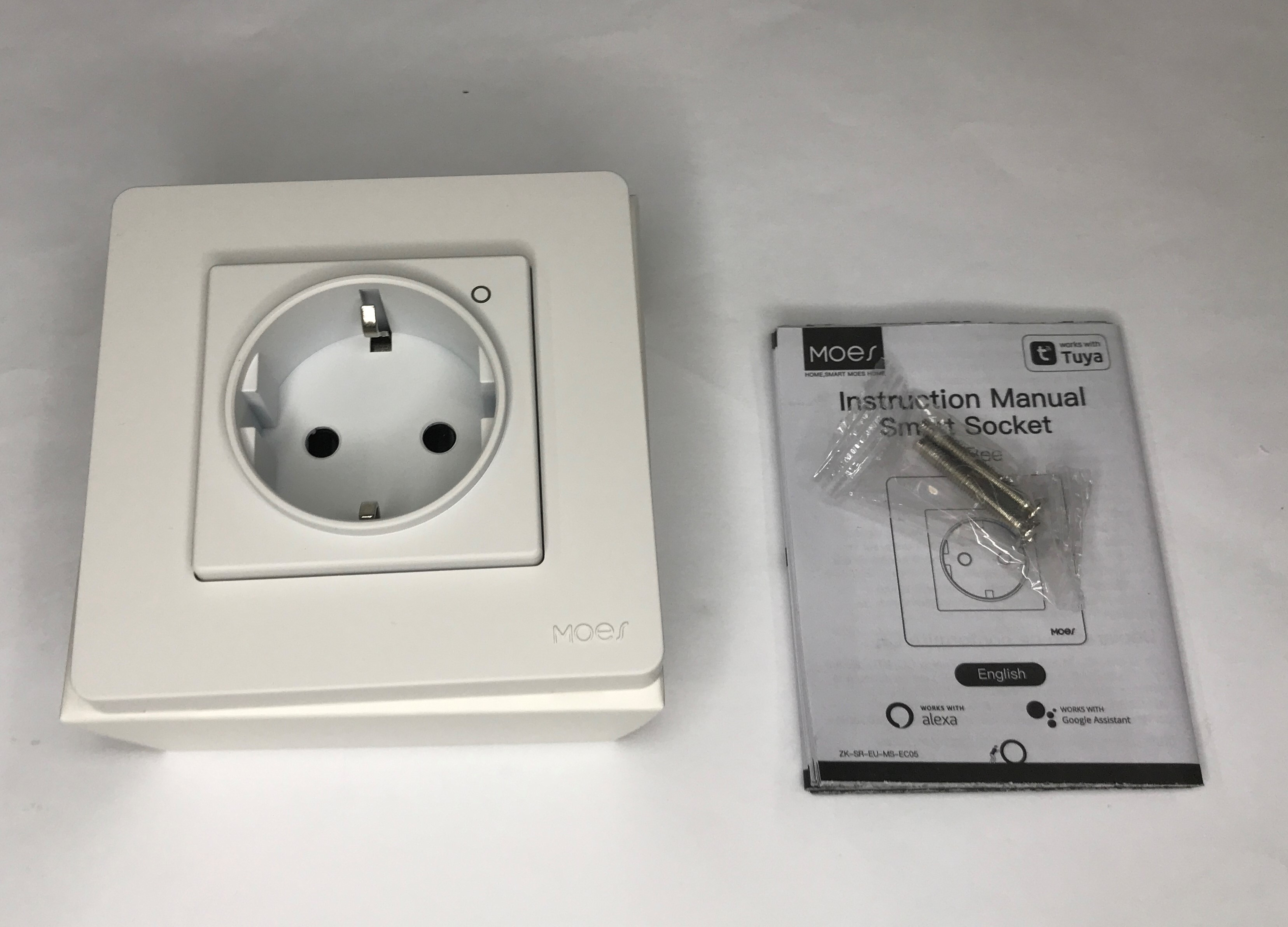

White Moes Schuko wall socket beside a “Smart Socket” instruction manual with screws
How to monitor energy consumption in building automation? One solution for individual consumers can be some kind of extension cable or adapter that takes the measurement, but it is undoubtedly more convenient to have the measurement in the socket itself. The ZK-SR-EU shown here makes this possible. The ZK-SR-EU takes the form of a flush-mounted socket and is controlled via the Zigbee protocol, which enables easy integration with both the manufacturer's gateway and the Home Assistant. The whole thing, of course, also has a tiny button on the casing to switch the relay in the event of a wireless outage.
