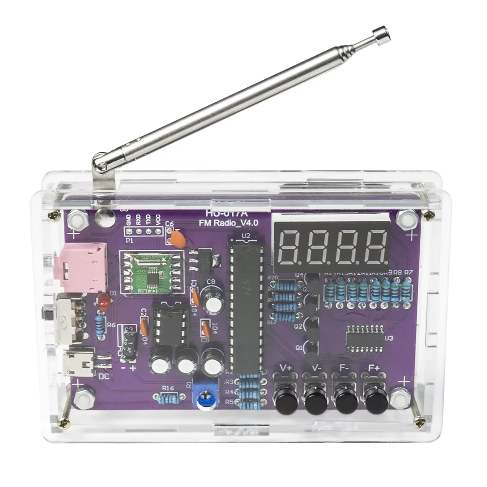

    What kind of soldering kit for a beginner? The HU-017A kit shown here costs just under a dozen zloty, and you can get it even cheaper in a promotion. It allows you to build a simple FM radio based on a ready-made RDA5807S module, a microcontroller with a 7-segment display for tuning and a TDA2822M audio amplifier. A slightly more expensive version with an enclosure is also available.

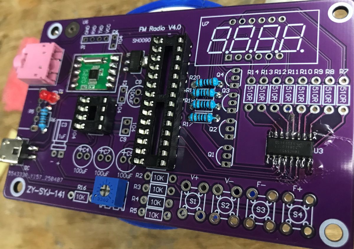

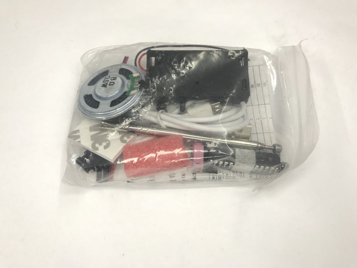

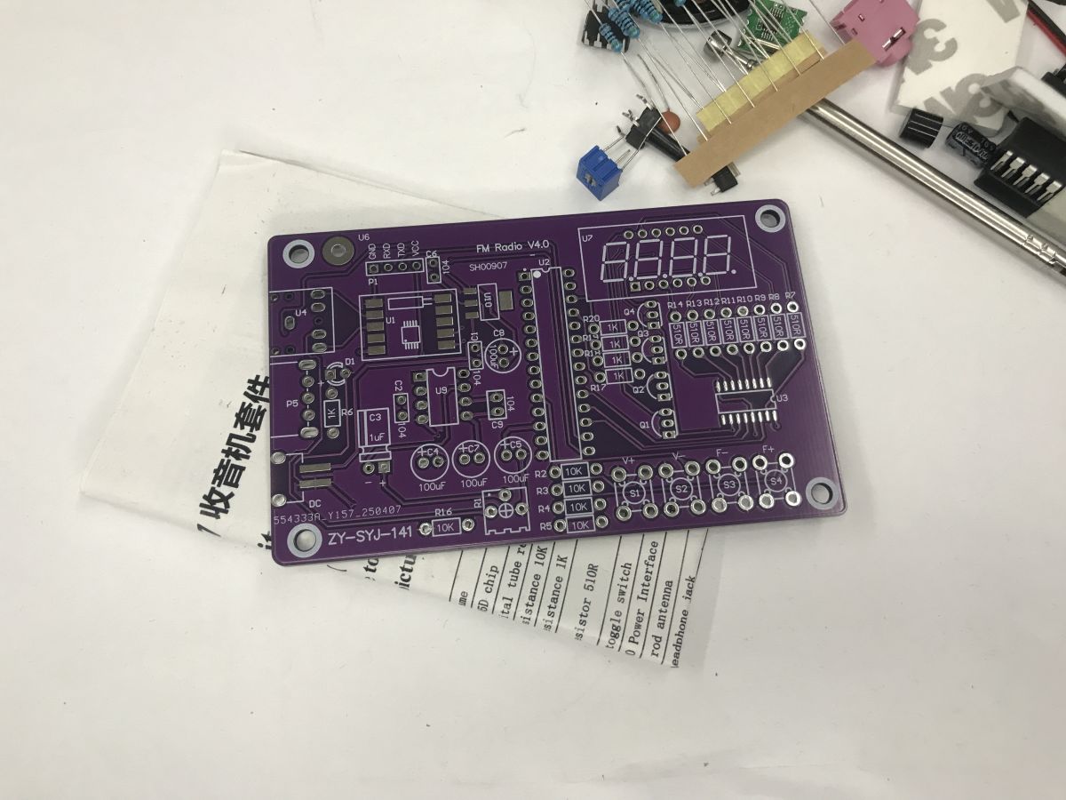

    Let's start with the contents of the kit. I got mine in a promotion, I paid about 10 PLN. Let's see what's inside:
    How many radios are in a radio? FM 87-108 MHz RDA5807S do-it-yourself kit

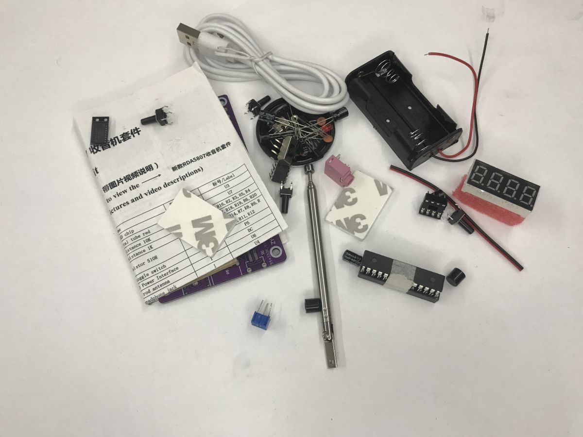

    Loudspeaker and antenna you know, components and board too, but they even gave a battery basket and USB cable. Not bad.
    The seller has thought of everything - there is even a bilingual manual. For this reason, I will shorten my argument a bit here, but will still present the assembly of this radio.
    How many radios are in a radio? FM 87-108 MHz RDA5807S do-it-yourself kit How many radios are in a radio? FM 87-108 MHz RDA5807S do-it-yourself kit
    I always start by wiping the tile with isopropanol. Any dirt or grease makes soldering difficult. Hygiene of the soldering iron tip is also important, but the board should not be forgotten either.

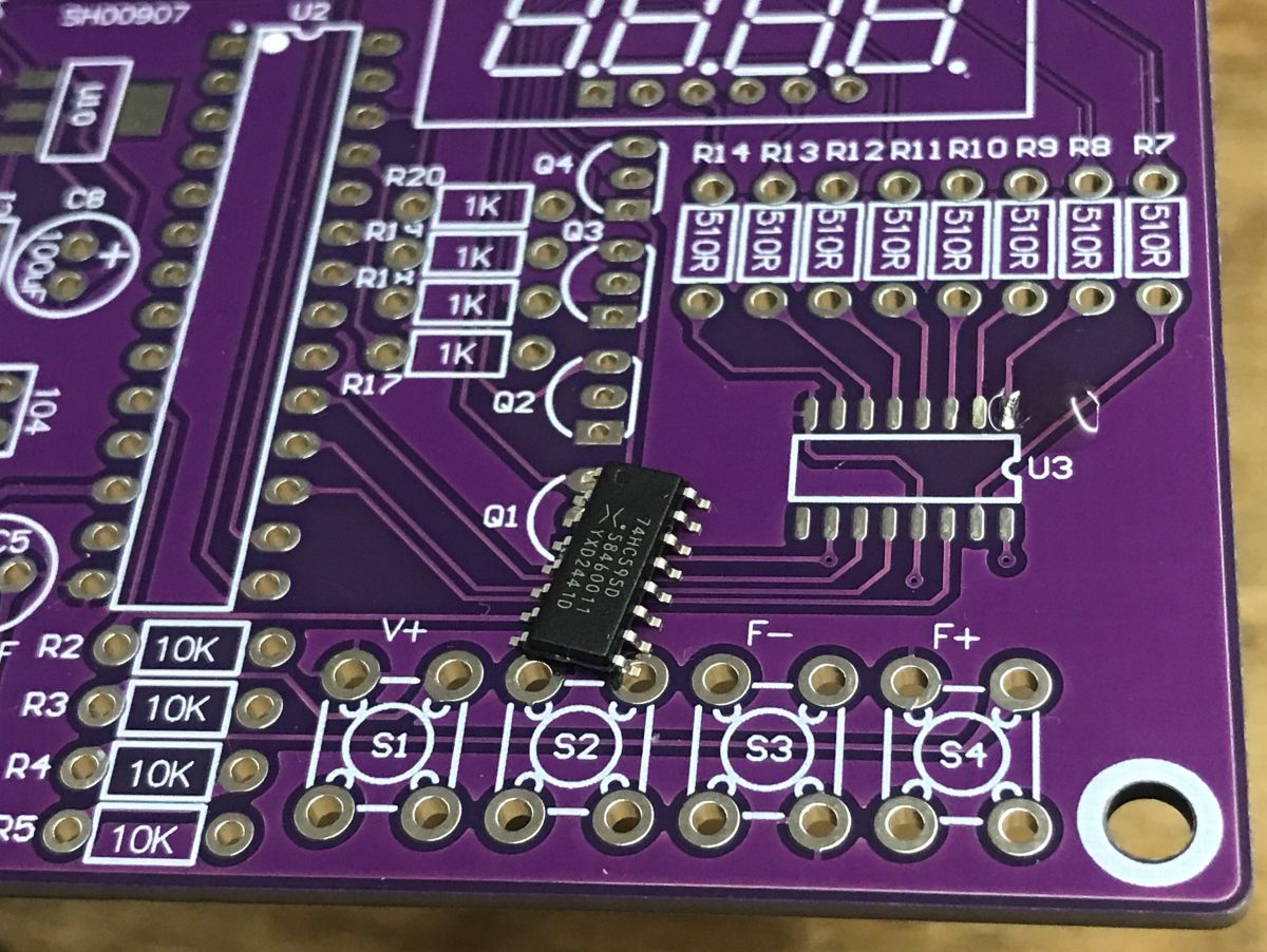

    Most of the components are assembled by threading, although there are a few sparse SMD parts. It's best to start with the tiniest circuits, then the soldered ones won't interfere so much with the assembly of the next ones.

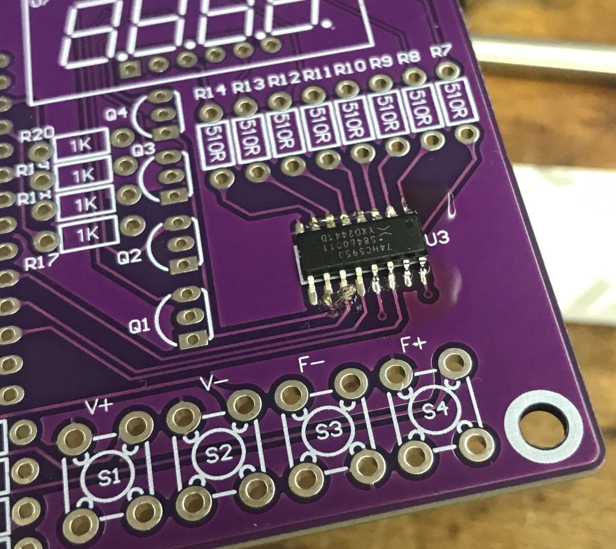

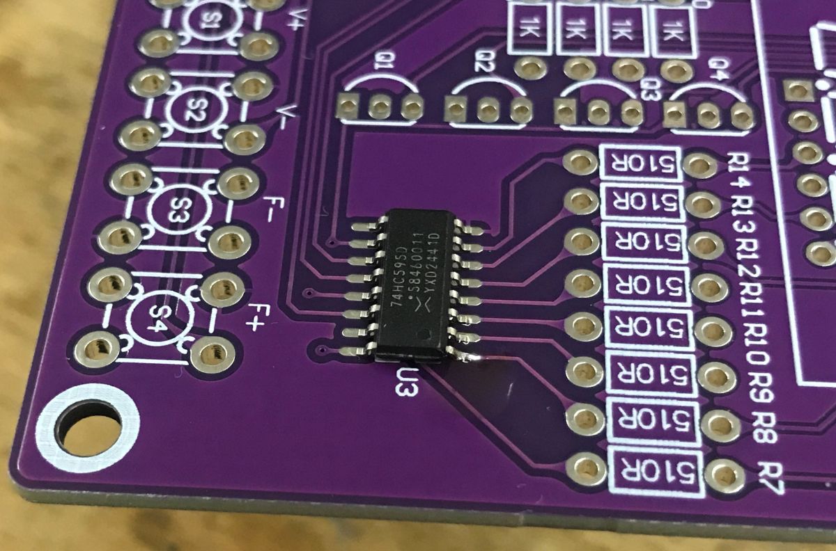

    The smallest is probably the 74HC595D sliding register. It allows you to control the display with fewer pins on the MCU side. I discussed it in a separate topic .
    It must be fitted according to the marking of the first pin (dot/cut). My method of soldering is to apply solder (and always a little flux - for convenience) to one pad, then "grab" the chip by one leg, and solder the others. It is important to heat the pad and apply the binder to it - not directly to the soldering tip.

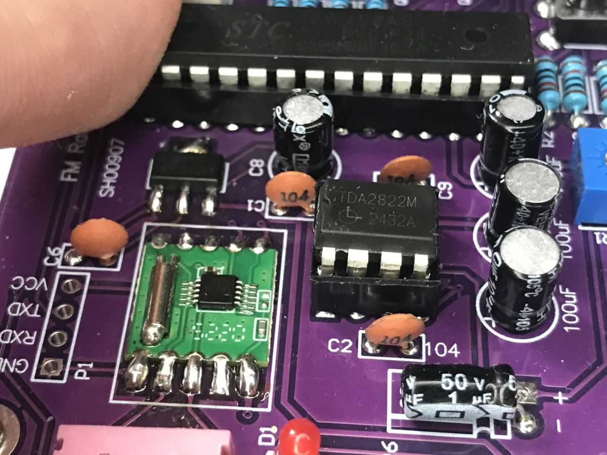

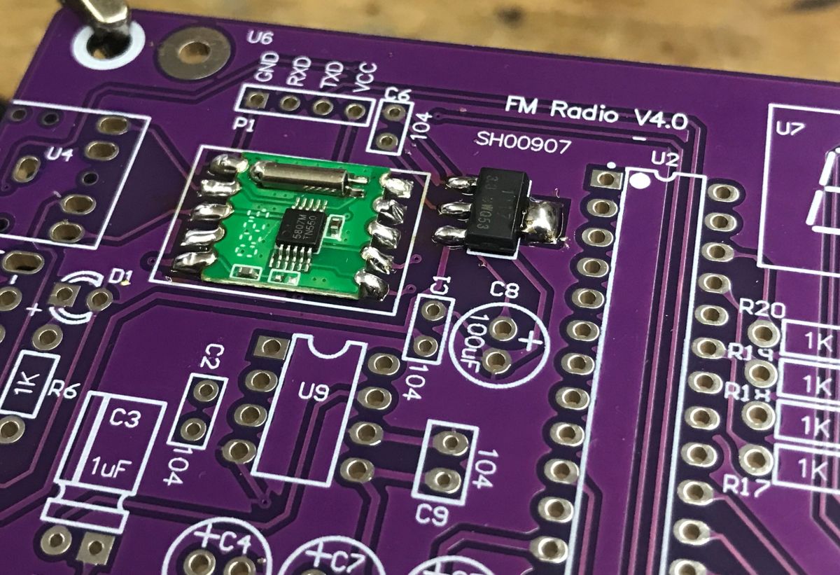

    The second thing that needs to be soldered initially is the radio.... or rather the radio module - the RDA5807S. This is the one that receives the radio signals and converts them to audio output, tuning is done digitally via I2C protocol from the microcontroller. Here I have a similar method and again, care must be taken to ensure the correct orientation, you can't solder 180 degrees inverted.
    Right next to it you need to solder the LDO that supplies it with 3.3 V, taking 5 V as input. It is also important to have good contact between the component and the large pad, which acts as a heat sink, although in this particular case there is not much heating.

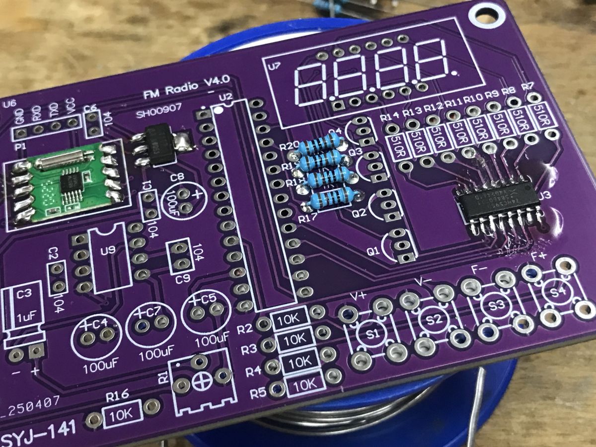

    Then one by one - the resistors. You just have to verify them with either a barcode or a multimeter. You can't get the values wrong, here we have two different ones, 10kΩ and 510Ω.

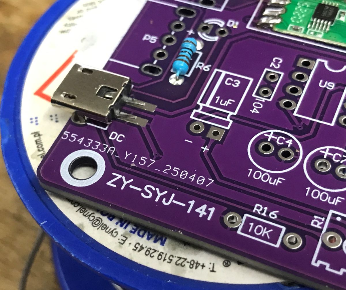

    Of the SMD components, there is still the USB socket, or rather, its contacts are surface-mounted and the legs are threaded.

    With electrolytic capacitors and transistors you also need to take care of polarity.
    How many radios are in a radio? FM 87-108 MHz RDA5807S do-it-yourself kit Purple FM radio PCB with soldered components and footprint for a 4-digit 7-segment display Assembled FM Radio V4.0 PCB with 4-digit 7-segment display, buttons, and USB connectors

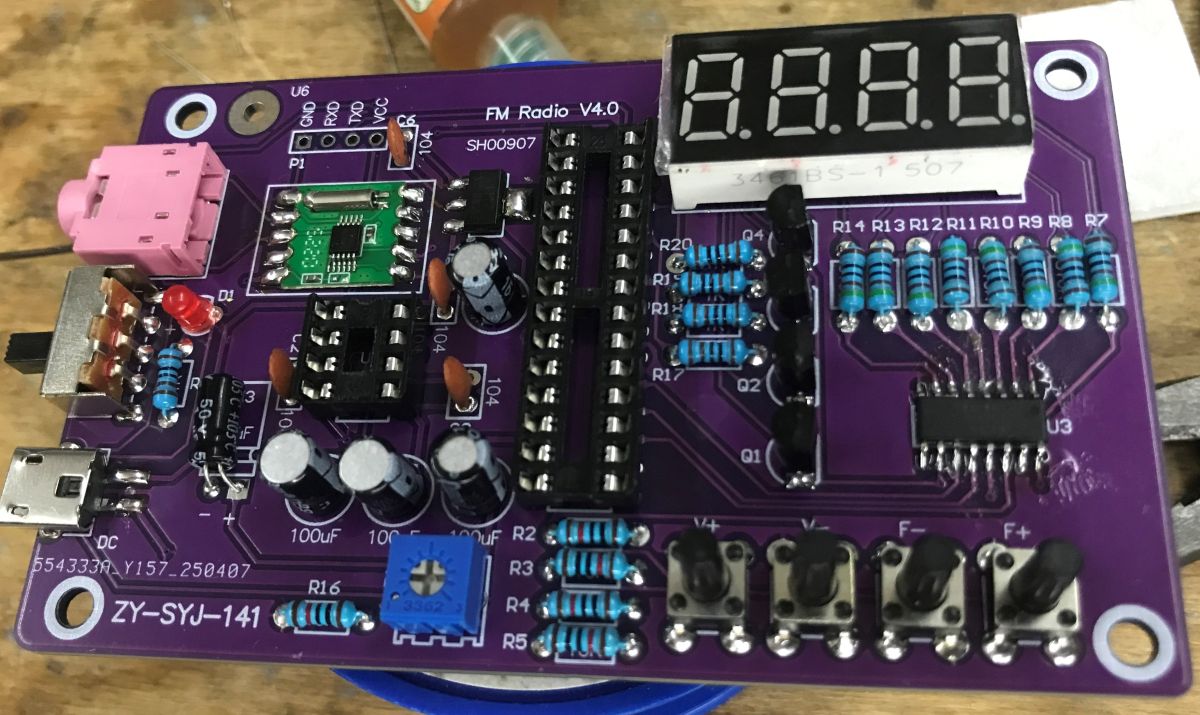

    Finally I also solder the bases, here again taking care of the orientation, although for the base itself it is a purely cosmetic matter, however a reverse soldered base would be misleading. Then I dogleg the legs of the components (MCU and amplifier) and put them in the bases.
    Close-up of a purple PCB with an FM tuner module, TDA2822M IC, and several electrolytic capacitors

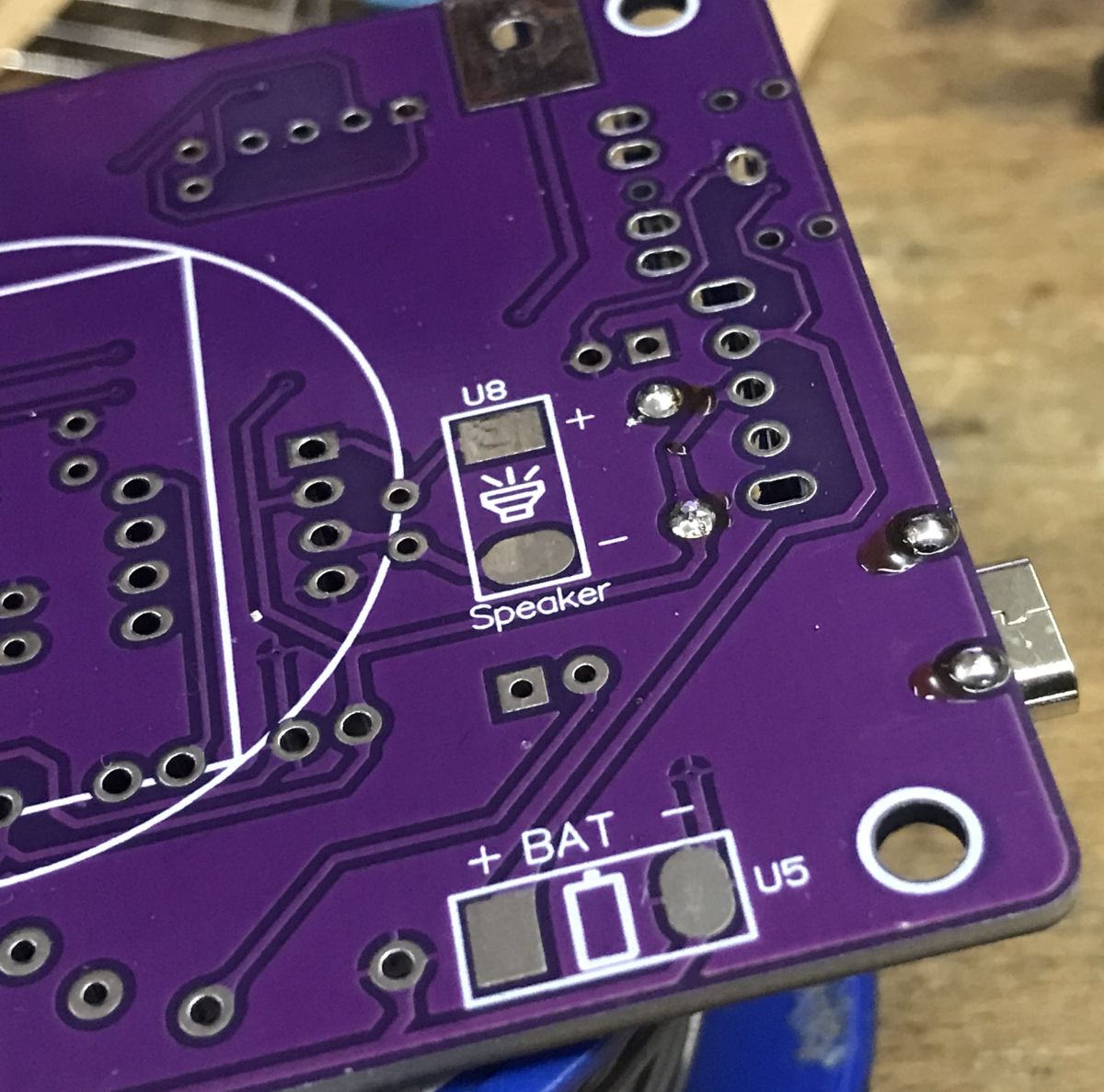

    Still remains to solder the speaker (I take the wires, pads and solder), mount the antenna and it's time for the final verification of the solders and connections. Just for the record - the radio works straight away.

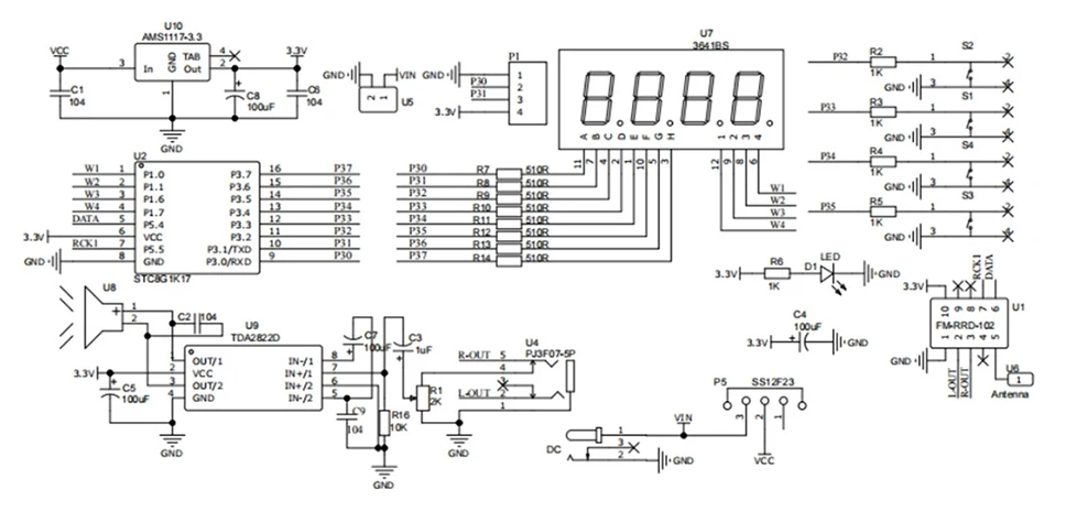

    Finally, we will quote the schematic of the radio (almost - because in the topic there is a version with a register and here without):
    Schematic diagram of a simple FM radio with microcontroller, 7-segment display, and audio amplifier
    The radio from the HU-017A kit consists of several simple functional blocks. The power supplied from the USB or DC socket is stepped down and stabilised by the AMS1117-3.3, which provides 3.3 V for the electronics. The main controller of the unit is the STC8K17 microcontroller, which operates the buttons, display and communication with the FM tuner. Station reception is performed by the RDA5807S module, which receives the signal from the antenna and, via the I2C bus, is tuned by the microcontroller. The current frequency is displayed on a four-digit 7-segment display controlled by a 74HC595 shift register. The audio signal from the tuner goes to the volume control potentiometer and then to the TDA2822 amplifier, which drives the speaker. Pushbuttons allow you to change the frequency and control the radio, and an LED indicates power to the unit.

    I see an opportunity to improve this receiver somewhat. On the headphone socket, pins 3 and 4 could be connected. This would allow stereo listening on the headphones and full mono on the speaker (the socket pins would connect both channels).
    As for building my own radios, in my youth I went through all of them from the booklet: 'The Simplest Radio Receivers' by Wiktor Chojnacki.
  • Passive resistive combiner needed for mono output

    >>21898310 I also noticed that the mono speaker is only the right channel. But channel summing is not done by shorting the outputs! Has the colleague checked the datasheet of the circuit? After all, these are outputs suitable for 32-ohm headphones, what output impedance can there be, especially compared to a 2 kΩ potentiometer? This can be done on a passive resistive combiner (lossy of course).
    A'speaking of just the schematic. I don't think it's very educational (and this is, among other things, the role of the set) that the signal counting from the left goes into the speaker, and from the right goes out into the ether through the antenna. And it is not a transmitter ;-) I guess that such was supplied by the manufacturer, and maybe the general rules of drawing are different in slant-eyed people. However, with us it has become accepted that in diagrams the signal flow is generally from left to right. Other than that, galvanically, in terms of connections etc, it seems correct ;-)
