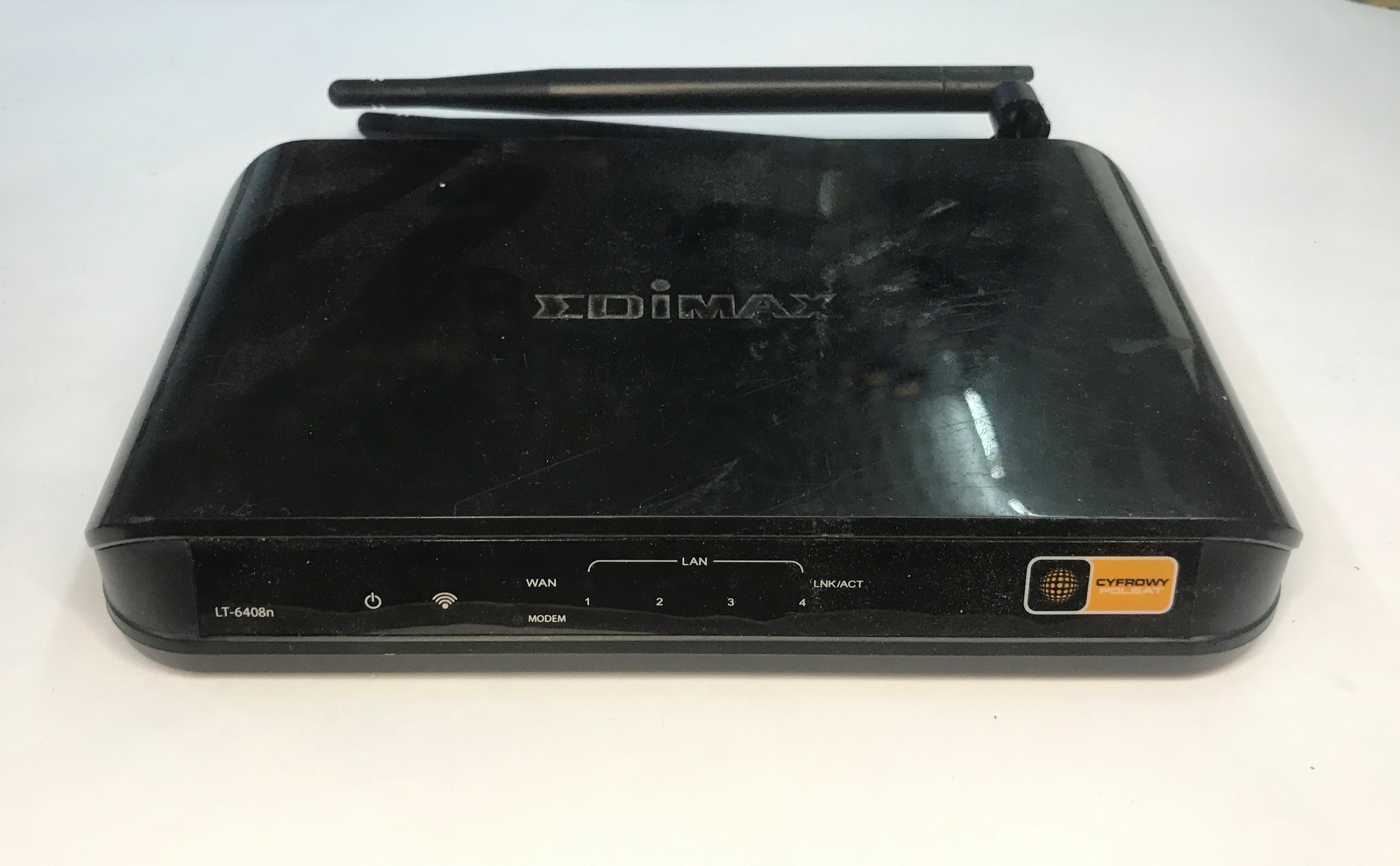

This time we take a look inside the Cyfrowy Polsat LT-6408n router. This is actually a model manufactured by Edimax and sold to the operator as the Edimax LT-6408n with its branding. The router was primarily developed to share internet from LTE or HSPA+ modems connected via USB.
The whole thing works with a 5 V power supply, which is typical of slightly newer hardware already. The bottom sticker shows the default IP, name and administrative password. The FCC ID of the device is NDD9564081112.
On the back we have an On/Off button, WPS/Reset, four LAN ports, one WAN port, a power supply input (DC Jack) and a USB port, this is often used to connect the aforementioned LTE/4G modem (Huawei E3372s-153 as an example).
