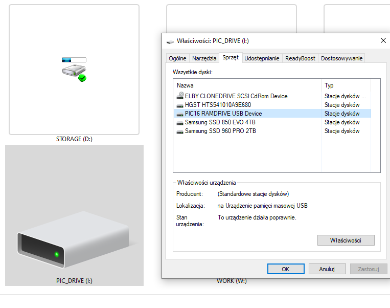

    This is what the data carrier looks like in "This Computer":
    The simplest (type in) password manager with USB configuration like a memory stick

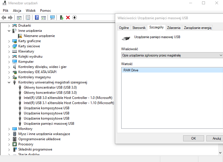

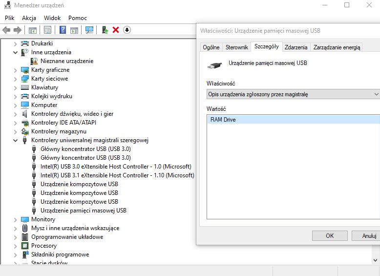

    This is how it looks in the device manager:
    Windows Device Manager screenshot with “USB Mass Storage Device” properties showing value “RAM Drive”.

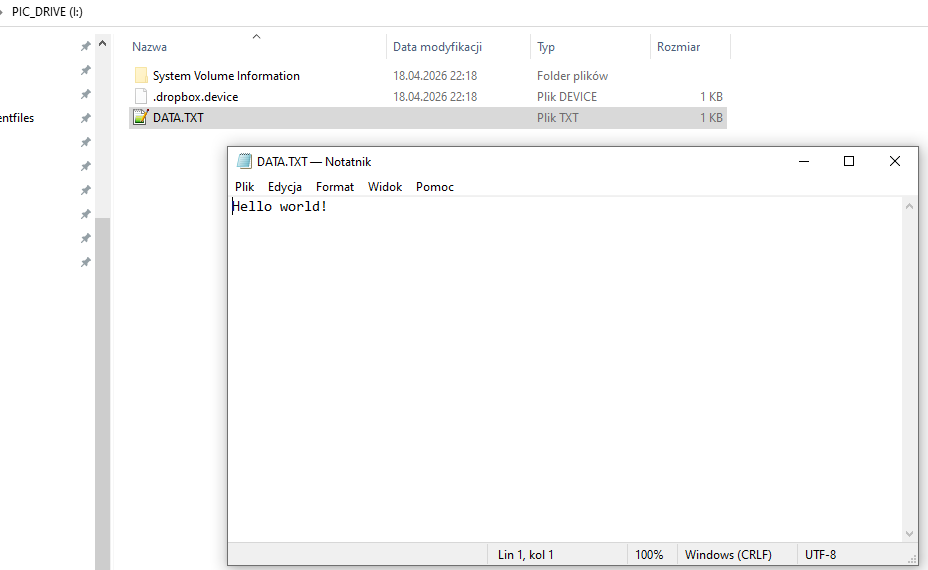

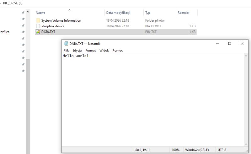

    Yes when opened in Windows Explorer (interesting fact: this file from Dropbox and the system folder do not physically exist in my file table):
    Windows File Explorer showing PIC_DRIVE and DATA.TXT opened in Notepad with “Hello world!”

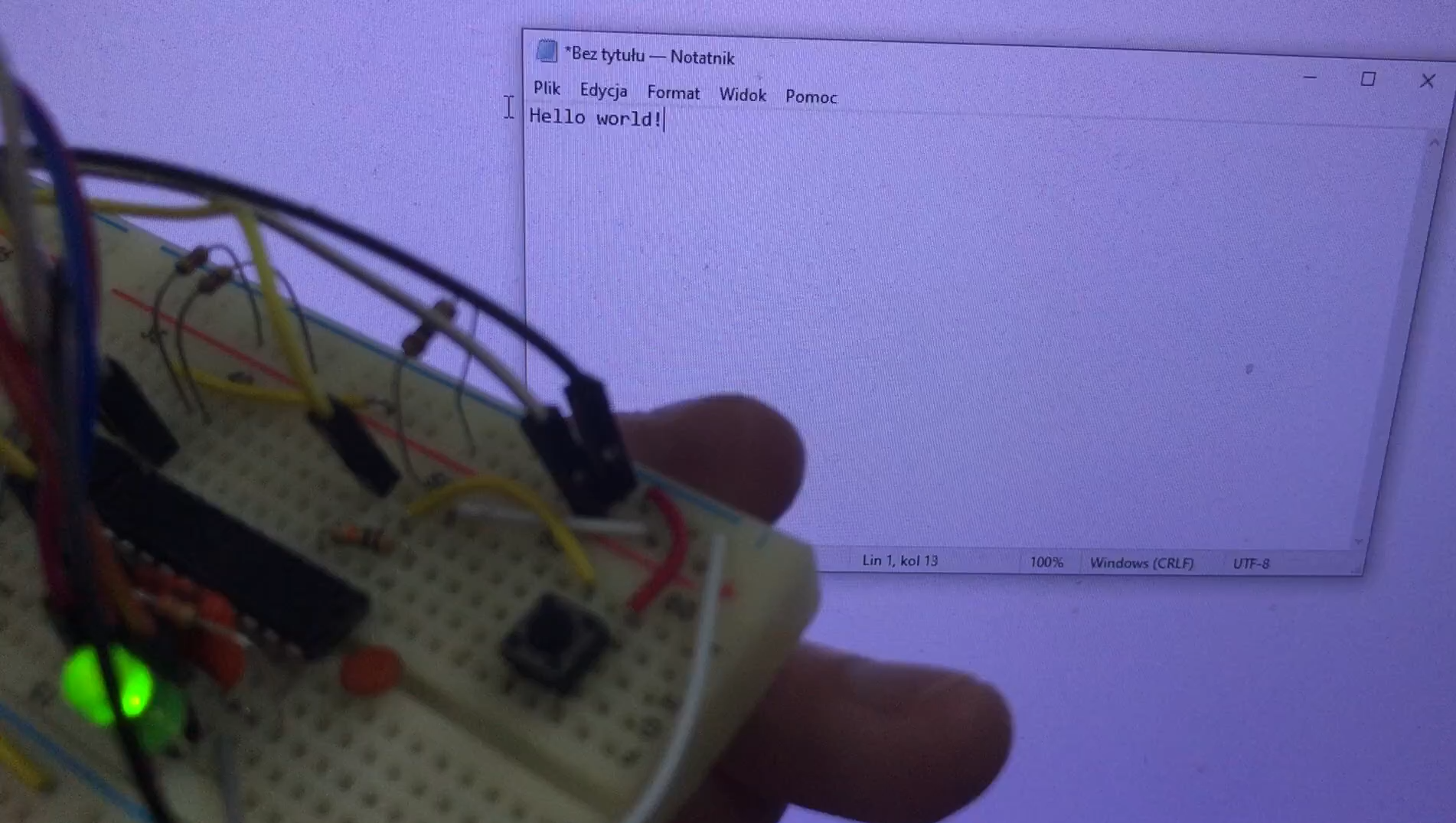

    This is how the device works in practice - the video shows the button being pressed, the LED flashing and the text being entered:
    ... and that intrusive window from Dropbox after typing in text is a good illustration of the device reverting to storage media mode.
