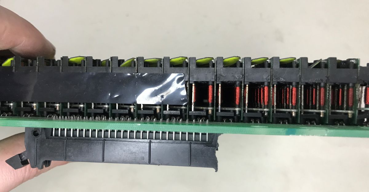

An electromagnetic display, often referred to as a ‘flip-dot display’, as the English name suggests, consists of two-colour flip-dots that are rotated by electromagnets. Each flip-dot has two sides in different colours (usually yellow and black), and its position is changed by a short current pulse applied to the coil. After such a pulse, the dot remains in the set position even after the power is switched off, which means very low power consumption – current is only required when the displayed information is changing. This entire process is accompanied by a characteristic mechanical ‘clicking’ sound.

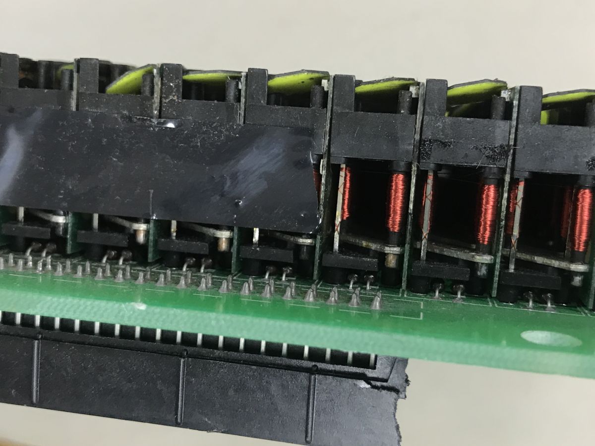

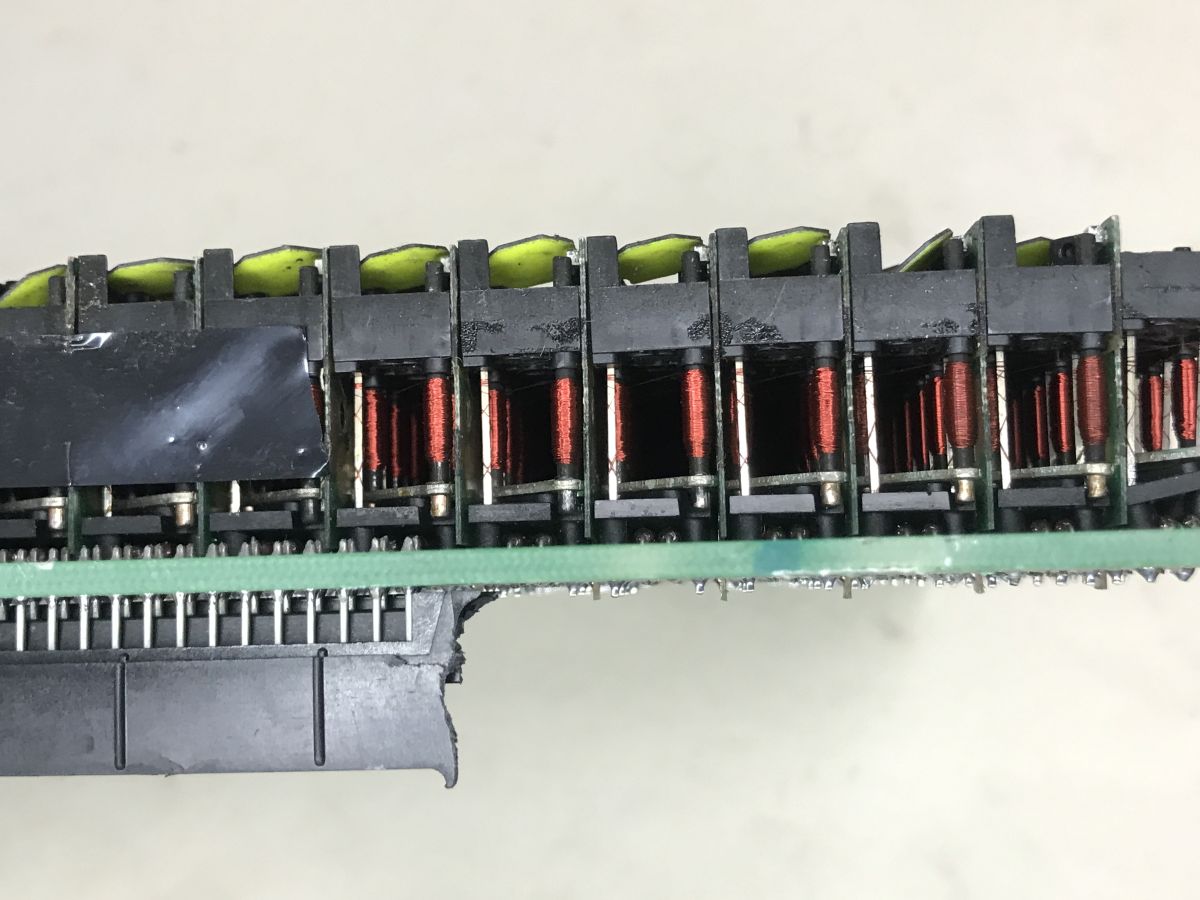

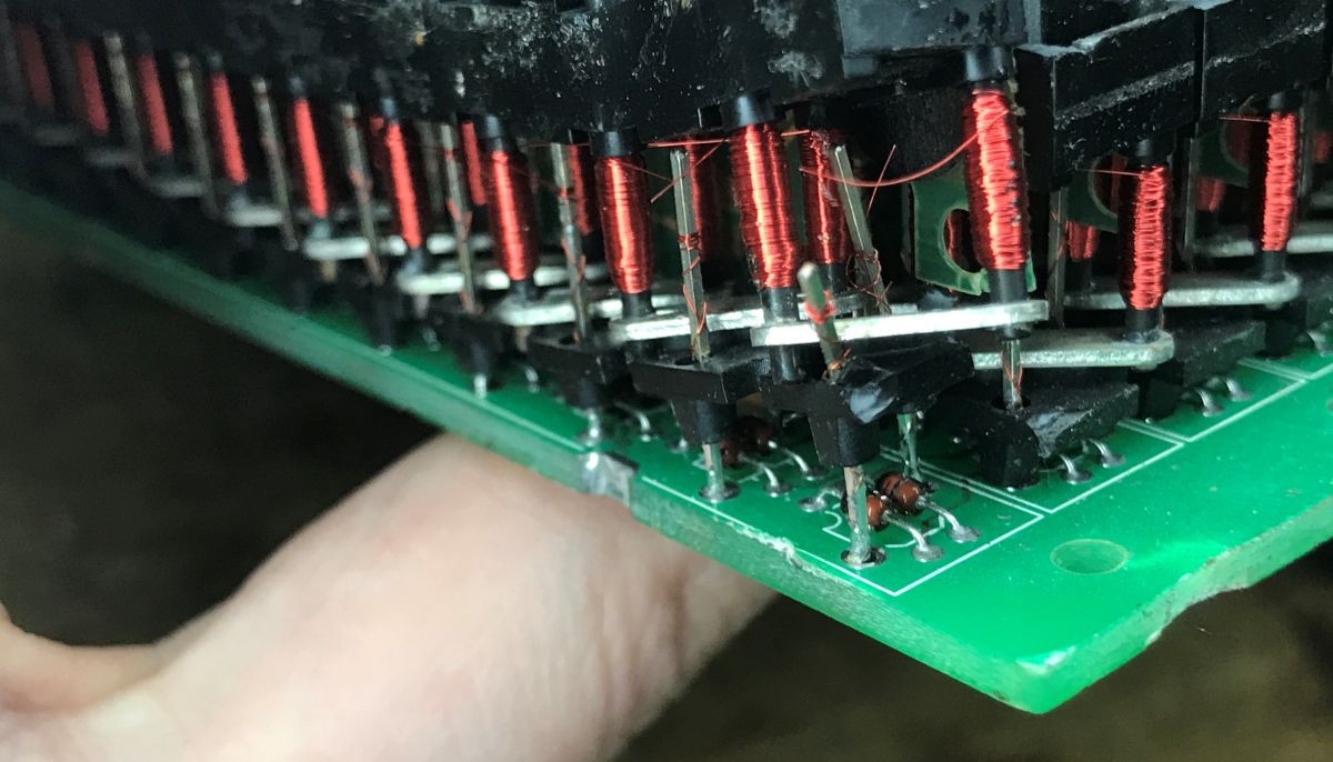

My unit was already damaged and came from a scrap heap, so I decided on a slightly more destructive demonstration and also took a look right underneath the coils.

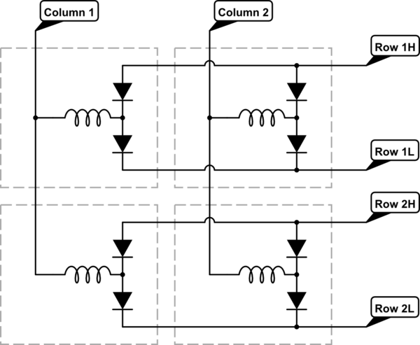

You can see two diodes there, which enable matrix-style polarisation control and simplify the matrix wiring. This makes it possible to address points in the array by rows and columns without running separate wires to each coil.
(schematic source: https://electronics.stackexchange.com/questio...is-the-purpose-of-diodes-in-flip-dot-displays )

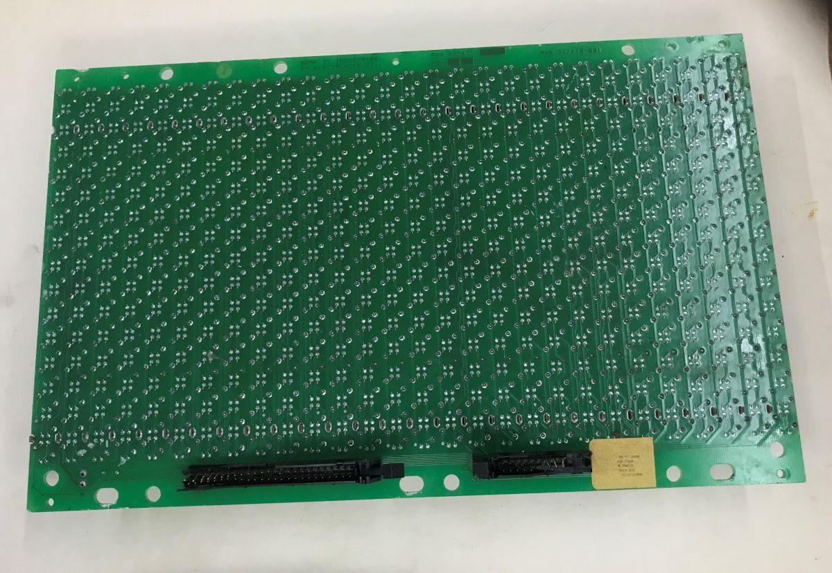

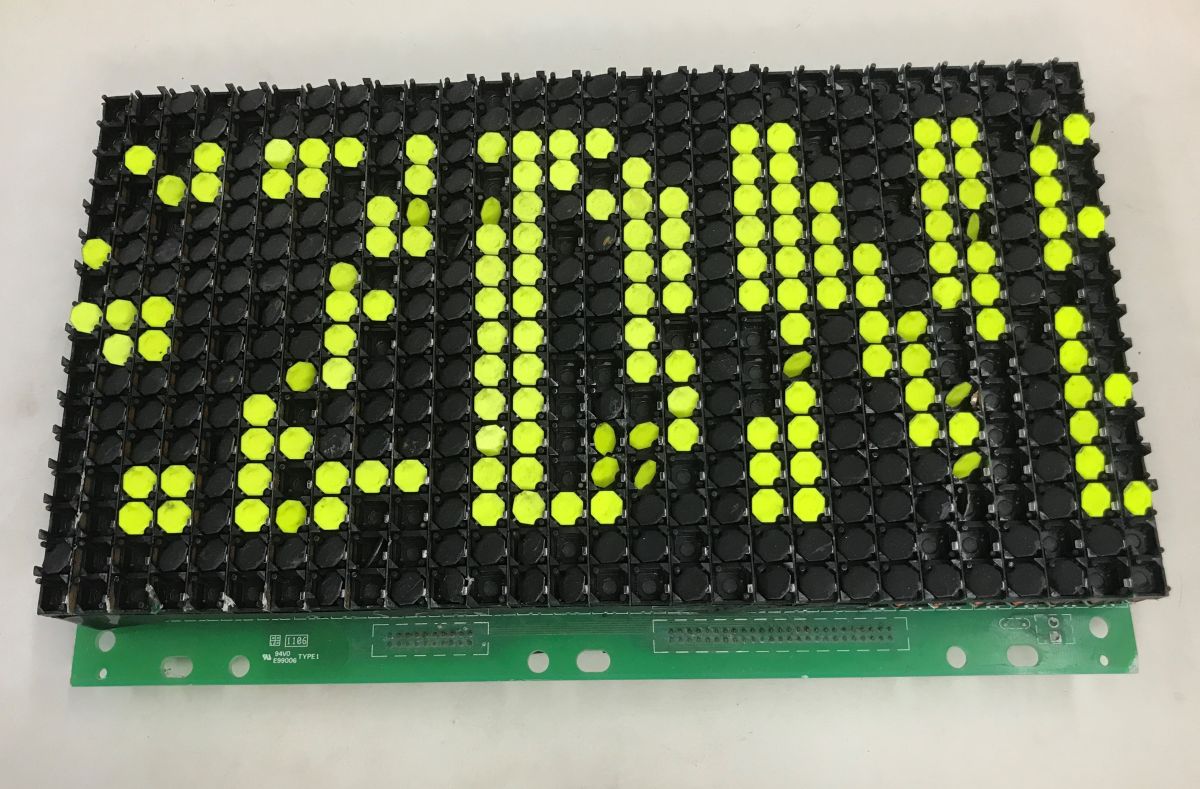

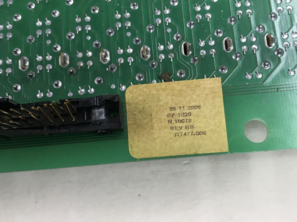

To sum up , this was a rather old flip-dot display salvaged from a scrap heap. It arrived in such a poor condition that I simply decided it wasn’t worth trying to get it working. You can’t see it very well in the photos, but many of the dots are missing, and the connectors are also in need of replacement. The unit itself appears to be quite old; the date on the sticker reads 05.11.2006, meaning it’s nearly 20 years old. Judging by the display’s condition when I received it, this is likely just one of at least several segments. And here’s the mystery – what on earth could this display have been showing in the first photo? I don’t really have any specific ideas about that…

So it might have been tram equipment or minibuses – that fits too. [Read more]

Could you explain in more detail exactly how it works mechanically? Where is the axis of rotation and where are the spring components? [Read more]
You can sort of see this in the first photo, right at the start. There are no spring-loaded components there, and the axis of rotation runs through the centre of each flap (dividing it in half). Another... [Read more]

So I’m assuming that the electromagnet is situated slightly further away than halfway along the magnetic flap (relative to the axis of rotation)? [Read more]
In the case of those shown above, the electromagnet is U-shaped (the winding is divided into two poles, and the magnetic field is enclosed by a magnetic flap). In the Polish patent, there was a single... [Read more]
