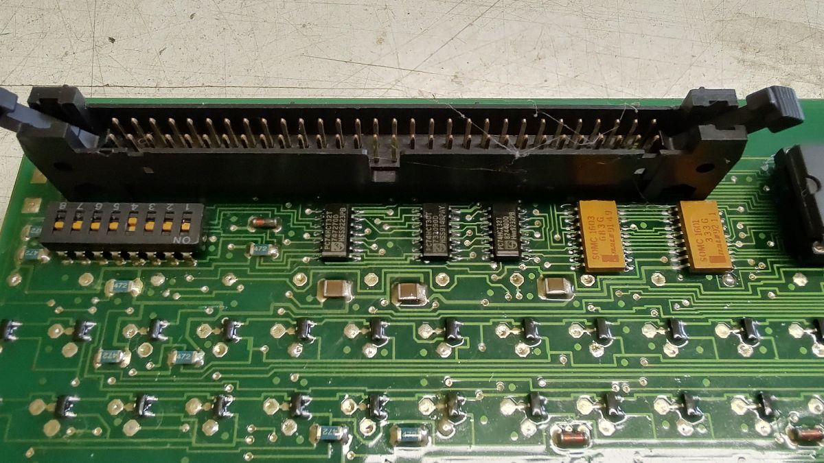

    Green PCB with dense grid of solder points and two black connectors along the bottom edge Close-up of a green PCB with many solder points, a pin connector, and a label dated 05.11.2006 Close-up of a green PCB with solder joints; text reads “MARK IV INDUSTRIES FP ELECTRONICS DIV.”

    My unit was already damaged and came from a scrap heap, so I decided on a slightly more destructive demonstration and also took a look right underneath the coils.

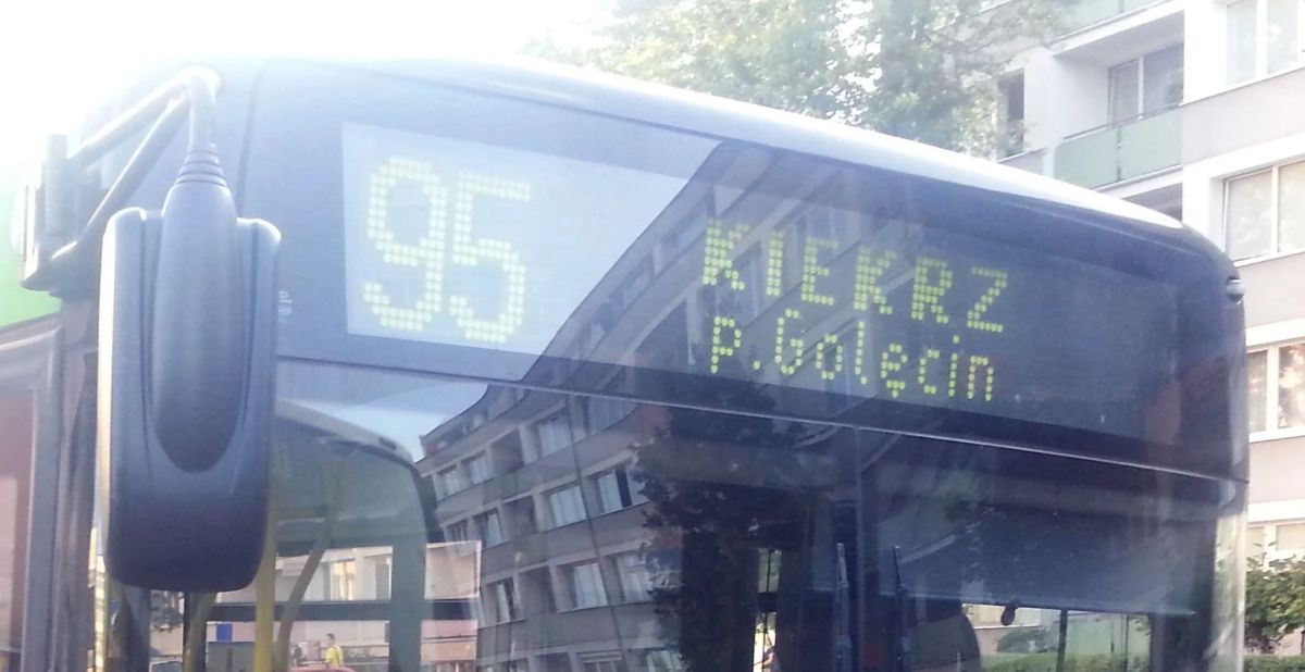

    In the 1990s, I worked for a company that specialised in this type of ‘display’. The company manufactured boards and clocks based on its own ‘dots’ – patented in Poland – which operated on a similar principle, as well as on those shown above, which were imported from abroad (I can’t remember which country now; some Western patent). A pixel operates in two states; without a control signal, it remains in one of two stable positions. Each pixel consists of an electromagnet and a magnetic flap. Without a control signal, the flap remains attracted to the core by the force of the permanent magnet itself. If we induce a magnetic field in the core with the opposite polarity and stronger than the field of the flap’s magnet, the flap will be flipped into the opposite stable position. Excitation of the core is only required at the moment the flap flips. There are no ‘springs’ involved.
    Single-digit displays and seven-segment displays were manufactured. Clocks, sports scoreboards, information boards for railways and public transport, etc., were produced.
    Example of a display on a bus How does an electromagnetic (flip-flop) display work? Presentation, working principle and riddle

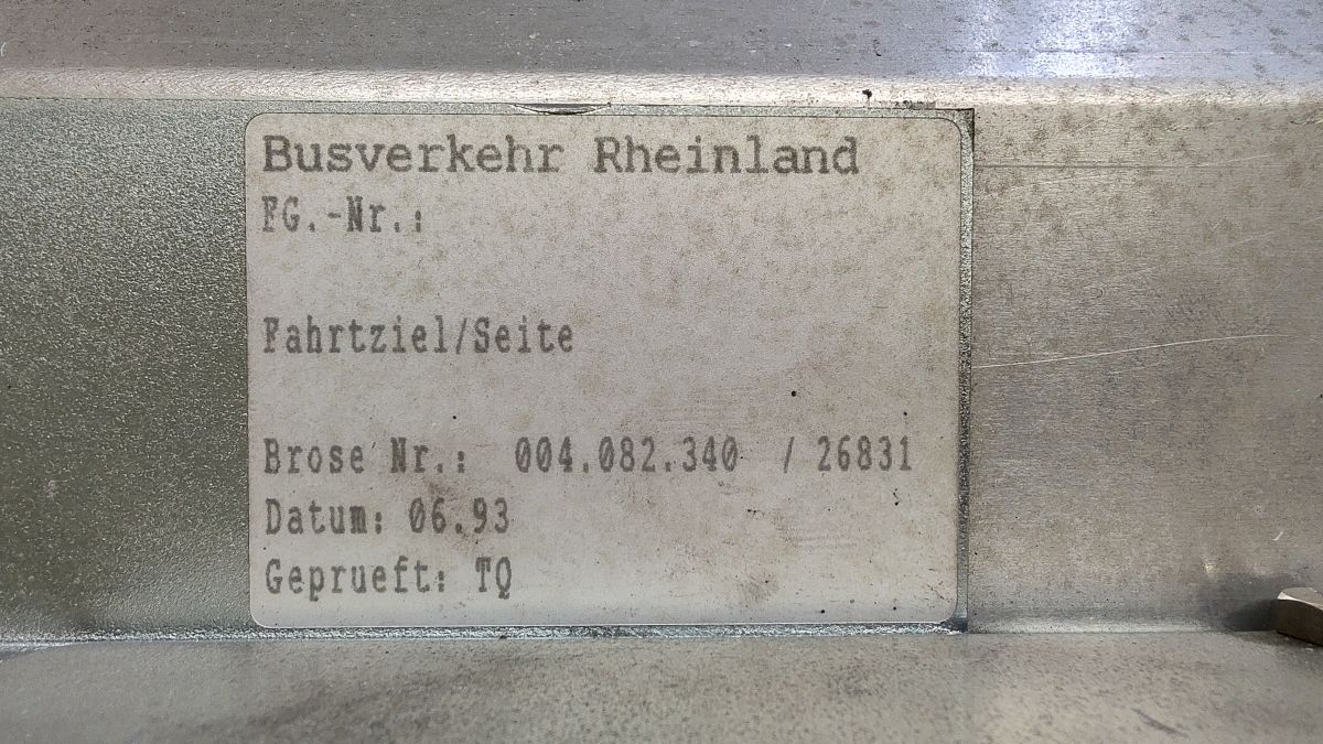

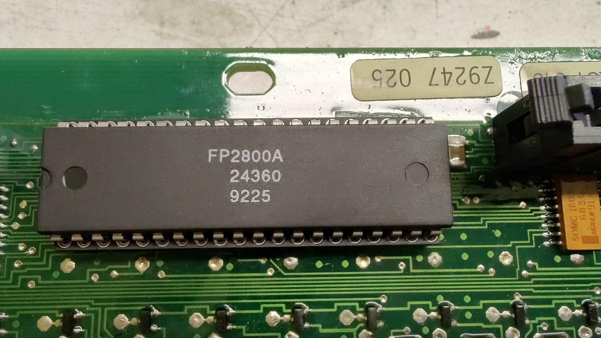

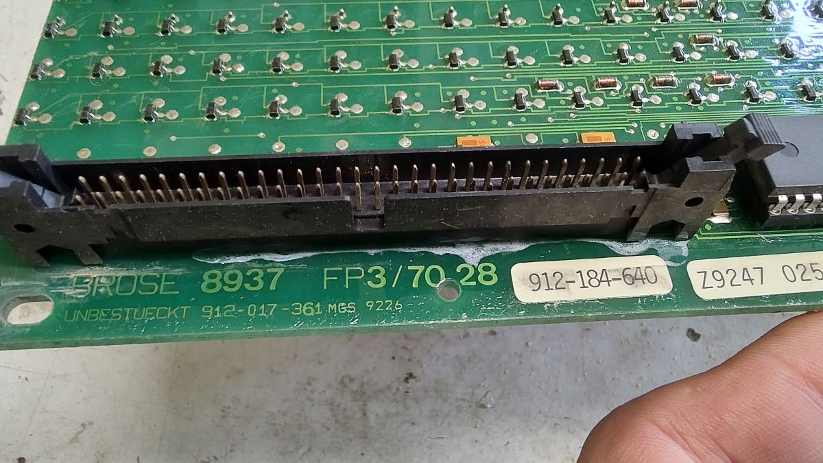

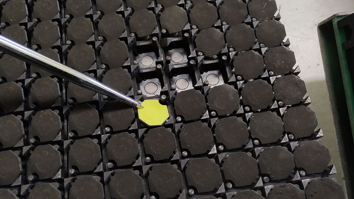

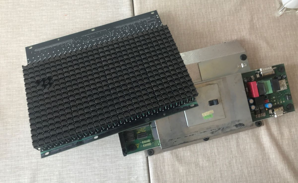

    I have a nice set (4 display modules) from a bus that was bought by a driving school, and I’ve replaced the display with an LED one.
    Each pixel on the display has a fixed position on the black side; the yellow is temporary and requires a continuous power supply.

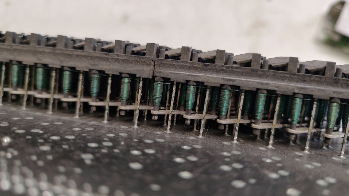

    A few additional photos showing details of the display:
    How does an electromagnetic (flip-flop) display work? Presentation, working principle and riddle How does an electromagnetic (flip-flop) display work? Presentation, working principle and riddle How does an electromagnetic (flip-flop) display work? Presentation, working principle and riddle How does an electromagnetic (flip-flop) display work? Presentation, working principle and riddle

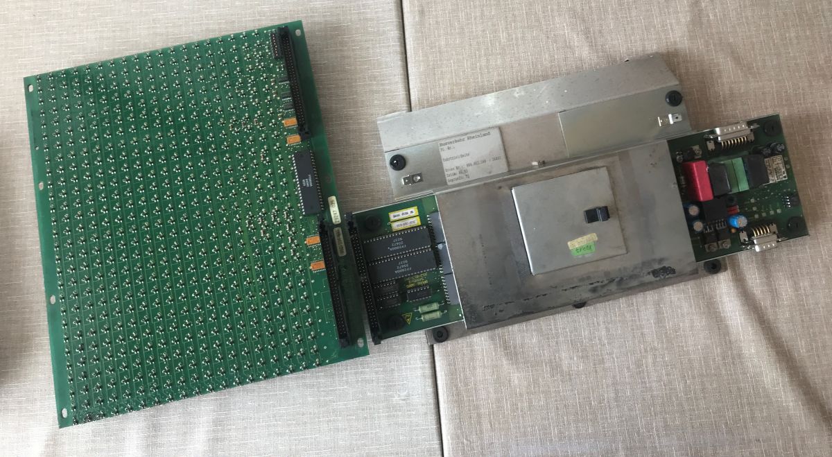

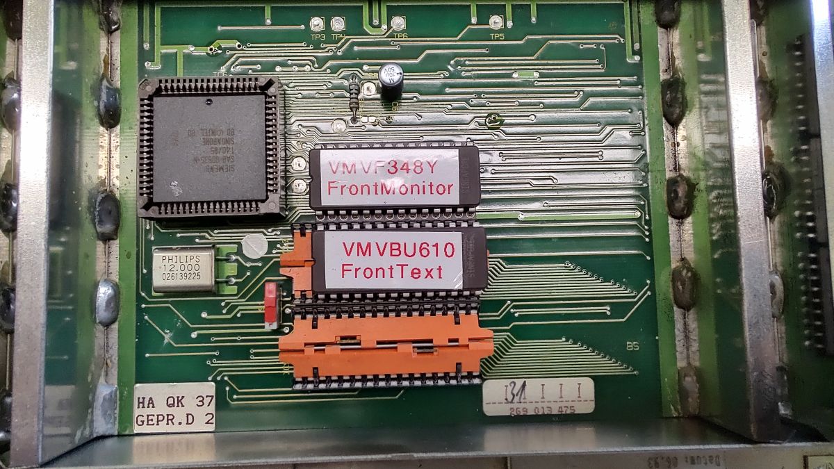

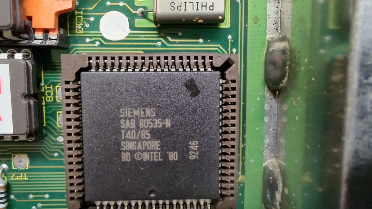

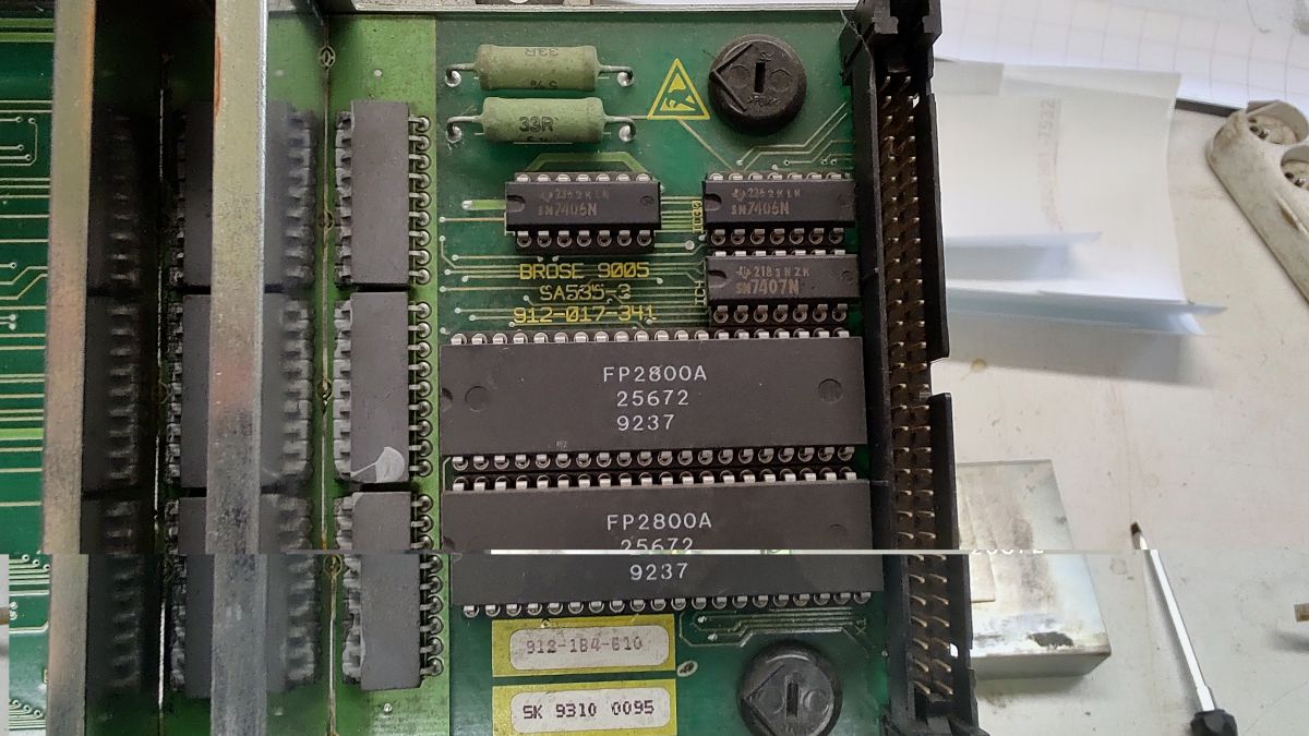

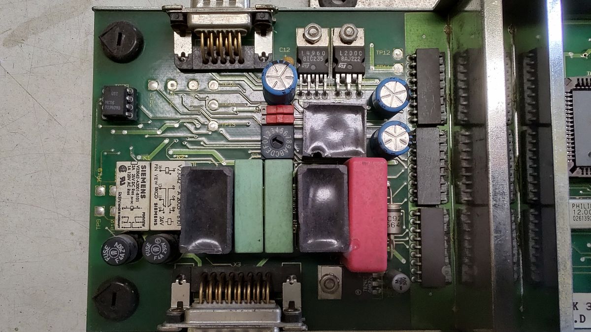

    Photos of the main controller:
    How does an electromagnetic (flip-flop) display work? Presentation, working principle and riddle How does an electromagnetic (flip-flop) display work? Presentation, working principle and riddle How does an electromagnetic (flip-flop) display work? Presentation, working principle and riddle Close-up of a Siemens SAB 80C535-N chip on a green PCB Close-up of a PCB with ICs and an edge connector, including FP2800A chips
    Unfortunately, I don’t have the control panel used to change the content. The first photo in my post shows the main controller with the central section covered; the metal plate covering this section has a flap, providing access to the memory chips with descriptions on the attached labels.

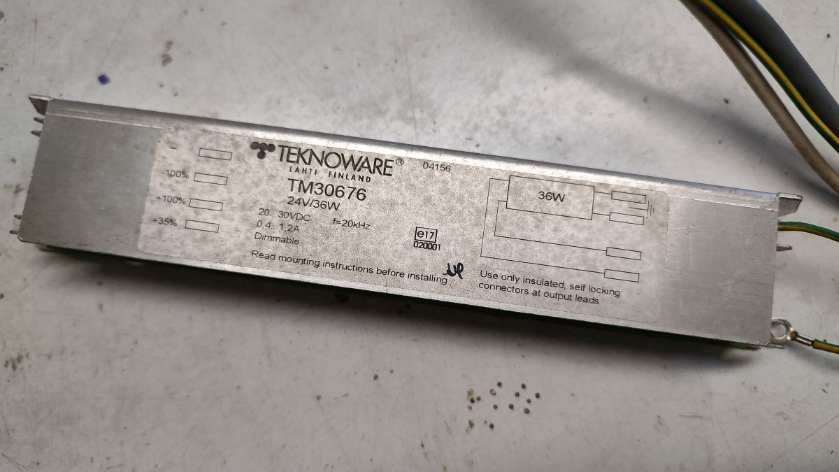

    The set also includes a 36W fluorescent lamp power supply, which is, of course, used to light the display:
    Teknoware TM30676 24V/36W metal ballast on a work surface, with label text and attached wires.
    I’ve never actually tried to get the whole thing up and running; I haven’t connected anything to the mains and I’ve no idea whether it’s all in working order. I’d planned to build my own control system and get a clock running on a single panel, but unfortunately I’ve found myself short of time for such things, and as a result it’s all been sitting around waiting for a few years now.
    So here’s a request for my friend @p.kaczmarek2: if you fancy it and have the time to power it up, analyse the whole thing, have a look at the memory and so on, do let me know via private message – I can send you one panel along with the controller and wiring.

    a_noob wrote:
    Each pixel in the display has a fixed position on the black side; the yellow is temporary and requires a continuous power supply.
    Bear in mind that they may operate on the principle of core remanence, meaning they retain their last set state even without power (I’m not sure for how long). In any case, I haven’t yet seen any with just one stable state – the fact that they don’t need to be constantly powered is one of their greatest advantages.

    exlibris71 wrote:
    Bear in mind that they may operate on the principle of core remanence, meaning they retain their last-set state even when powered off (I’m not sure for how long). In any case, I haven’t yet seen any with just one stable state – the fact that they don’t need to be constantly powered is one of their biggest advantages.
    Actually, my mistake – after switching, it stays in the second state. I hadn’t checked anything on the subject; I just wrote what I thought. Apparently, all the ones I have were ‘reset’ before the last time I switched them off, which is why they’re on the black side. It’s cleverer than I thought ;)

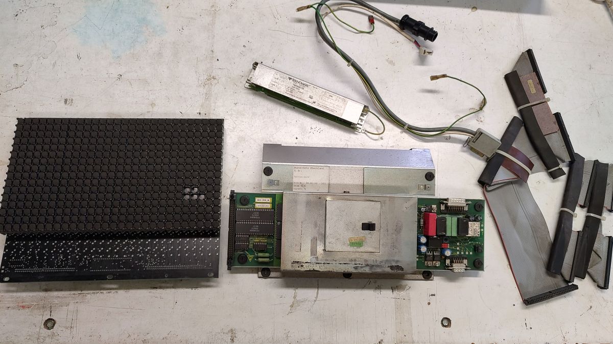

    I forgot to post an update here earlier, but the parcel from @a_noob has arrived – thank you very much. I’ve also got the cable. I haven’t done anything else with it yet, but I’ll try to post an analysis of the circuit board in a separate thread.
    Does anyone know any more about how it was controlled – in terms of the protocol used, etc.?

Where else are flip-dot displays commonly found besides railway stations, and what kinds of systems used them?
The thread places them in vehicles as well as station infrastructure. One commenter says he encountered controllers for such displays in Scania 113CLL units, which shows they were used in transport information systems beyond fixed railway boards. Another commenter mentions a current manufacturer building large boards and animations, suggesting use in display installations as well as traditional passenger-information hardware. [#21916110]
What did factory controllers for older flip-dot displays typically use, such as Intel 8049 or FP2800A-based driver boards?
Older factory controllers could use an Intel 8049 microcontroller with an FP2800A driver stage. One participant recalled exactly that combination from systems he had seen. The thread presents this as practical field knowledge rather than a full schematic, but it is the only concrete controller identification given. That makes 8049 plus FP2800A the best-supported answer for the older hardware discussed here. [#21916110]
How does a flip-dot display controller built around an 8049 compare with a more modern microcontroller solution for DIY control?
An 8049-based controller is the documented older solution in the thread, while a modern DIY controller is not described there. The practical comparison is simple: the original approach uses dedicated legacy control hardware, and the thread only confirms Intel 8049 plus FP2800A in older systems. For DIY, the author instead demonstrates direct bench-supply pulsing, which avoids needing the missing factory controller but also lacks automated scanning and normal service behavior. [#21916110]
What is the FP2800A, and what role does it play in driving electromagnetic display coils?
In this thread, the FP2800A is identified as the driver used with an Intel 8049 in older flip-dot controllers. "FP2800A" is a driver component category in this context that interfaces controller logic to electromagnetic display coils, and its key characteristic is handling the coil-driving stage rather than the high-level display logic. The post does not give pinout or electrical ratings, but it clearly assigns FP2800A a coil-driving role. [#21916110]
How do you recognize damaged flip-dot modules, such as missing dots or worn connectors, and what parts are usually worth replacing?
You recognize damage by missing dots, poor connectors, and incomplete segmentation. The author says his unit was missing many dots and that the connectors were suitable only for replacement. He also judged the module too poor to restore further, even for testing beyond a destructive presentation. In a scrap unit like this, connectors are the clearest replaceable part named explicitly in the thread. [#21915830]
