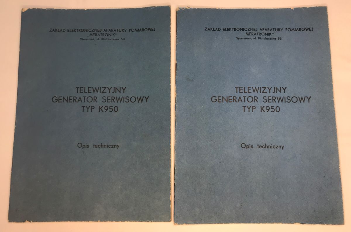

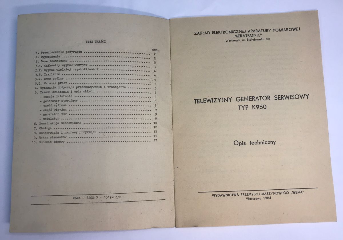

    Let’s start, however, as one should in theory – with the manual. From my own experience, I know that many people aren’t patient enough and tend to dive straight into the equipment, but really, it’s worth knowing what you’re doing, and the manual shown here is a world away from what you get with modern products. Actually, it should be in the plural here – yes, there are two copies of the Technical Description. Those were the days when you could simply search online for...
    Retro unboxing – K950-type television test signal generator – 1985, interior, schematic diagram

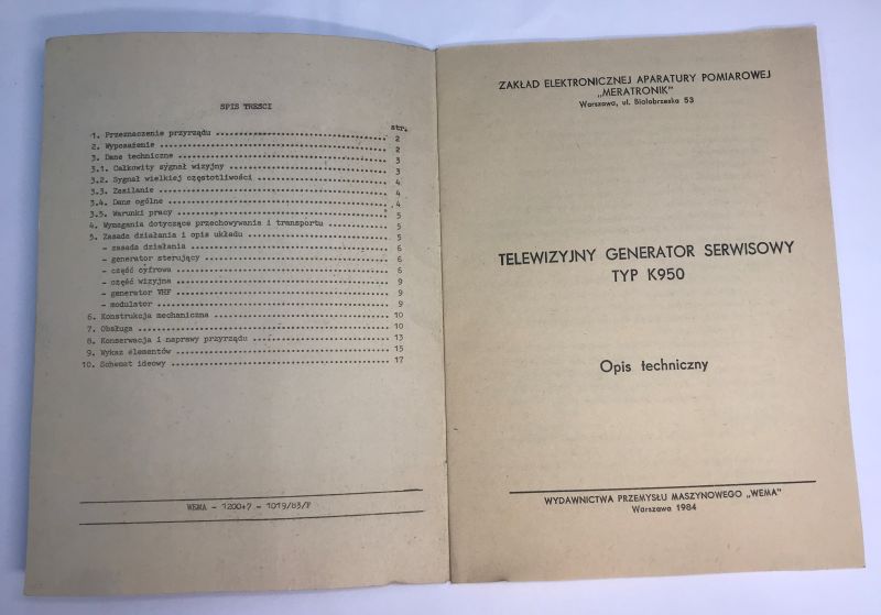

    The booklet dates from 1984 and was published by the ‘Wema’ Machine Industry Publishing House. It opens with a table of contents that already hints at the quality of the documentation.

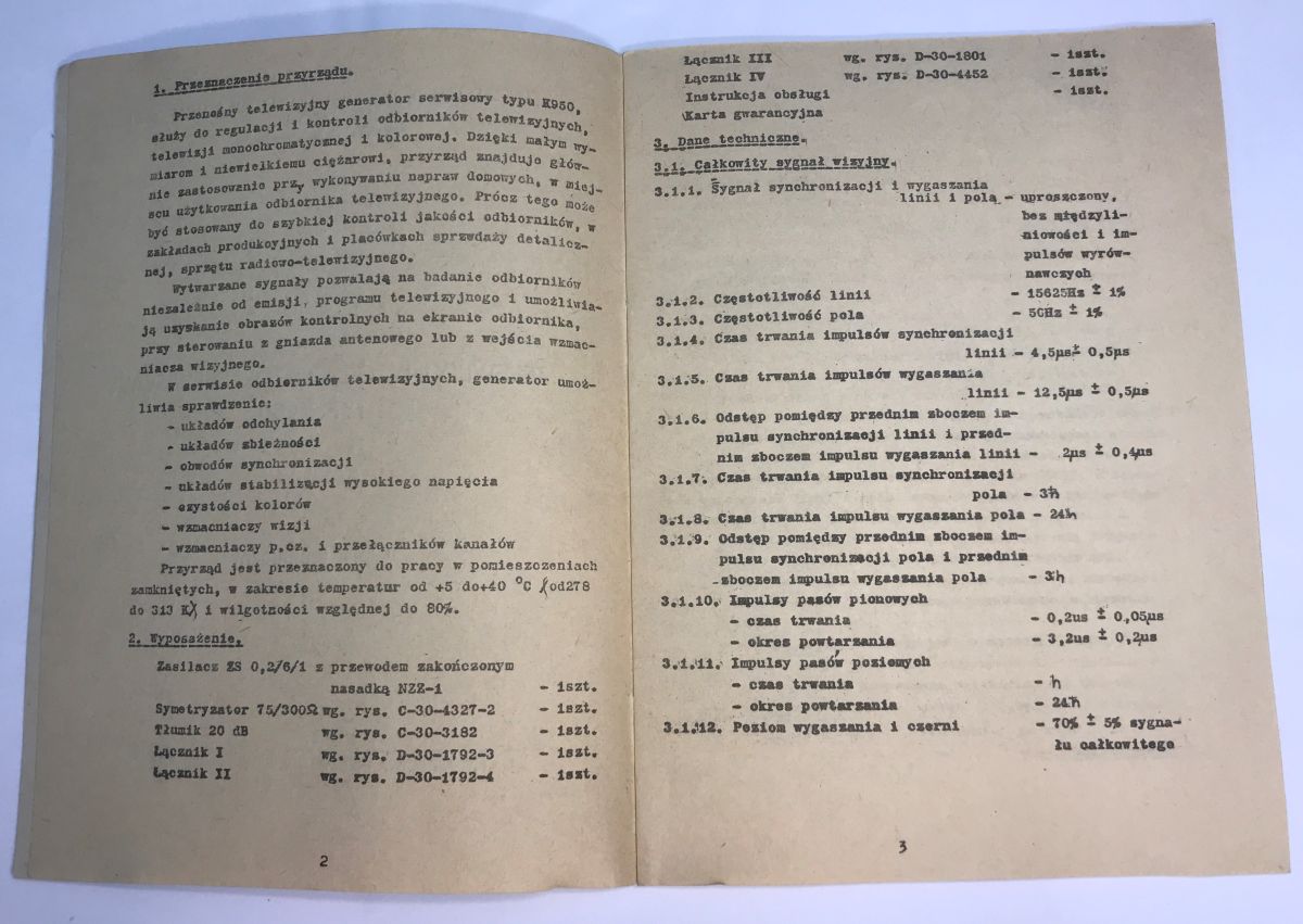

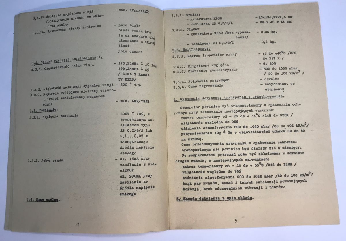

    It begins with a description of the instrument’s intended use and the contents of the kit. This is followed by the device’s technical specifications, a description of the signal it generates, and detailed time-domain and amplitude waveforms.
    The next page continues this description, followed by recommendations regarding the transport and storage of the device. Well, it is quite detailed – but that is not the most impressive part yet.

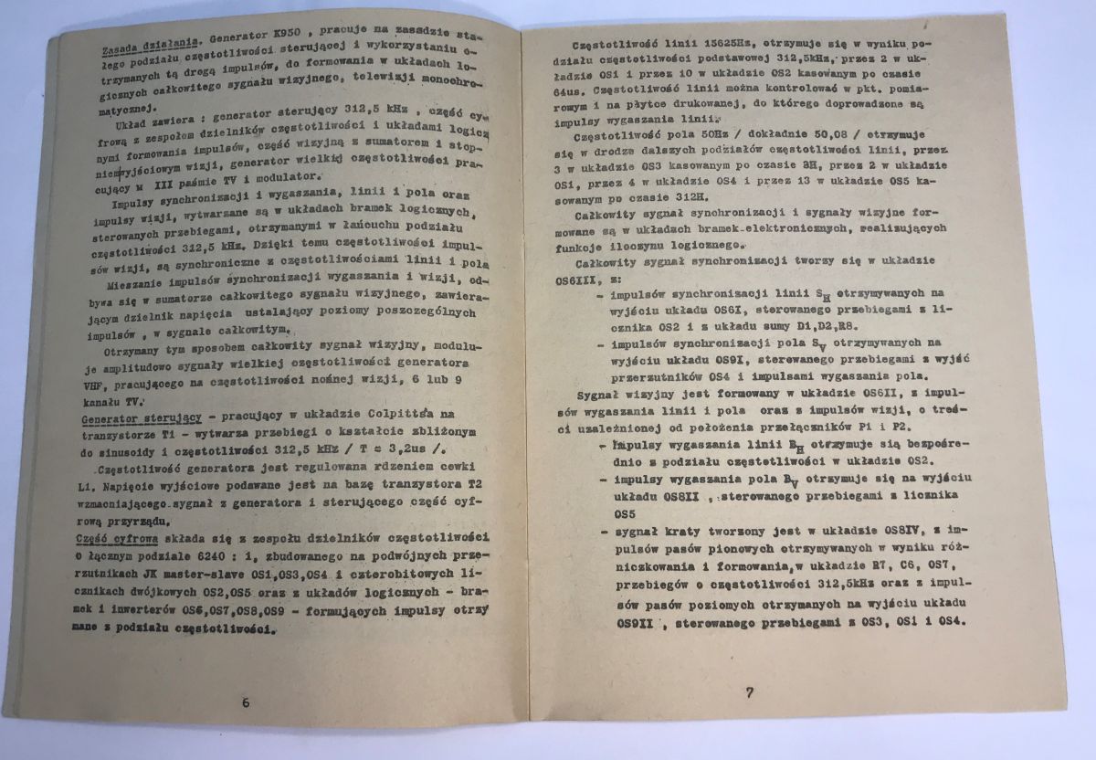

    Next, we have a detailed technical description of how the entire device works, broken down into individual functional blocks.

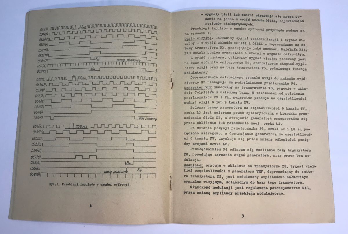

    One of the pages in the description is devoted to a diagram of the pulse waveforms in the digital section, which makes it easier to diagnose the equipment.

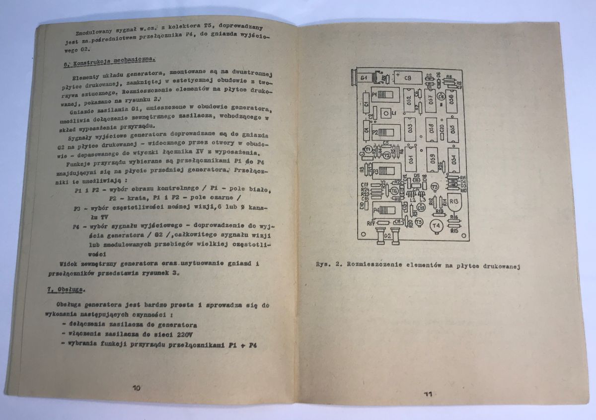

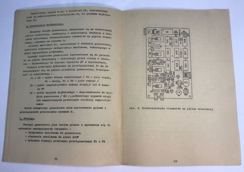

    A description of the electronics is one thing, but I certainly wouldn’t have expected a detailed layout of the PCB itself here:

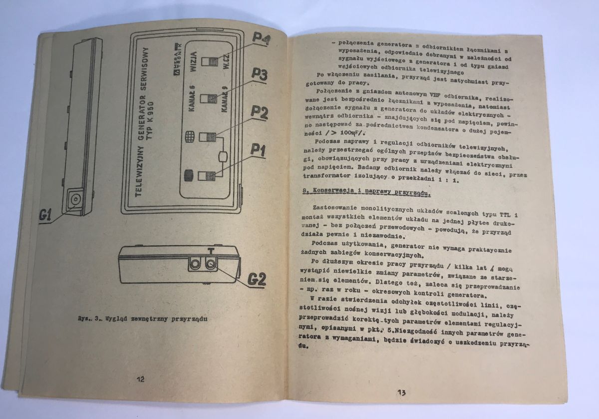

    Moving on, after the components have been laid out on the PCB, there is also a diagram of the instrument’s casing, showing views from three sides. Next comes a section on the maintenance of the device. It is clear that the whole unit has been designed with longevity in mind.

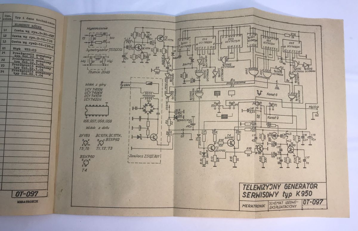

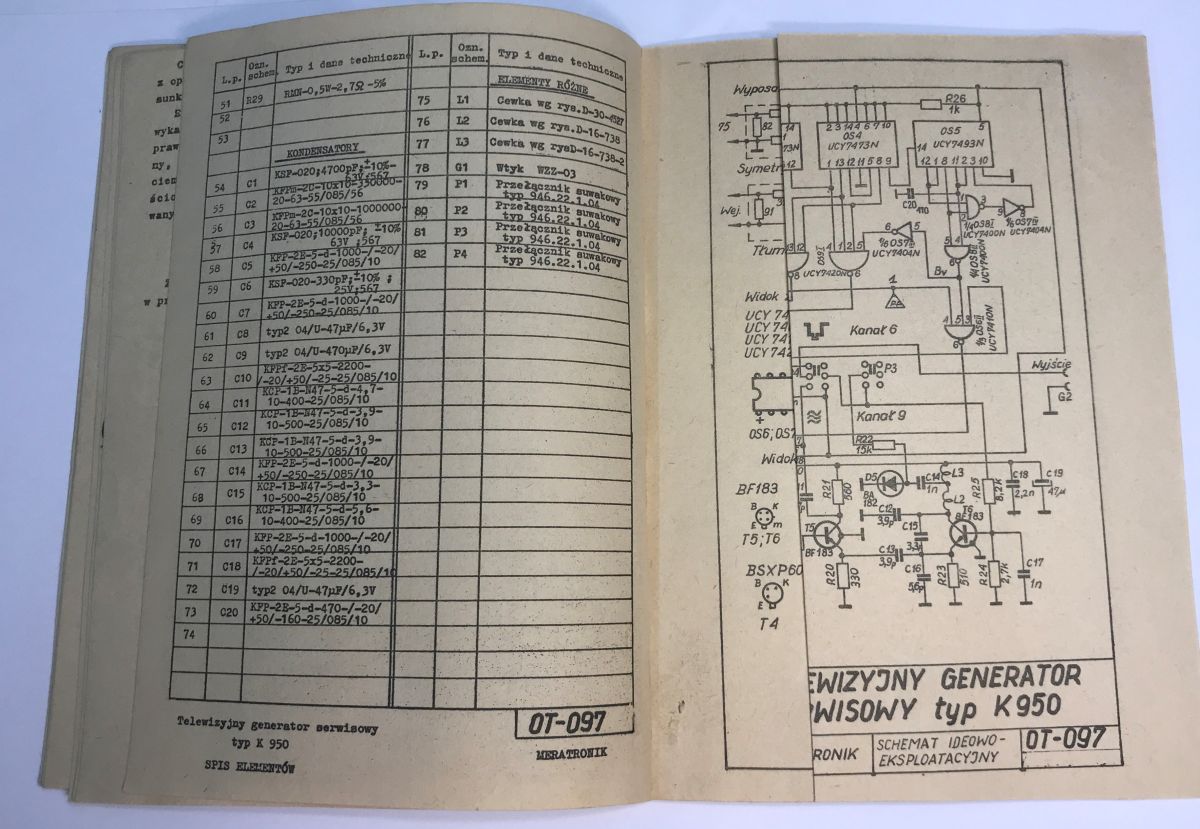

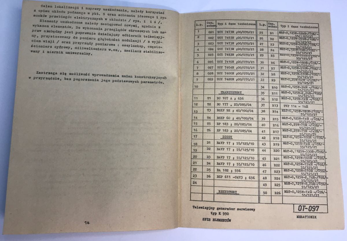

    Finally, there are a few words on servicing the device itself, along with a detailed list of components and their designations. On the last page, there is a fold-out diagram.

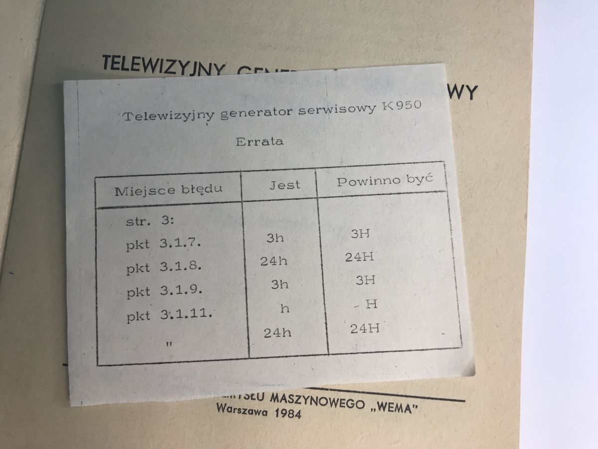

    Actually, there was one more slip of paper in the manual – an errata sheet, no doubt cut out by hand. The attention to detail in the documentation is impressive.

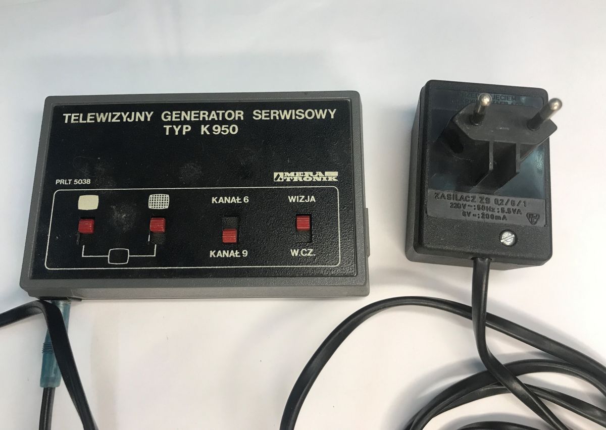

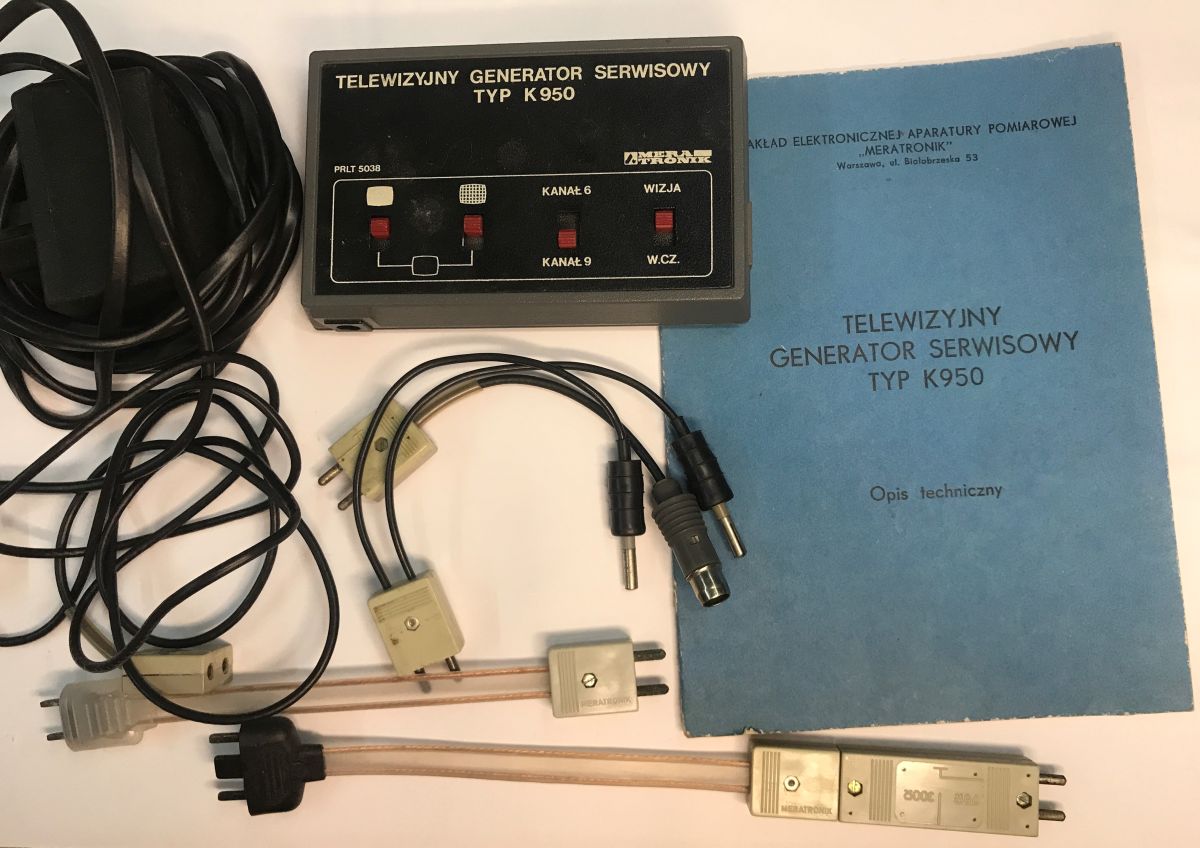

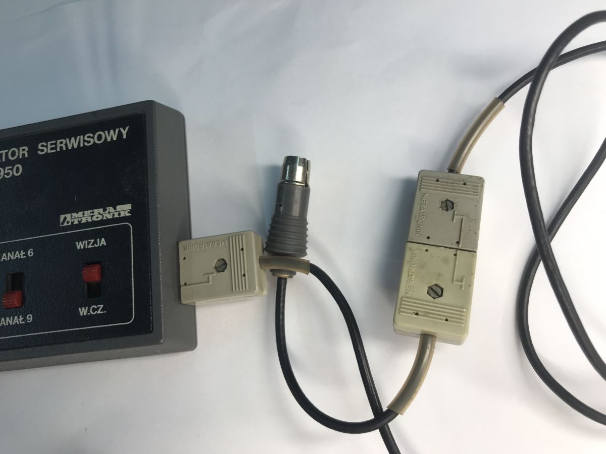

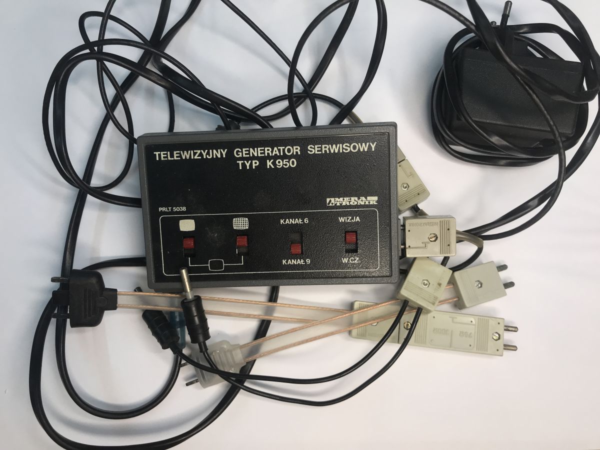

    That leaves the unit itself – complete with a power supply (based on a mains transformer, of course, not a switching power supply) and a range of cables:

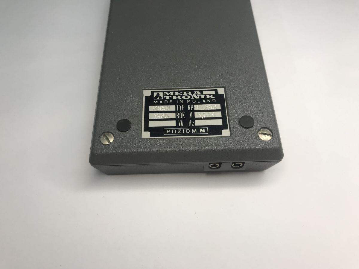

    On the back of the unit there is a plate showing the date of manufacture and a specific serial number.

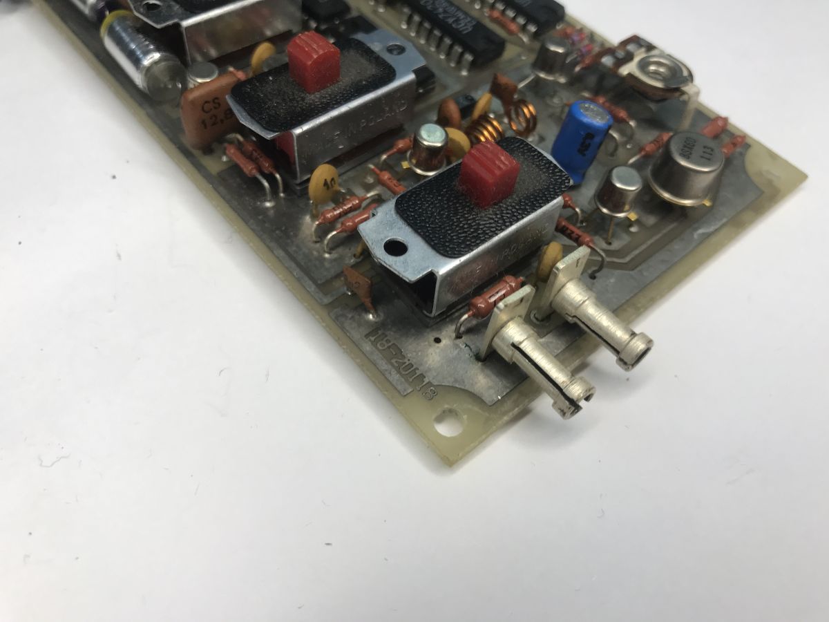

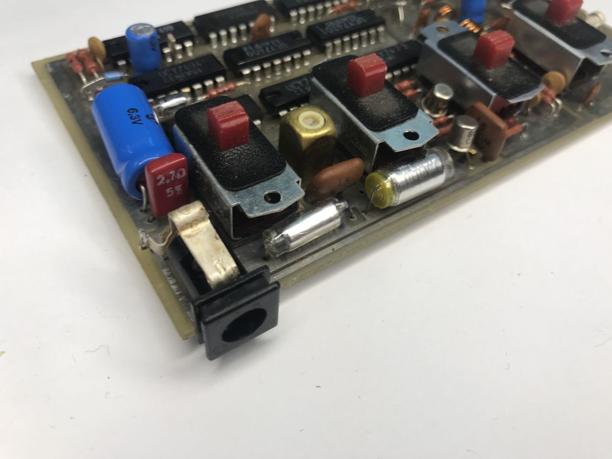

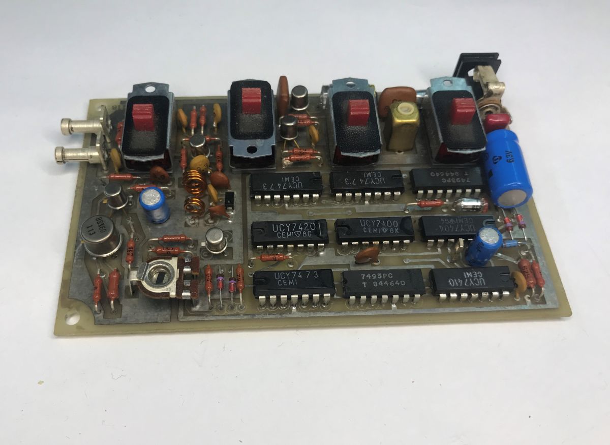

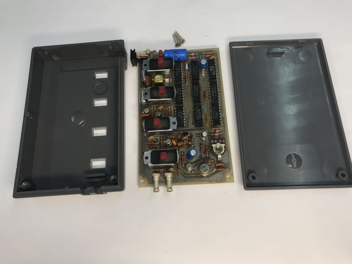

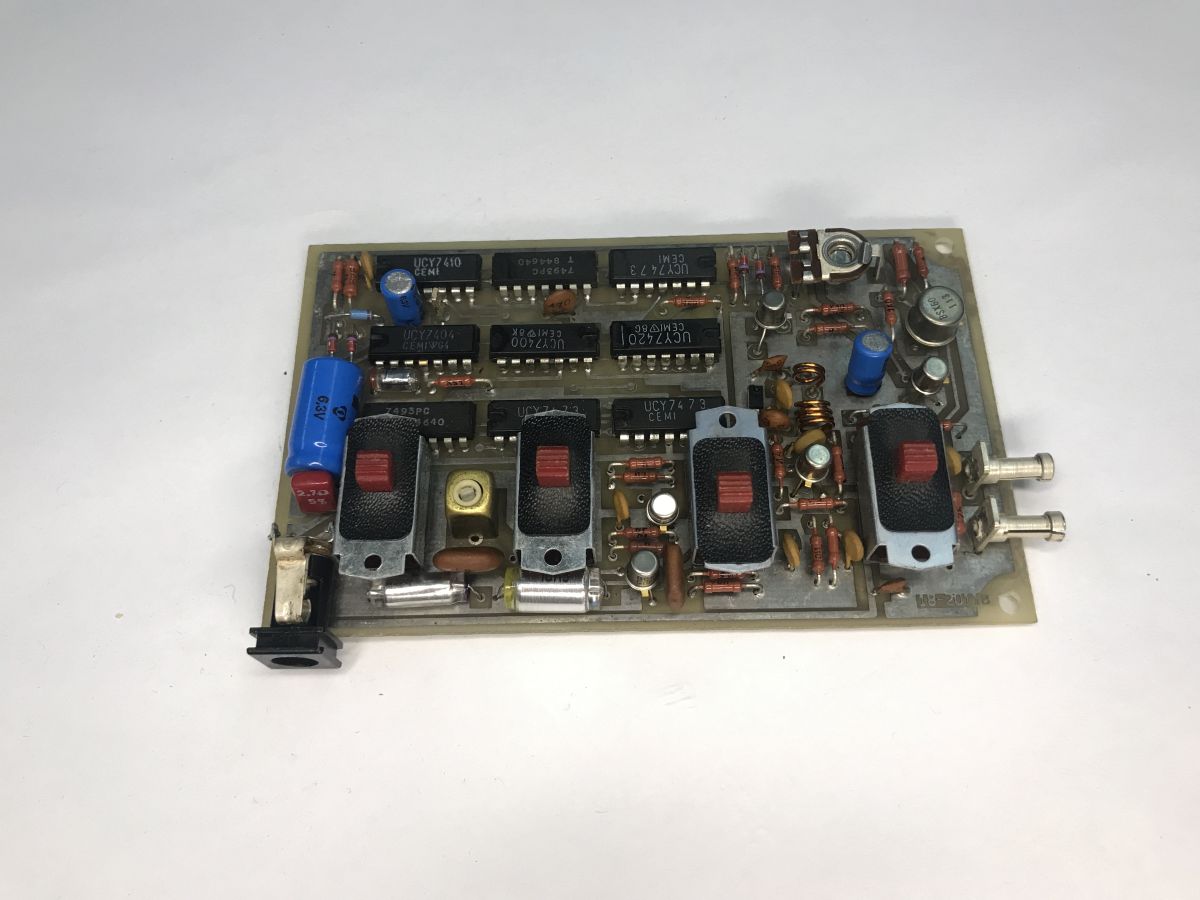

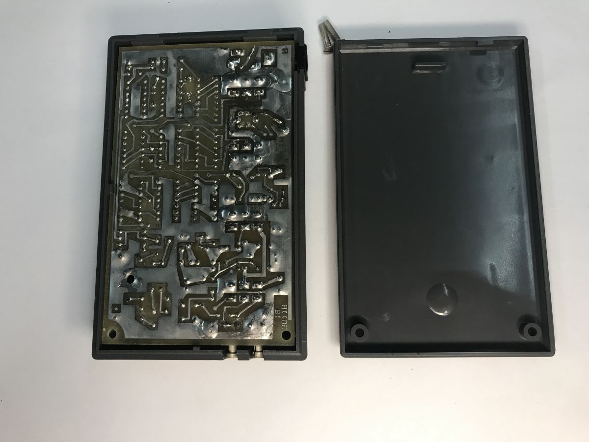

    Once the casing has been removed, we can see a double-sided, tinned board:
    Retro unboxing – K950-type television test signal generator – 1985, interior, schematic diagram Retro unboxing – K950-type television test signal generator – 1985, interior, schematic diagram

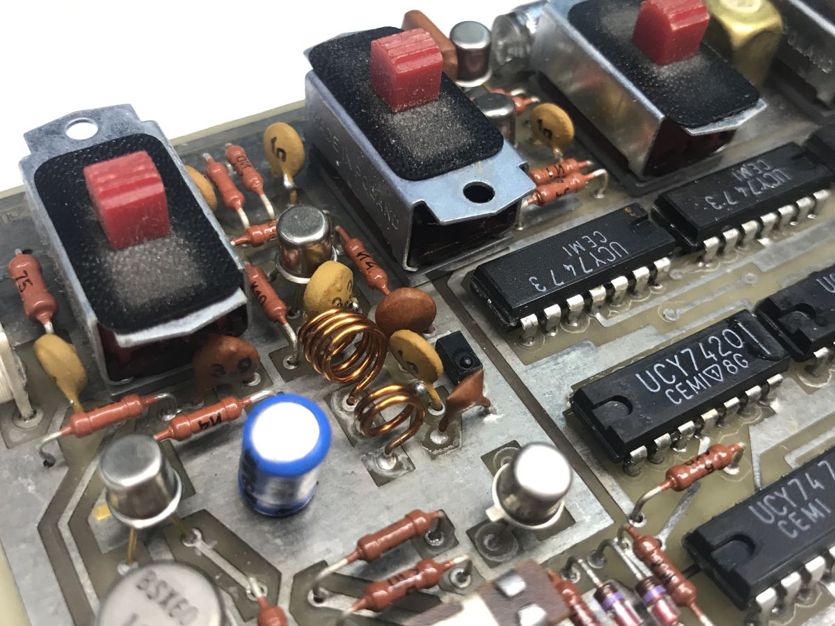

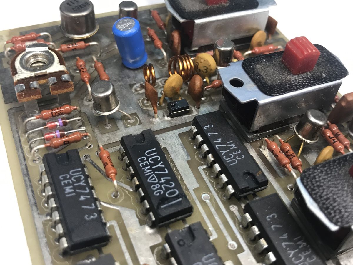

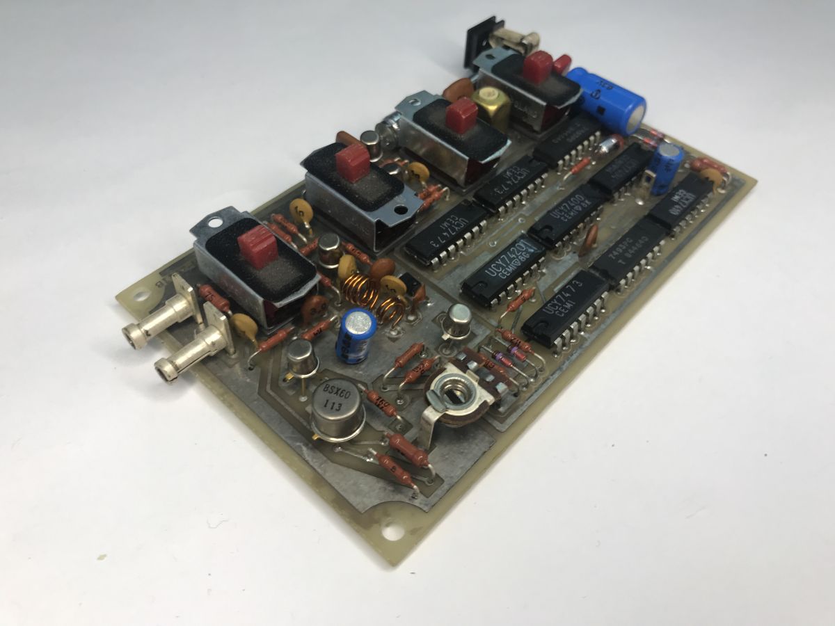

    The device consists of separate sections; first comes the 312.5 kHz control generator, the signal is processed by the digital section, which includes a set of frequency dividers and pulse-shaping circuits, the video section (with a summing circuit and video output stage), and a frequency generator operating in TV Band III, along with an optional modulator.
    In addition, there are four switches available, which allow you to:
    - select the test pattern – white field/checkerboard/black field
    - select the carrier frequency – channel 6 or 9
    - select the output signal – modulated or unmodulated
    Retro unboxing – K950-type television test signal generator – 1985, interior, schematic diagram Retro unboxing – K950-type television test signal generator – 1985, interior, schematic diagram Retro unboxing – K950-type television test signal generator – 1985, interior, schematic diagram
    Essentially, I will repeat the documentation here, but the device consists of components such as:
    - UCY7400 (NAND gates, e.g. the main control generator)
    - UCY7404 (hex inverter)
    - UCY7410 (triple 3-input NAND gate)
    - UCY7420 (dual 4-input NAND gate)
    - UCY7473 (dual J-K flip-flops, frequency divider unit)
    - UCY7493 (4-bit binary counter / frequency divider)
    - BC107A (NPN medium-frequency transistor)
    - BC177 (PNP medium-frequency transistor)
    - BSXP60 (NPN switching transistor)
    - BSXP92 (NPN switching transistor)
    - BF183 (NPN high-frequency transistor)
