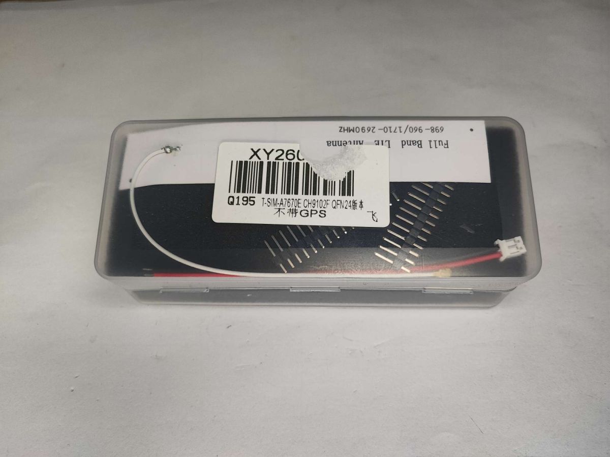

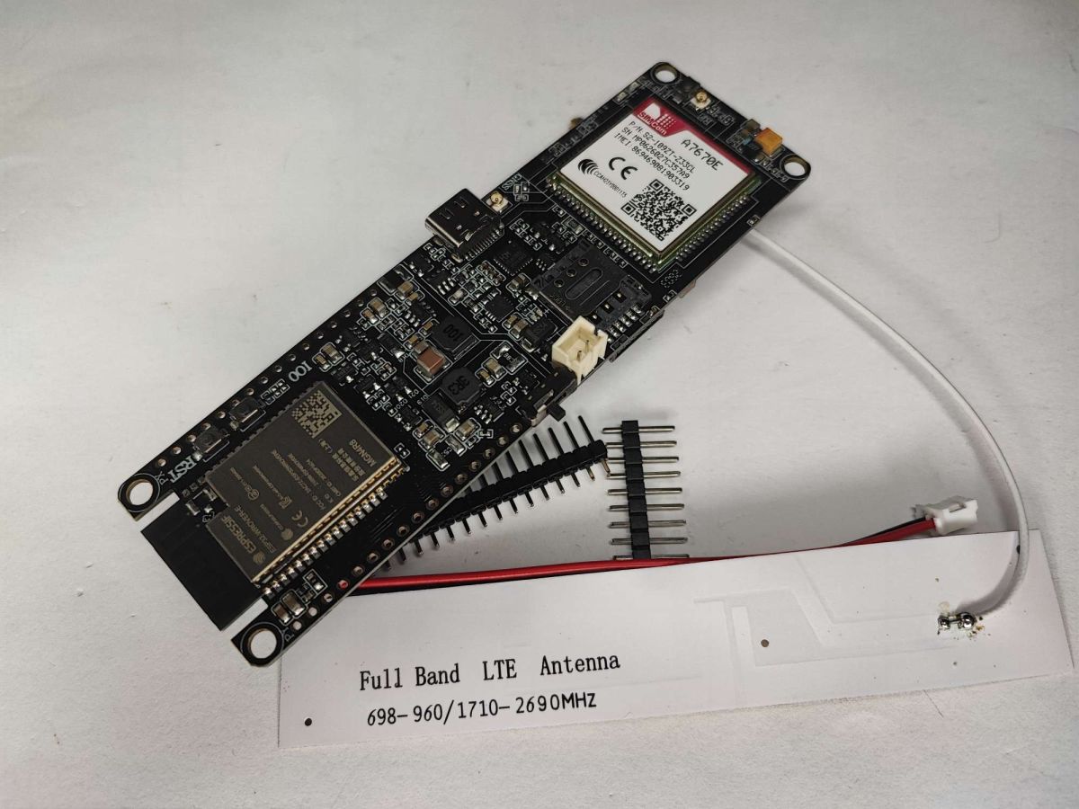

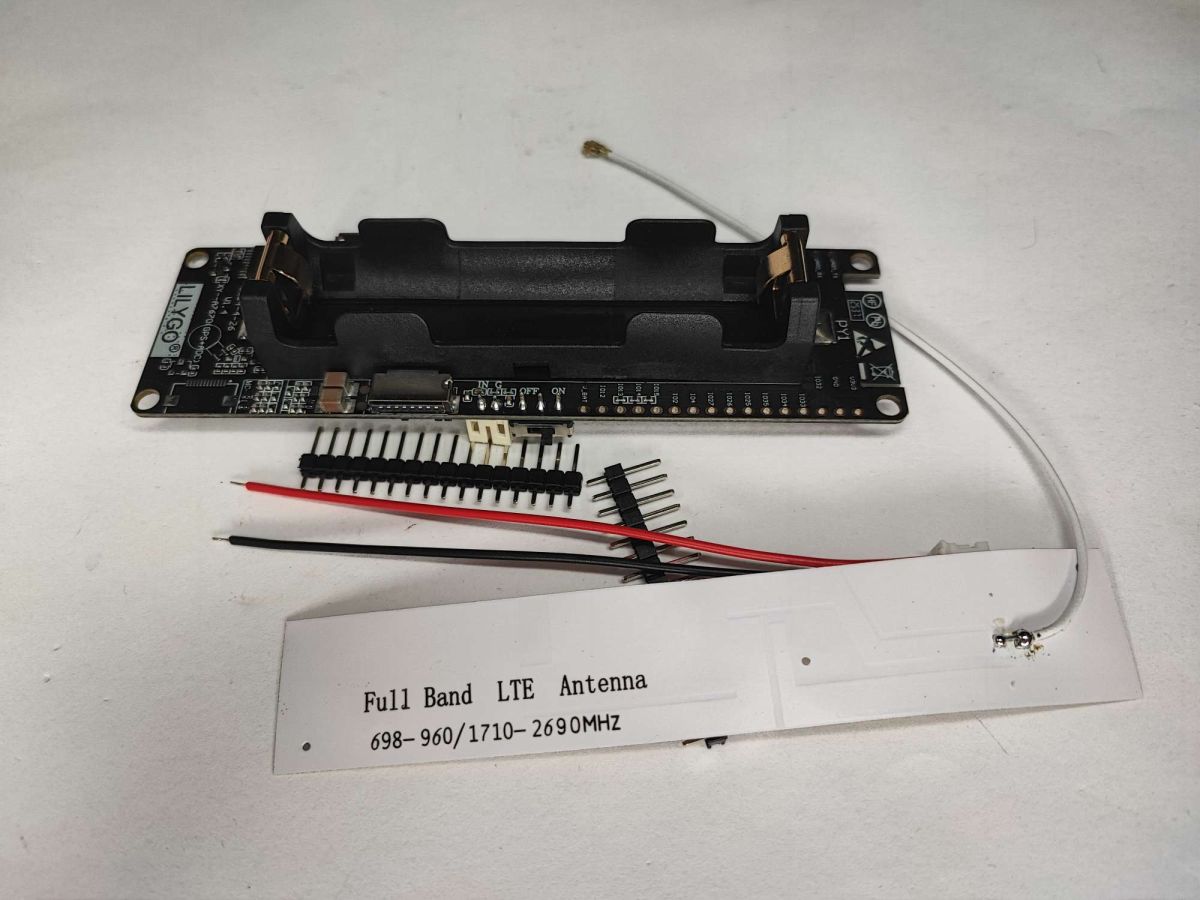

Let’s start with the contents of the pack. I bought it for 200 zł from a Polish importer, although it can be sourced from China slightly cheaper, depending on any special offers. Inside, I received the T-A7670E-R2 board itself, a dedicated LTE antenna, a power cable with a 2.0 mm PH plug (allowing connection to an external power source) and two rows of gold-plated pins for soldering in yourself.

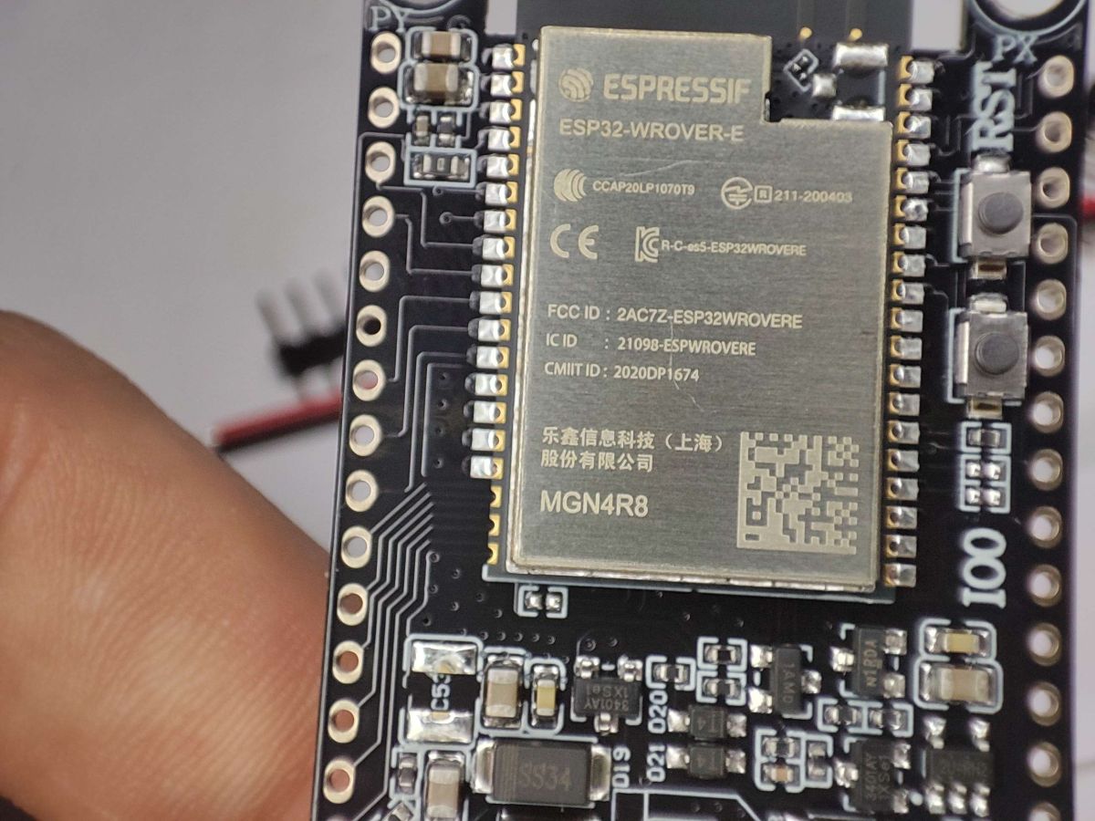

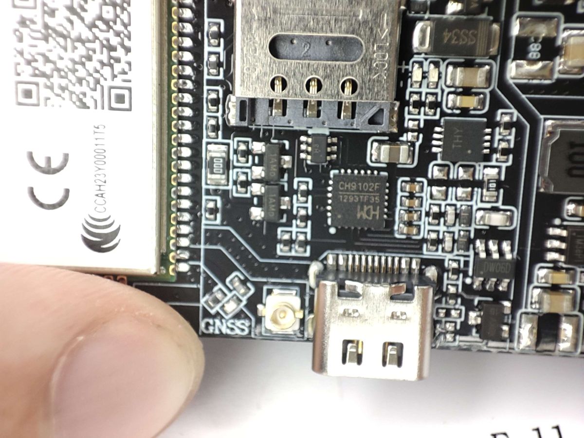

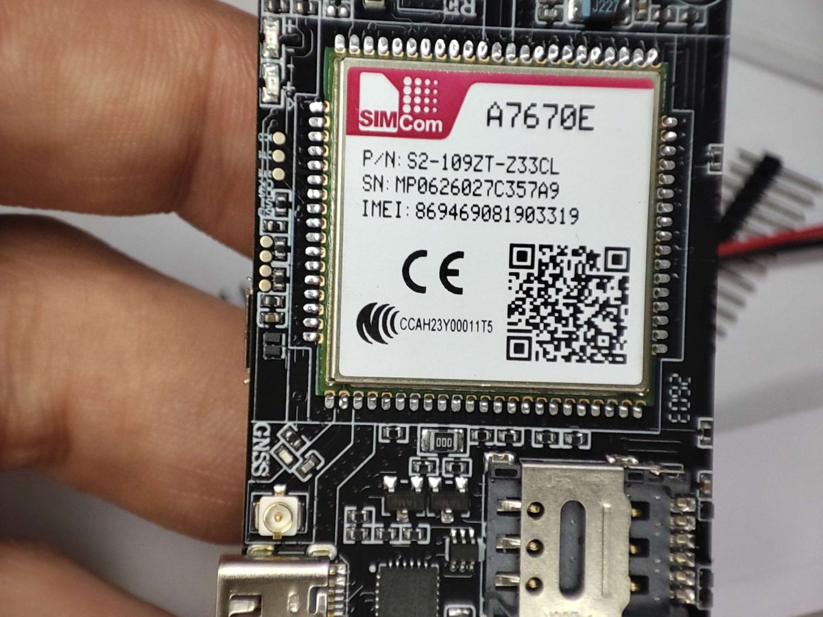

On the board, we can see the aforementioned ESP32-WROVER-E module connected to a SIMCom A7670E mobile modem. The PCB is cleverly designed for portable IoT projects – a holder for an 18650 Li-Ion cell is integrated on the reverse side, allowing for many hours of operation without an external power supply. There is also space here for a microSD card slot (ideal for system logs and measurements) and a nanoSIM card slot. Thanks to the use of the well-known ESP32, the board retains full support for 2.4 GHz Wi-Fi interfaces and Bluetooth communication (the chip supports both classic Bluetooth and its energy-efficient version, BLE – Bluetooth Low Energy).

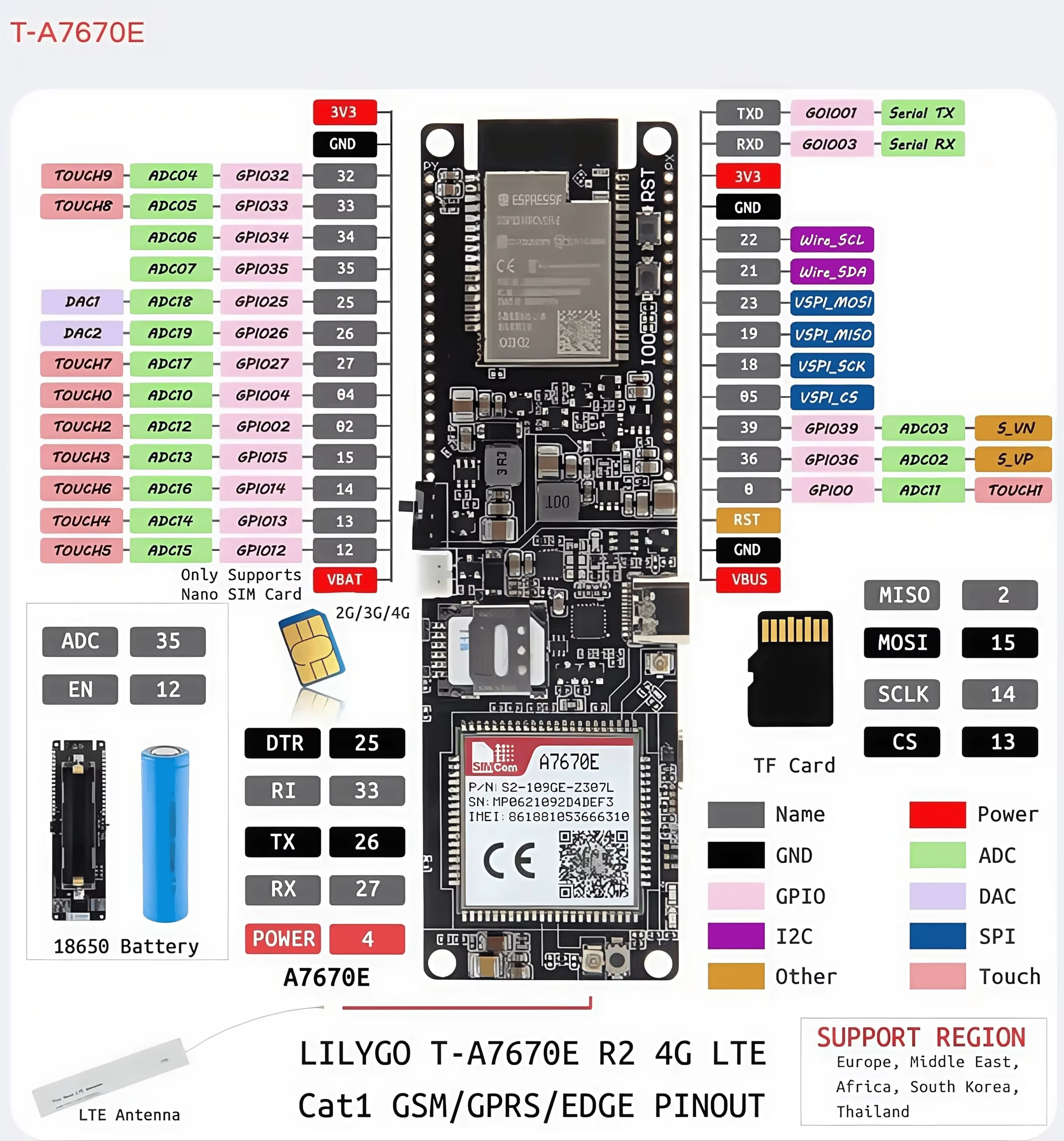

Pins:

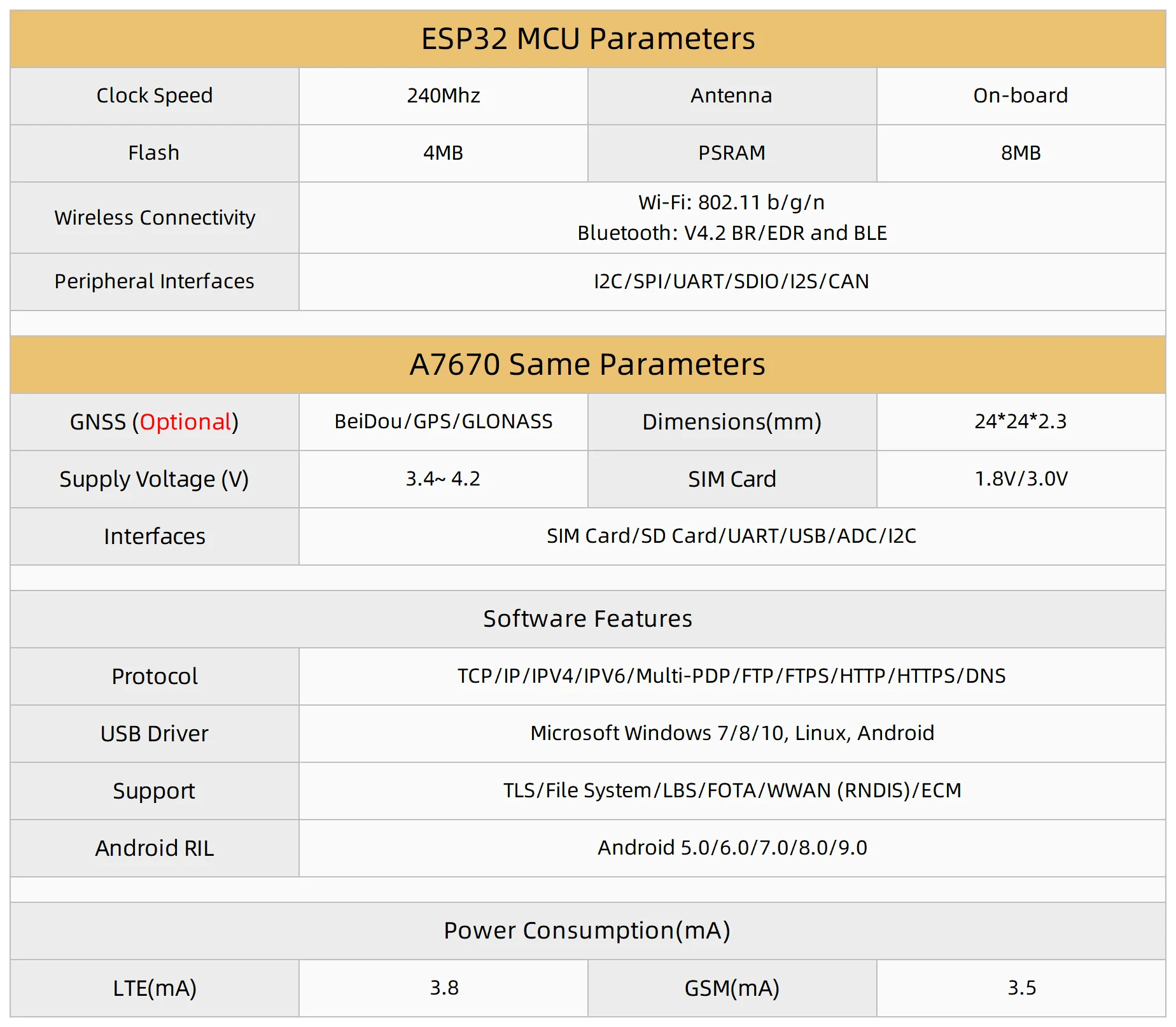

Specifications:

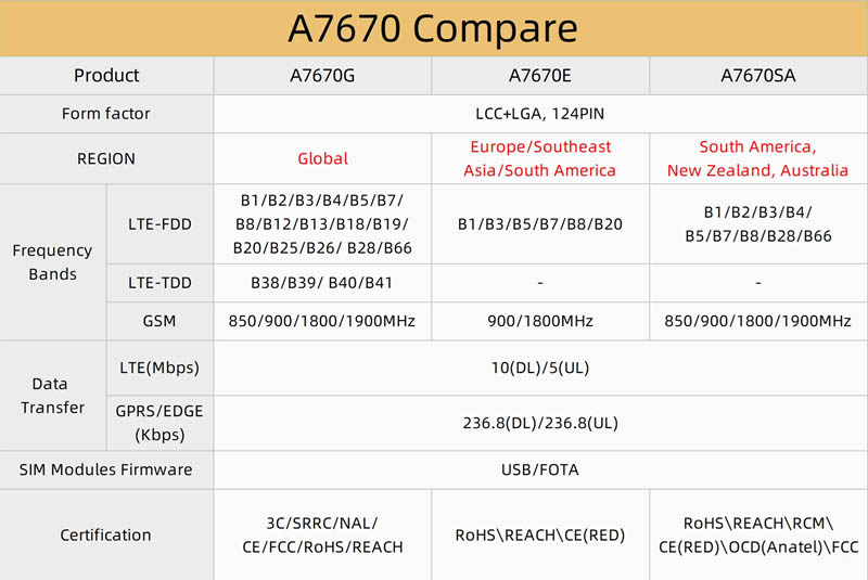

Three versions are available – depending on the region – A7670G, A7670E, A7670SA:
The A7670 module communicates with the ESP32 via the UART interface and is controlled using AT commands, although we will use a ready-made library for this.

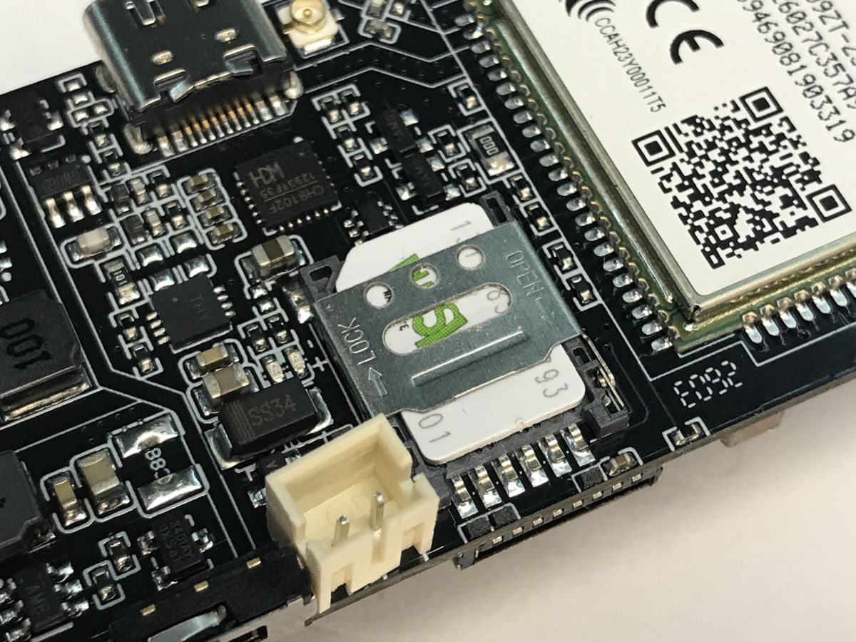

PLEASE NOTE! A SIM card is essential
Important note: without an active nanoSIM card, we will not be able to connect to the network. Although the modem will initialise correctly and respond to AT commands, attempts to run the code without a card will hang whilst waiting for the SIM_READY status or network registration. Please also ensure that the card is not PIN-locked (or remove the PIN via software).

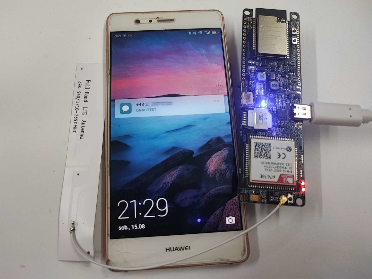

How do I send an SMS via the A7670E?
To start with, the simplest test – sending an SMS to the specified number. The script below was written for PlatformIO, but it will work just as well in the Arduino IDE.

Result:
The network registration process went smoothly – the SMS message reached its destination.

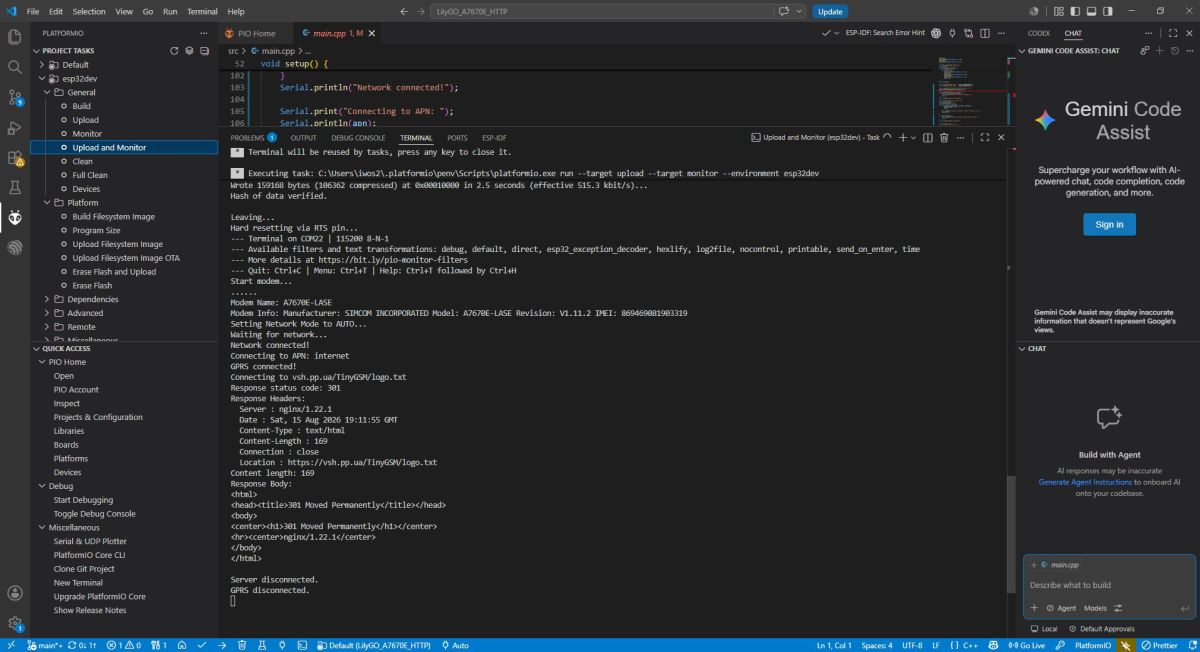

How do I make an HTTP connection via the A7670E?
The next test is a standard HTTP connection. We will use the "ArduinoHttpClient" library in conjunction with "TinyGSM" to retrieve data via a GET request from the test server ("vsh.pp.ua") and output it to the serial port. Just remember to replace the APN in the code with your own.
Code: C / C++
Result:
The connection to the server was successful, but the server is attempting to redirect us to the encrypted version of the page. This is becoming increasingly essential in today’s internet. For this reason, we will now handle HTTPS.

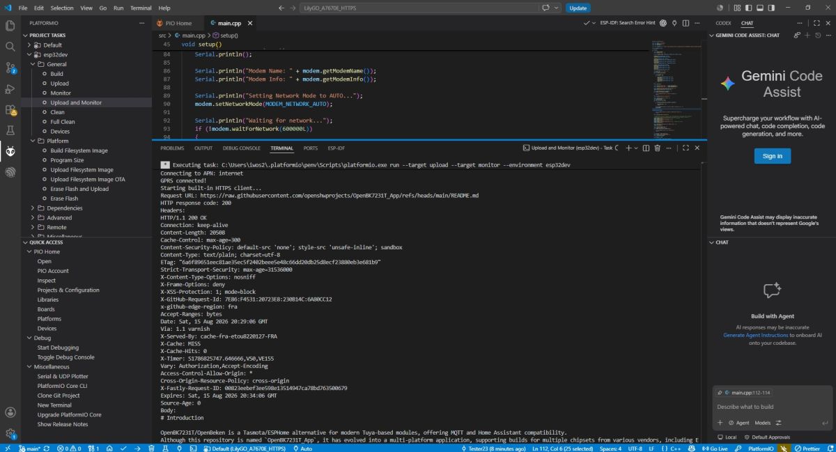

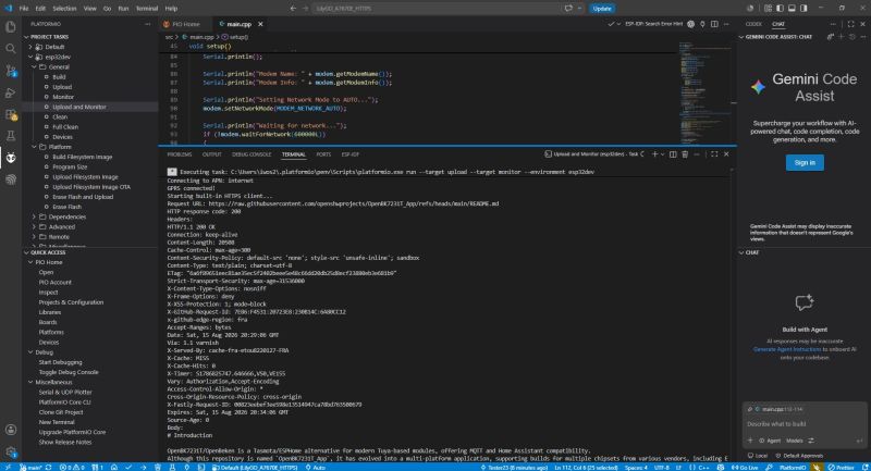

How do I establish an HTTPS connection via the A7670E?
Nowadays, HTTP alone is often insufficient. Instead of the “TinyGsmClientSecure” library (which relies on the modem’s SSL sockets), the code below directly utilises the built-in AT commands for HTTPS (“modem.https_begin()”), which tends to be more stable on the A7670E. In both cases, the modem’s hardware-based TLS relieves the microcontroller of the burden of cryptographic calculations. Note: in the demonstration code, validation of the certificate’s date against the modem’s RTC has been deliberately omitted (“ignorertctime”). Whilst this is a convenience in the demo, in production it is a flaw that leaves the system vulnerable to MITM attacks.
Code: C / C++
Result:
A secure connection to the server has been established – the system correctly handled the encrypted communication and downloaded the file content. In this case, the Readme for my OBK project from GitHub was downloaded.
