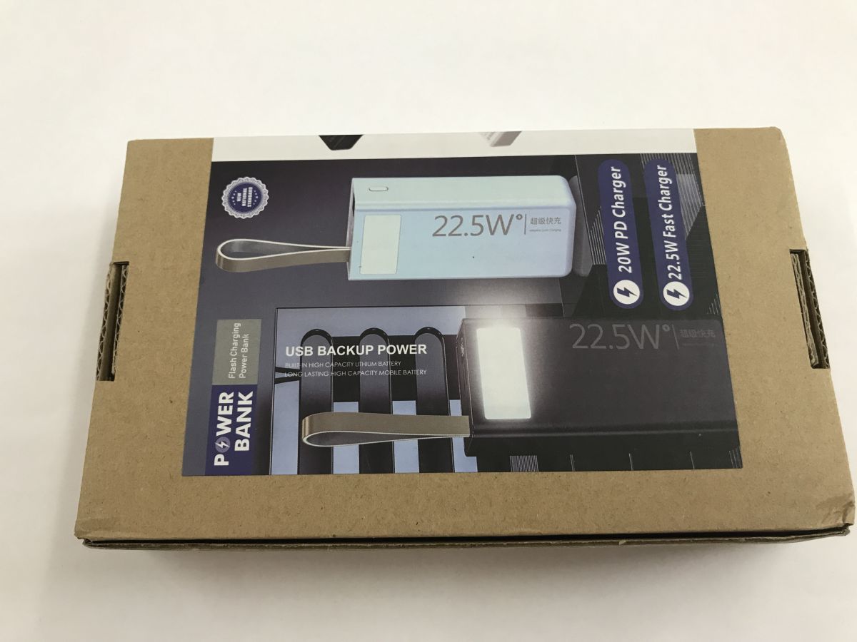

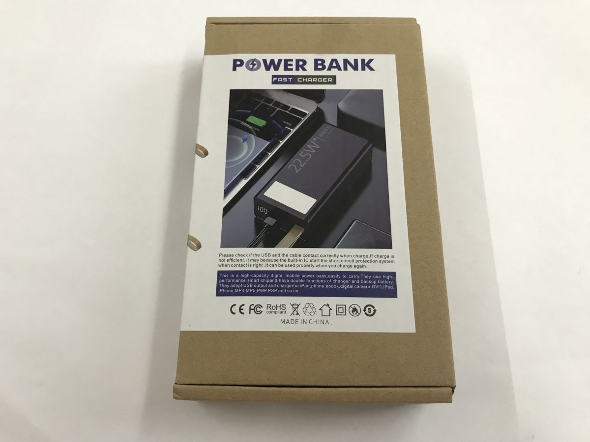

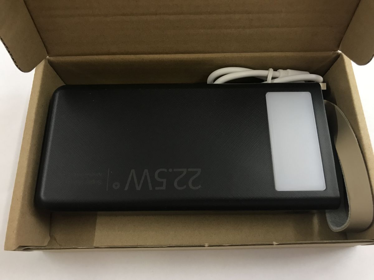

    The device arrives in a very simple, almost plain cardboard box, with nothing but a label stuck on it. Even at first glance, it’s clear that this is a typical Chinese ‘no-name’ product. Inside, apart from the power bank itself, there is a short, white USB cable. The device itself is made of matt plastic, and on the side there is a practical carrying strap and a fairly large LED light panel that doubles as a torch.

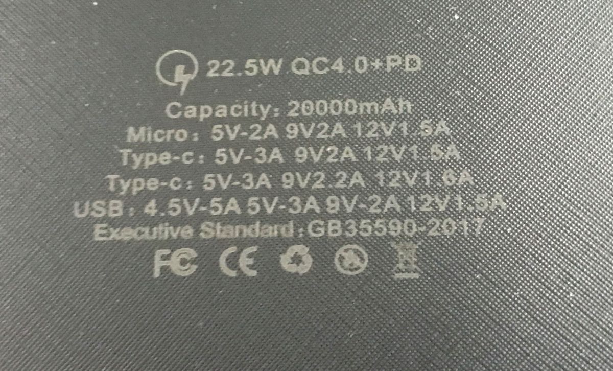

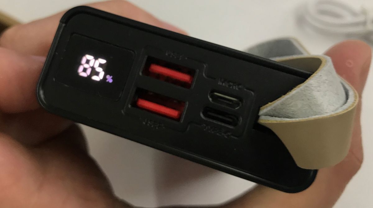

    On the underside of the casing, you’ll find the full port specifications, supported voltages and the impressive-sounding “QC4.0+PD” printed. The GB35590-2017 standard is also marked there.
    On the front, next to the set of ports (two red USB-A output ports, one MicroUSB input port and one universal Type-C port), there is a clear digital percentage display showing the current battery charge level.

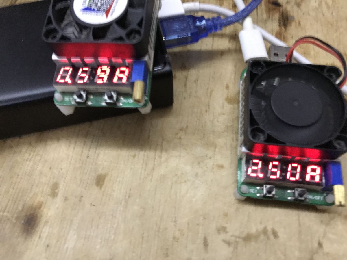

    It can deliver up to 3.7 A at 5 V:

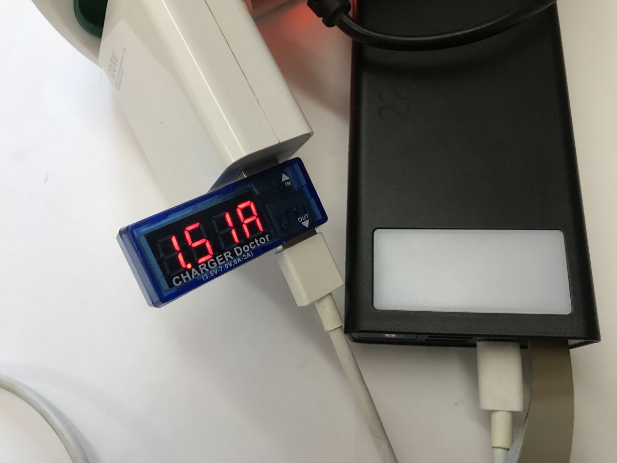

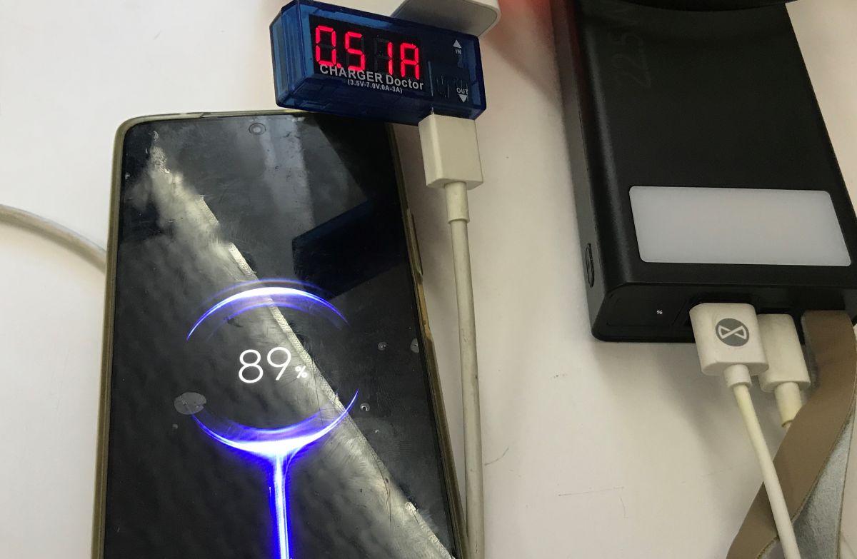

    QC kicks in and delivers over 1.5 A, although I didn’t have a decent meter to hand to check this:

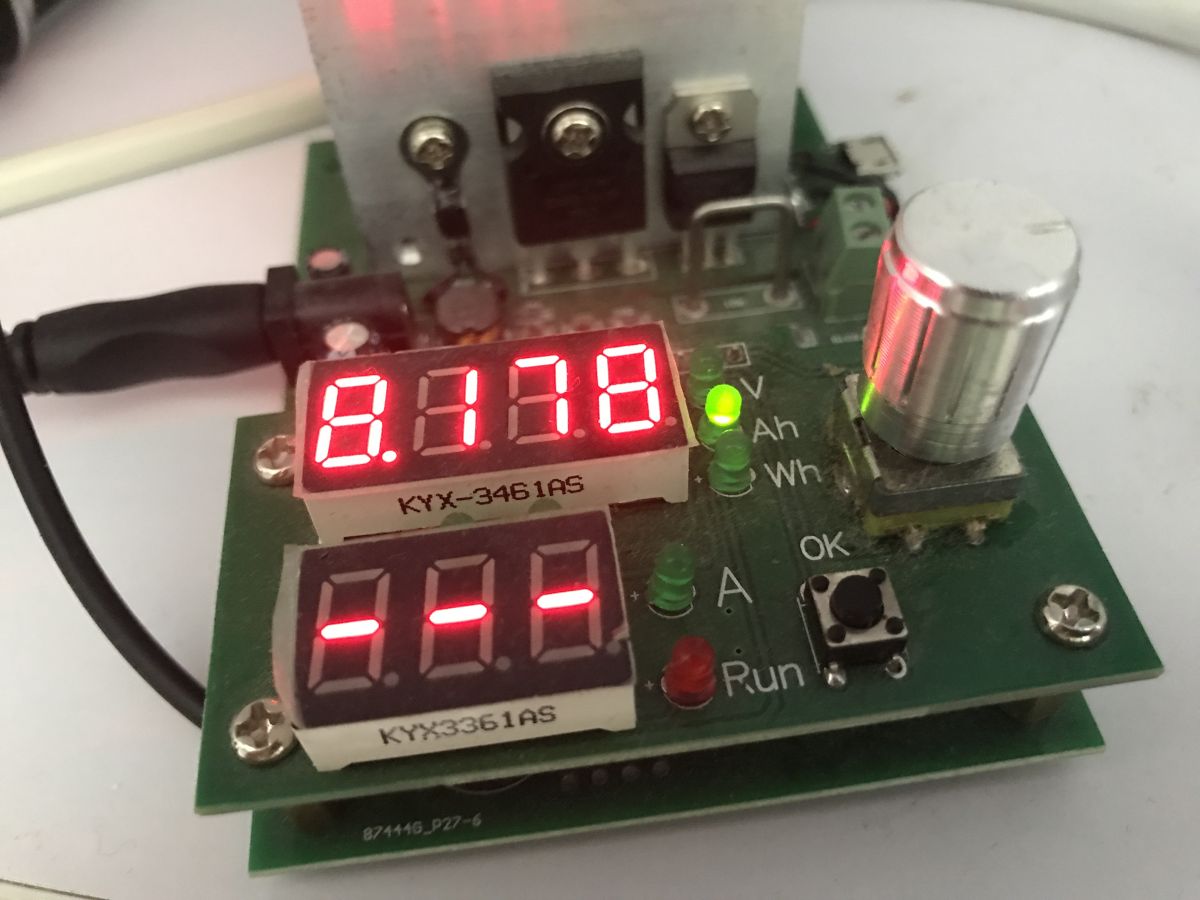

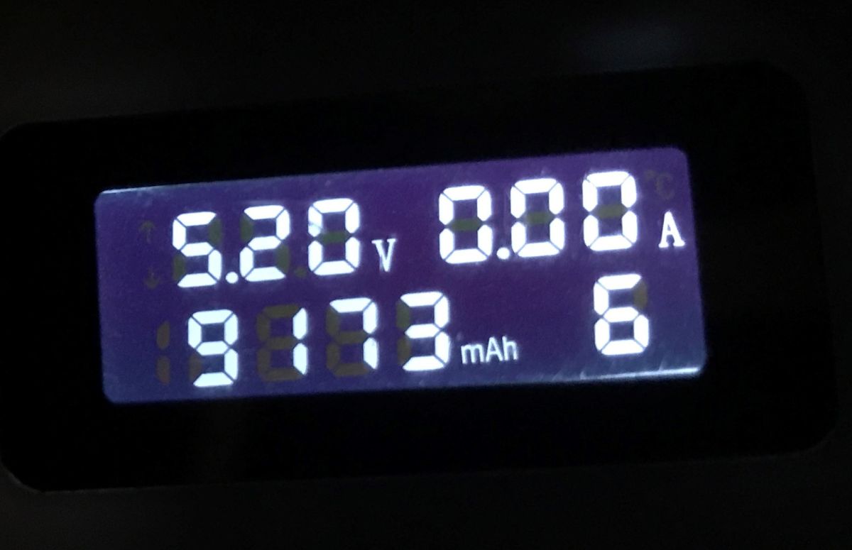

    I checked the capacity several times, additionally measuring how many mAh are drawn whilst charging the cells.
    A practical test of power banks and capacity measurement – PPXJ20, BS-30KP365 and one unbranded mode A practical test of power banks and capacity measurement – PPXJ20, BS-30KP365 and one unbranded mode
    The figures are indisputable. 8,178 mAh at 5V gives us, taking into account my conversion factor from previous threads , this gives approximately 8.178/0.65 Ah = 12.5 Ah per cell.

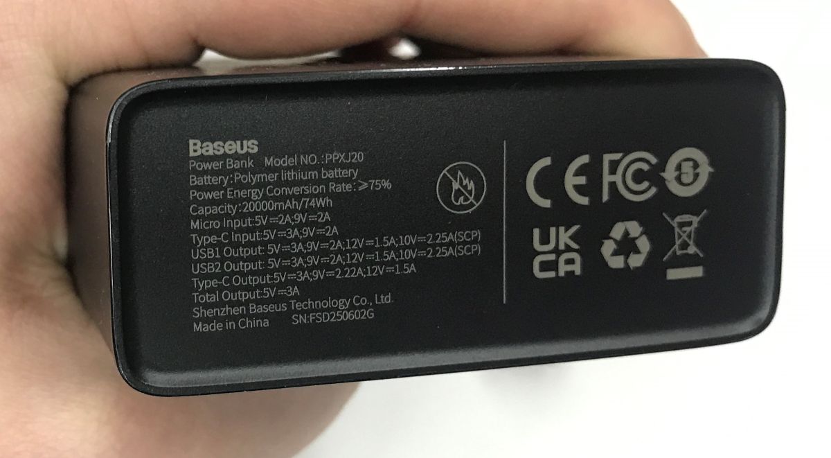

    It looks more like a branded product here too. The text beneath the ports is clear, and the model name is printed on the casing, although here it’s slightly different – PPXJ20.

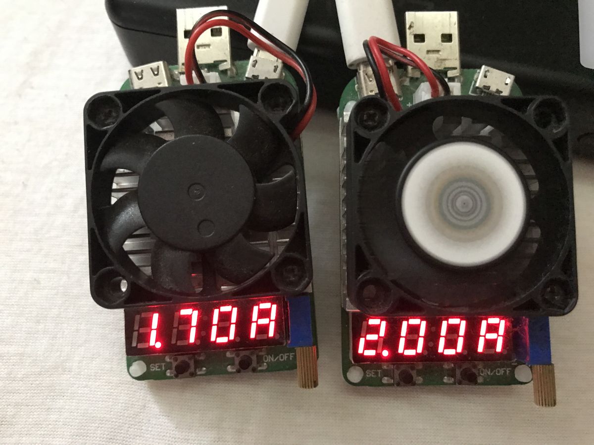

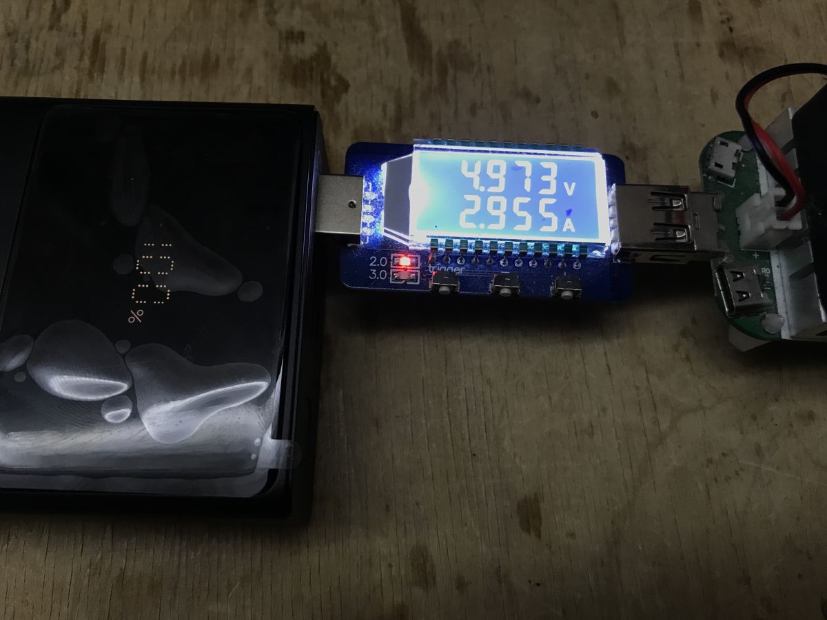

    I started with current performance tests. At 5 V, it can consistently draw almost 3 A, so essentially it’s perfectly fine.
    The phone activates QC correctly.
    The specified maximum current is shared between the ports. It cannot be split between the two ports to draw more current.

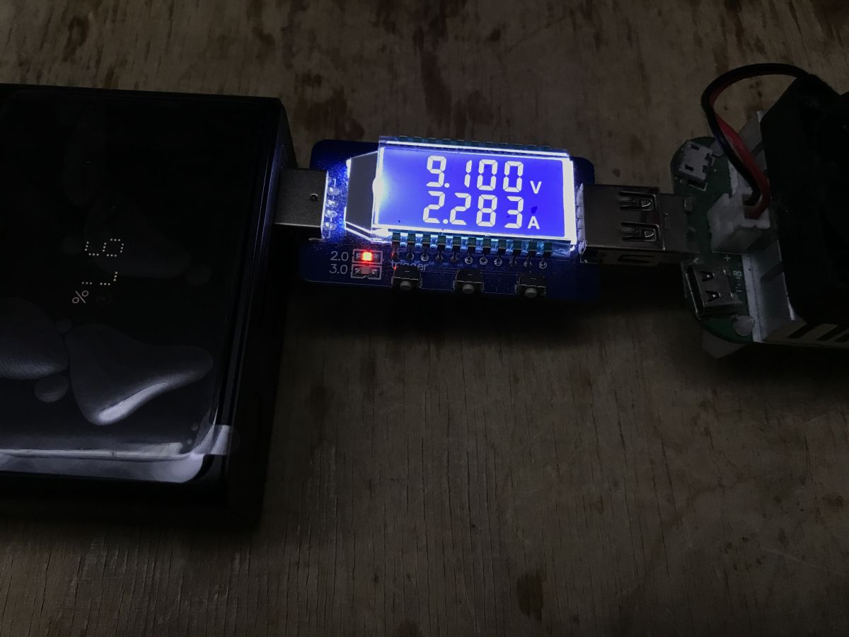

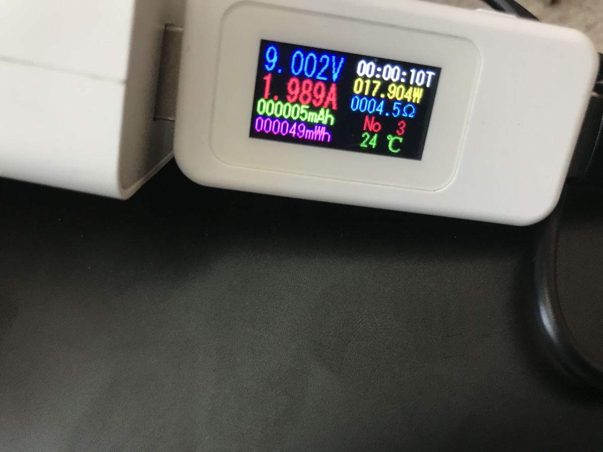

    A power bank connected to a suitable charger is also capable of drawing a higher voltage; at 9 V, it can draw as much as 2 A, giving 18 W of charging power.

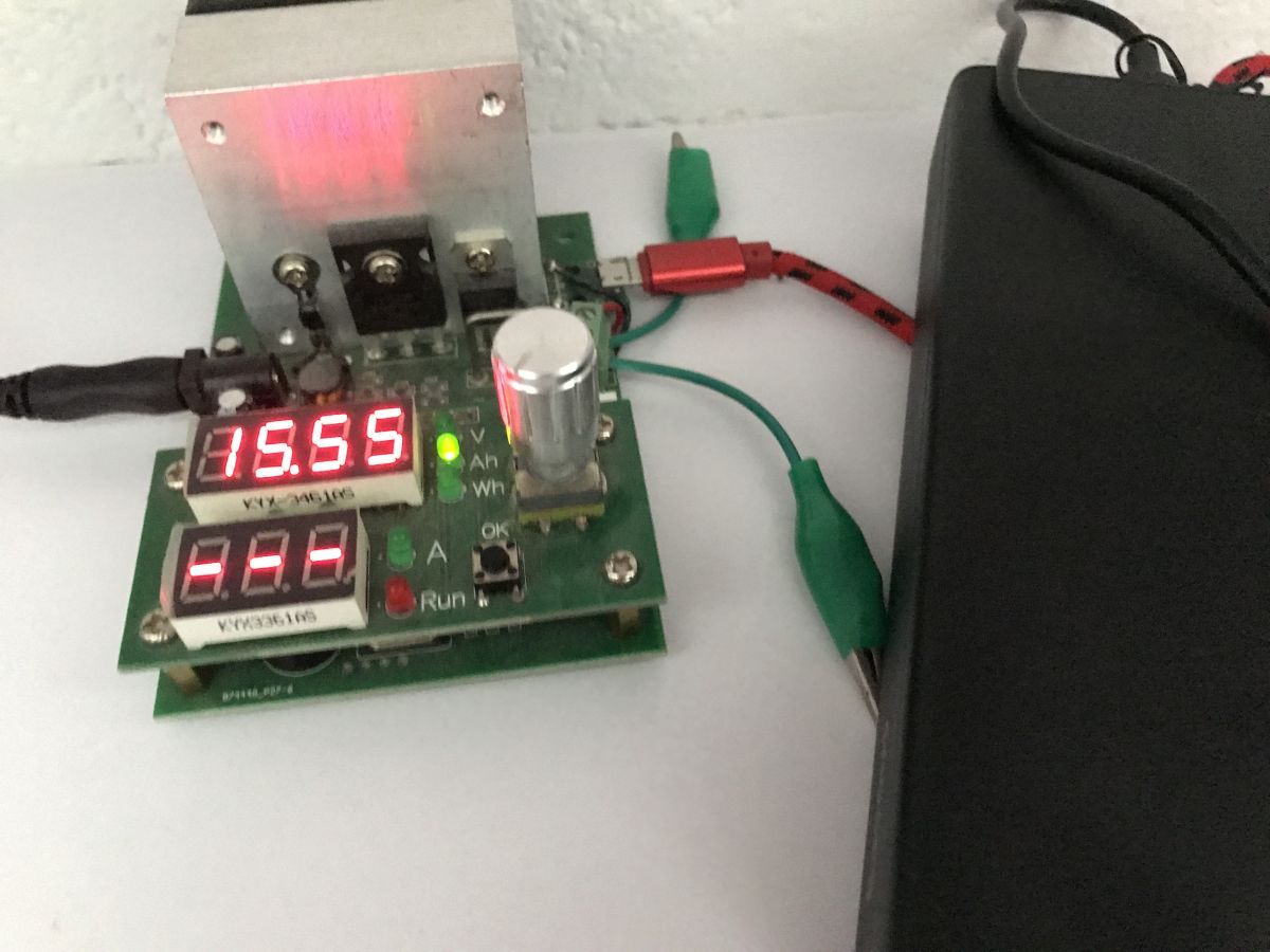

    It’s time to move on to the actual capacity test. Again, I carried out the test several times to rule out measurement errors or undercharged cells.
    Around 15.5 Ah, which, when calculated using the same formula (15.5 / 0.65), gives us a good 23.8 Ah per cell – which actually exceeds the capacity stated in the specifications. It seems, however, that the brand does matter; it’s better to trust something that has a specific model name and manufacturer, rather than a completely no-name product.

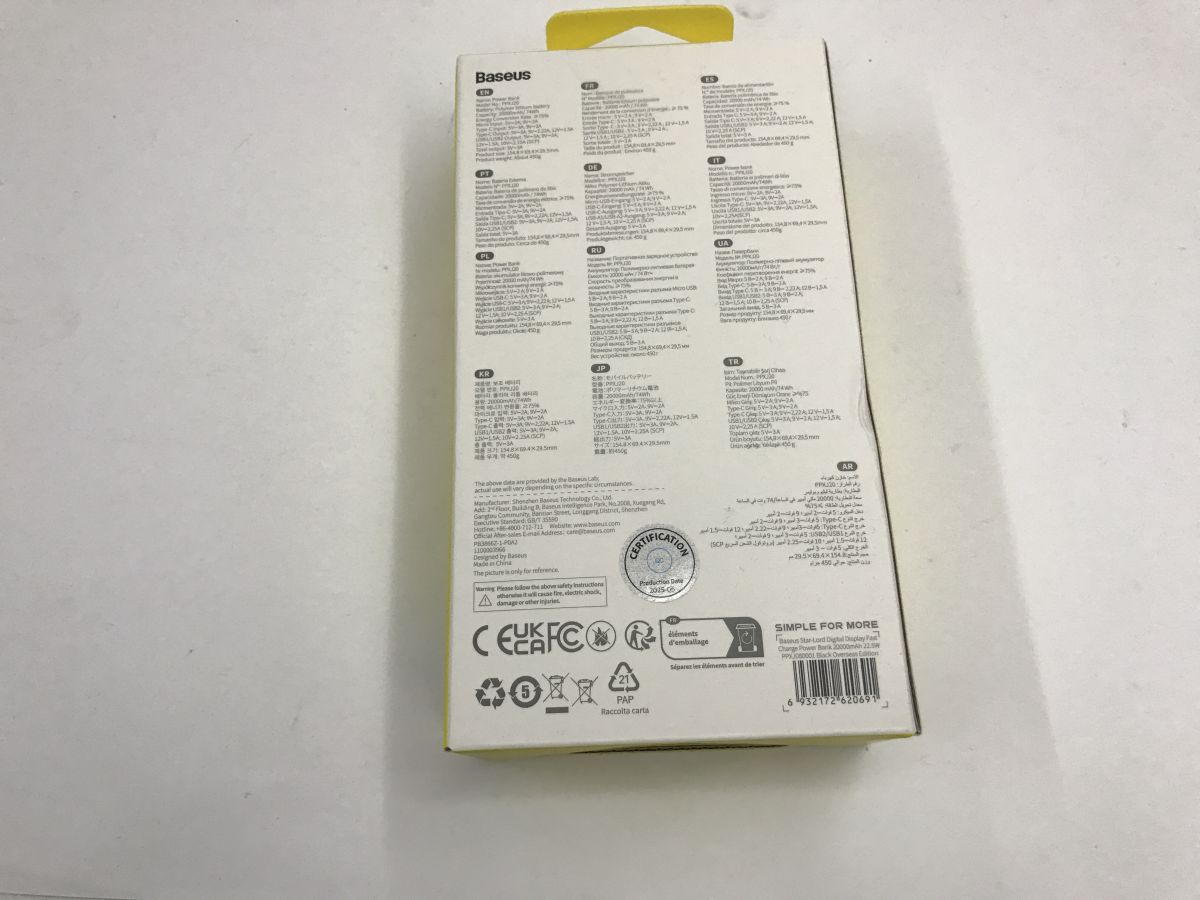

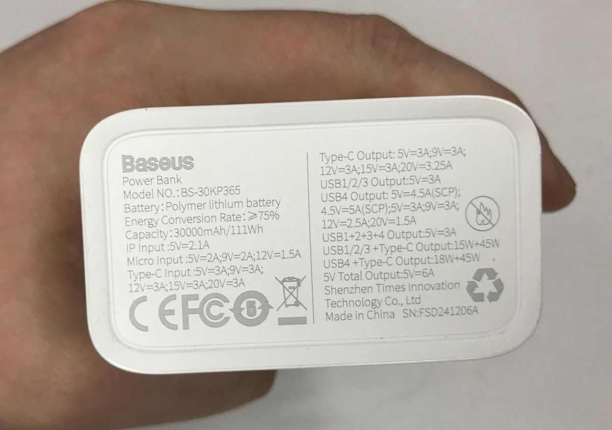

    BS-30KP365 - 30,000 mAh Baseus 65W

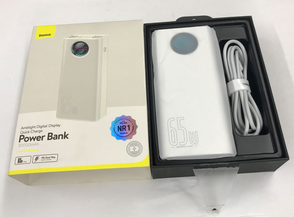

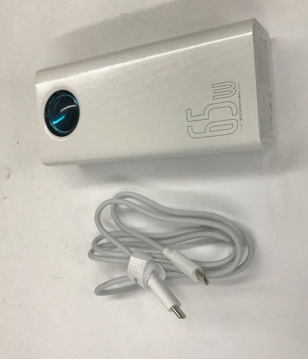

    The third, more promising model is the Baseus Amblight (BS-30KP365) with a capacity of as much as 30,000 mAh. It offers an impressive total power output of 65 W and a very wide range of ports, including four USB-A outputs (one of which is QC-compatible up to 20 V and 1.5 A), a bidirectional Type-C port (supporting 20 V and 3.25 A output) and additional charging inputs in the form of MicroUSB and Lightning. The box also includes a dedicated Type-C to Type-C cable supporting 100 W (20 V, 5 A), which will make it easier to fully charge this power bank – a process that, according to the manufacturer, takes around 10 hours.
    Unfortunately, I don’t currently have a load to fully test the claimed 65 W, but I’ll be able to successfully measure its actual capacity. Let’s start, however, with a quick look at the packaging.
    A practical test of power banks and capacity measurement – PPXJ20, BS-30KP365 and one unbranded mode A practical test of power banks and capacity measurement – PPXJ20, BS-30KP365 and one unbranded mode A practical test of power banks and capacity measurement – PPXJ20, BS-30KP365 and one unbranded mode
    The set includes a cable, and it’s

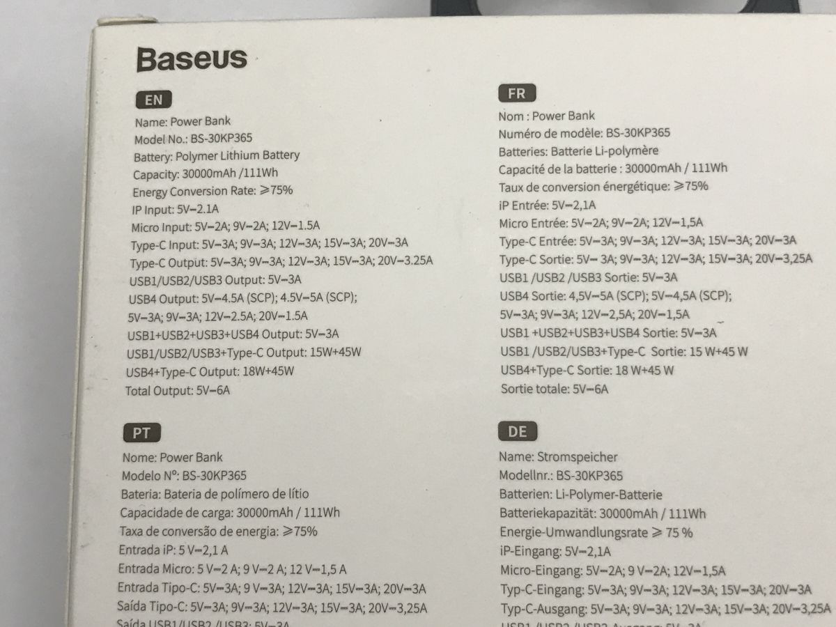

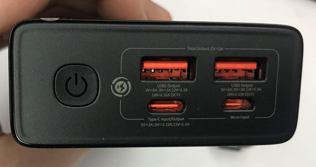

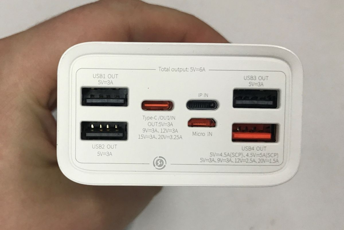

    Port descriptions? Model name? Everything is labelled in detail and clearly.

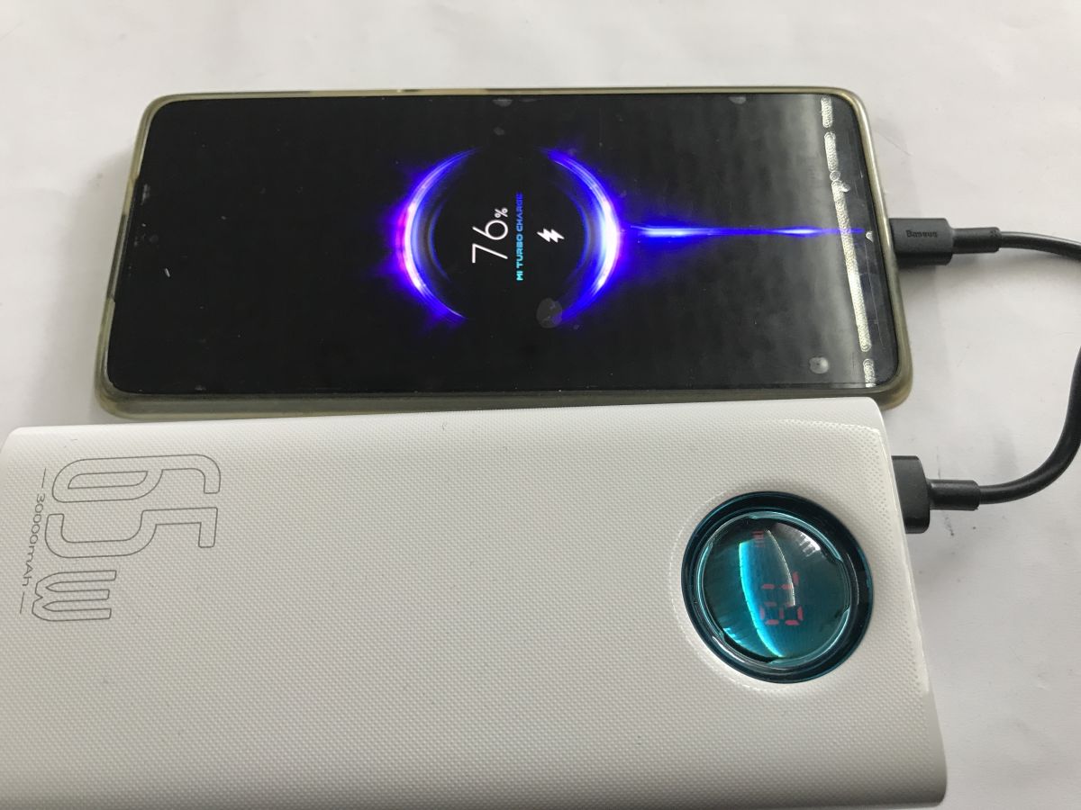

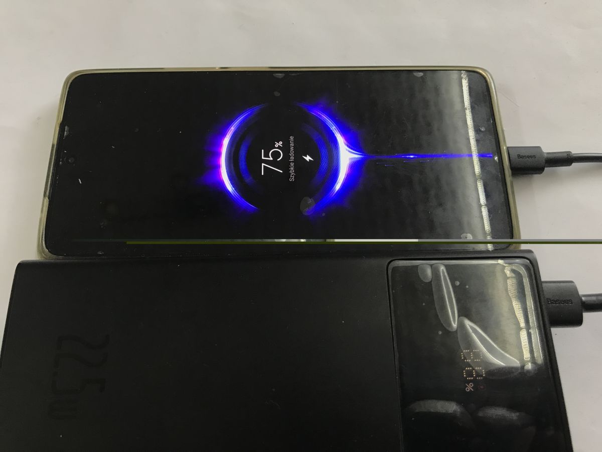

    First, something simple – charging my Xiaomi. And here’s the first plus point – it supports not only standard QC, but also the even faster MI Turbo Charge.

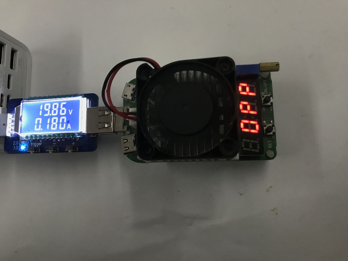

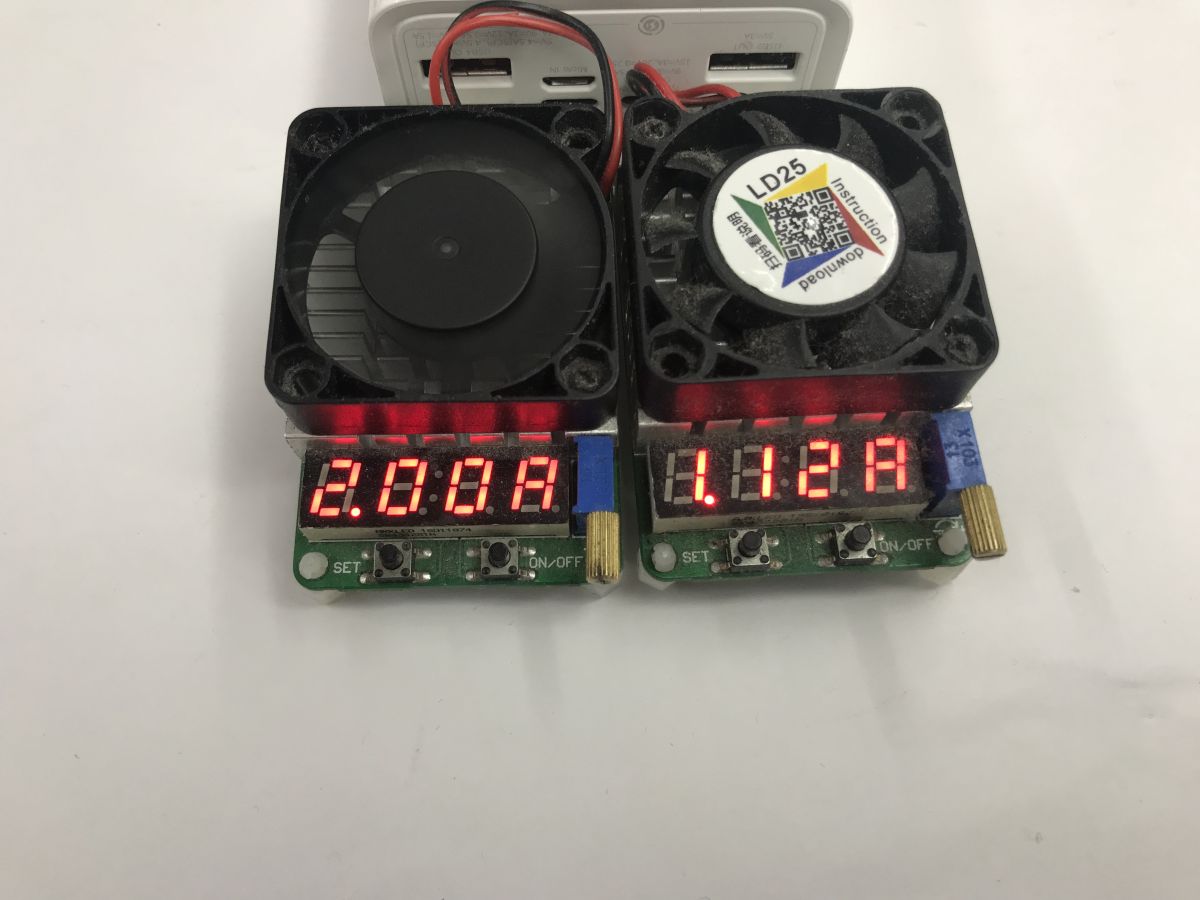

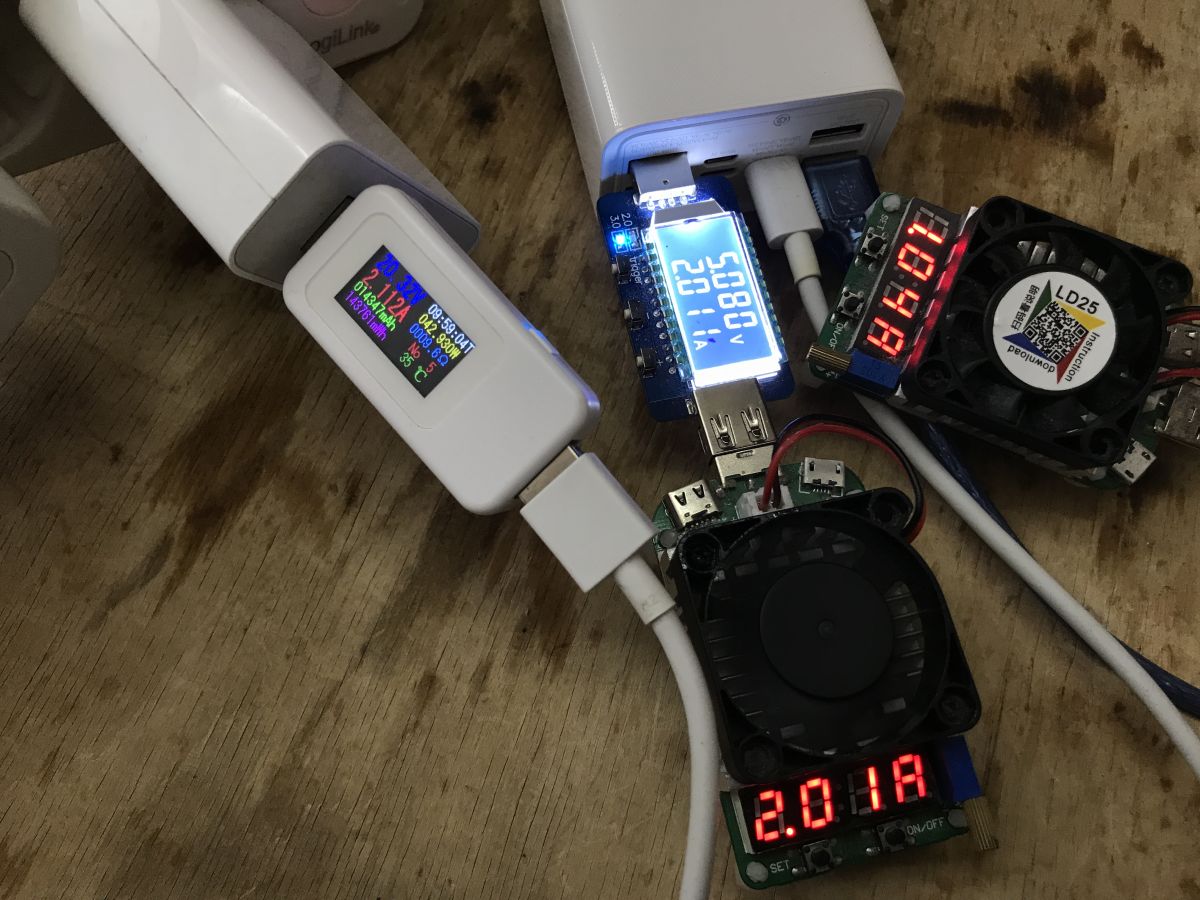

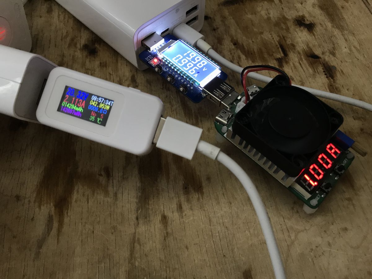

    Now, current output and QC. Yes, you can set it to 20 V. You can even draw nearly 2A at that point, but my load cuts out at that stage, so I wasn’t able to reach the limit.
    I’m getting an OPP error (Over Power Protection) on the LD35.

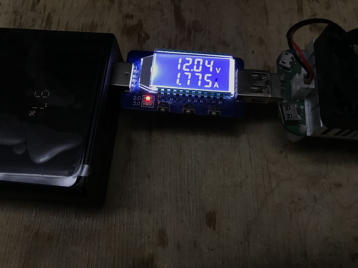

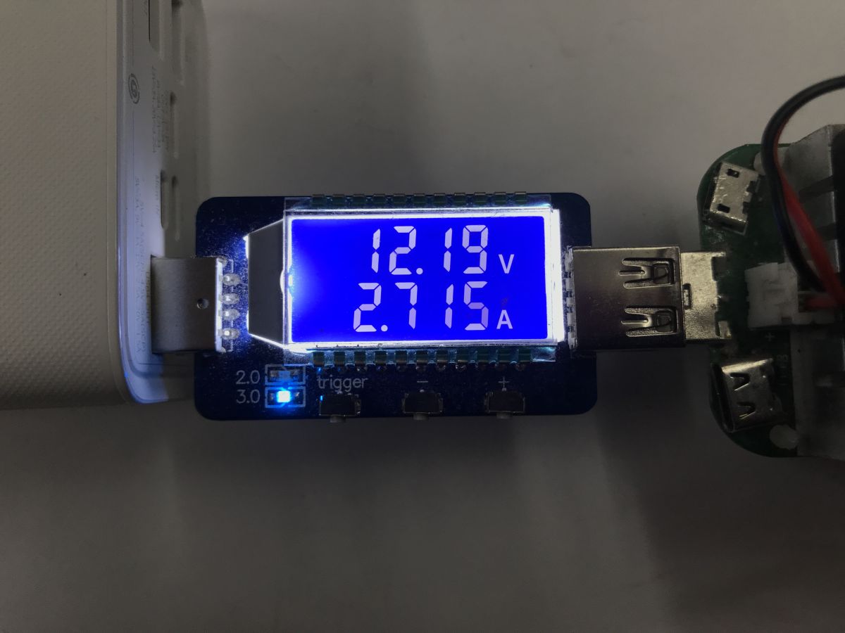

    At 12V, I can draw just under 3A:

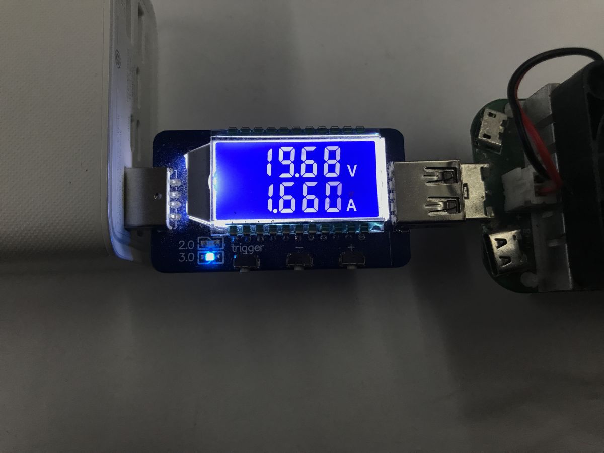

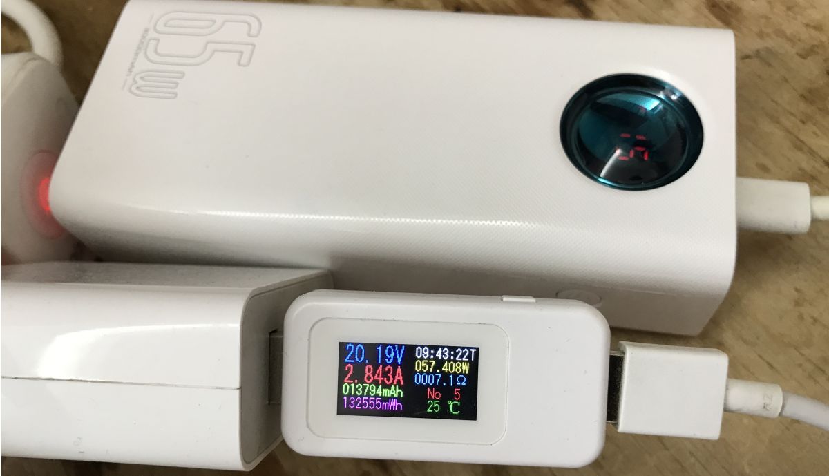

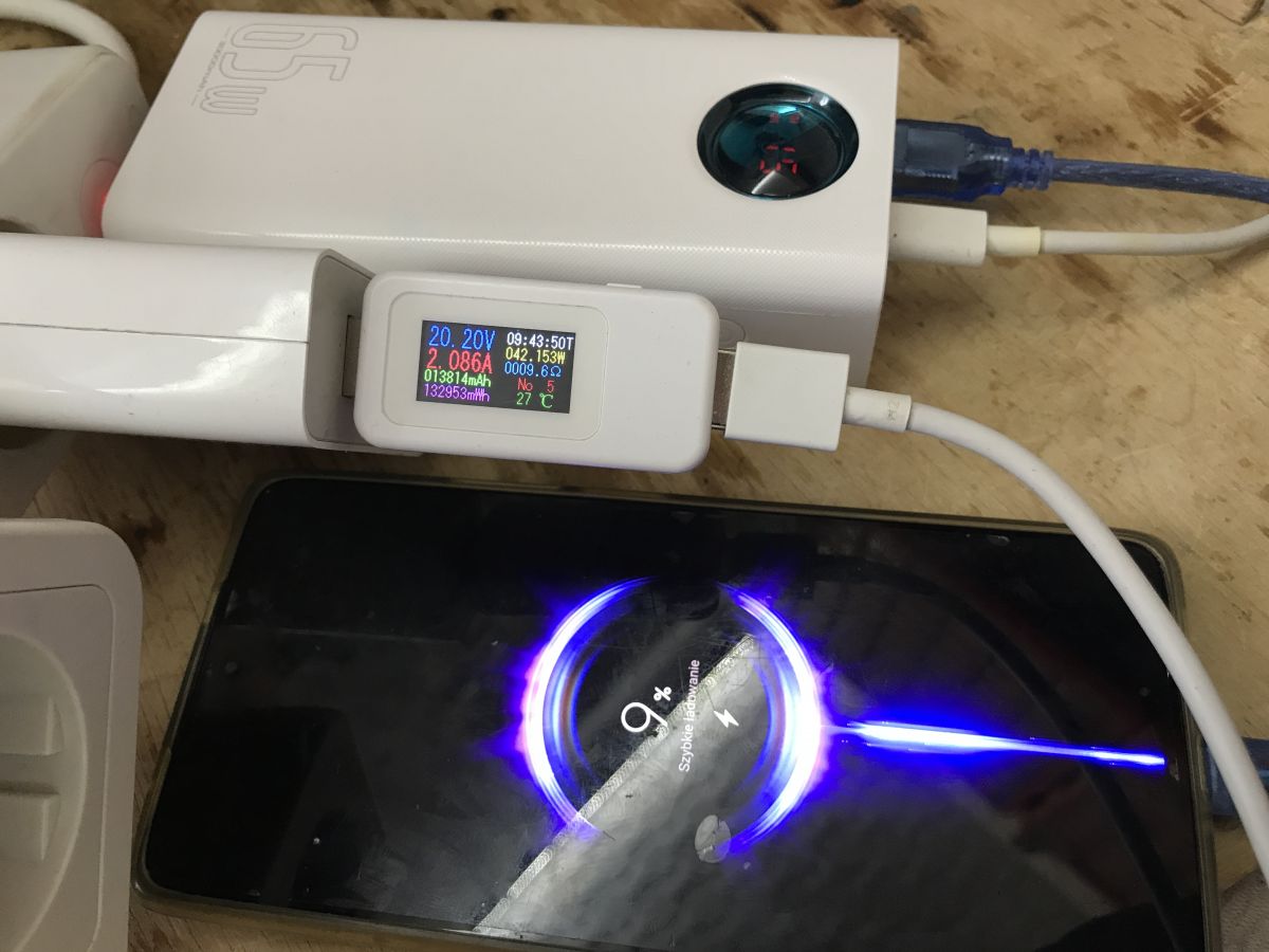

    The device is capable of drawing a good 20 V from a Xiaomi charger:
    What’s more, there’s ‘pass-through’ charging, i.e. 20 V goes from the Xiaomi charger, and then the Xiaomi device itself, connected downstream of the power bank, also receives the increased voltage. Normally, power banks do not allow this and will disable QC if something is connected to both the input and output.
    I looked into this in more detail and here’s an interesting point: this behaviour only holds true as long as one output port is in use. If I connect a load to the second port, the voltages drop and QC cannot be enabled.

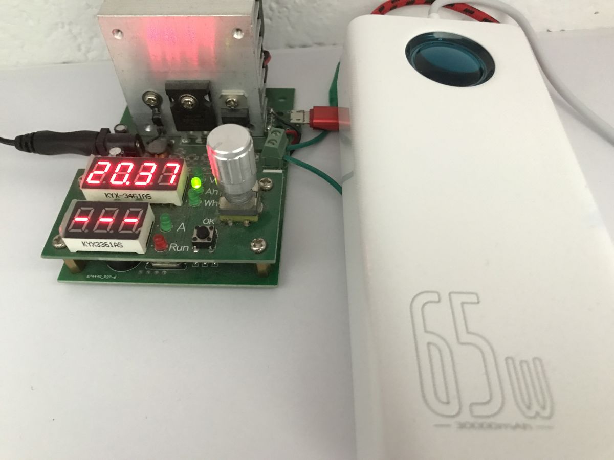

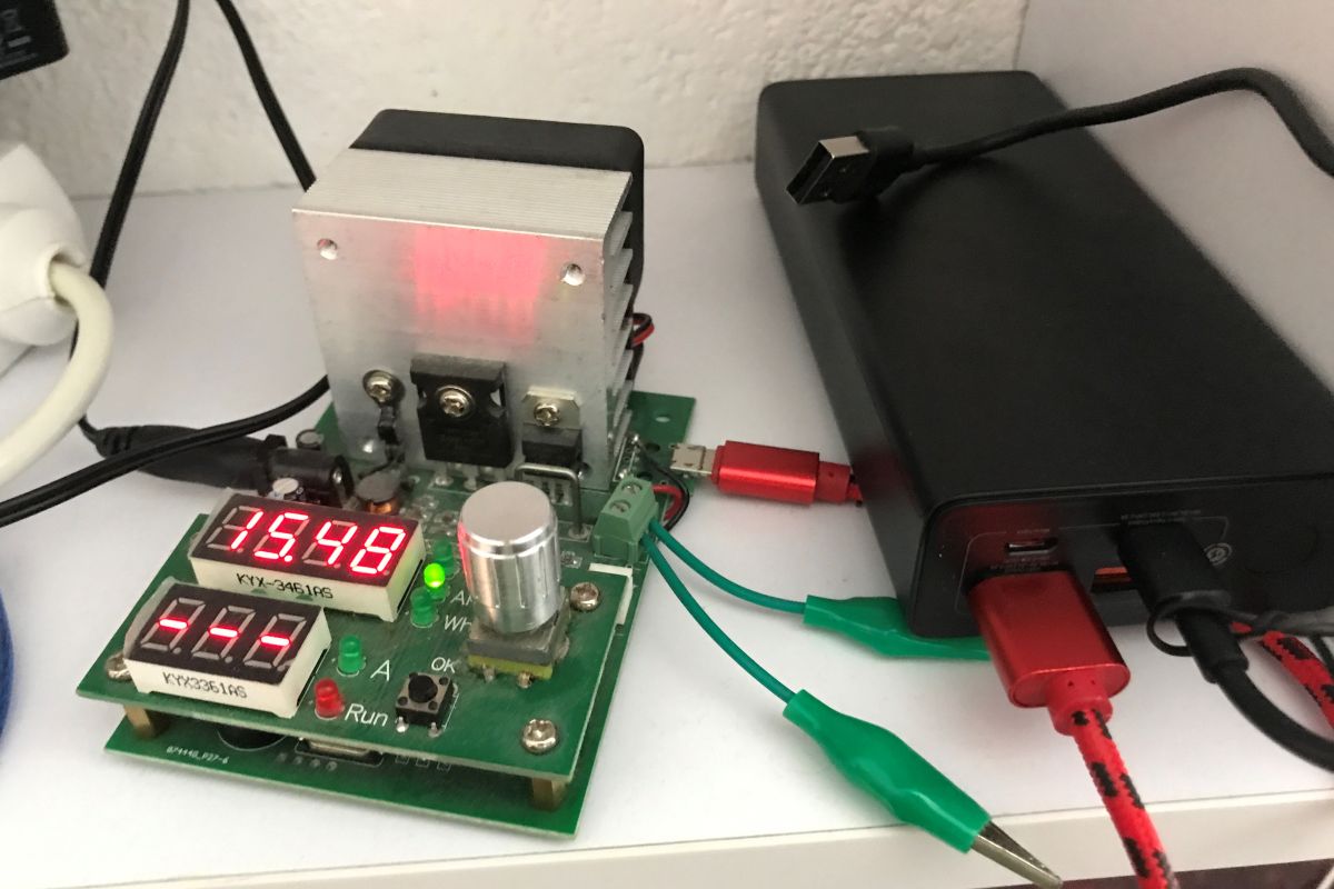

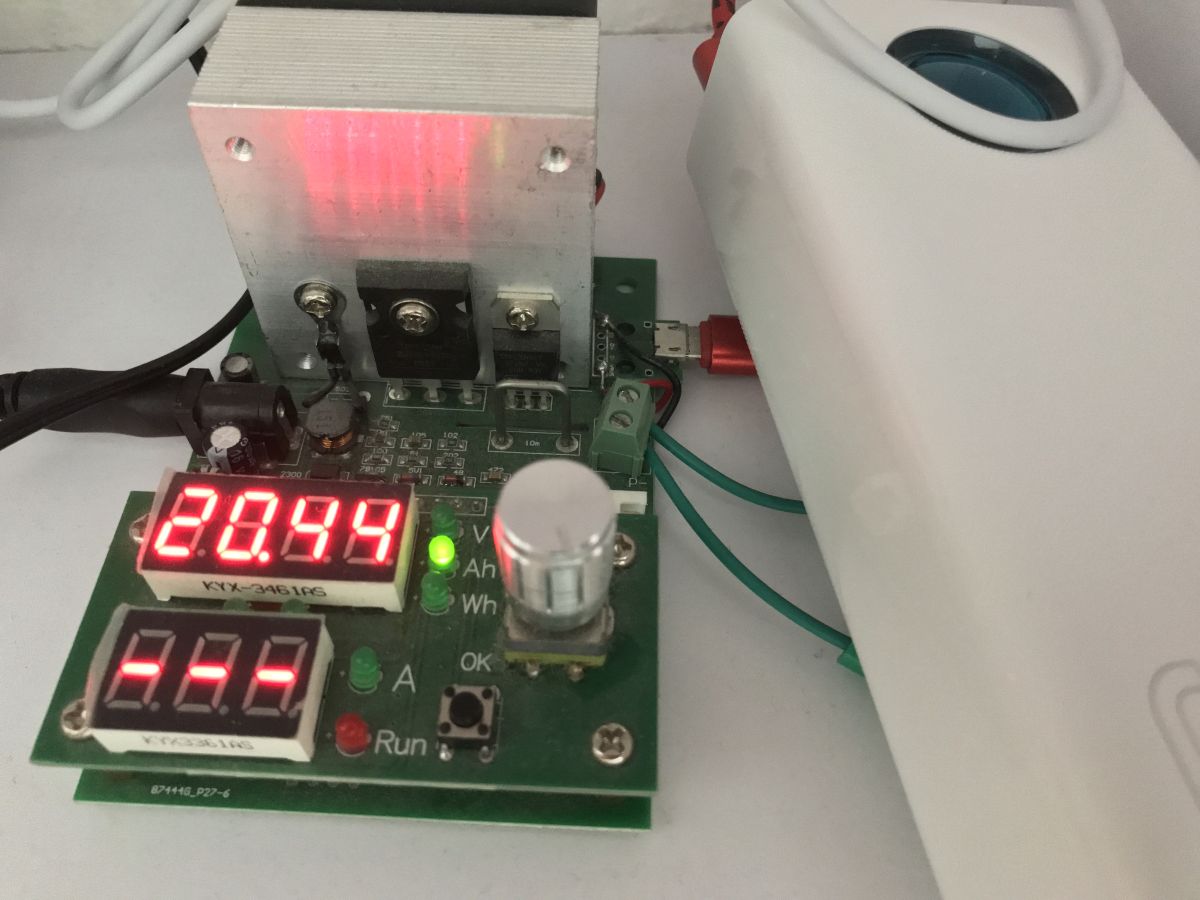

    The capacitance tests remain:
    In this case, I measured values ranging from 20.37 Ah to 20.94 Ah at a voltage of 5 V. Applying our standard conversion factor again (dividing by 0.65), this gives us a good result of between 31.3 Ah and 32.2 Ah of usable capacity per cell. This is further proof that branded equipment not only lives up to its promises but actually offers a slight margin above the promised 30,000 mAh.
