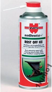

    1marek133
    Rate: 8
    How about: "WURTH ROST OFF ICE Spray", I have a problem in Lanos, I soak in kerosene, and if it doesn't let go, it's the last chance. If someone used it, let him write, because the contraption is not cheap.

  • #22 10079498
    ociz
    Posts: 15844
    Help: 1379
    Rate: 3486
    Recently, I got a power steering cable with a baked clamp on the tube (I had to dismantle the gear to unscrew it) and since I had time, I tested various inventions, including a freezing one, but of a different brand. None of these sprays worked, only the burner did its job.

    I unscrewed a tool similar to the one in the picture at the cylinder, and at the flexible hose I have a massacre, I soak it in kerosene for the second day and tomorrow we'll see what comes of it. In the morning I'll go get some better tools and look for this drug. If it doesn't help, I'll have a brand new set for the left rear, which I want to avoid.
