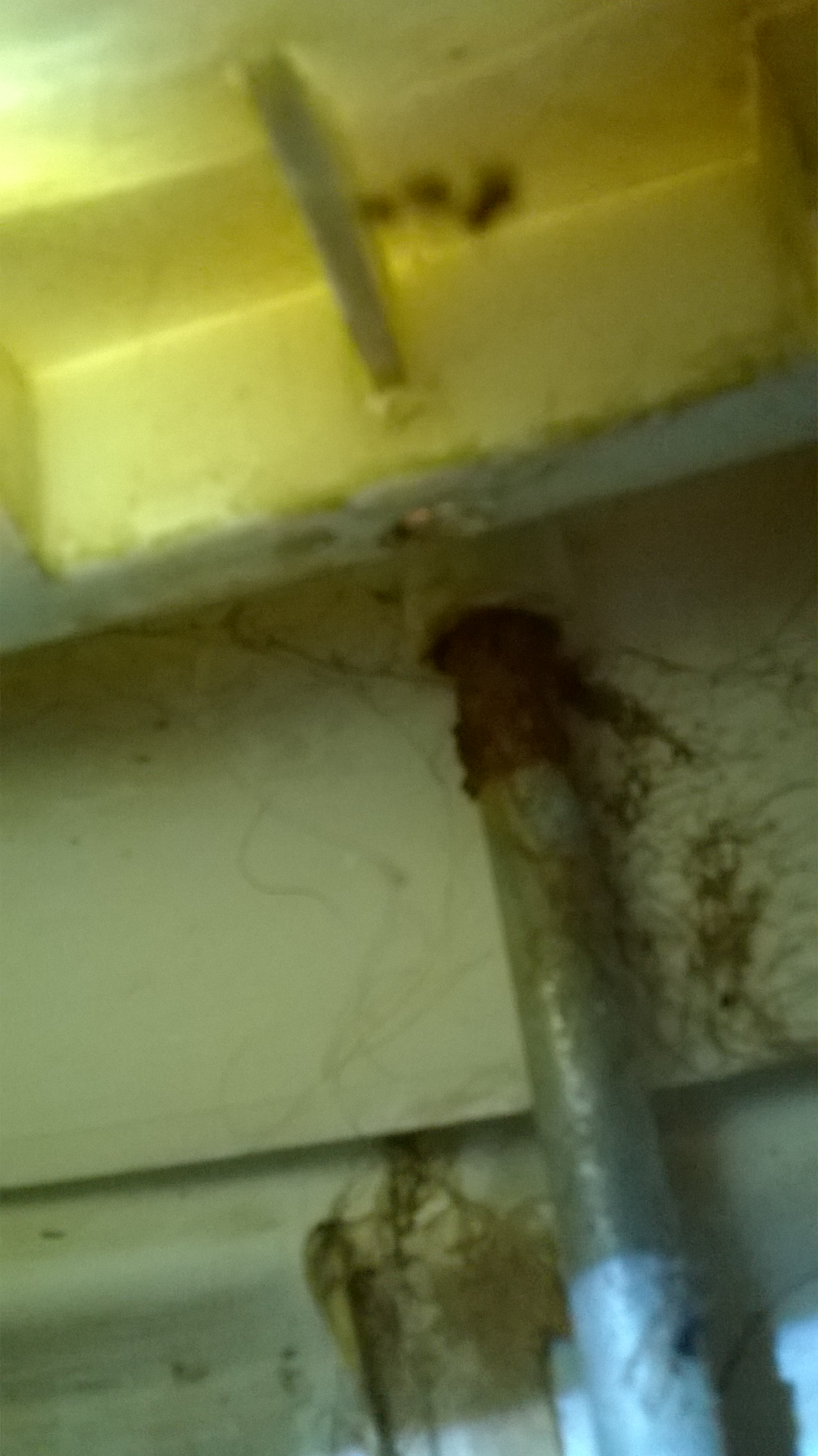

    tomi137
    Hello, I have a franie centrifuge and a few days ago the rubber holding the engine broke. I have to pull out the drum to get to the bottom, but I can't because removing the cover blocks a plastic brake at the top, connected to a rod and a rubber cap at the bottom. Does anyone know how to disassemble the brake and remove the cover? I plan to remove the cap at the bottom of the brake, but it rusted and I am afraid that there will be a problem with reassembly later. One more question - how to unscrew the plastic cap? I tried to unscrew while holding the screw on the bottom, but I don't want to move.

  • #2 16638668
    stanislaw1954
    Posts: 15132
    Help: 2003
    Rate: 4624
    Take another picture of the brake at the top from a horizontal position facing the end that goes into the housing.
  • #3 16638701
    tomi137
    Was this the photo you wanted? The first photo down (the rod at the bottom probably has a rubber cap). Second photos are the top where it enters the plastic handle.

  • #4 16638826
    stanislaw1954
    Posts: 15132
    Help: 2003
    Rate: 4624
    I was more concerned with the plastic handle as it is connected to the rod, looking above the lid to see if there is a pin that connects the shaft to the handle. I used to replace the rubbers that held the drum, but it was a few or maybe ... ten years ago and I don't really remember.
  • #5 16638908
    tomi137
    Unfortunately, it cannot be checked, because there is no gap between the handle and the cover to see how it is mounted, and the handle has no bolts, pins, screws, etc. I tried to feel with my hand but I did not feel anything moving.
  • #6 16639165
    stanislaw1954
    Posts: 15132
    Help: 2003
    Rate: 4624
    If you are sure that this is the case, then everything that is put there must unscrew from the bottom of the knob. It must be sprayed with a rust remover, eg WD.

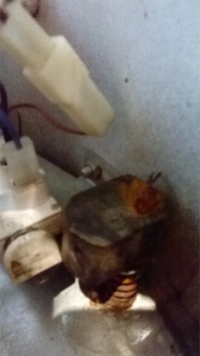

  • #9 16659247
    tomi137
    The bottom cover cannot be removed because it is welded to the structure, I also cannot unscrew the brake from the bottom, I sprayed it, but the screw is irregular in shape and it won't unscrew. (picture)

  • #10 16659333
    stanislaw1954
    Posts: 15132
    Help: 2003
    Rate: 4624
    tomi137 wrote:
    i cant unscrew the brake from the bottom either i sprayed but the bolt is irregular in shape and i don't want to unscrew. (picture)
    Tap with a hammer and then use a Mors pliers or similar instead of a wrench.
    #11 16660044
    zhudomel
    Home appliances specialist
    Posts: 4993
    Help: 1280
    Rate: 3368
    - after all it is disassembled.
    tomi137 wrote:
    I also can't unscrew the brake from the bottom
    - the brake is inside the engine. What you can see in the picture is the switch mechanism and there is no screw; there is only a cotter pin, after which the switch cam is pulled up. Why bother. You can replace the engine hanger without disassembling this mechanism. But if you want to make a mess ...
  • #12 16660110
    peter falk
    Posts: 7549
    Help: 1158
    Rate: 3357
    zhudomel wrote:
    Well, because it is:
    https://obrazki.elektroda.pl/1159248500_1502554082.jpg
    And in the above photo hangers can be seen.
    tomi137 wrote:
    removing the cover blocks the plastic brake at the top
    Yes. Taking it off makes the job easier, but to take it off you have to activate additional brain ganglia :D
