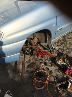

    Today, briefly on the subject.
    You want to replace the brake disc and come to the moment you unscrew the bolts securing the yoke.
    If you downplay this fragment, you will treat yourself to a string of unnecessary material losses and labor-intensive activities.
    The photos discuss the process on the example of citroen berlingo. Unscrewing Screws from Brake Yoke: Step-by-Step Guide for Citroen Berlingo Brake Disc Replacement Unscrewing Screws from Brake Yoke: Step-by-Step Guide for Citroen Berlingo Brake Disc Replacement Unscrewing Screws from Brake Yoke: Step-by-Step Guide for Citroen Berlingo Brake Disc Replacement Unscrewing Screws from Brake Yoke: Step-by-Step Guide for Citroen Berlingo Brake Disc Replacement Unscrewing Screws from Brake Yoke: Step-by-Step Guide for Citroen Berlingo Brake Disc Replacement Unscrewing Screws from Brake Yoke: Step-by-Step Guide for Citroen Berlingo Brake Disc Replacement Unscrewing Screws from Brake Yoke: Step-by-Step Guide for Citroen Berlingo Brake Disc Replacement Unscrewing Screws from Brake Yoke: Step-by-Step Guide for Citroen Berlingo Brake Disc Replacement Unscrewing Screws from Brake Yoke: Step-by-Step Guide for Citroen Berlingo Brake Disc Replacement Unscrewing Screws from Brake Yoke: Step-by-Step Guide for Citroen Berlingo Brake Disc Replacement
    The bolts from the yoke are originally tightened with a high torque and fastened with the use of demountable adhesive - blue color on the threads.
    In many parts of the network there are tips that partly answer the question.
    Take the basic advice:
    - apply all the given methods at the same time and the screws will unscrew !!!
    -adjusting only some methods will damage the milling cutter on the t55 torx
    - most often the screw is damaged by jumping out of the key from the screw during unscrewing
    - it should be added that the screws are hard to reach - service
    So, go to work:
    - use keys of good quality
    - the key knob can not be shock absorbed - 3/4 inch lever with reduction
    - lock the key when unscrewing with the carpentry clamp - the most important
    - place the thread with a small burner around 200 °, cover the rubber gaskets
    tin from a beer can
    -the burner must have a narrow stream of fire
    - unscrew the screw with the help of the applied pipe on the knob
    - do not use loosening by slow pressure on the key
    - do not forget about hitting the screw with a hammer
    -you can also make a stroke in the side of the screw by using a chisel
    As you can see in the pictures, the screws are not corroded so pouring them with all sprays brings a small effect.

    I will add a torx socket well from me because you can make a mistake in the choice of torx.
    And after the bolt I beat it with the torx inserted.
    I prefer to destroy torx like a screw.

    I would add that it is best to use sockets 1/2 inch impact type.
    During loosening they absorb the least. Unscrewing Screws from Brake Yoke: Step-by-Step Guide for Citroen Berlingo Brake Disc Replacement

    k. przemo 27
    probably it is not the original lubrication of the slide, but as a syringe through the rubber cover you will press the lubricant.
    Many years I used oil / even burned / and it was a better solution than dry work with rust in the middle - so good manufacturers of cheap replacements.

    andrzej123456 wrote:
    but as you push the syringe through the rubber cover you will press the lubricant.
    It undresses and cleans or eventually exchanges like corroded echoes ...

    k. Jan 1815-
    -the idea of replacing the torx screws with an ordinary hexagon - after a slight corrosion in the hexagon, the keys rotate and after the event - checked and that is why the car industry uses torx
    k.vogelek1-
    I think that pre-tightening is more risky than hitting a screw with a copper hammer and gives the same effect!
    To all-
    I see that colleagues forget that the discussed screws combine demountable adhesive and this completely changes the situation.

    Heat the screws with a burner, then pour water so that you can touch the screws, then it goes lightly.

    The article is about loosening screws.
    The parameters you are asking for are in the service manual.
    In my case, the yoke bolts were on blue glue - a nightmare.
