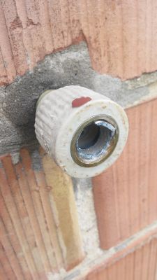

    When trying to replace the ball valve to go under the garden hose, the valve was of such quality that it broke off and the thread remained inside (photo attached).
    Anyone have any idea how to unscrew it? I tried to unscrew the entire plastic tip because it would be more convenient, but it doesn't work, it sits firmly, turns the whole pipe released from the house outside. It is true that I only have one pipe wrench and it is hard to hold it against the wall with my hand so that it does not rotate the whole thing, but I have the impression that it would not help much anyway.

    Try to use a narrow blade to cut the thread remnants and bend them inwards with a screwdriver and either chip them off or unscrew them with pliers.

    The only way out is to gently crumble this "znal" or whatever it is. Be careful, because these brass inserts tend to break.

    The option with a saw blade is out, there is no way to undermine it and grab it. I don't understand what I'm supposed to do with it?

    Buddy, a jigsaw with a metal blade. Make a few cuts along the perimeter of the broken thread. Be careful not too deep.
    Then, with a flat screwdriver, try to pick out one cut piece of thread, the other pieces are easier to pick out.

    Spray with penetrant (CX, WD m, kerosene, brake fluid) overnight, make something like a knife with a double-sided blade (I use an old, properly honed chisel) and turn it gently into the broken element. Of course, you need two good wrenches, one for cobra type plastic and any adjustable flat wrench, preferably with two people.

    On the opposite sides, saw the grooves to the maximum depth so as not to damage the threads in the brass. Adjust the appropriate flat bar to the grooves made. Holding the wrench on the plastic, try to turn the flat bar. It's a good idea to use penetrating agents.
