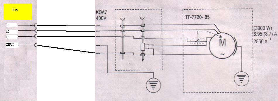

    And I have a different question. I have 1-phase and 3-phase sockets at home. How it looks in the switchboard. Usually, power supply in sockets, i.e. 230V, is it just a pulled out phase of these three? Is there a separate 3-phase cable and a separate 1-phase cable to the building? Is it like the picture? Can 220V lines be pulled from any phase? You can divide them, i.e. that on one floor the 230V line will be from one phase and on the other from the other or the third?

    1.4 cables come to the house (probably phase1, phase2, phase3 and zero)
    2.I have 3 large fuses on the main board - so I'm guessing that between 1 and 0, between 2 and 0 and between 3 and 0? So there are 3 phases of 220V each
    3. The garage has a 380V 3-phase power supply with 4 cables as at the entrance to the house. I bought a 3-phase saw but it has 400V which according to the store is the same as 380V ??? but it has 5 cables for the plug and is supposed to fit easily into my 4-wire installation - 380 + 400 is probably a rounding? but I don't really understand how a 4-cable installation is supposed to fit seamlessly into a device powered by 5 cables.
    4. According to the star-delta diagrams drawn above, I conclude that there are 230V three-phase motors and 400V three-phase motors ??? I am asking for this because in the same store there is a 220V saw with the same power and the seller said that if you also have 380V, it is better to take 380 because it will not load one fuse 220 but the current consumed will be divided into 3 fuses and then the fuses can be smaller and they will not heat up so much, and besides, 380V with the same rated engine power as 220V is stronger than it ????
    5. Why, according to the figures above, 230 + 230 = 400 and not 460?
    6. Where should I get the missing fifth wire for connecting the saw in the garage and what is it needed for?
    7. Does the sequence of phases (wires) in the plug matter?
    8. that is, looking at the above drawing - my current 400V saw has a TRIANGLE system because it would not be 400V in the star? And where is the ground or zero connected in the triangle connection drawing? Why for a 3-phase installation according to these drawings, you can use a 3-core cable, once a 4-core cable, and according to the saw that I have purchased, even a 5-core cable ???? Is the 3-phase installation not the same everywhere and if not what for (advantages and disadvantages) ???
    I am asking for help because I have a saw that I cannot use because I do not know how to connect it "without any problems" with my installation and thank you in advance for your help.
    PS.
    I am asking for simple answers, because the formulas and elements presented by someone do not tell me anything and I did not understand any of them.

    So:
    1. You think well
    2. You think wrong. If they were between phase and zero, they would burn out immediately (the fuses are plugged in series with the receiver). They are like in the picture:
    Understanding 230V & 380V Current Phases: Wiring, Voltages, and Changing Direction of Power Motor
    3.6. Figure above. You have an old (4-wire) system at home. Now a new one (5 wires) is used. The fifth conductor is ground (so-called protective zero). All devices manufactured now use this system (if, of course, their construction requires grounding).
    Why higher voltage? If you remember that one year there was a change in the mains voltage (increase) - the voltage of 220V was increased to 230V and 380 to 400V. Old voltage devices will operate with a higher voltage (at least the vast majority of them).
    As for the fuses, the seller was actually right. The three phases are evenly loaded, so there is less current flowing in each of them than would be to use only one phase.
    7. Yes, it does. The saw will spin the other way. If there is no right-left switch, you have to swap any 2 wires phase with each other (thin pins in the plug). DO NOT SWAP PHASE WITH ZERO!
    The saw motor can be considered a little bit, without disassembling the device you cannot be 100% sure (if it is not stated on the plate). Although, as a rule, low-power motors are delta-connected (they do not have heavy starts).
    What about the protective conductor? Install a new socket in the garage and bridge the protective zero with the working one in the socket. The equipment will work, but I don't know how it relates to electric shock protection, so it's better for my colleagues to say something here.
  • #18 5720607

    Thanks for the quick reply. Some of my doubts have been dispelled, but not all. I would like to know more:
    1. According to the previously drawn star diagram, is it a 230V 3-phase motor? I am asking for this because in the same store there is a 220V saw with the same design, power and price as my 400V.
    2. Is the 230V 3000W motor weaker than 400V 3000W?
    3. I found one topic on this forum where it says that you can bridge 0 with mass, but only in one case. Unfortunately, it is a bit unclear in this thread and I cannot understand if it can be done in a 4-wire device to fit a 5-wire installation or vice versa - i.e. in a 4-wire installation to match it to a 5-wire device.
    4. Where is the grounding coming from - probably not from the power plant? If not, then in some simple way I could connect the earth electrode, for example, to a central heating pipe or dig into the ground and the issue of the 5th cable would be solved?
    5. if the sequence of phases (wires) in the plug is important, why can ANY phases be changed and not in some specific order? For example, the required order is 123, so to reverse the engine speed it should be 321 and not 132?
    6. Where in your triangle connection drawing is ground or zero connected?
    7. Why for a 3-phase installation, according to your drawings, you can use a 3-core cable once, and once a 4-core cable, and according to the saw that I have purchased, even a 5-core cable ???? Is the 3-phase installation not the same everywhere and if not what for (advantages and disadvantages) ???

    The engine has 3 coils. If they are designed for 400V voltage, they can be connected in a delta (see, each of them will be 400V) and star-shaped, but then it will be weaker (there will be 230V on each coil).
    If, on the other hand, the engine has 230V coils, it can only be connected in a star (if we connect it in a triangle, we will burn the engine).
    I am talking about 3-phase motors. There is probably a 230V 1-phase saw in your store. Theoretically, power is power and it shouldn't be weaker, but I have never checked things like this before.
    As for the phase sequence, see:
    123 123 123 123 - this is how the voltage on individual phases goes, if we change the voltage, see:
    132132132132 - do you see? Also it's 321, no so it doesn't matter :)
    You can make an earth electrode yourself - as you say, a flat bar is buried into the ground. Unfortunately, it must be done at an appropriate depth, because the earth electrode must have as little resistance as possible, it must be checked with a special instrument. In a word - the saw itself is not worthwhile.
    You will always connect a 4-wire device to a 5-wire installation - the protective conductor (PE) is not used then.
    Bridge both the N and PE conductors and connect the saw.

    For MW-750. Compare the drawings.

    Almost everything is clear. There is only ZERO left - where does it run on the side of the network (power plant, nearest transformer or to the soil as mass) and where does it go on the engine side (see my diagram)? could the thermal switch cut off 1 winding and switch it to zero? So zero would be very important at this point. And what about this power - why did the store say that 3000W 3-phase is stronger than 3000W 1-phase.
    In this case, the problem would start - I would not like to interfere with the installation of the device, if only for this reason, so as not to lose the warranty. I was hoping that everything would be successful at the level of mixing with the plugs and cables in them :cry:
    And would such a simple solution work? The equipment will work? If so, in this case I will avoid rummaging with electricity (I will fix the plugs away from the electricity myself :D ), calling an electrician (cost) or voiding the warranty of the device (I will not rummage in it).

    I made a cable according to my last diagram and the saw works. So I am waiting for information on previously discussed topics:
    1. 220-380 power comparisons
    2.what will be with the thermal switch from my diagram with the current settings
    3. if and why the engine breaks down due to the lack of one phase.

    WHAT ABOUT MY CONNECTION DIAGRAM? The thermal sensor is drawn on the engine? What does he disconnect and what does he switch to? What about the switch assembly - there is also something like a resistor or a coil and what does it switch on and off? Does my cable have the correct connections to the saw according to my diagram? I am interested in this because the engine is hot after an hour of operation and the thermal switch has not worked even once. Maybe it is not the switch-off temperature yet, maybe the thermal switch is defective, or maybe the missing PE wire causes the switch to not work? I work with my soul on my shoulder because I don't know if everything is OK - give me a hint.

    Bridge the zero with the PE wire (casing) - in the event of a breakdown, it will protect you against electric shock. It looks like the saw has a built-in residual current circuit breaker and when we have 5 wires, it protects the user against electric shock.
    If the saw gets hot, check the manual how much it can work - often the current Chinese devices cannot work for a long time. The engine should not be more than approx. 70 - 80 * C
    Currently used saws most often have the function of braking after switching off. This may cause the engine temperature to rise slightly. It may also overlap with a bit of over exploitation of the device.
    In non-professional devices, the power of the device is not always well suited to continuous operation. There may be, for example, too low engine power in relation to the saw diameter or ..... it is not known yet what. You asked for a wire that is disconnected by a thermocouple. I can see that the motor is switched on with a contactor, and the contactor is controlled by a coil, one pole of which is disconnected by a thermic. Activation of the thermistor causes no control of the coil and as a result all power phases are disconnected. You asked why a 1-phase and a 3-phase motor with equal power ratings can have different powers. Theoretically, it can be proved, but I will say this: it is about voltage drops. Someone has already explained it to you on this topic. Connect, for example, a 230v extension to such a saw only with a 1-phase motor. the pre-bed is, for example, 35m. and it is, for example, 3x2.5. the current flows through 2 wires and you get power from 230v. you now have 35 m of 5x2.5 cable. The current flows through the wires and the power is obtained from the voltage of 400v. I don't know how to picture it to you otherwise.
