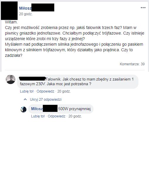

    Is it possible, for example, to make a three-phase inverter? I have a single-phase socket in the basement. I would like to connect three-phase. Is there a device that can do three phases from one?
    I was thinking about connecting a single-phase motor and connecting it with a V-belt to a three-phase motor that would act as a generator. Will it work?

    Maybe I will answer for the author who went to the Facebook group for advice. I'm in the same group.
    Converting Single-Phase to Three-Phase: Inverter, V-Belt Method & Possible Solutions
    So we have a power requirement of min. 500W.
    But we are waiting for an answer regarding the requirement of 3x400 or 3x230.
