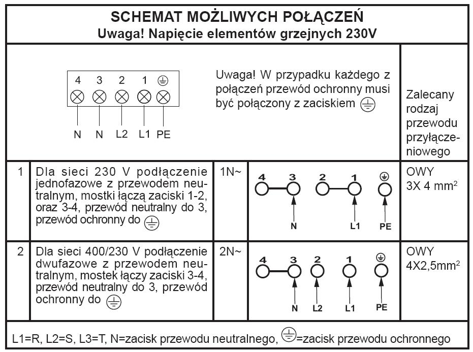

    I have a few doubts whether I understand correctly the principle of operation of a three-phase installation.
    With single phase it is straight, blue is neutral, green and yellow is ground and the other color is 230V phase.
    At the outset, I will say that I mainly rely on this scheme.
    https://obrazki.elektroda.pl/6007955400_1346959155.jpeg
    There are 5 wires, blue is zero, green and yellow is ground and the rest are phases.
    I understand that. However, the so-called "strength" is a voltage of 400V. From what I have deduced, it is as if 3 phases together give 400V, and each phase separately is 230V. And taking a single phase, it can be treated as a single-phase installation (i.e. connected to 230V sockets, etc.). And generally, these phases are interchangeable (so long as not to bridge them). Am I wrong?
    I was also interested in a rather strange entry regarding the connection of an induction cooker.
    Specifically - induction hobs usually require only two phases to be connected, and the third one to connect to the neutral wire, but would the fuses not work then?
    I do not fully understand the principle of operation of this installation and it is hard to read something more specific.
    Specifically - induction hobs usually require only two phases and the third one to be connected to a neutral conductor
    Give a specific example, the model of the oven, the diagram.

    rafik54321 wrote:
    and the third to connect with a neutral conductor
    Indicate in the diagram that the L3 phase is connected to the N terminal.
    Specifically - induction hobs usually require only two phases to be connected, and the third one to connect with a neutral conductor, however, would not the fuses be fired then?
    I do not quite understand the principle of this installation and it's hard to read something more concrete.
    Nothing like that on the diagram you have presented.

    It is not about the fact that the installation scheme (ie the first post) was exactly the same as in the oven diagram (ie from my second post).
    Rather, it should be treated as separate issues regarding the same installation.
    Let's say five wires stick out of the wall. 3 phases in different colors, zero and grounding. The last two are very easy, it is also easy to connect L1 and L2 (if all phases are interchangeable), but what about L3? Where does the entry about the L3 and zero connection come from? I do not understand that. And such an entry was in the vicinity of the oven pattern and it seemed absurd to me, so I ask.
    Now a separate issue. If I have a three-phase system, and I need 230V power, eg for a computer, is it enough that I take any phase? Is the topic more complex.

    In the second case, the "power" third phase remains unused. However, the terminal 3 and 4 should be bridged in the oven. So many theories. In practice, you should call a "professional" because, as in any instruction for this type of device, it is written that the connection should be entrusted to a qualified electrician. And that's what I propose to stick to.
    Nothing, instead of 3 phase, you connect N

    It is said that you connect N to terminal 3 and not to L3.

    I know, I understand that the schematic is that two phases are connected and the third oil is connected (no plugs are connected, and it is best to insulate it). This is how I understand and make sense. I mean an absurd note that was under the diagram.
    But I understand that it was a kit.
    This aspect can be ended.
    Now the question is whether to make a 230V installation in an apartment, for example, you can use whatever phase or should you use a specific one?
    I'm asking because I just prefer to know how the installation works in my house, which is possible, which is not possible. And as for the electricians' professionalism - I will leave without comment. I've seen a situation where 3/4 of the installations were "hung" on a 0.75mm2 cable, so I'd rather educate myself and know if the electrician will be kumaty or not.

    At the bottom it is no putty but a description of the former RST phase marking
    In principle, everyone, but sometimes happens, that the measurements come out, that the neighbors use L1 and L3 more, it is logical that we use the less loaded L2
