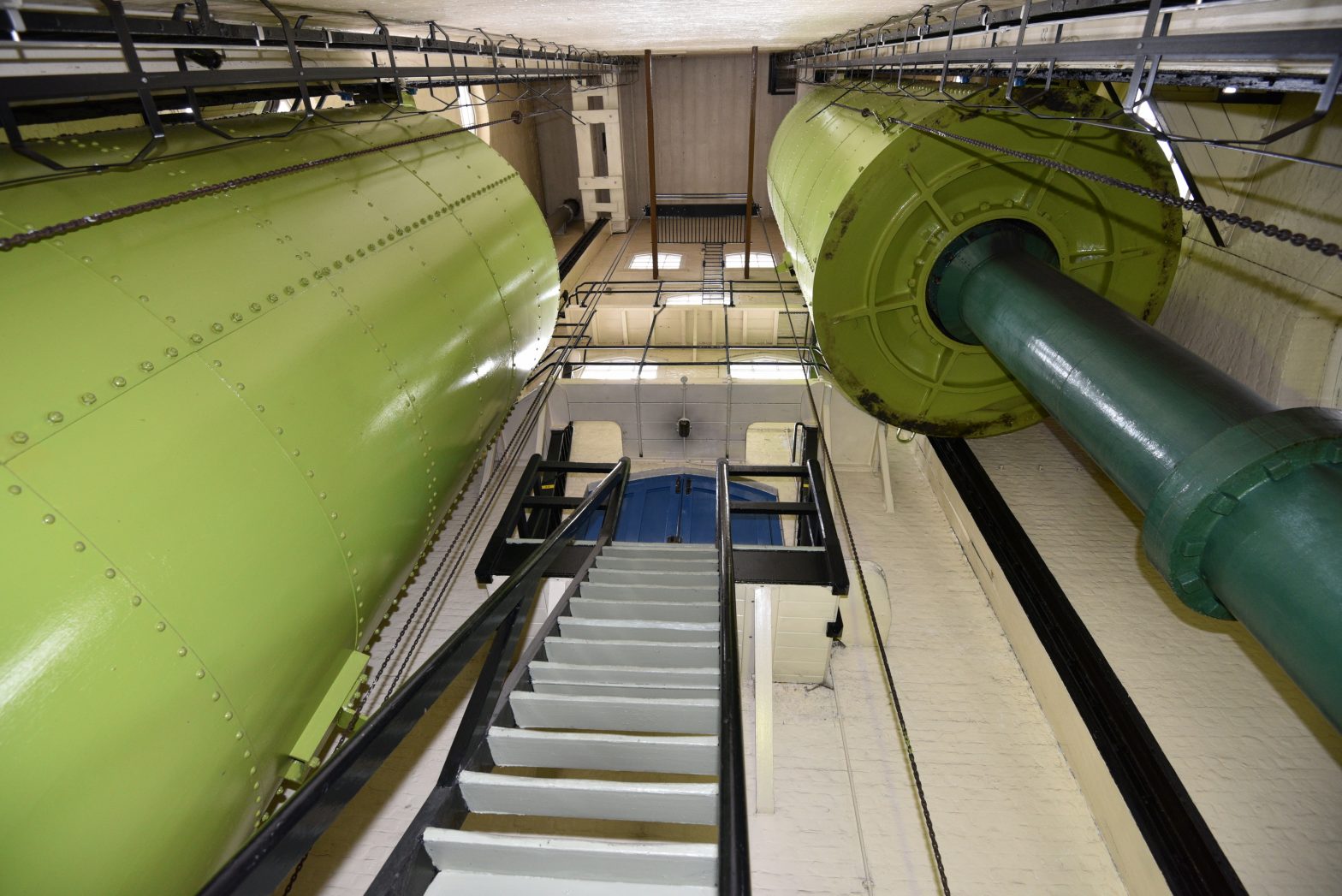

    I mentioned once that I saw such an accumulator but working in a hydraulic system -
    https://towerbridge.me.uk/wp-content/uploads/...e-engine-room-accumulator-tower-1568x1047.jpg
    The photo is from this site:
    https://towerbridge.me.uk/original-machinery/
    Can be visited in London.
    It worked for a hundred years - now the electric pumps have enough power to move the bridge without a gravity accumulator.

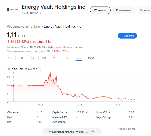

    Meanwhile, gravity drags Energy Vault's share value to zero
    A five-year stock value chart of Energy Vault Holdings Inc showing a decline.
    Maybe there should be a competition, for the energy storage company that has managed to deceive investors the longest.
