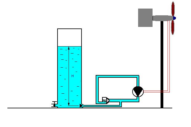

    Nardis
    Posts: 63
    Yes, @ Pietro54 - water is it!
    Here is a simple example of how this can be done:
    Calculating kWh for Lifting 2 Tons to 5m with a Gravity Accumulator Design
    Reliability guaranteed for decades (after using appropriate valves and a pump, e.g. a gear pump).
    How it's working? The windmill drives a simple gear pump, which forces the water to circulate through the hydraulic ram. In the tare, we close and open the valve cyclically, which causes huge pressure jumps and pumping water into the tank at the height of H. In fact, apart from the fan and valves, there is no need to service. :)
    greetings,
    Peter
    Added after 6 [minutes]:
    Of course, the ram also needs to be supplied with water to replenish the defect that is transferred to the reservoir.
  • #8 5384087
    stomat
    Posts: 5728
    Help: 257
    Rate: 1982
    And why not just use a mains-powered electric motor instead of building these wonders on a stick? This amount of energy will cost less than PLN 6 ANNUALLY. 0.03 kWh × 365 days × PLN 0.5 / kWh = PLN 5.47.
  • #9 5384120
    Pietro54
    Posts: 113
    Rate: 9
    But what are you talking about? What engine?
    Besides, you've been hitting the calculus, multiply the result by 24 and you'll be okay. ;)

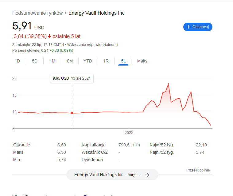

    vodiczka wrote:
    Bemx2k wrote:
    already today there are "gravity" installations that work well with an efficiency of 80%.
    They work :?: Then give a link to such an installation operating on an industrial scale.
    I do not mean a pumped storage power plant, and this is also a gravity installation.
    You say, and you have! It happened to me two years ago. I had to bury it, but I found it.
    https://www.gramwzielone.pl/magazynowanie-ene...azyny-energii-wchodza-na-rynek-duze-zamowanie
    I wentogle "gravitational energy storage" and your link appeared in the third position.
    Have they fulfilled the order :?: There is only information about obtaining the order and about the operating pilot installation.
    Energy Vault has so far built a 5 MW gravity energy storage. A demonstration installation is located in the Swiss region of Ticino.
  • #27 20114904
