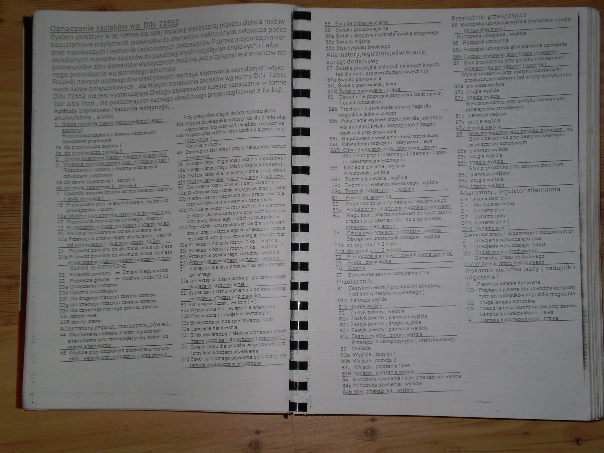

    so I googling and I can't find anything specific, the only thing that pops up for me is ready-made book publications,
    so I decided to ask here:
    Does anyone know where I can find a description of the color codes for marking wires in car installations and for the numbering of terminals
    I often see signs in the installation of cars and not only, for example "33a"
    is it somehow standardized and where can I find exhaustive descriptions.
    Thank you for helping everyone

  • #2 5393853
  • #3 5393874
    alfa32
    Posts: 19
    Rate: 15
    Thank you for the answer and the photo,
    numbers are already clearing up the situation,
    only the colors of the wires in the bundles, as I mentioned.
    Krzysiek
