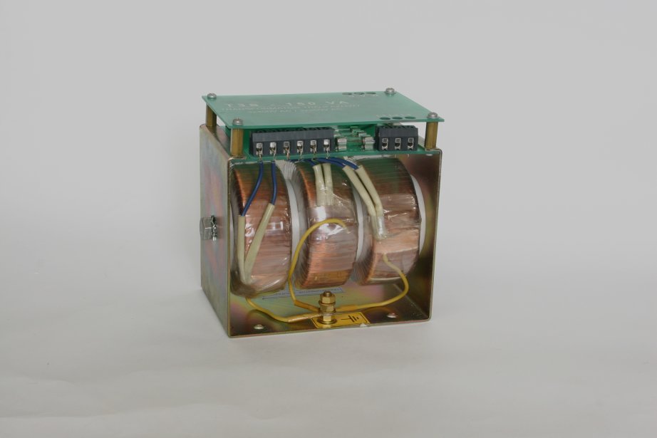

    Do PC ATX Power Supplies Output AC or DC Current and How to Identify Cable Voltages? When it comes to such a transformer, I have a very similar one removed from the monitor, the same one from which I removed the transformer multiplier.
