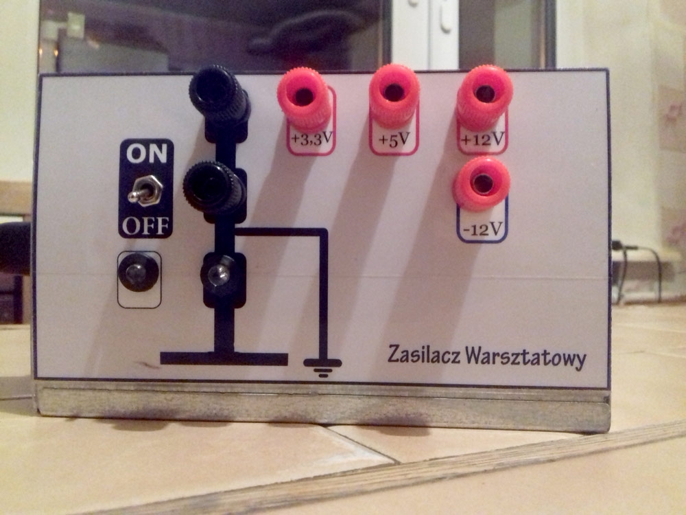

    The power supply is ready. I just don't know why
    at + 3.3V it is 3.46V
    at + 5V it is 5.46V
    at + 12V it is 11.08V
    and at -12V it is only -10.29V

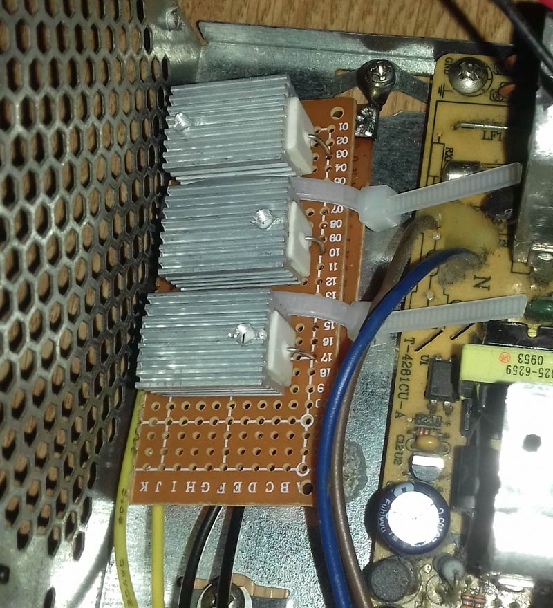

    Everything is fine. I connected two + 12V lines to 3 68 Ohm resistors. I equipped the resistors with heat sinks. Nevertheless, with the power supply turned on empty, the resistors get hot. You can touch it, but not longer than a few seconds because they burn. Converting ATX Power Supply for Workshop: Diode Resistors, Parallel Connections & 12V Line Load

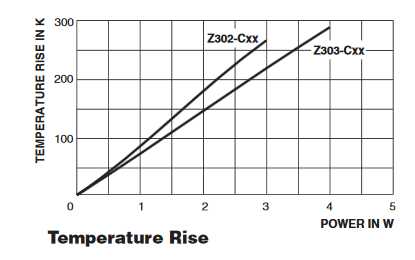

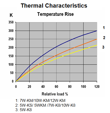

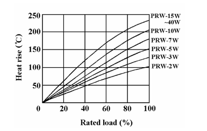

    The resistors heat up because this is their role, they dissipate power in the form of heat, in the case of wire in ceramic housings, these are temperature-resistant elements and it would be a pity not to use it ;) They are designed so that at nominal power the surface temperature can reach from 150 ° C to 300 ° C depending on the model and manufacturer, the smaller the heat dissipation area and the higher the power, the higher the temperature. While the resistor itself could work at such high temperatures, it would rather not be in the vicinity of other elements or the laminate, which means that PCBs usually have to limit the power loss below half the nominal value, and you can get burned anyway.
    Below are some examples from the datasheet
