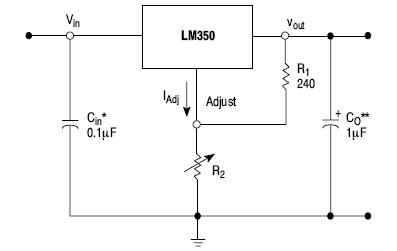

    And how to make the power supply give 9V?
  • #9 16775067
    monti18
    Posts: 75
    Hmm, you can make an output adjustable on the LM 350. It's not that hard. As in the diagram. Or also a constant 9V output on this chip. Converting Old Computer ATX Power Supply into 12V, 9V, 5V, 3.3V Workshop Supply
