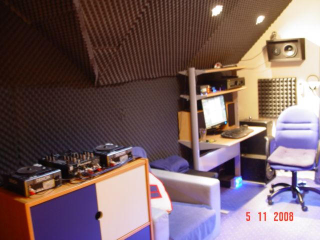

  • #16 5705140
    Granat :)
    Posts: 3043
    Help: 202
    Rate: 667
    It looks something like this:
    Affordable Soundproofing Alternatives for a 2x2 Vocal Booth Without Egg Trays
    you could think about 50x50cm pyramid panels, it would look even nicer, I guess :)
  • #17 5705359
    tasiej
    Posts: 161
    Rate: 12
    it looks cool :) pyramids fall off PLN 16 a piece costs: / I thought to buy the rounder ones in the dimensions of 45x35 or 50x60 which will fit better? :) it is 2.5 PLN / pc :P I'd have to buy 70 of these :)
  • #18 5705414
    Granat :)
    Posts: 3043
    Help: 202
    Rate: 667
    I bought 200x120cm and they did not fit together a bit, as can be seen in the photo, but if you buy a few smaller panels cut at the factory, it should be ok
  • #19 5705453
    SzokalML
    Level 36  
    Posts: 3316
    Help: 240
    Rate: 99
    if you give your carpet, there should be no echo.
    The main advantage of a sponge is that it looks very aesthetic and professional.
    The same effect can be achieved with carpets, curtains, carpeting, etc.
    only then it looks like a Gypsy camp.
    I did this myself in my rehearsal room (about 15 m2 - hard to say, because the shape is irregular) - I found a lot of rugs, carpets, blankets and sponges made of mattresses etc. so I used them. In addition, a lot of egg packaging, which I collected or received, and since I put off making the room, there was a lot. But I do not recommend egg pallets. It is difficult to fix them firmly, one of them falls off the wall regularly ;)
    And carpets, tapestries, etc. are very easy to fix firmly.
    What effect? when it comes to acoustics, it's very good. High selectivity of sound, practically no feedback,
    they all heard very well during the rehearsal, despite relatively weak amplifiers. Price? PLN 0 - I didn't buy anything, everything was won somehow :)
    But this look of ubiquitous rags can only make you smile.
    The duvets are even better, and they soundproof very well.
    And the sponge is very aesthetic. Pomegranate: congratulations, nice room to work.
