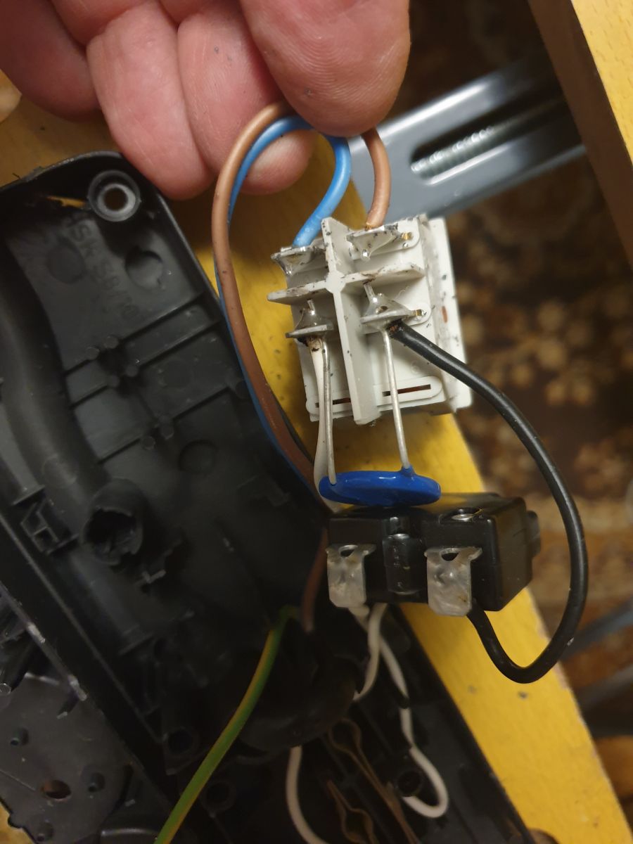

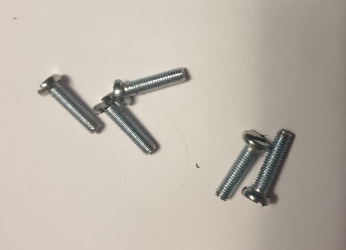

  • #4 18595077
    Colicab
    Posts: 25
    Rate: 12

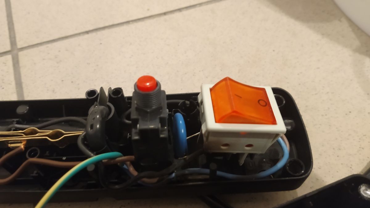

    I am well aware that more than 10 years have passed since the answer, but the thread has not been closed / resolved and the strip is still on sale and is very popular.

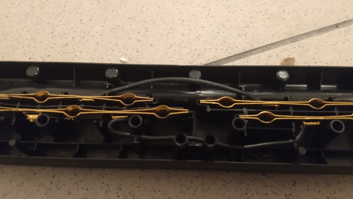

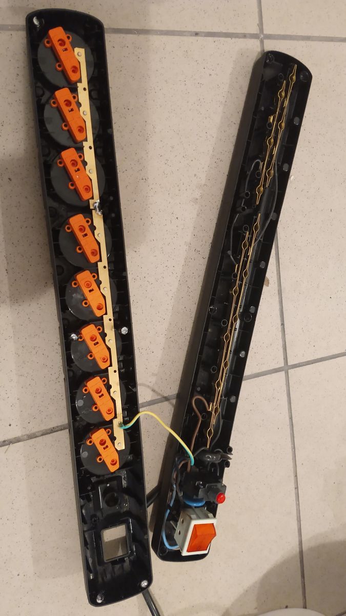

    My strip is an Acar S8, but it is identical to the S5, as you can see in the pictures.
    How to open it?

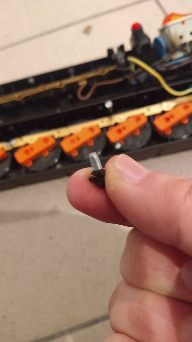

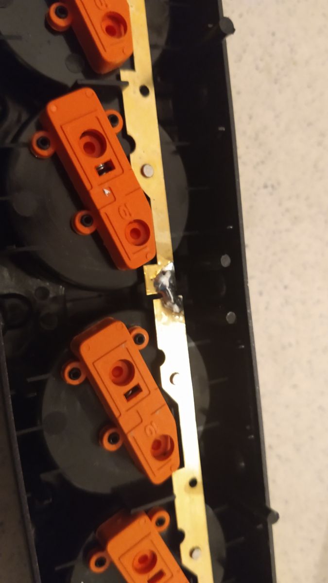

    The colleague above is right. The strip is screwed on with bolts with smooth heads. They can be replaced after repair, the bar is threaded (not rivets). Inside, by the switch, a varistor, which I did not find by the numbers in the store (burnt at my place). The fuse is closed in a riveted "box". Fixing it is not as easy as I expected, I am thinking of replacing it with a classic 5x20 fuse.

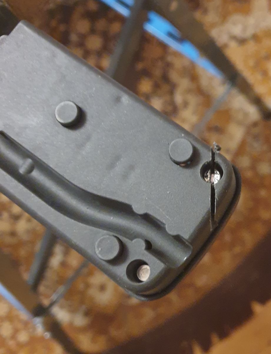

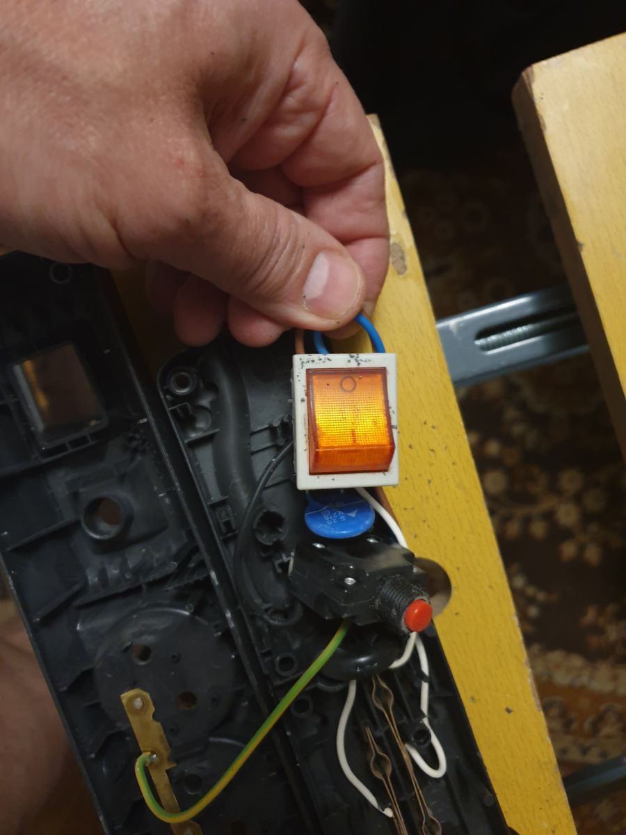

  • #5 19799389
    maplejacek

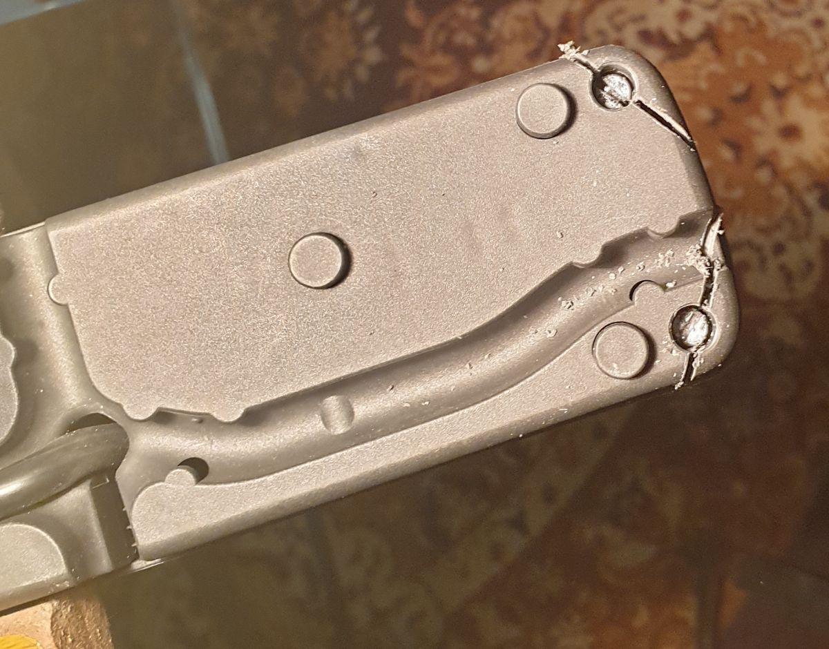

    In my opinion, it is possible to open the ACAR S10 skirting board invasively by sawing off the fixing screws with smooth heads (M3 x 18.5) with a hacksaw. I did it yesterday. I sawed the minimal gaps in the screws and unscrewed the screws with a flat screwdriver without any problems. I replaced the used switch, which is typical for these strips, and twisted the strip with a kind of sheet metal screws. Of course, there were oversaws in the plastic housing at the sawing points. It doesn't matter to me. I left without filling. In my opinion, the strip, after repair, also fulfills its mechanical function.

  • #6 20346499
    Raf1200
    Posts: 125
    Rate: 11
    Hello, can you write what switch you replaced because I did not find an identical one and the purchased one is a little smaller in height ??
