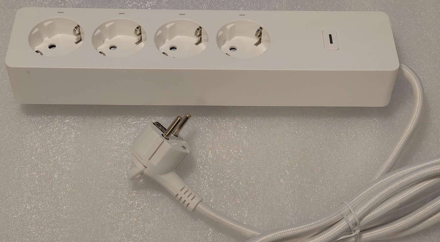

  • As sold in the Action stores (NL, Dec 2024). First some images:
    Packaging of the LSC Smart Connect smart power strip with WiFi functionality.
    Packaging of a power strip with four sockets and a button.
    White power strip with four outlets and a power plug.
    The device can be successfully used with OpenBeken, but requires some DIY skills to open the housing without damage.

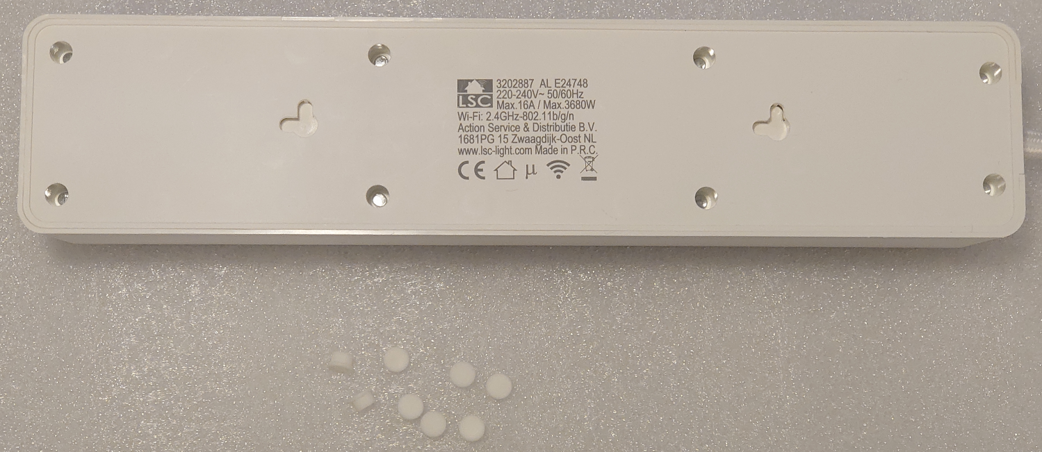

    First, remove the 8 rubber feet (they pull out very easily):
    Back side of a power strip with eight screw holes and an informational label.
    Next, you'll find screws with a completely flat head surface. For the rest, they are normal self-tapping plastic screws:
    Self-tapping screw with a round head on a white background.

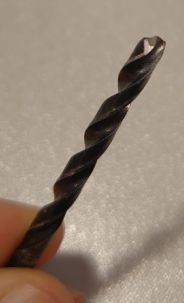

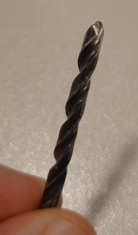

    So, how to get them out? As first attempt, I tried to drill them out. This ruined the plastic housing around the screws so badly, that it was almost impossible to reassemble the power strip again.
    The second plan worked better: get an (old) metal drill bit (ca 4 mm diameter) and an electric grinding stone. Grind down the head of the drill bit, and create an 'opposite' cutting surface. In other words, let's create a left-turning drill.
    Drill bit with a custom ground tip for unscrewing screws Drill bit with modified tip for screw removal.
    Stick some tape around the drill, so it won't damage the 'shaft' of the screw hole with its sides (we only need the tip of the drill).
    Carefully place the drill in the center of the screw head, so it doesn't touch the side walls. Start drilling (counterclockwise of course) and keep the drill centered, away from the sides.
    At first, the drill will start eating some of the screw head, that's fine. At some point it will get enough grip, so that it starts turning the screw. Once the screw gets halfway out, the drill is more likely to hit the side walls, so keep it centered!

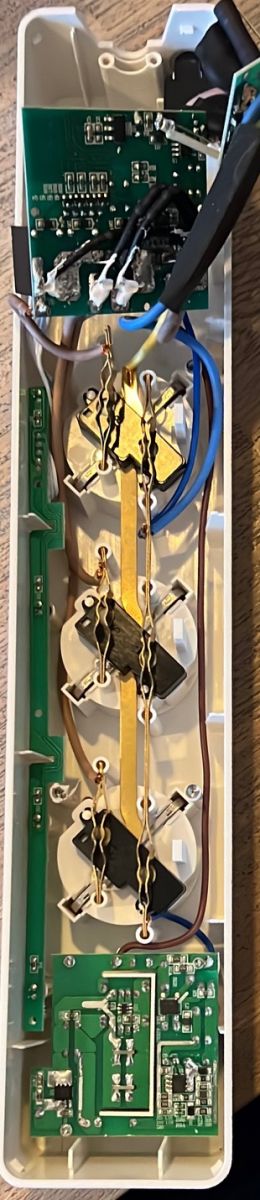

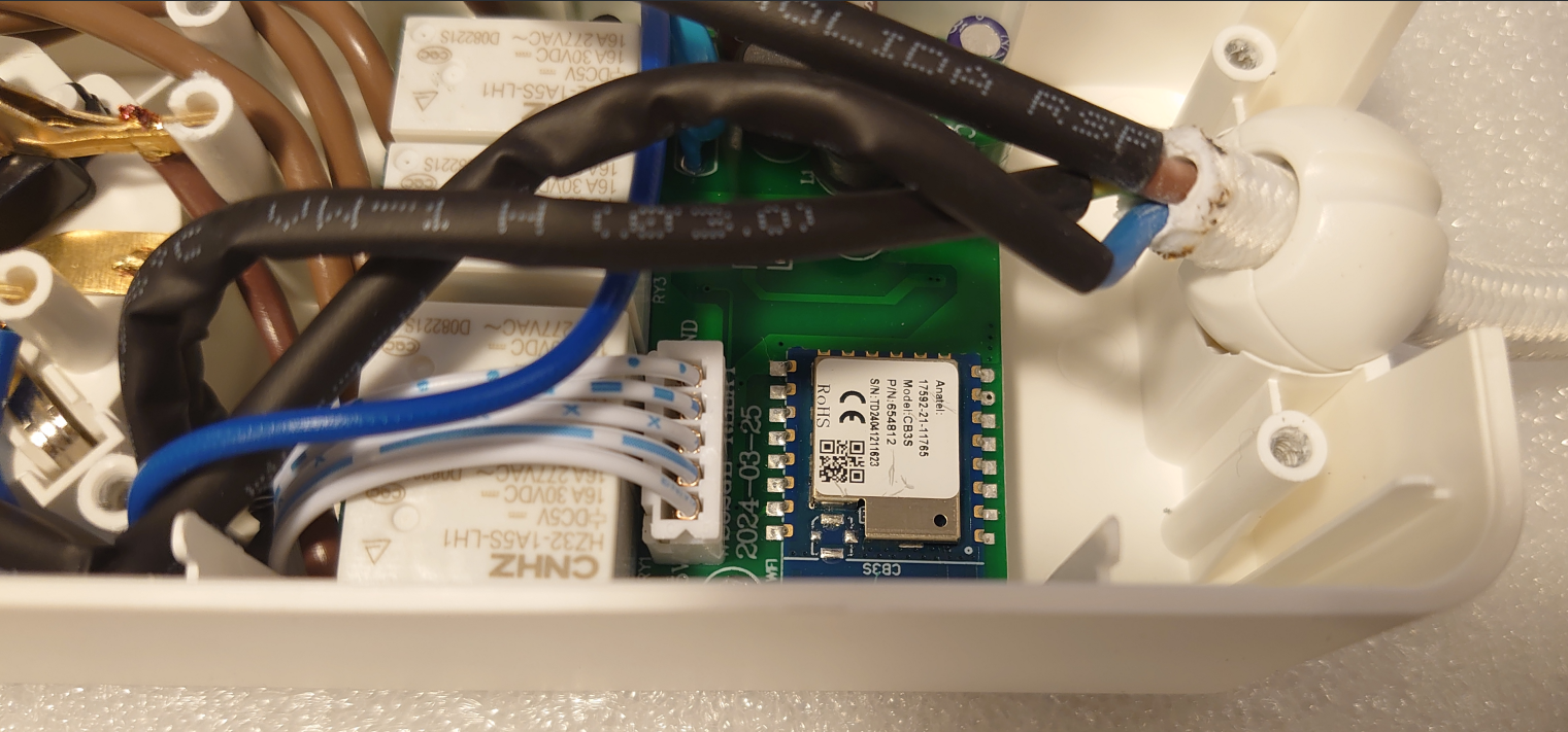

    Once the screws are out, the inside shows some wiring strips, a mains-powered PCB with 4 miniature relays and a CB3S module, and a separate PCB strip along the sockets, which holds the 4 LEDs:
    Open plastic casing of a power strip showing internal electronic components and wiring.
    Note the grooves in the ball joint at the end of the cable. When reassembling the housing, this groove must point straight up and down, so they align with two notches in the housing halves.
    Interior of power strip with CB3S module and wiring.

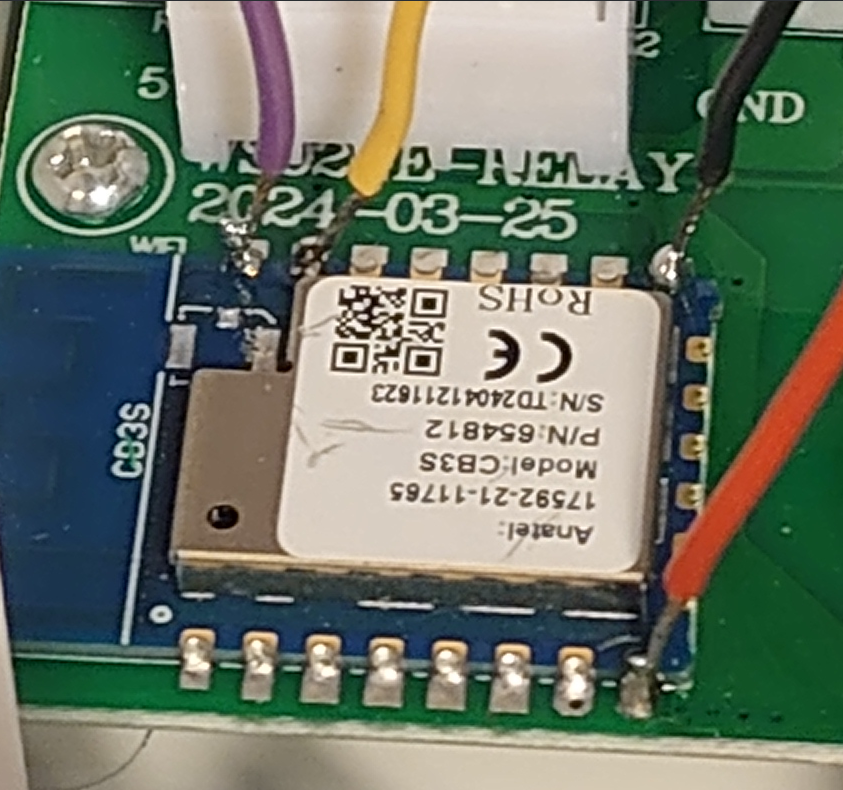

    Make some temporary solder connections to the 1st, 2nd and last pin of the top row, and the last pin of the bottom row:
    CB3S module with soldered wires.

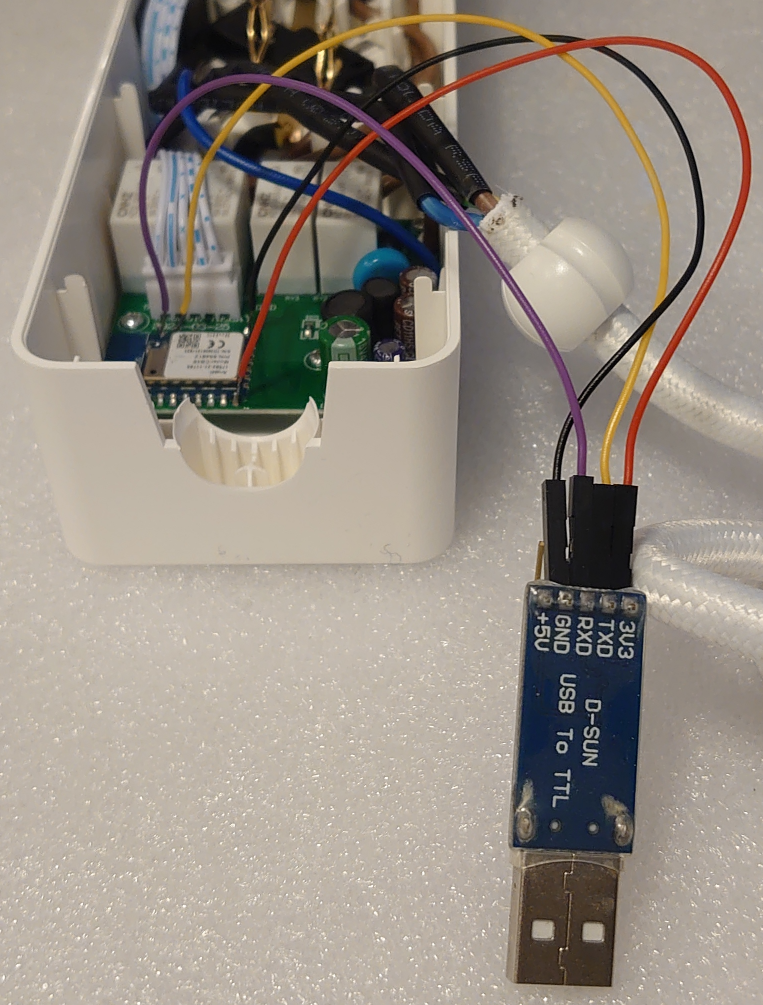

    And connect them to a 3.3V TTL serial interface:
    Interior of a power strip with a connected USB to TTL interface.
    Colors don't matter, but in these pictures:
    - black: Gnd
    - red: +3.3V
    - purple: Tx (smart plug) to Rx (PC)
    - yellow: Tx (PC) to Rx (smart plug)
    Some hints for flashing OBK:
    - When the flashing software asks for a device reset, you can shortly pull and re-plug the red wire.
    - This didn't work reliably for me. Instead, you can also momentarily connect pin 1 of the CB3S module (its reset input) to Gnd:
    Top view of CB3S module with pin markings.

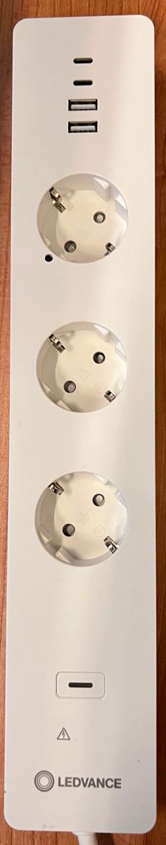

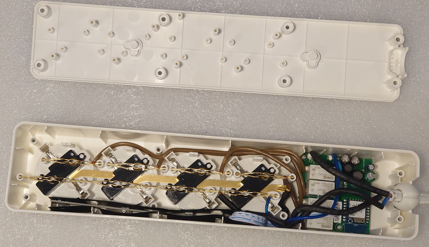

    Not sure if I need to post this as a new device ?

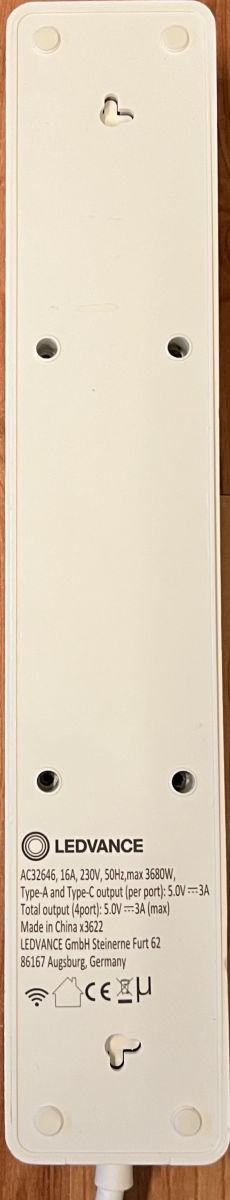

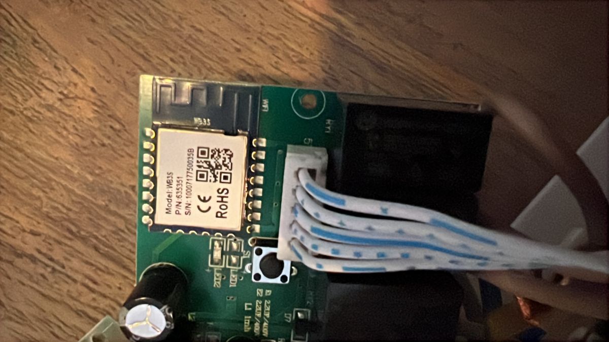

    Just finished modifying the LEDVANCE AC32646 and thought to post it in the Teardown section.
    To my surprise someone else did it to what looks like the same power strip without the USB connections, this device has 2 USB-A and 2 USB-C ports
    Interior of a modified LEDVANCE AC32646 power strip with visible circuits and wires.
    LEDVANCE power strip with USB ports
    LEDVANCE power strip with USB ports.
    Close-up of an internal circuit board with a communication module.
    I used BK7231GUIFlashTool-v5
    and OpenBK7231T_UA_1.17.821.bin
    Reg
    Erik

  • The housing hides 8 rubber feet and uses flat-head anti-tamper screws; replacing them with 2.9×16 mm or 2.9×13 mm normal tapping screws simplifies future service. [#21361104]
  • The flashed strip uses a CB3S module based on BK7231N, with 4 relay channels and one Pair/Toggle All button on P10. [#21361104]
  • UART flashing was done with a 3.3 V TTL adapter using 4 temporary solder wires on the module header; the mains plug stayed disconnected during the whole operation. [#21361104]
