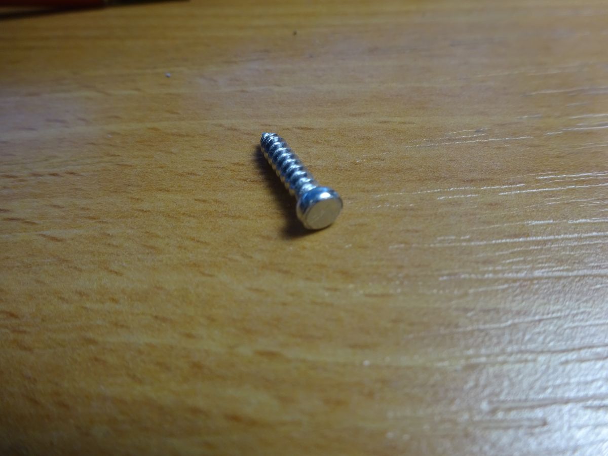

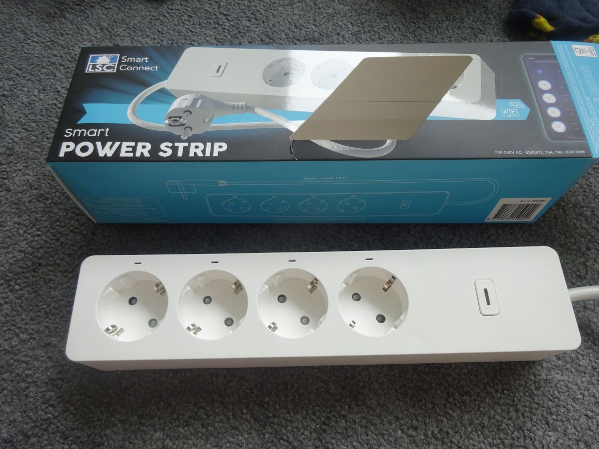

    LSC Smart Connect Smart Power Strip teardown. Bought one on 2024-10-10 at Action.
    LSC Smart Connect power strip with packaging on a carpet background.
    Barcode label on a blue background with article number 3202887.

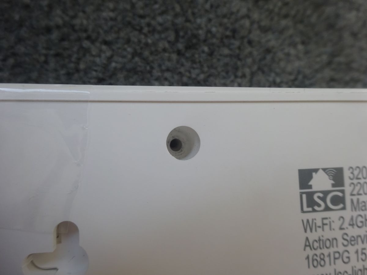

    This is a bit of a nasty power strip, because it has screws without a recess, i.e. no phillips, pozidriv, hex or whatever - they look like a nail! Also, the screws are sunk 10mm deep in the housing, so you can't use your pliers to turn them - the opening is way too small.
    Screw with rounded head lying on a wooden surface.
    Close-up of the LSC Smart Connect power strip casing with a small hole for a non-standard screw.
    So a teardown is, unfortunately, not doable with regular tools, I had to be creative.

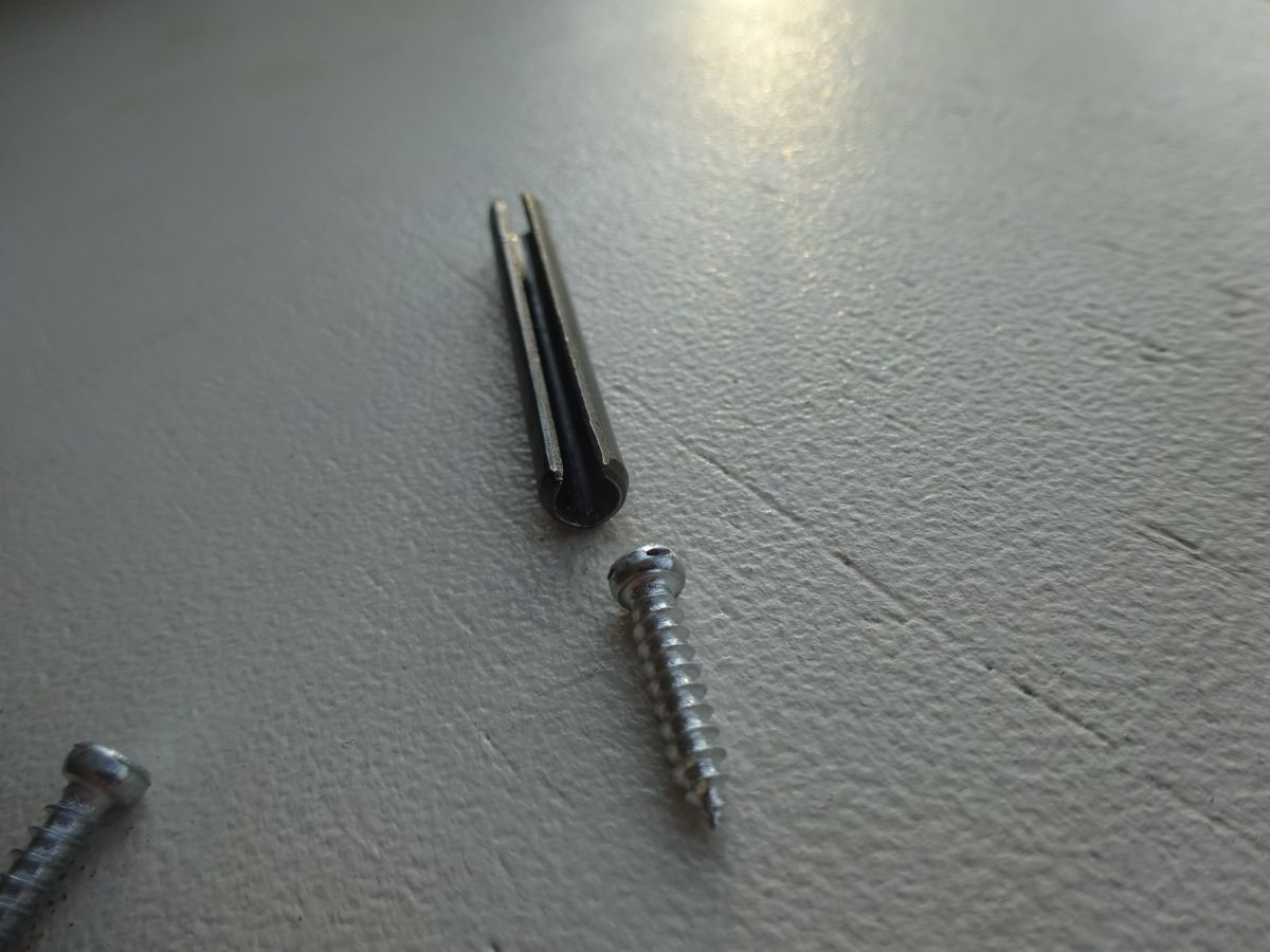

    Luckily, the local Hornbach had a "spanhuls" (Dutch) or "Spannstift" (German) with the right diameter to enclose these nasty screws:
    Close-up of screws and a metal pin lying on a surface.
    Here is how to remove the screws:

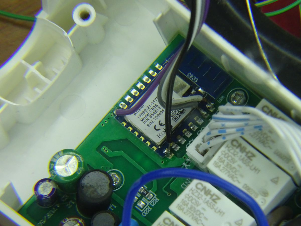

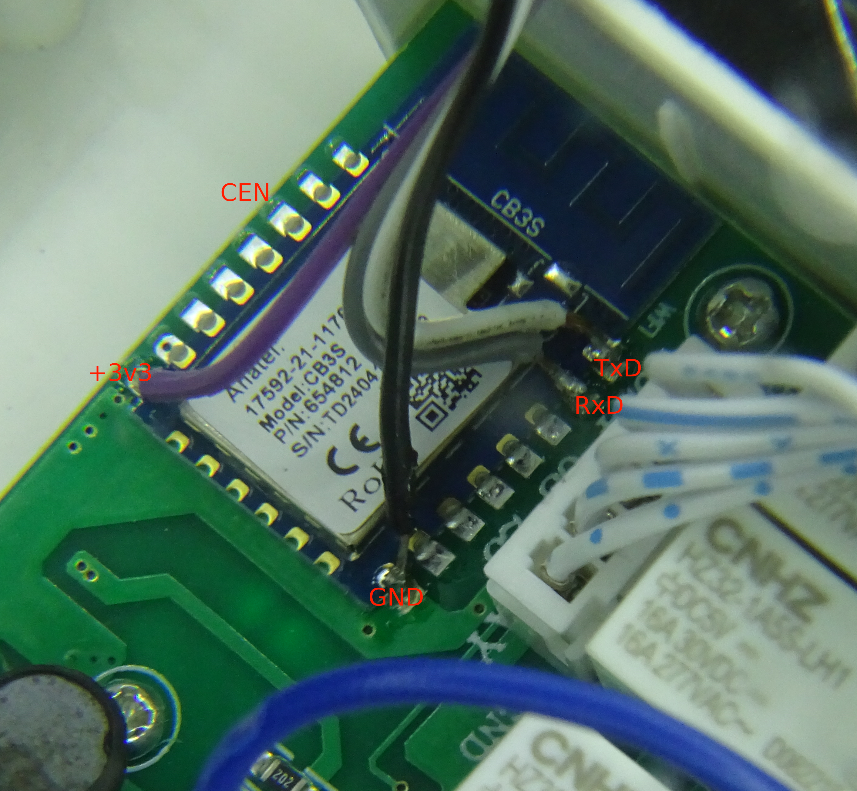

    After that, a rather straightforward CB3S module can be found. You can program it in situ with a USB to serial programmer:
    Interior of a power strip showing the CB3S module.
    Close-up of the CB3S module in a smart power strip with pin labels.

  • #4 21262606
    vsessink
    >>21261196 I believe it's this one: readResult...-15-16.bin (2 MB)You must be logged in to download this attachment.

    It looks more like a "Paspen" or "Spanstift" what you used to open it.
    Thanks for sharing on how to open it!
    And yes, this unit whines when the relays are all off.
    I'll try to open one in the coming week.
  • Paspen removal tips for stubborn screws
    #14 21392765
    Maximilian0017
    Posts: 12
    Just opened one of the units without damage using the 3 or 4mm "Paspen" or "Spanstift"
    It isn't that easy because the Paspen will pop off the screw quite easily.
    Tips:
    - first try to turn the Paspen until it locks a bit, then hammer it a few times.
    - during the removal keep pressure on the Paspen, even if it pops off try to grip it by turning until it locks and keeping pressure.
    - do not hit the Paspen with the hammer if you almost have the screw out, it will damage the threads.
