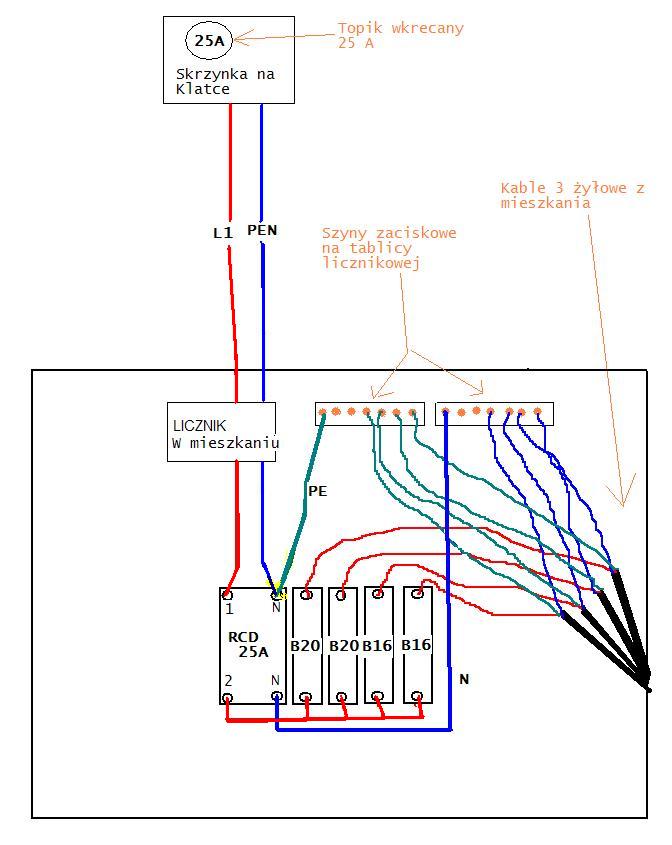

    I am writing to you because today one thing started to interest me, namely.
    In the block of flats (old building, post-German) I have a 2-core copper installation, at home I recently replaced the installation with a 3-core one and I do not know what to do with this new grounding cable, I read a lot of comments on the forum, which makes my head completely confused, no I also know what type of electrical network I have in the block ...
    I mean exactly that once the zero wire bridged with the pin, (as I mentioned the installations in this apartment, several sockets also had the zero bridged with the pin)
    And now the question arises, if you connect the neutral wire from the entrance to the apartment with the neutral wire and the grounding wire from the exit from the apartment, what will happen? because at first glance it seems that it will work in the same way as when bridging zero with a pin in each socket,
    but you will not have to do it separately at each socket ...

    Copper Installation in Old Block of Flats: Connecting 2-Core to 3-Core with Neutral & Grounding
    How does it look in your eyes? can you do that?
    Please do as shown in your drawing.
    If you do so, you will become the owner of the TNC-S network
  • #11 6264567
    joon
    Posts: 77
    Rate: 24
    Check only with the meter what voltage is between your PE and earth, eg CO. Sometimes the voltage drops on the neutral conductor are so large that such a solution is forbidden.
    1. Not so fast, how do you know TT is not brought?
    2. As in an apartment, it is not "networks" but "installations" in the system ... next).

    OK, I will do it according to the scheme above that was posted by my friend goohan I also have 4 circuits so I will have the same.

    I connected, tested the differential and everything works fine,
    now I am waiting for my friend to make a memory, and thank you for the answers and best regards
