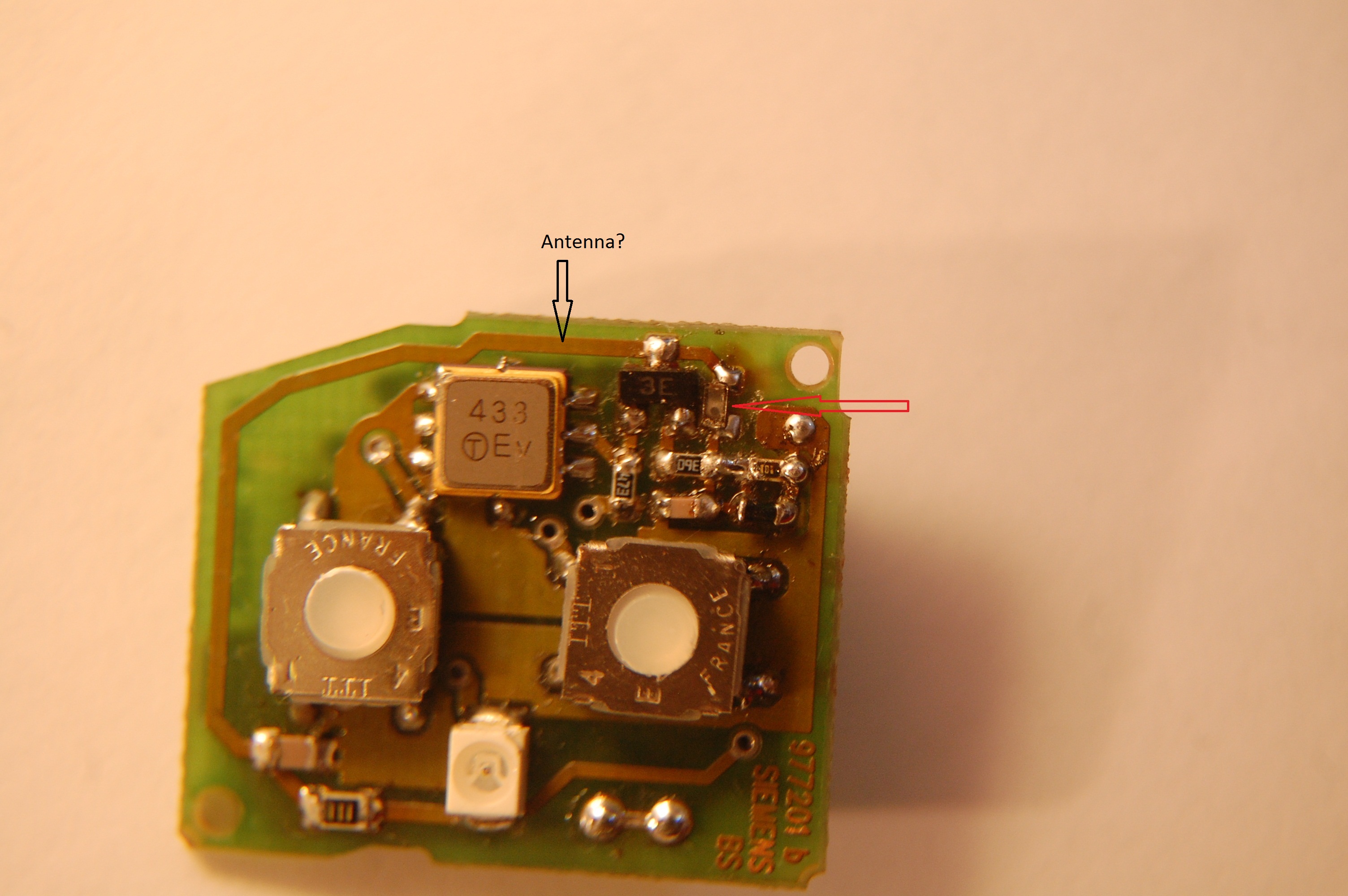

    I have a remote control for cordoba 97r (siemens bs 977201 b - this is its designation) looking for a schematic of it because it is impossible to program it after undressing I have an impression that one subunit is missing only the question what is it? gives a photo of the plate greetings

  • #2 6645968
    skowyt
    Hello. I have the same pilot and you are actually missing one item. I'm not sure what it is but I think the resistor is black with three white lines, the shape resembles a rectangle. It resembles those rectangles that are on the other side of the tile only that it is bigger. greetings

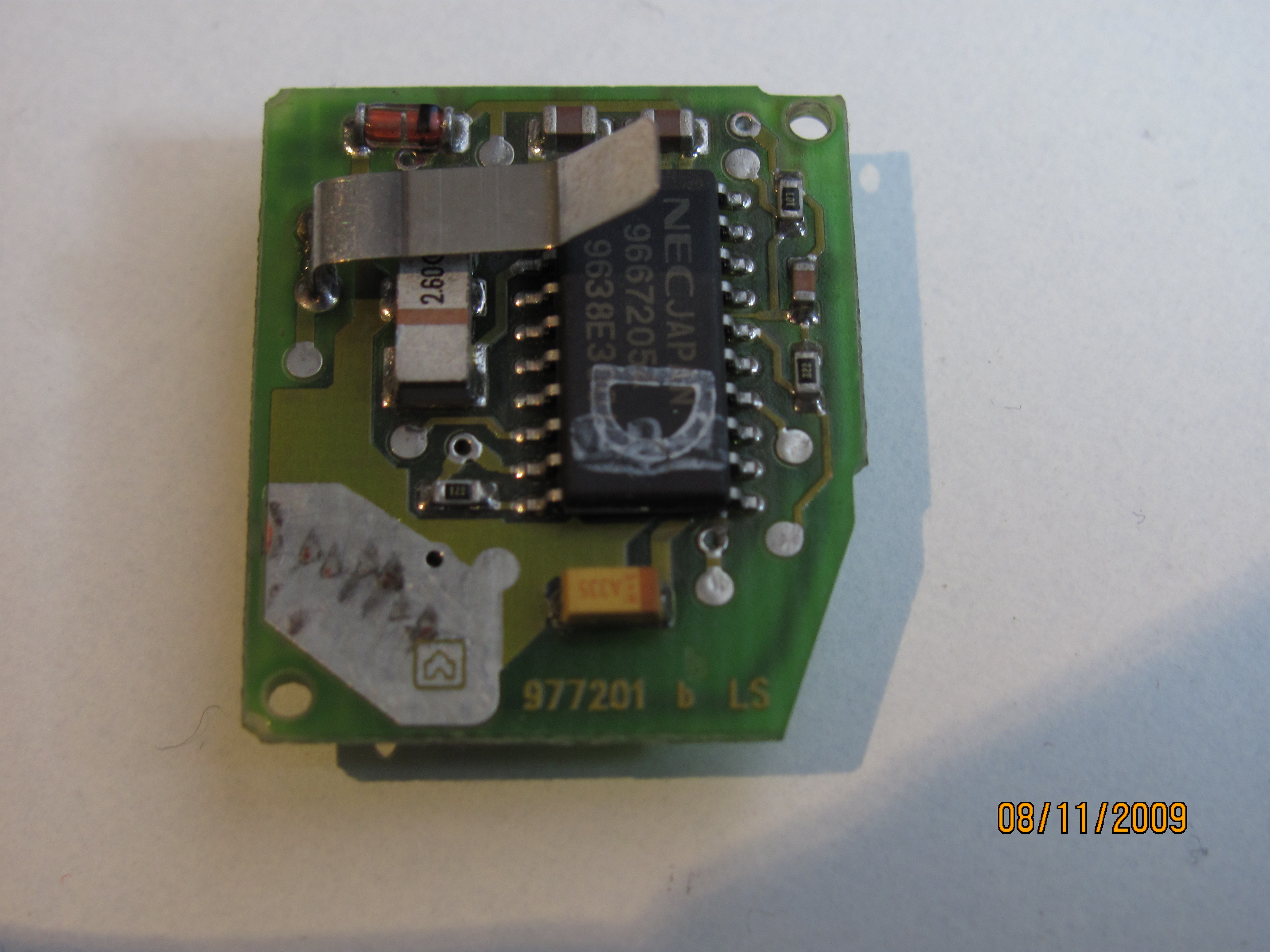

  • #3 7147639
    jabol1
    Posts: 20
    I have the same pilot, but the chip located on the other side of the plate has dropped out. You could put on the board a photo of the remote control board but its other side. I will be very grateful, Regards!
  • #4 7150989
    szarobury256
    Posts: 26
    Rate: 7
    Okay, I'll put it in but it's only on the weekend because the car went to Poland as soon as I have it I will put it
    greetings
  • #5 7231511
    jabol1
    Posts: 20
    I renew my request for a photo from the pilot's remote site. Thank you in advance. I greet you.

    • siemens bs 977201 b - Remote control in the key of the seat cordoba 97r IMG_0150.jpg (1.68 MB) You must be logged in to download this attachment.
  • #7 7425110
    rikimaru99
    Posts: 83
    Rate: 14
    Hello. regarding this missing element, I put on the diode the same as on the back of the tile. solder and see it will probably move.

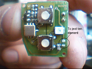

  • #8 9041735
    tszab
    Hi!
    I have a same remote fob, with a bad component on it. It is near the 3E marked component. Can you measure it for me? It is broken on mine and hasn't got any mark.
  • #9 9514690
    tos18
    Level 42  
    Posts: 7139
    Help: 1113
    Rate: 1870

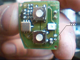

    I dig up the topic because I have a similar problem.
    tszab: your missing component is 5pf capacitor
    My question concerns the element marked with a circle
    Probably a capacitor. I would really like to know its capacity.
  • #10 9730907
    goolman111
    Posts: 30
    Rate: 7
    The missing element is the smd resistor 111 = The resistor has a resistance of 110?. It is worth to fly all connections in the pilot. Glad!
  • #11 9730997
    tos18
    Level 42  
    Posts: 7139
    Help: 1113
    Rate: 1870
    Thanks - but I'm interested in the element in the circle next to the missing resistor.

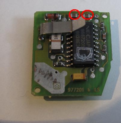

    Hello, I am the new owner of Sharana from 99 and I have the key the same as others in this post. As I look at the circuit board from the IC side, there should be two capacitors over it, which I do not have. I am asking for info what their values are.
    darkstarmike
  • #15 10073317
    darkstarmike
    Posts: 8
    Gentlemen, really no one can check the value of these capacitors?
    [photo borrowed from colleague gray-brown256 because I do not have anything to take pictures of my key]
    Please, help me!
