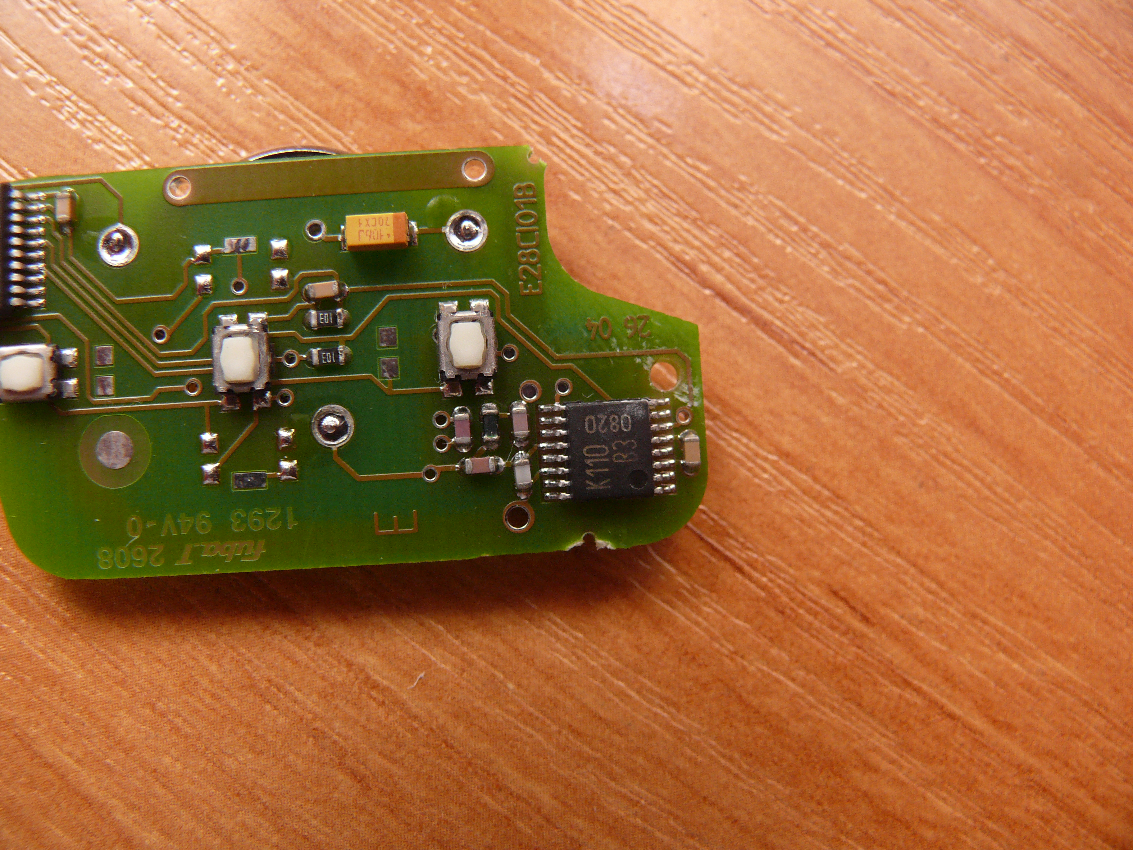

    I got just such a remote control (3 buttons) to replace the microswitches. For "ease" the owner himself desoldered the used ones. The problem is that he also collected one smd resistor, whose value is difficult to determine. Request: could someone with such a remote control or access give his (resistor) value? Peugeot 407 - Remote control in the key (3 buttons) - no resistor

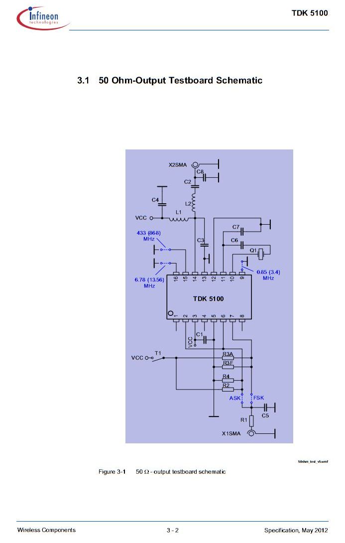

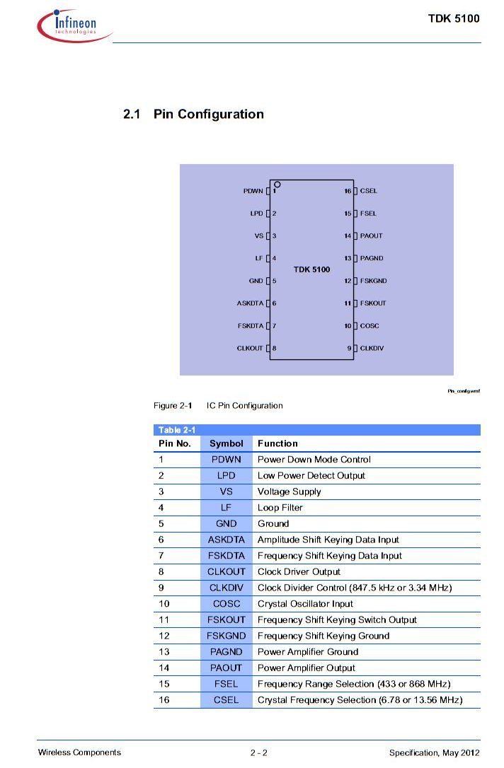

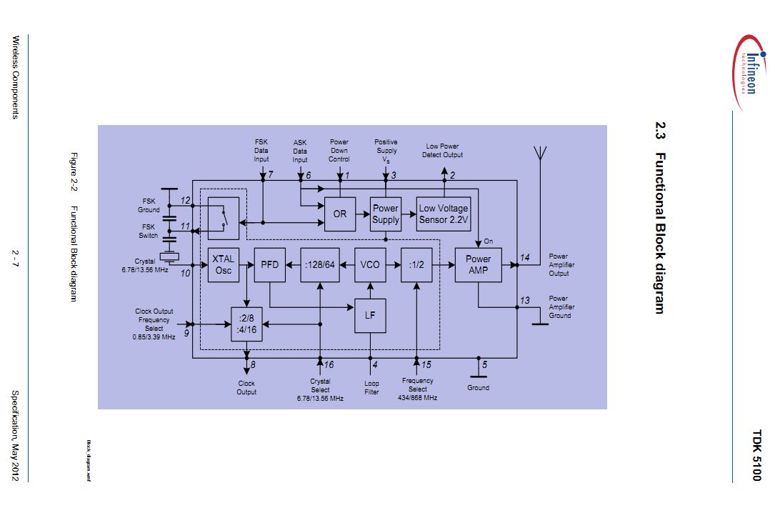

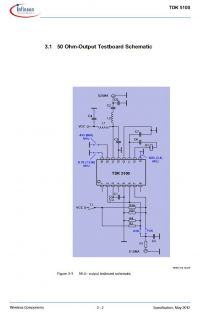

    LXT wrote:
    The layout has the indication "5100"
    This is TDK5100-ASK / FSK Transmitter 868 / 433MHz.
    Peugeot 407 - Remote control in the key (3 buttons) - no resistor Peugeot 407 - Remote control in the key (3 buttons) - no resistor Peugeot 407 - Remote control in the key (3 buttons) - no resistor Peugeot 407 - Remote control in the key (3 buttons) - no resistor

  • #5 16406503
    LXT
    Level 26  
    Posts: 737
    Help: 87
    Rate: 72
    TDK5100, it's actually ON. And my strap is R3, so is it for ASK or FSK 15k. I soldered there for the purpose of trying out 10k and interestingly it works only has a small range. Well, maybe he finished the new battery. Next week, the guy is coming up again, we'll replace the resistor, battery and see. And of course, thank you very much for your interest in the subject, time and specific help. :D
  • #6 16406656
    wqq
    Level 22  
    Posts: 395
    Help: 48
    Rate: 173
    For me, the meter showed 5 ohm (I bet more on the coil) - of course soldered into the board ...

  • #9 16409906
    antek1cza
    Posts: 1208
    Help: 182
    Rate: 199
    wqq wrote:
    Element without markings ..
    I suggest placing a sharp and clear picture of this part and the 5100 chip that is next to it.
  • #10 16410641
    wqq
    Level 22  
    Posts: 395
    Help: 48
    Rate: 173
    I will not do sharper ...

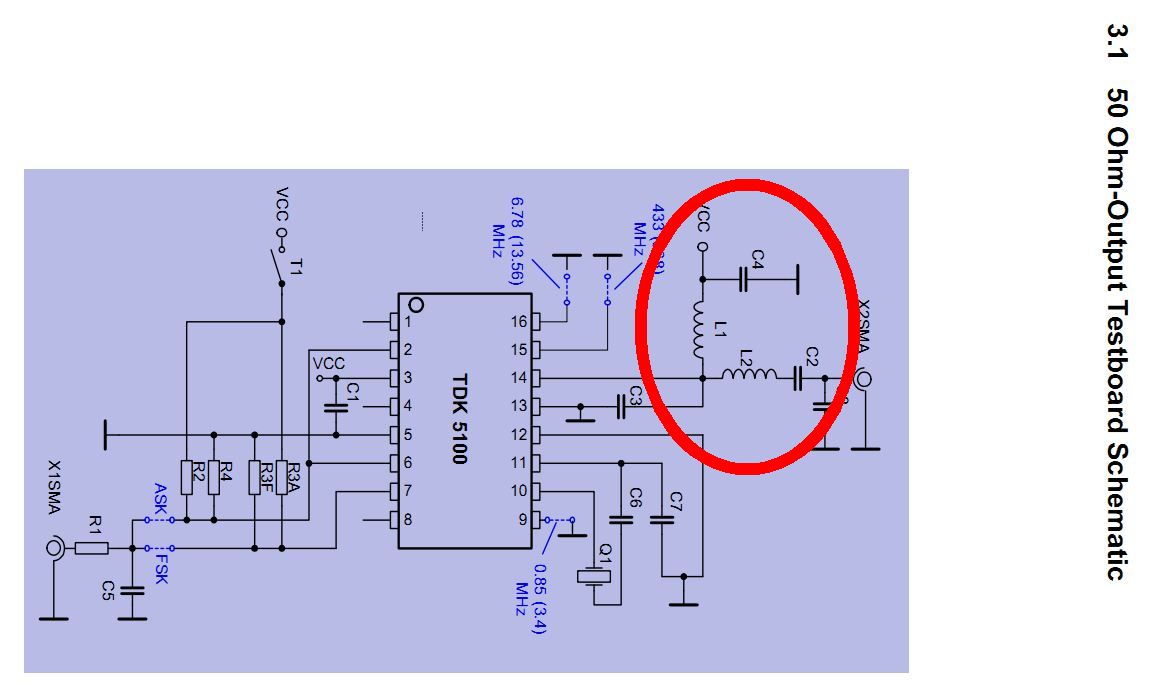

  • #11 16411954
    antek1cza
    Posts: 1208
    Help: 182
    Rate: 199
    wqq wrote:
    For me the meter showed 5 ohm (I bet on the coil more)
    That's right:
    In the diagram with IC 5100 Peugeot 407 - Remote control in the key (3 buttons) - no resistor
    and IC 5110 Peugeot 407 - Remote control in the key (3 buttons) - no resistor
    Practically the same but the chips themselves have slightly different parameters and the boards differ:
    LXT wrote:
    And my strap is R3
    where is it written
    because it has too high resistance and there must be a choke with a resistance of approx. 5?!
