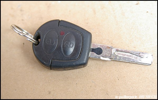

  • #3 16279169
    opsops
    Posts: 25
    Rate: 8
    Led indicates the pressure of the button. Tear type wrench.

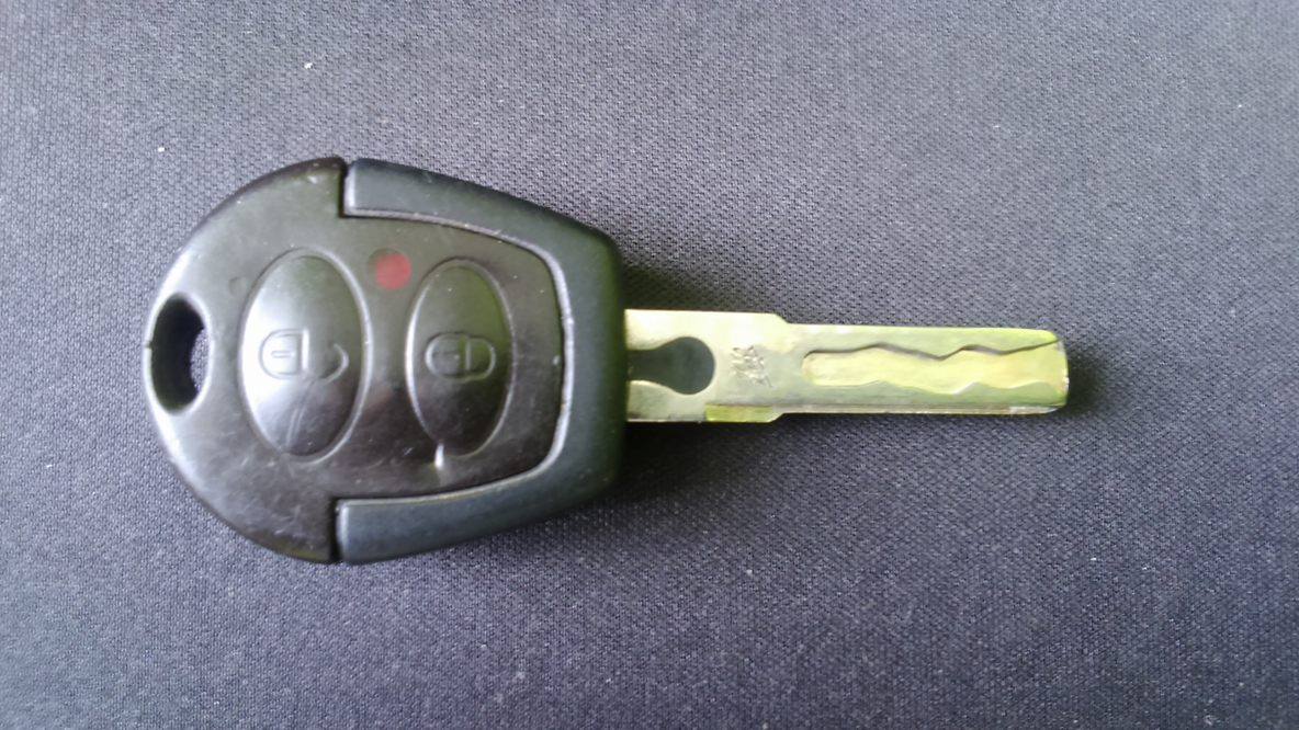

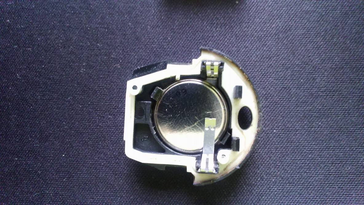

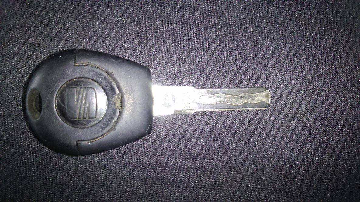

  • #8 16280087
    opsops
    Posts: 25
    Rate: 8
    Pilot Hella 433Mhz 5fa 007 680
    One Varta CR2032 3V battery (correctly installed)
    Seat Leon 1.8 125 KM 2000
    I will add photos later.

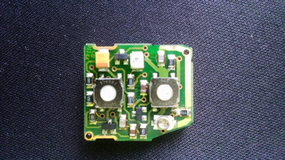

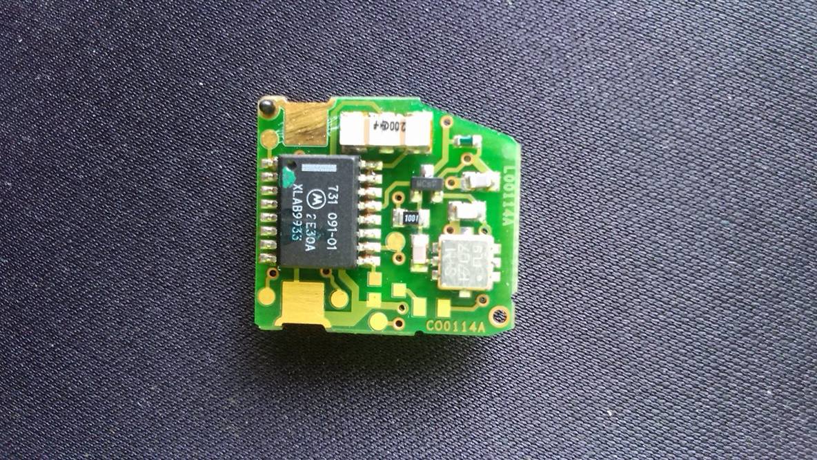

    Added after 29 [minutes]:
    Photos of the key inside.

    Watch the remote control under the microscope or magnifying glass.
    Look for cold solders, cracked paths, etc ...
    Connect the pilot board's power supply to an external 6V stabilized power supply,
    measure the current consumption by the "plate" from the power source.
    Check three times - where to connect [+] where [-] power!
    Check whether the current consumption from the power supply changes when you press the switch on the "PCB".
    You must start the pilot diagnostics from these measurements.

    In my opinion, this remote control should have 2 CR2016 batteries, so 6V and not 3V, and here is the problem.
    Newer remote controls are on one CR2032
  • #12 16282645
    opsops
    Posts: 25
    Rate: 8
    Buddy actually works on 6V. I connected 2 CR2032 batteries for a short time each and the key came to life. Only 2 such batteries will not enter there because they are too thick.
