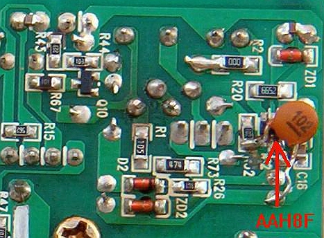

    The power supply as in the subject, and the stand-by converter was dropped, the zener diode and the resistor were obstructed.
    I would be grateful for the information about which diode (what voltage) and what resistor.
    Exactly I mean elements ZD2 and R26 visible in the attached photo.

    The resistor should be read, regarding Zenerka it can help marking on the element SOT23-6 (IC2), drawing a piece of the scheme ...

    The resistor looks like 101 but I'd rather make sure the measurement gives a lot more. IC2 does not make much sense for AAHBF :) and I do not know what kind of layout it is.

    I once got the message that this is part of AAH8F, and not like you read AAHBF ...
    However, it does not change the fact that I did not find an application anyway.
    However, the photo I have is too poor to read the value of this resistance ...

    Udostępniam zdjęcie lepszej jakości oraz dane niektórych elementów.
    Bardzo często uszkodzeniu ulega :arrow: Transil jego dane: P6KE220A oraz ultra szybka dioda :arrow: UF1007 .
    Koniecznie wymienić trzeba dwa kondensatory elektrolity 1000µF/10V po stronie wtórnej w PP .
    Identifying ZD2 and R26 Values for Tagan TG500-U26 Power Supply Repair

    Thanks for the detailed photo. Replacing the diode has helped and also replaced all electrolyte capacitors prophylactically in stand-by, and the power supply works and let it stay that way ... :)

    If someone had a damaged system in the housing SOT26 and wondered what this might be I already know the answer :D .
    It's a layout:
    SG6848 , and its newer version is: SG6858T
