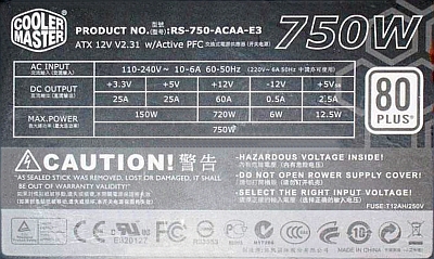

    Cooler Master model: RS-750-ACAA-E3 - Burnt out TNY278PN and R17 and ZD7
    Problem with the power supply as in the topic. Ruptured TNY278PN. Burnt resistor R17. From the strips I managed to read 2.2M (I'm not sure of this value!), And the Zener diode SMD ZD7 in series with the resistor. Unfortunately, it is impossible to read what voltage the diode is on, it is connected in parallel between the one leg and S the integrated circuit TNY278PN.
    I need a value:
    ZD7
    R17
    For a person who will help (knows the value of elements) or be so polite and will measure the voltage on the diode and read the value of the resistor from the power supply he owns), the 100pkt plus reward provided helped.

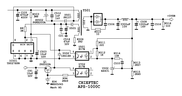

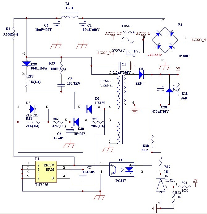

    Are you sure that it is: TNY279, and not like in the other less powerful was probably TNY278PN? According to the application for the system you can analyze (figure) ... Should you ask if this is the end of the damage? How is 24N60C3 and what APFC says (layout) ...

    After all, I wrote that 278PN, not 279. I saw Datasheet, but the system does not agree with this application. Mosfets after the original operational. APFC not yet tested. I am still looking for info.

    Did you hope so ...? You need to look for analogies are just new trends in ATX and probably will fall out in the runways (look at other power supplies from this company).

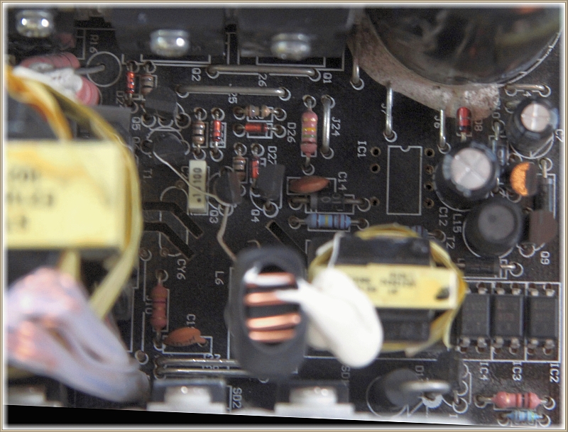

    Ok, I'll put in photos, but they will not be Top Quality because now I have only 2mpx camera in Nude 9000. The zener diode is from the print side (SMD). Metallized resistor, plain THT.

    CoolerMaster 750W should be based on:
    - classic APFC, built on CM6800 + field 24N60C03 (TO-247)
    - TNY278PN standby
    - PS113 supervisor
    - 2 or 3 opto.
    Is that? After all, pin 1 and S are the output for the CE opto connector?
    Cooler Master model: RS-750-ACAA-E3 - Burnt out TNY278PN and R17 and ZD7 Cooler Master model: RS-750-ACAA-E3 - Burnt out TNY278PN and R17 and ZD7 Cooler Master model: RS-750-ACAA-E3 - Burnt out TNY278PN and R17 and ZD7
    You probably have the search elements in the power pin?!

    Resistor 2,21M metallized, Zener diode 5V1 , suspicious in the second efficient PSU. The connection, as I wrote above, unfortunately, the primary winding of the transformer of the standby converter has a break, you will have to rewind, because buy a ready one will probably fail ...
