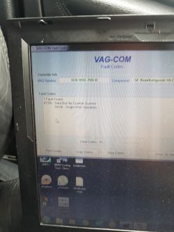

    what to do if you don't have a working key? I have the original set of 4 keys, including 2 remotes, none of them work. Batteries were discharged in both of them and in the car I had already replaced the battery with new ones. The diode on the keys began to react to pressing the buttons.
    in the tab 046 comfort module 010 adaptation in field 01 the value 1 is saved and the module does not accept anything else I tried 0 and 2 only 1 can be saved then I press the car unlock button on the remote control and nothing happens? tell me what's next? there was one error stored in the comfort module viz
    01336 Data Bus for Comfort system
    80-00 single wire operation.
    The car is a 2003 Skoda Superb. Regards, Derek Programming Seat Toledo 2000's Central Locking Remote 433MHZ 5FA 007 680 via VAG COM and OBD2
