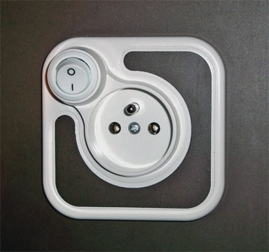

  • #20 7270440
    sebjaw
    Posts: 21
    Board Language: polish
    Hi.
    I'm all for turning devices off. Special sockets with a built-in switch may be best for this purpose. Standard in many countries - a rarity here.
    In general, it is not important whether one person can save a lot or a little in this way ... but what matters is how much a whole city or country can save in a whole year - if everyone had such sockets with a switch and used them ...
    Not to mention the ecological aspect (reducing CO2 emissions into the atmosphere, etc...)
    An example of such a FunCo socket:
    Electricity Consumption of Standby Devices and Impact of Daily Power Disconnection
    Max 10A
    I greet and encourage you to be economical and ecological (2*E)
    sebastian j
