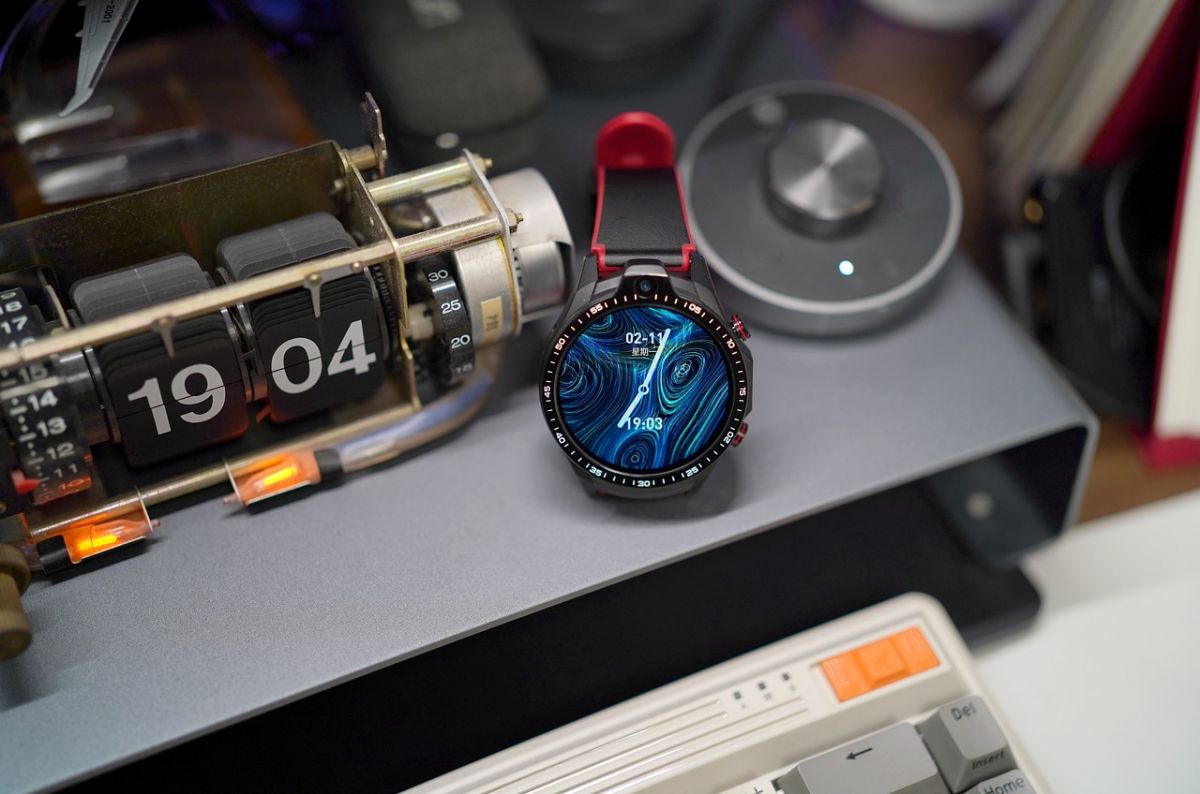

  • Mechanical clock and smartwatch on a desk.
