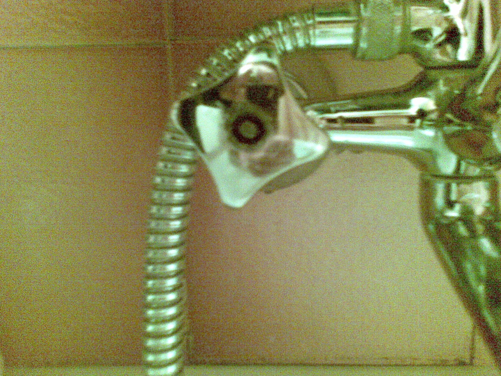

    I did not want to start a new topic because I have quite a similar problem. I have a classic bathtub faucet. The battery is dripping slightly. I wanted to replace the valve under the tap, but they can't pull it off. There must be a rock there and the tap just "stuck". I replaced the hot water tap without any problems. Anyone have any idea how to pull off the cold water tap? He doesn't want to do anything by force so as not to tear the battery off the wall :D

    kiepas
    Posts: 37
    Yes, I turned it on. The hot water tap went down although there were also problems. I pissed WD40, waited a moment and downloaded it. But the one from the ground one sticks terribly tight: /

    You sit down on the bathtub, rest your leg on the faucet, and with your hands you grab the tap and pull it with all your strength.

    Or, remove the battery and use a striker to treat the head while holding the knob :D

    Screw on the nut (or screw - there are 2 types of fastening) and, pulling the knob firmly towards you, hit the nut vigorously with a small hammer.
    If the head is old - sealed with a flat gasket, put a newer one on the o-ring, the whole cost is about PLN 5.
