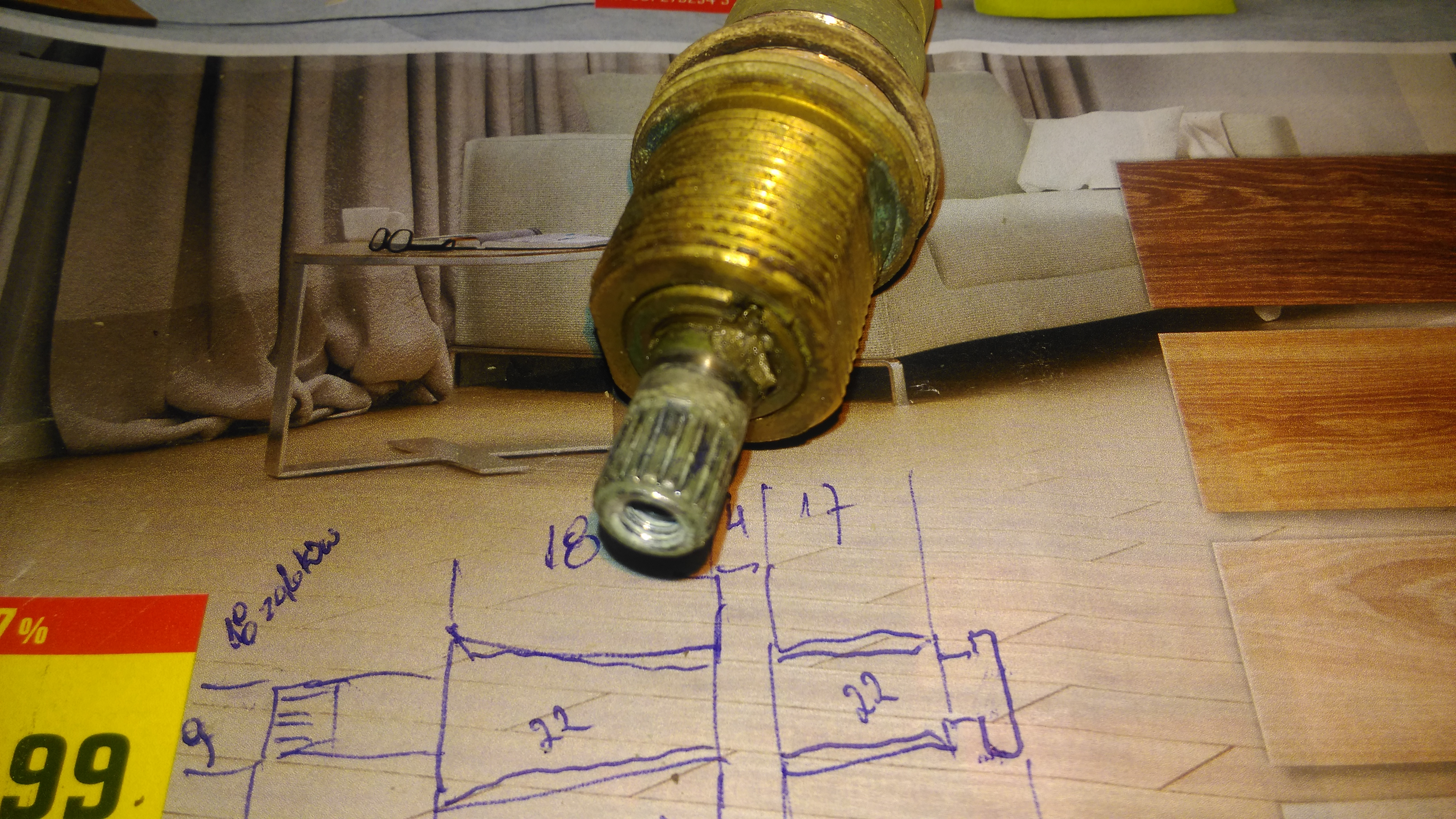

    Hello, I'm going to jump on the topic.
    I managed to pull the head out, but what I saw surprised me a bit.
    I have a question, maybe someone knows where to buy such a head only in the ceramic version and what brand is it?
    Attached is a photo of two heads, the smaller standard one, I need a larger one (the spline of the cork is also larger).
    Thank you for your help.
    Removing and Replacing Old Bathroom Faucet Head: Steps for Disassembly & Installation
  • #12 18002140
    pablito_p
    [quote="1 PAWEL"]You must specify how many teeth there are on the head pin knob (knurl) and dimensions.
    Below is a quick technical drawing :) dimensions in mm of course
    Removing and Replacing Old Bathroom Faucet Head: Steps for Disassembly & Installation Removing and Replacing Old Bathroom Faucet Head: Steps for Disassembly & Installation
