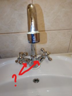

    I have a problem with disassembling the taps of the basin faucet shown in the first photo below. Unfortunately, despite removing the plugs from the taps and then unscrewing the screws in them, the taps cannot be removed further. I wonder if you don't need to unscrew these ala nuts / covers on the back first (marked in red in the photo)? And the second thing, is the tap to be turned on or off? Because I don't know anymore ...: /

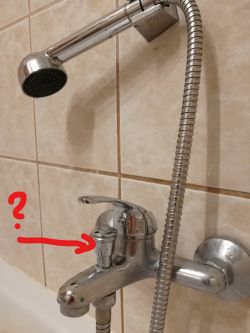

    My second question concerns a different type of faucet, namely a shower faucet. Is it normal that after the water circuit is closed, it continues to fly from the shower head or tap, sometimes for several minutes? In a sense, it drips laboriously and it takes quite a long time ... I would like to add that after unscrewing the cartridge inside seems to be in good condition, and the battery handle works freely. I wonder if this button is not to blame for changing the circulation between the spout and the handset, what do you think? Before I haven't dealt with yet.

    #2 17439330
  • #3 17439358
    TomToM97
    So yes:
    1. Remove the knob covers and unscrew the screws.
    2. Unscrew the conical sleeves.
    3. The cocks should let go and I got to the heads.
    Or so?
    2. Take out the taps somehow and then take care of the conical sleeves?
    3. And I have access to the heads.
    I have doubts because you indicated that the sleeves will be unscrewed, but at the beginning you wrote "after unscrewing the taps" so as I understand it, the latter variant, right?
    Do you have any way to let these unfortunate cocks let go? :D
    #4 17439367
    Parowy
    Level 22  
    Posts: 955
    Help: 55
    Rate: 227
    Welcome.
    As for the second question, this is normal. I have the same with a typical shower faucet, the water left in the hose slowly drips out of it after hanging up, I suppose it would disappear if you held the handset much below the battery before hanging it up.

    I suppose a colleague is going to replace the heads in this battery?
    Or just head gaskets, commonly known as mushrooms?
    I think the chanterelles just stuck on the spines over time.
    Spray with some descaler and then use a rubber mallet like a surgeon with a scalpel during the operation. Just gently tap these cocks from the bottom and the top.
  • #6 17439400
    TomToM97
    The plan was to replace the entire heads, because one of the knobs is not too interesting anymore. Unless it is only a stone or a gasket that is to blame, then maybe and without replacements, the question of checking them is. Well, first I have to get to them somehow, I'll try to figure something out tomorrow to finally move them.
    #7 17439414
    Kenworth 18
    Posts: 11265
    Help: 2442
    Rate: 3749
    If after removing the plugs there is a screw securing the cocks, they must be removed.
    I used to repair the battery for a friend of mine, I suppose the cheapest Chinese-style retro and, surprisingly, the taps were permanent.
    Unfortunately, the angle grinder had to go into motion because the heads were damaged.
  • #8 17439417
    TomToM97
    I understand, then thank you all for dispelling my doubts. Good night!
    #9 17439435
    Kenworth 18
    Posts: 11265
    Help: 2442
    Rate: 3749
    If you want to save the heads, tap the taps on the screwed tap.
    If they don't let go, twist and cut as much as possible. Then you will only save the hens, provided that the axis can be punched.

    There is also one thing. Namely, the heads can have different ways of fixing the knob. It can be either with a screw (as shown in the photo - i.e. there is a hole with an internal thread in the head), or (much less often) with a nut (in the head, a threaded pin protrudes from the head, for which a nut fixing the knob is given). Therefore, you also need to pay attention to this detail. Of course, you have to pay attention to the size of the head to fit the battery - here it is probably a typical 1/2 '', since it is unscrewed with a 17 key. How can the head be made of plastic? It's made of brass and shouldn't have any plastic parts. If it has, it means it's some trash.
