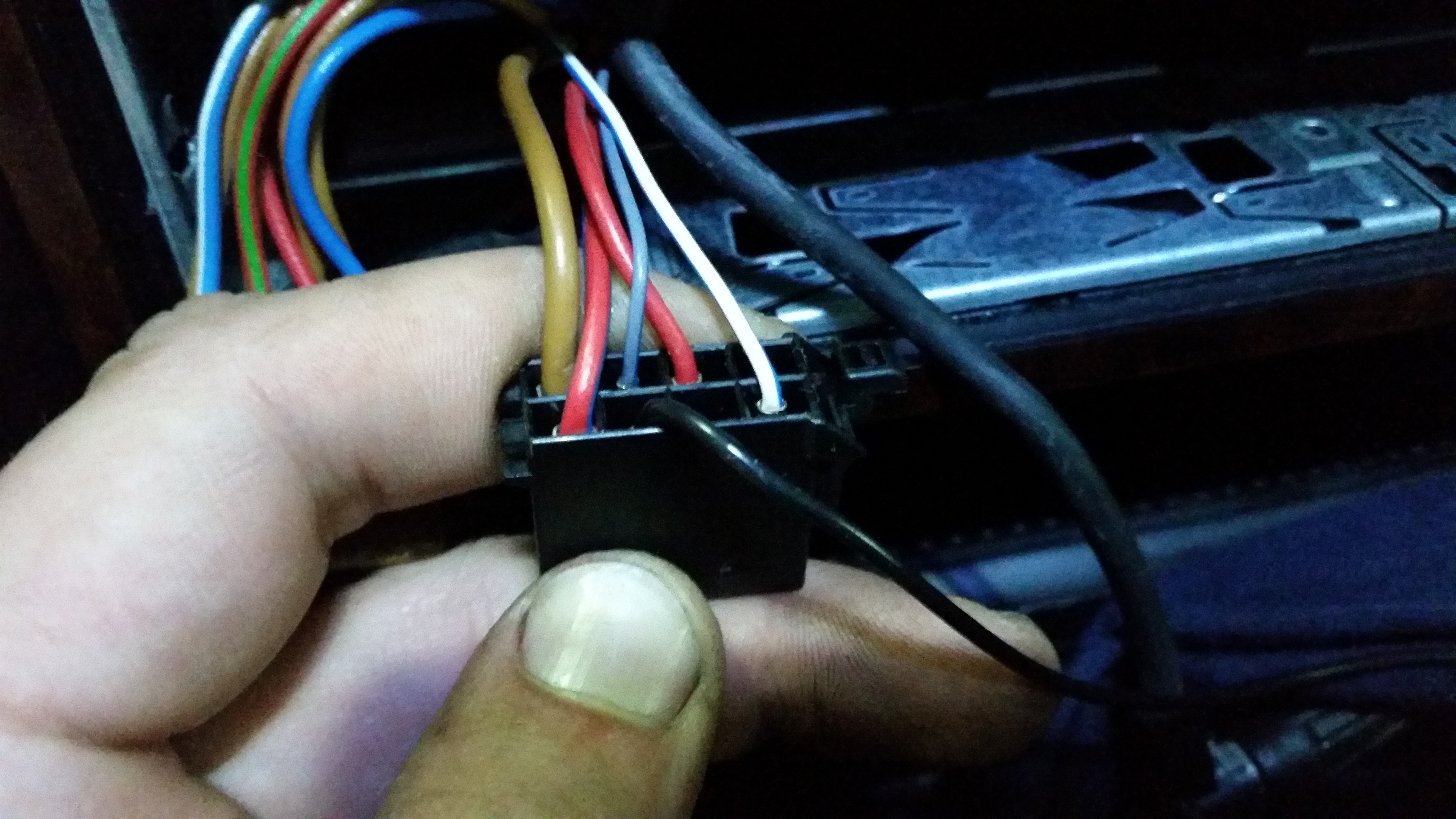

    Hello, I have a problem with connecting the remote cable to the right place on the radio.
    I took out the radio and it turned out that I have:
    -blue cable coming out of the ankle (indescribable)
    -doubled blue cable coming from the radio, as in the photo (described: "SYSTEM REMOTE CONTROL).

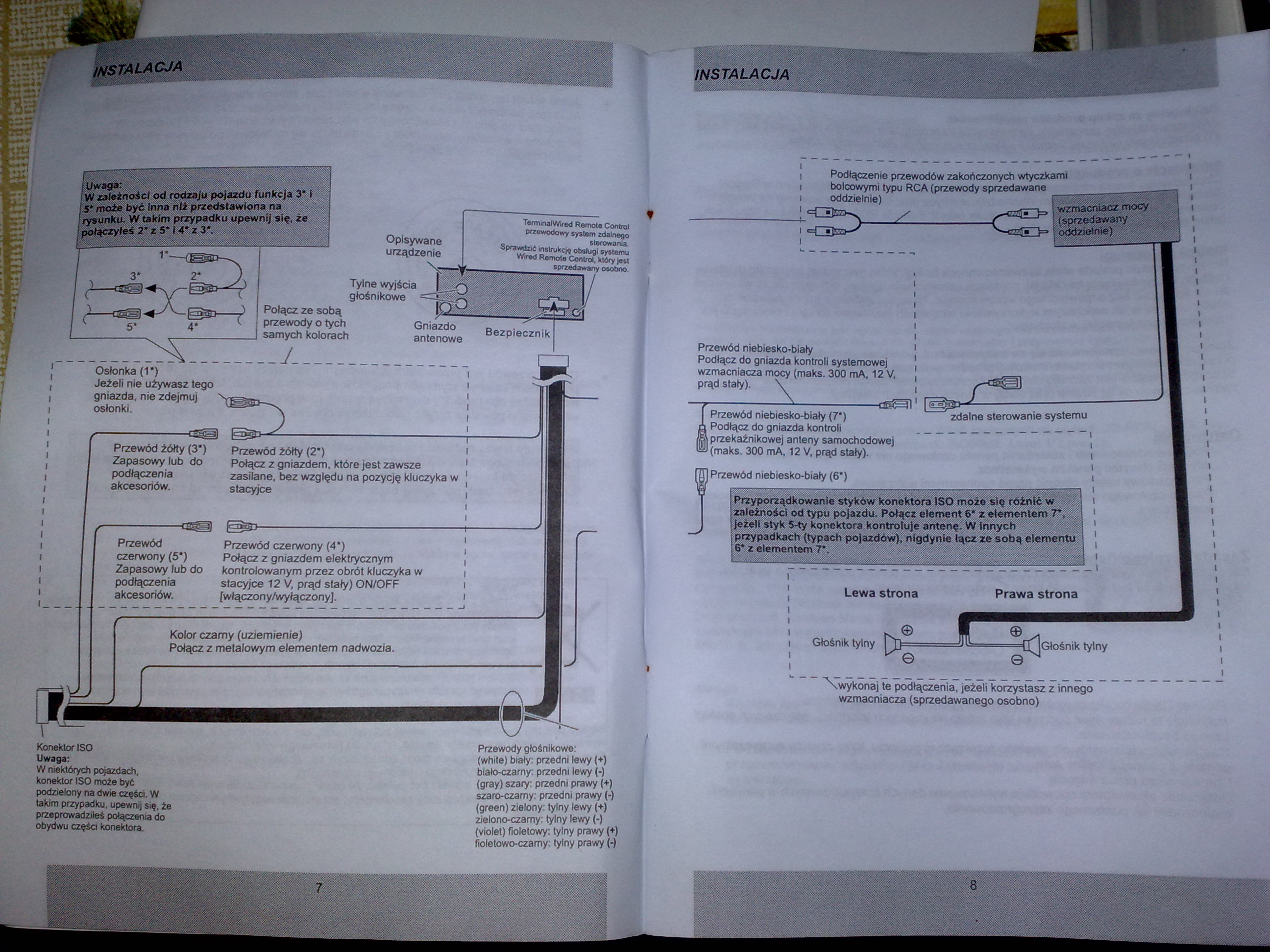

    In the manual (second picture), the plug on the radio (wired remote control terminal) is marked.
    Connecting the System Remote Control Cable to a Car Radio Properly
    So please tell me where to connect this cable because I don't know anymore ...

    Nowhere. This cable controls an automatic retractable antenna or amplifier.

    Unless you actually have an amplifier and / or auto antenna there.

    Rate: 5129
    After all, there is a blue / white cable dangling on the bone from the car side.

    In the first point of the manual, you have that if you do not need any cable, do not remove the cover. Blue cables are cables with no voltage. The voltage appears when the radio is turned on / 12 volt /, and this voltage controls something, it can be, for example, a relay for turning on the antenna. And the second cable / also blue / it is for sure to control the amplifier / it should also appear 12 volts when turning on the radio.

    Hello, I have the following problem, I do not know what cable to pull to the amplifier from my ankle, Is it the black (not mass) it goes from the antenna. ? My radio is Blaupunkt modena 148 and I want to exchange it for 4000UB pioneer, which has a chinch input.
    Brown is the mass
    the one above it is a permanent plus
    the second red is a plus after the ignition
    black goes from the antenna
    blue is probably the radio's backlight
    and the white one I have no idea.

    Description of the iso cube is on the net and here on the forum.
