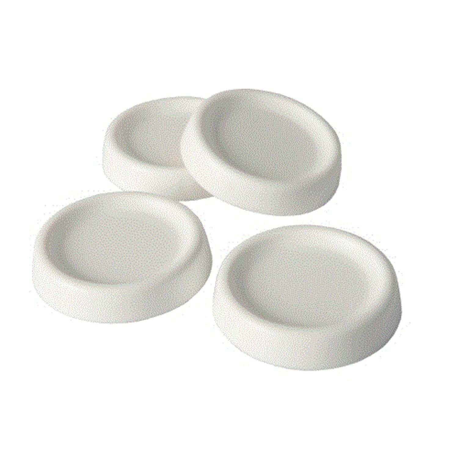

    Hello. I have a question. I have an LG washing machine and I want to buy a Bosch dryer. I want to put the dryer on the washing machine. Is there any application in fasteners? Looking for a connector for a washing machine or dryer? Thanks in advance for reply
  • #16 16960196
    mrhari
    Posts: 7981
    Help: 835
    Rate: 3239
    Such rubber pads are very good.

    Thanks, but are such rubber pads safe and will ensure the stability of the dryer on the washing machine? Where can you buy such washers?

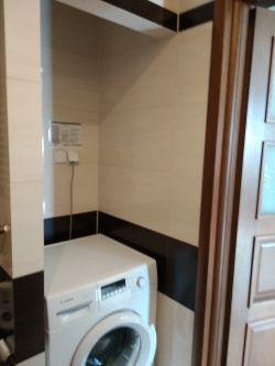

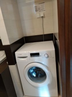

    And I have a question about the "installation of the dryer on the washing machine. My washing machine is in a recess in the bathroom (I inherited the solution from the previous owner). It is easy with the washing machine, because I just gently slide it into the recess on the floor. But is it possible to "slide" the dryer over the washing machine? Is the connector a better solution in this case? In the sense that you can put only the front legs of the dryer on it, and then somehow slide the dryer deeper into the washing machine?
    Thank you in advance for your help

    But I am not asking about it whether to use a connector / washers or not, but how to use them to put a dryer in the recess?
    If I put the rubber pads recommended here on the washing machine, how can I "hit" these discs if there is no access to the back of the washing machine? You can't physically put a dryer on a washing machine if you can't get there at all. It is impossible to hold a dryer weighing more than 50 kg by the front, lifting it and at the same time moving it over the washing machine worktop, because there is no way to stand next to this washing machine, as shown in the photo.
    In order to make my query more realistic and get reasonable hints, I will say that the store through which I want to assemble it cannot answer whether it is to be installed this way, because they do not have direct contact with assembling companies. They informed me that access to the assembly is on my side, so I am trying to make sure that I will pay for something that cannot be done or that someone from you has experience and can share them.
    What's the problem with that? You pull the washing machine out of the recess, insert the connector, the dryer on it, secure it and slide it into the recess. A 50 kilo dryer does not weigh, unless it is Miele. It goes to shift.

    The Bosch dryer is 52 kg, and the Bosch washing machine also weighs 38 kg. It is indeed an idea to move a 90kg set across the floor, but I wanted to make sure it is possible at all. I have trouble moving the washing machine now, so I was curious if anyone on the forum had this type of experience.
