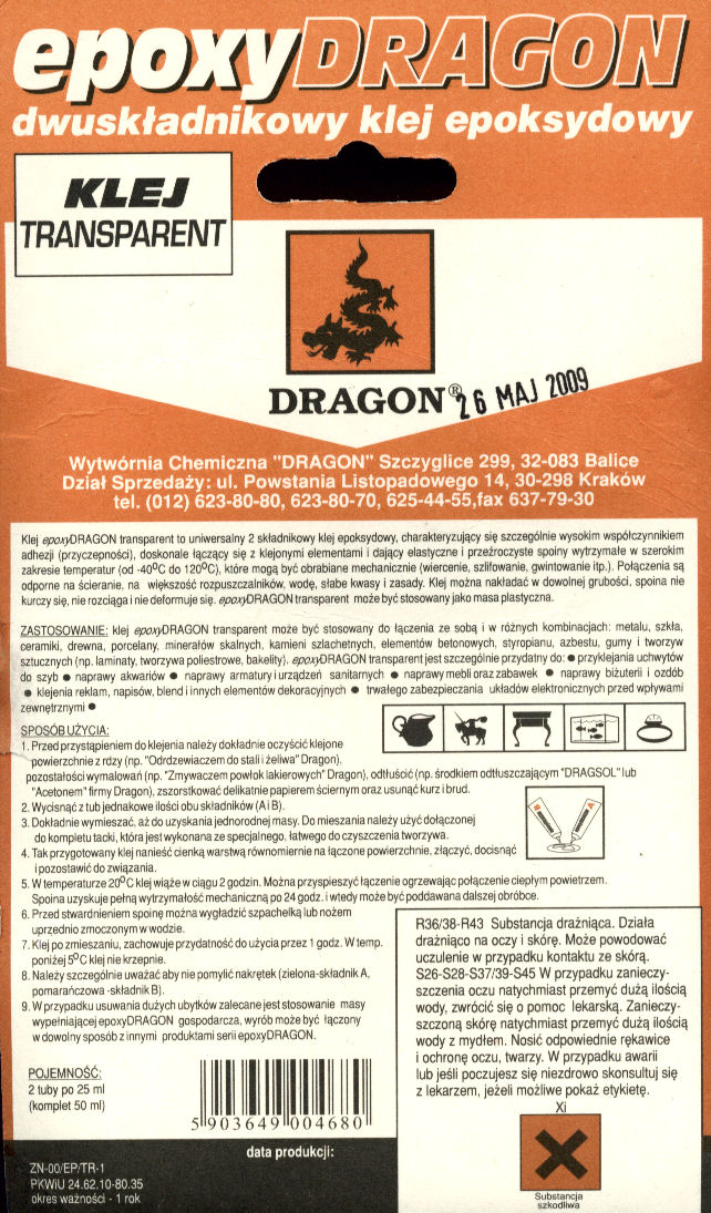

    I have a question what glue this water tank - because I have a very nice crack
    and the warranty for this product has expired.
    Or does anyone know where and for how much (what price) will I get such a replacement?

    do not glue it with any silicone because then no glue will catch and the silicone will not be strong enough. I think it is best to use epoxy resins with a PAC hardener (similar to resin and not to feel it with ammonia or socks :) ), such small packages - 2 tubes of almost the same size are probably produced by the dragon company - one of the cheaper ones.
    The PAC cured epoxy resin is also minimally flexible and has very good adhesion to ceramics.

    kazaaski wrote:
    I also recommend Dragon. Inexpensive (about PLN 8) and after drying it is incredibly hard and durable. Let other (especially American) inventions hide with him.
    I do not advise droplets. As far as I'm not mistaken, it's something like Cyanopan. This glue sets quickly and holds well, but after about a year from sticking, the joint breaks loose.

    Look for DRAGON or DISTAL epoxy adhesive. You can get them at any paint or building materials store. Both adhesives are two-component. Colors to choose from.
