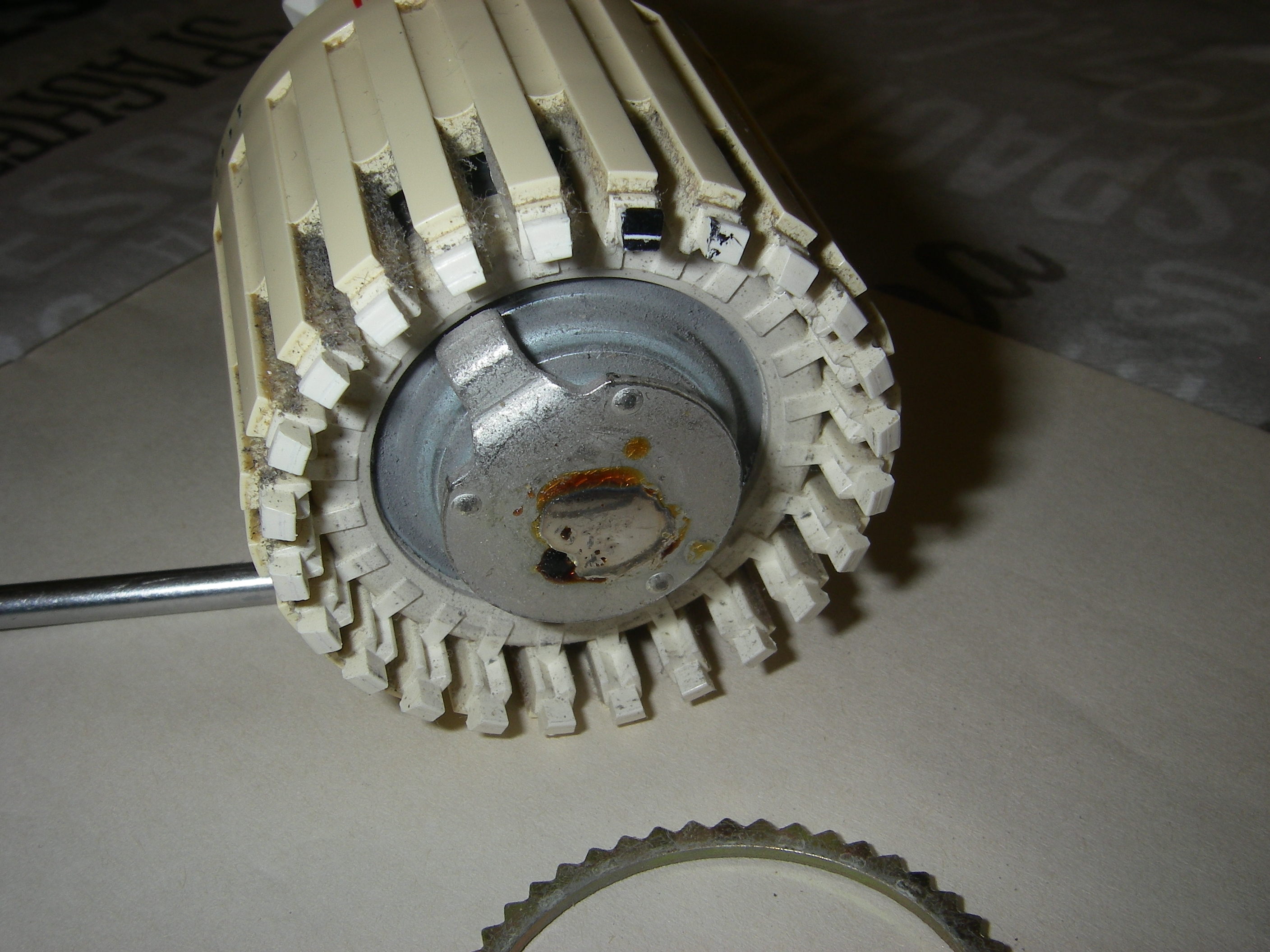

    I have these valves installed on my radiators at home
    Danfoss Thermostatic Radiator Valve Head: Hard to Turn, Disassembly, Cleaning & Lubrication Tips
    with such a thermostat
    Danfoss Thermostatic Radiator Valve Head: Hard to Turn, Disassembly, Cleaning & Lubrication Tips Danfoss Thermostatic Radiator Valve Head: Hard to Turn, Disassembly, Cleaning & Lubrication Tips
    The thermostat generally functions correctly, but the dial turns very hard. The resistance is so great that when turning the thermostat to "heat" it causes the valve to wrench out of the radiator. The appliance has been in service for several years so I thought maybe something was fouled in there. So I have a question: is it possible (and does it make sense) to dismantle the thermostat somehow, clean it and maybe lubricate it? If so, is it possible to get some kind of instruction (overview picture) on how to take it apart? Or do you have to buy a new thermostat after all?

    I have it too. I was able to undress it (it is technically possible without damaging the structure, but it must be carefully folded), cleaned (WD-40) and greased with silicone grease. To be able to disassemble, you need to remove these gears limiting rotation and fixing the point max. and min. (to be able to completely unscrew the sensor from the knob).

    I disassembled the head according to the drawing in the user manual. The inner thread of the plastic knob works with the aluminum head thread and there is friction. I applied some silicone-Teflon Naskosil grease to the thread and the head turns clearly lighter. Whether it will be a lasting effect, time will tell.

    I managed to remove the cover with my fingers, without using any tools. It is important not to change the toothed ring settings, because we will introduce temperature limits. The cutout in both rings should be under the red spot.
    Edition 4.12.2018 (after closing the topic)
    However, after a few months I found that the head could rotate even lighter and lubricated both points marked in the picture. The head could be rotated so lightly that it partially returned to its initial position. I had to wipe some grease off the left part of the picture. A compromise had to be found between turning slightly and keeping the set position firmly.

    In the end I gathered and dismantled this head. The mechanism is very crude, and it is not surprising that it works with resistance. I greased the thread with Silicon + PTFE grease (I had one) and it is easier, but I'm not entirely satisfied. I think that I will gradually replace thermostats for better ones. Below photos from disassembly:

    The thermostat lay on the shelf for a few days, I moved it yesterday and I was surprised how light it turns. I don't know if this grease has "matured" or what. It doesn't matter, it's okay now.
