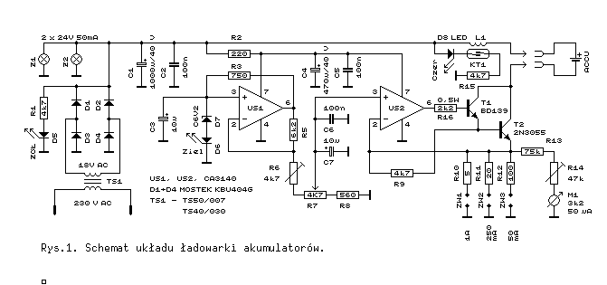

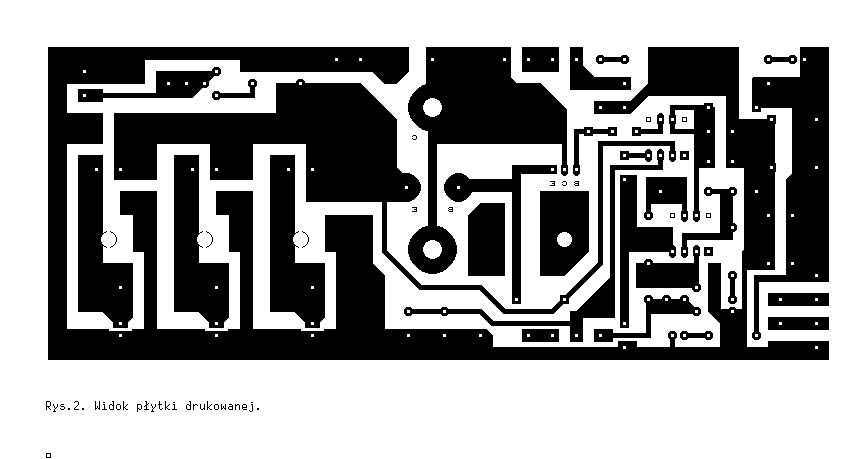

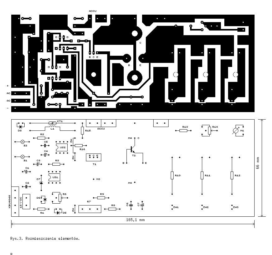

  • #7 740093
    kaczorek_wow
    Posts: 26
    I have a handy schematic ...
    If I make such a charger, does the usual battery charge me - a finger?
    There is 4 file
    • Stałoprądowa ładowarka akumulatorów NiCd i NiMH.doc (40.5 KB) You must be logged in to download this attachment.
    • Accu3.jpg (89.64 KB) You must be logged in to download this attachment.
    • Accu2.jpg (48.47 KB) You must be logged in to download this attachment.
    • Accu1.jpg (25.9 KB) You must be logged in to download this attachment.
  • #8 741127
    _jta_
    Electronics specialist
    Posts: 48935
    Help: 3203
    Rate: 4217
    If I make such a charger, does an ordinary battery charge me - a finger?
    To my knowledge - and I have quite a lot - it is useful for destroying batteries.
    The diagram is made in a bun - the author believes he has made a precise voltage source
    reference, and it will really float. Really precise sources with a diode
    The zener used a buried diode and temperature stabilization, but this is dated
    technology - currently, thermally compensated transistor circuits are used.
    But the more serious issue is how the batteries should be charged. I recommend reading
    my study on this subject http://www.fuw.edu.pl/~jt/akumulatorki.html - today
    I would probably write better, because I know more, but I don't have enough time.
    Two very important things:
    1) the battery should not be charged with direct current;
    2) the battery must not be overcharged.
    And the given chip does both, which is why it's a battery shredder.
    (1) this applies even more to disposable cells and rechargeable batteries with an electrode
    zinc - it has not been possible to develop such a construction of batteries that the electrode
    "dendrites" causing the short-circuit of the electrodes did not grow, they grow slowly
    with AC charging, and really fast with DC. The batteries are
    they are more resistant to it than disposable cells, especially when they have electrodes from others
    materials, but the short circuit of the electrodes is one of the most important types of their failure.
    (2) as far as I remember it effectively destroys the manganese-zinc batteries they have
    the same chemistry as an alkaline cell, so probably disposable cells too.
    Special, precise chargers are used for manganese-zinc batteries;
    do not count on the fact that any charger made will charge them correctly;
    similarly, any charger cannot charge disposable cells.
