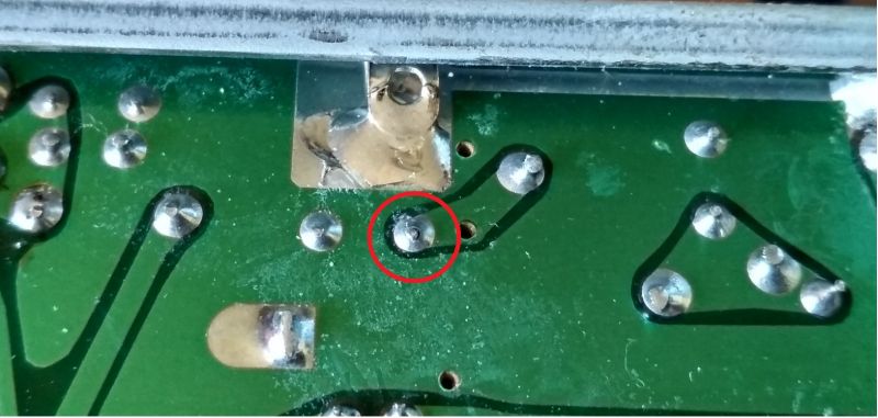

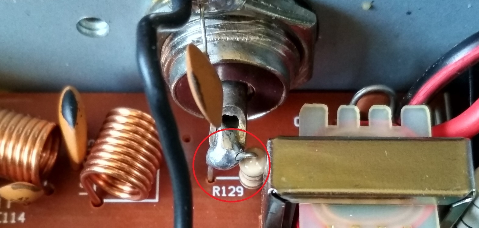

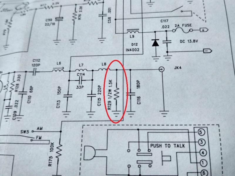

  • #10 17209118
    tomekdm
    On the example of the CB radio - Alan 100 plus fault, I will show what cold February looks like and what may be the cause of their formation.
    The failure manifested itself once in a quiet - once in a loud (normal) radio operation. Light blows against the casing brought a temporary improvement.
    The reason was the cold (huffed) February of the R129 resistor right at the antenna output.
    How to recognize cold February
    It also turned out that the antenna socket has some play - a slight left-right rotation of the socket was possible and this was most likely the cause of the defect. In addition to repairing the brazed joint, I fixed the socket thread with cyanoacrylate glue.
    Regards
