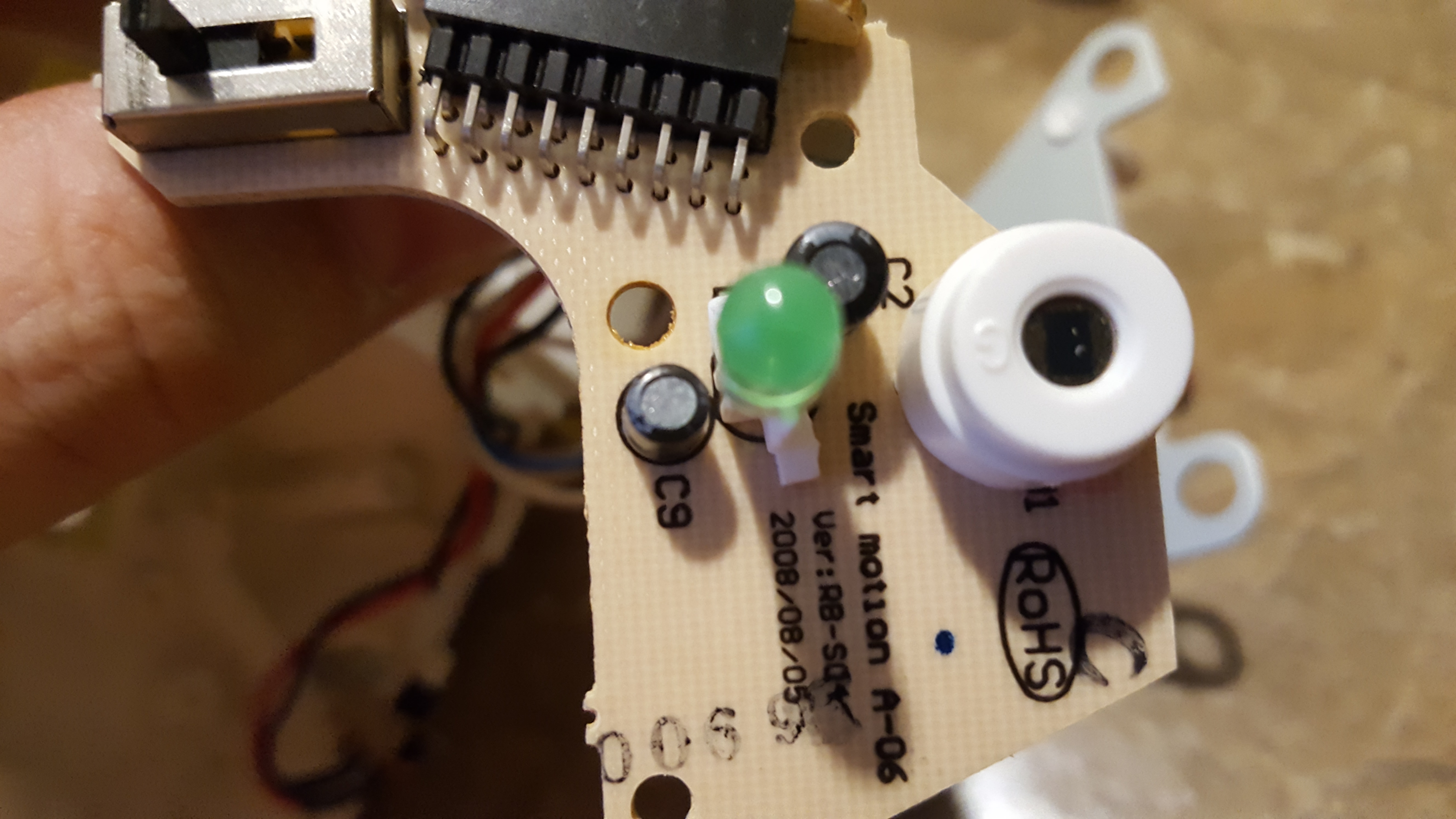

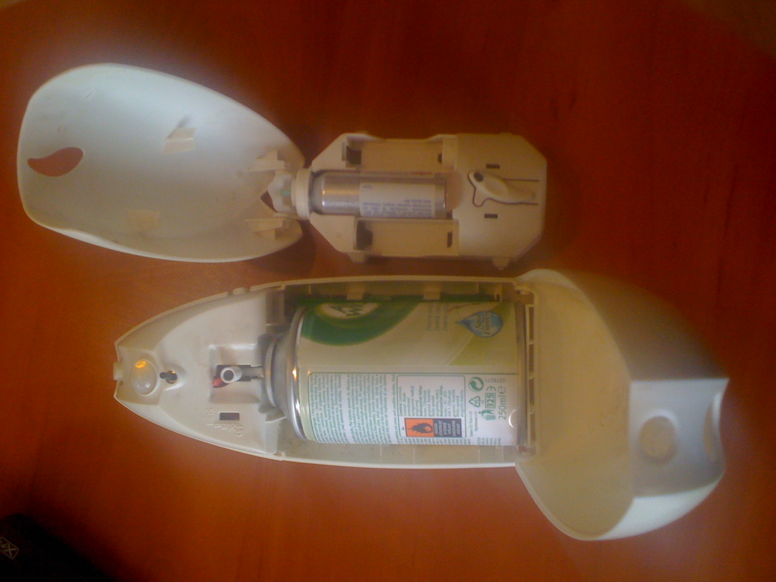

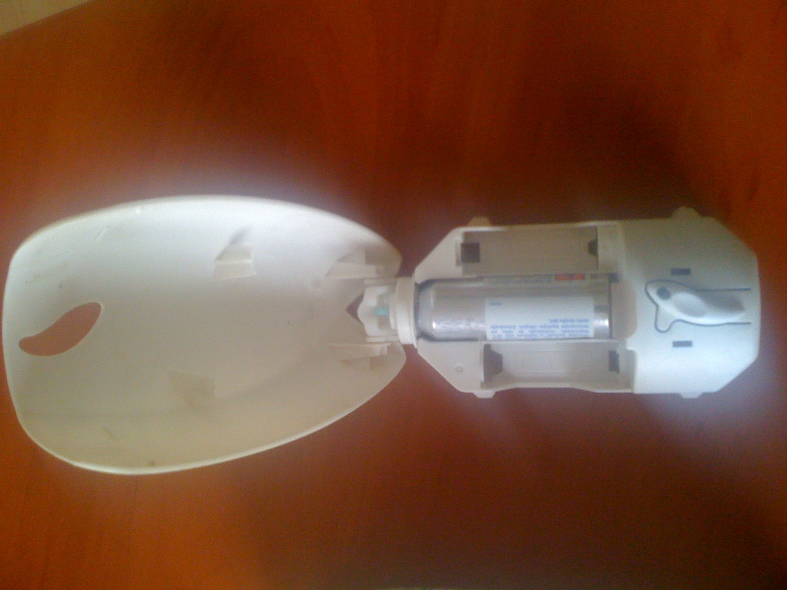

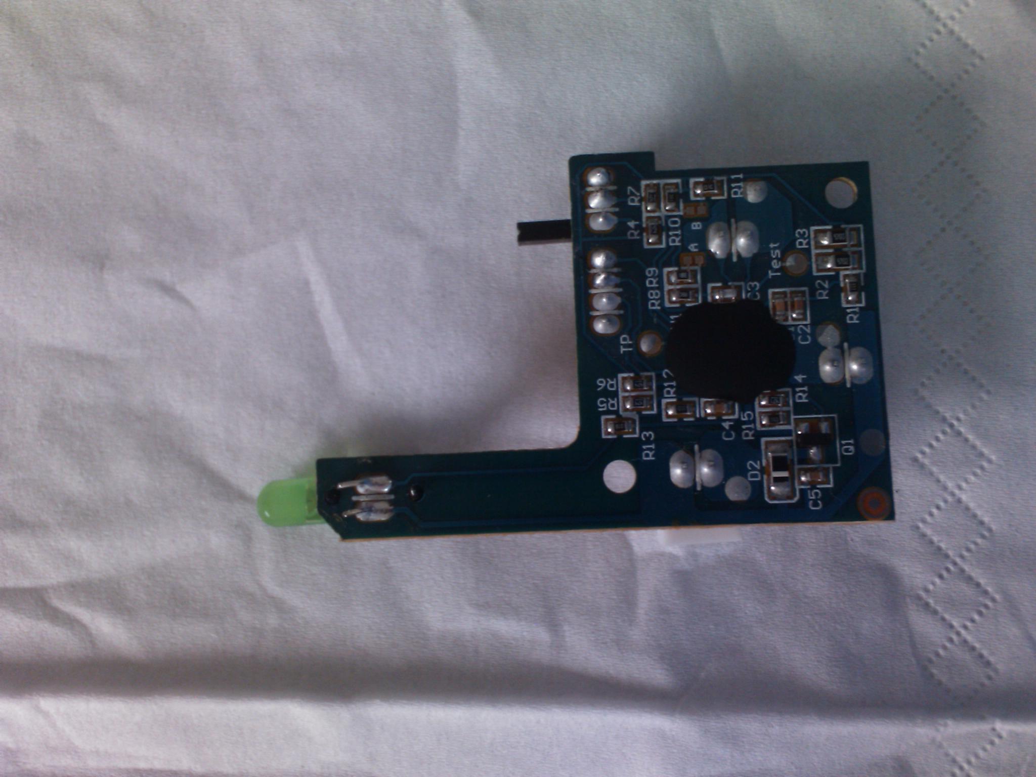

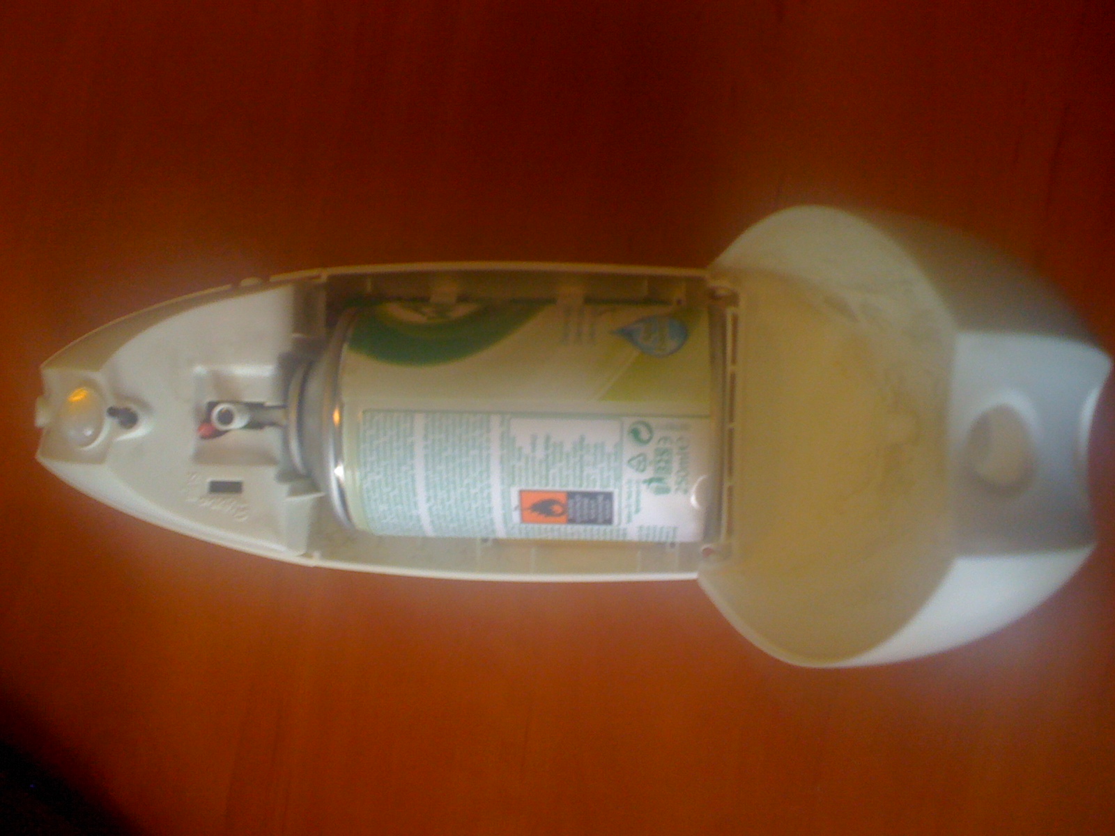

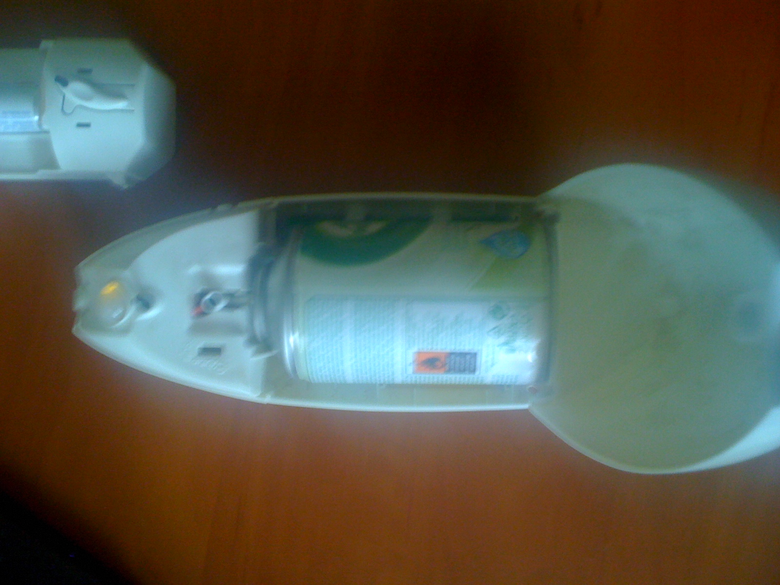

    Have any of you tried to extend the time between sprays on this device?
    The longest period for me is 36 minutes.
    I have a small and rarely visited bathroom where pissing every 36 minutes is way too often.
    When I disassemble the device, I will throw a photo of it from inside.

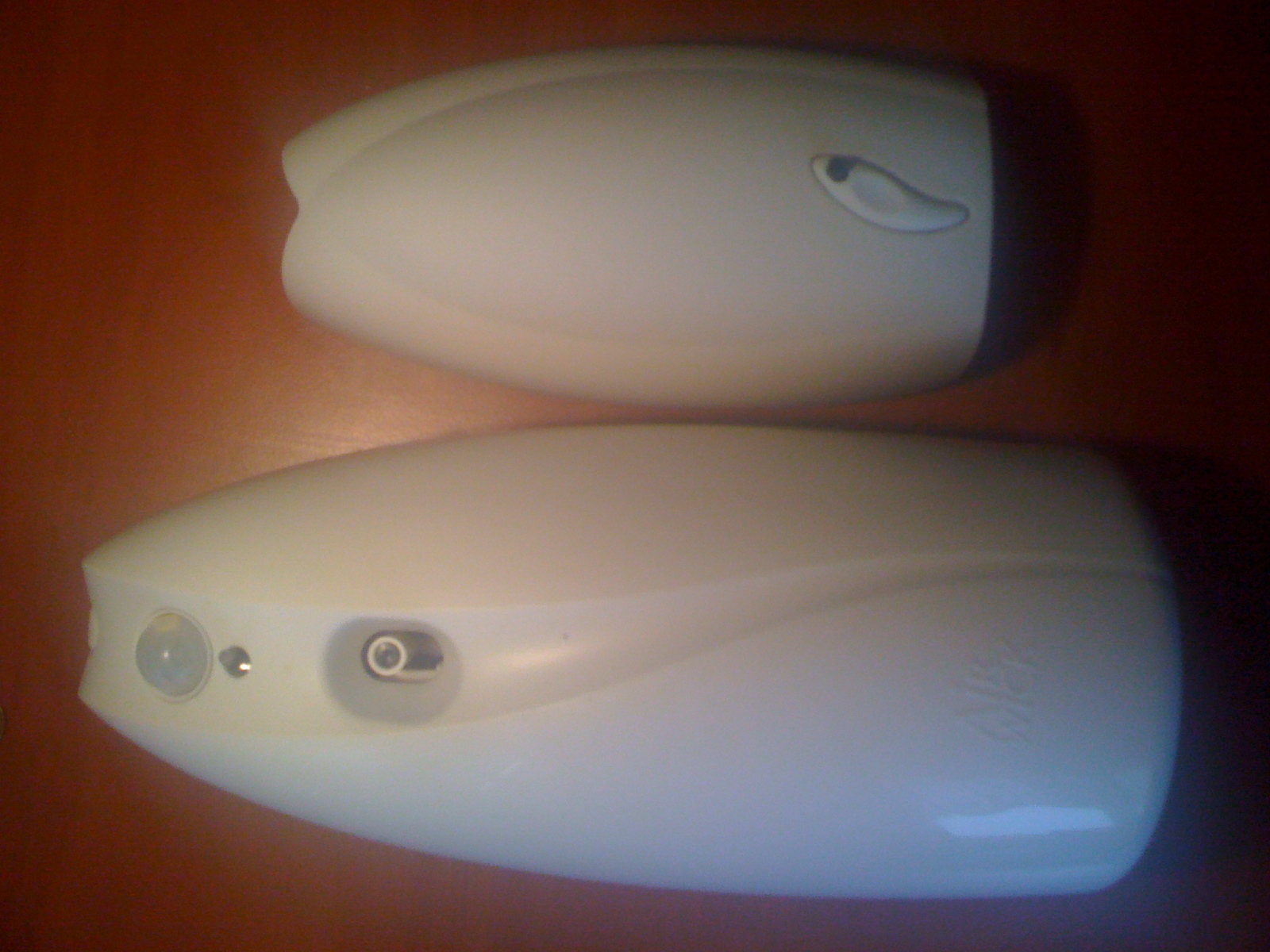

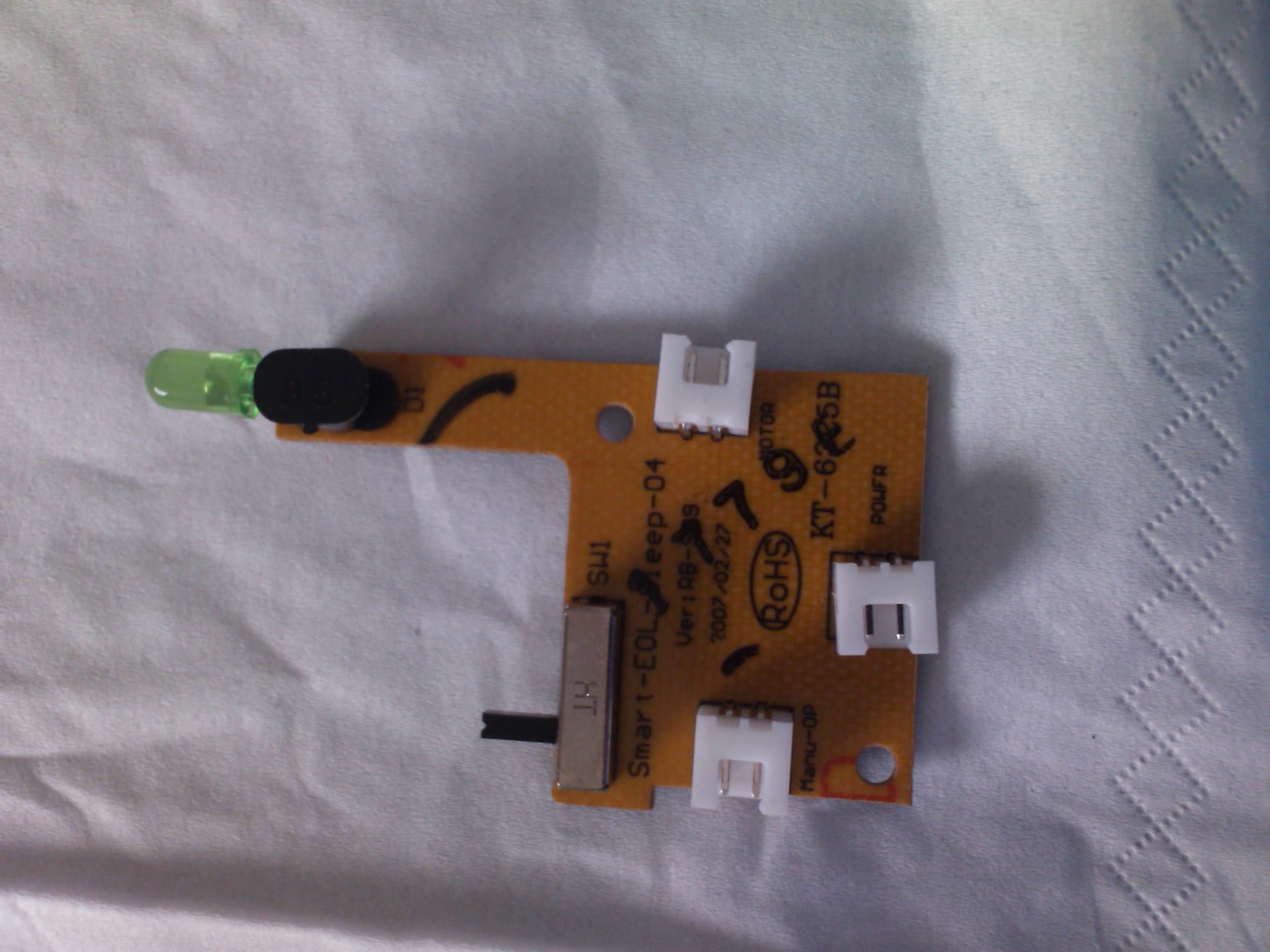

    My electronics are different, because there is no motion sensor. There is a button for that.
    But in fact, disconnecting the time trial would also satisfy me to some extent :)
    There are only resistors from the switch to the prock - the same. So the time is probably sewn into the program.

    The problem is that all resistors are of the same value. These are probably separate Prock legs.
    Tomorrow I will try to upload photos of better quality.

    I have an AirWick FreshMatic without a motion sensor. I allow myself to paste photos of my friend groovee (I have exactly the same model).
    How to extend Air Wick Freshmatic spray interval beyond 36 min? How to extend Air Wick Freshmatic spray interval beyond 36 min? How to extend Air Wick Freshmatic spray interval beyond 36 min?
    So...

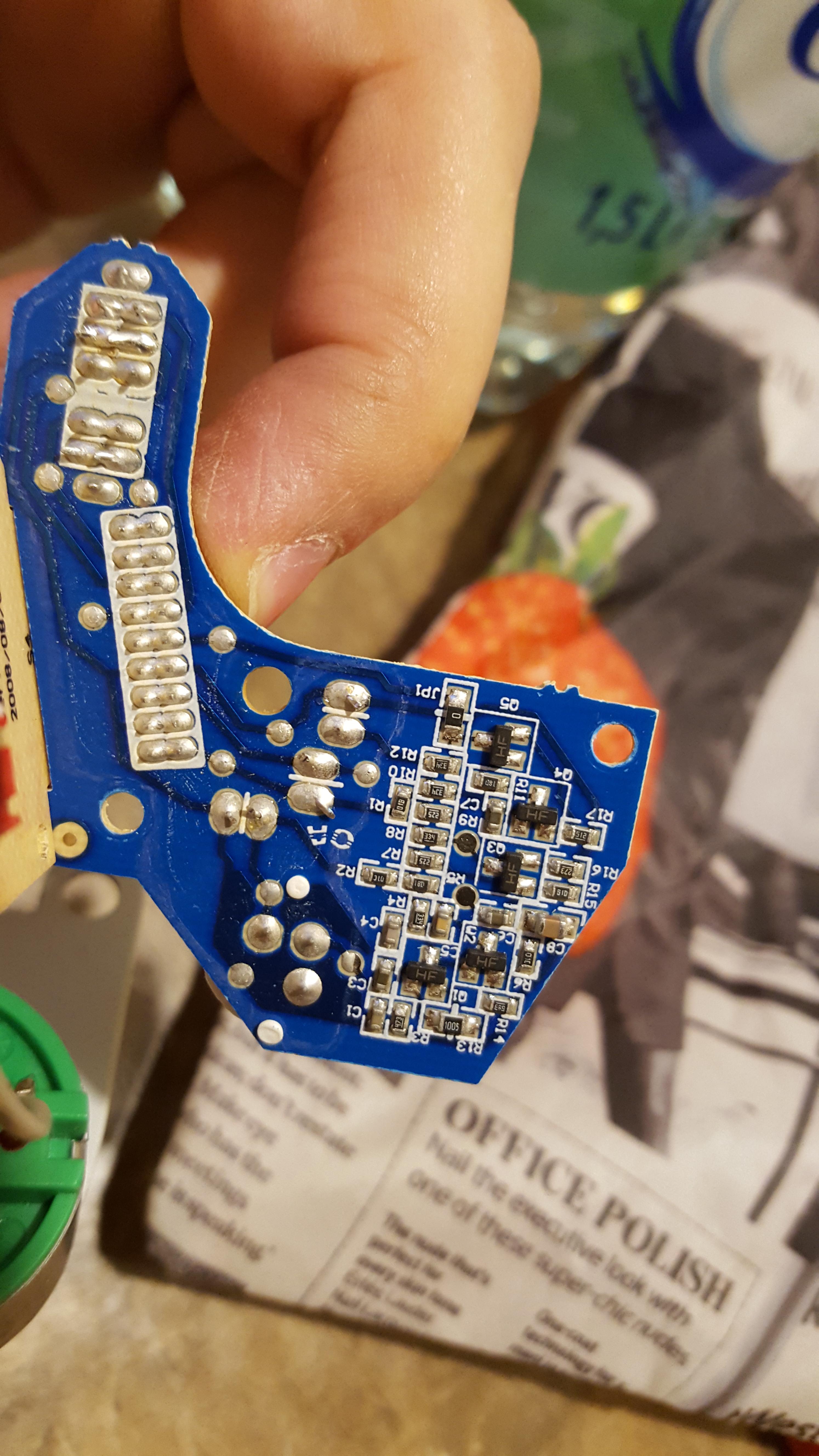

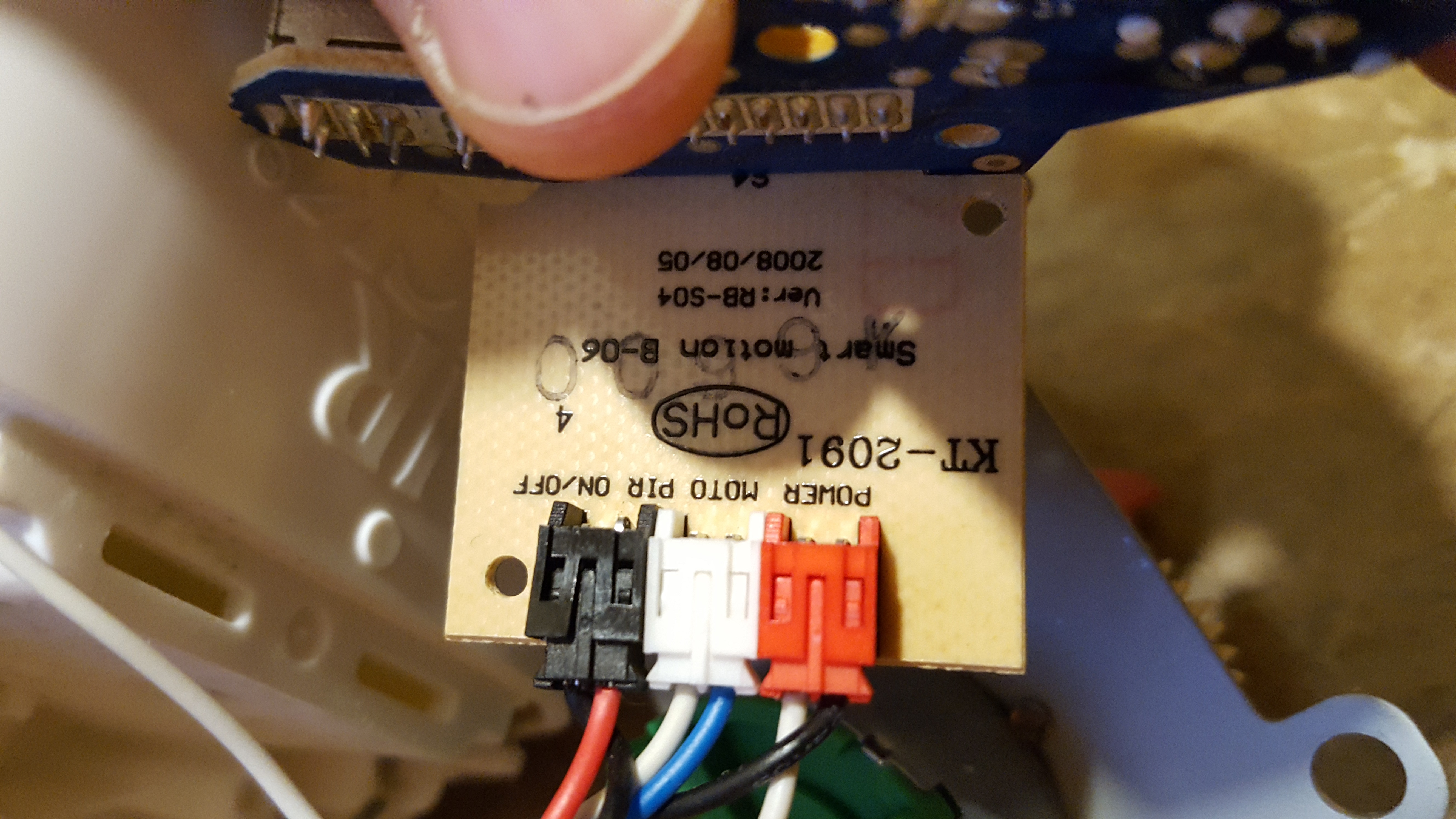

    The method is very simple, unfortunately it requires financial expenses if someone does not have an old air freshener without a timer. Just swap the tiles in these air fresheners and throw the timer out of the AIR WICK air freshener to make both fresheners work. I used a SC JOHNSON & SON, INC air freshener for this replacement. MODEL: 7Q1841 with motion sensor and timer that activates the system 30 minutes after a piss. It looks like this that after each spray, the system waits for half an hour and during this time it does not affect the detected movement, which gives savings such that the AIR WICK container which, when set for the longest time, i.e. 30 minutes, worked for me about a month while standing in the toilet now lasts for 7-8 months with two residents at home. On the AIR WICK PCB, you should skip the timer by inserting a micro button in its place. The micro switch should be inserted into the hole after the motion sensor in the SC JOHNSON & SON, INC. Housing. MODEL: 7Q1841 and we will have a freshener that will work only after pressing the button, which in the case of such a small applicator in this model is also an advantage. However, in the AIR WICK Frash Matic air freshener, a system from SC JOHNSON & SON, INC. Should be attached to the motor. MODEL: 7Q1841, replace the micro switch with a longer one and put it in the place after the diode, and put the motion sensor and the diode in and fix it in the place after the motion sensor. In this way, we get the AIR WICK FRASH MATIC air freshener with a motion sensor and a button for dispensing the contents of the container at the desired moment. I used hot glue from a gun for fixing, but everyone can attach it in their own way.
    How to extend Air Wick Freshmatic spray interval beyond 36 min? How to extend Air Wick Freshmatic spray interval beyond 36 min? How to extend Air Wick Freshmatic spray interval beyond 36 min? How to extend Air Wick Freshmatic spray interval beyond 36 min? How to extend Air Wick Freshmatic spray interval beyond 36 min? How to extend Air Wick Freshmatic spray interval beyond 36 min? How to extend Air Wick Freshmatic spray interval beyond 36 min? How to extend Air Wick Freshmatic spray interval beyond 36 min?
    Regards [/ img]
    At the request of a colleague Lorkovsky, I am adding photos of the board connection from the freshener SC JOHNSON & SON, INC. MODEL: 7Q1841 in AIR WICK freshener

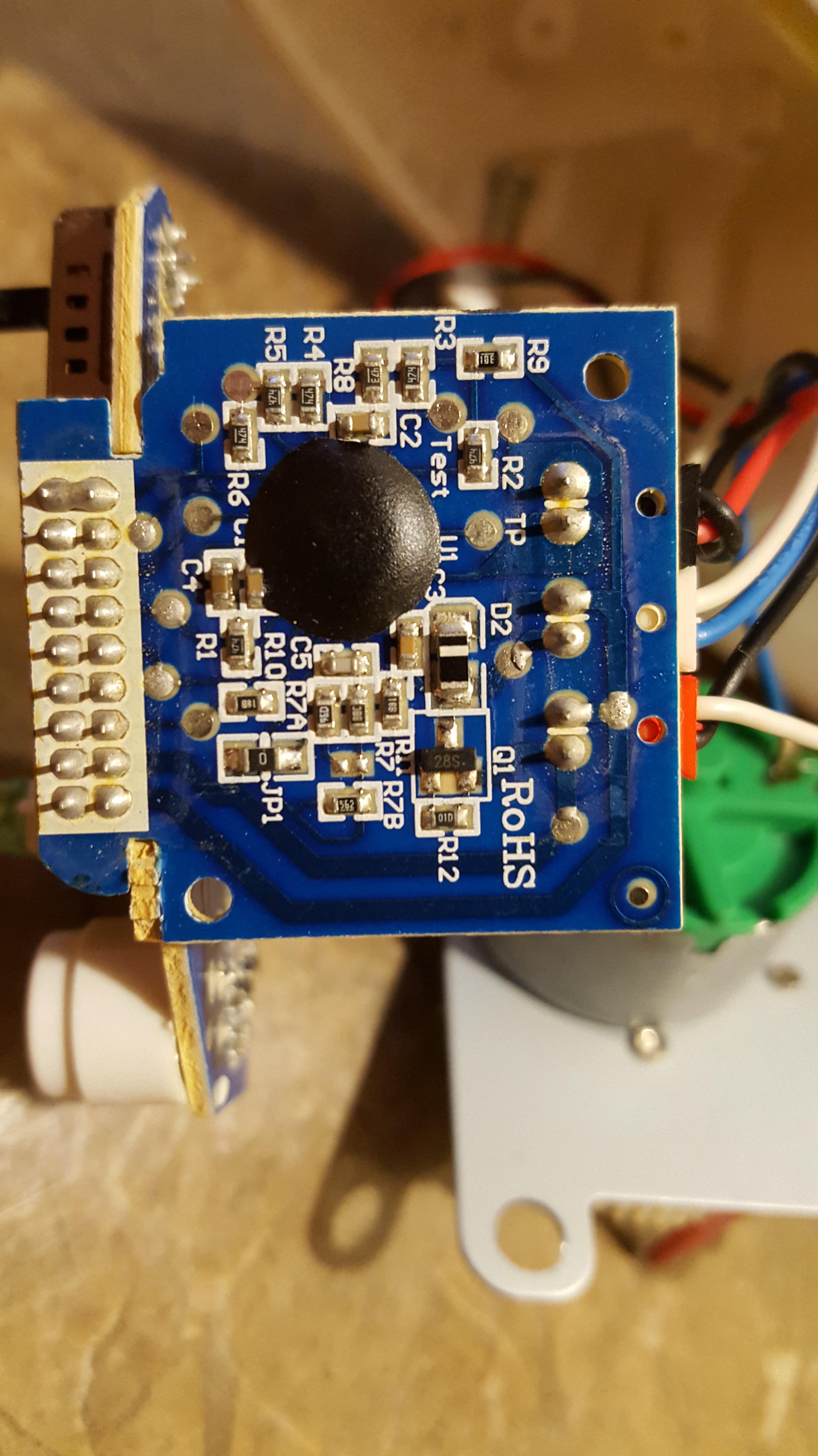

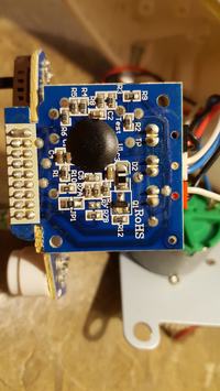

    Hello colleagues interested in the subject.
    After a couple of hours of scouting the AIR VICK's fault-time switch, I found the states to be the next number in the binary code.
    In my case of the AIR VICK version, the feet of the switch 1, 2, 3 are used, I marked them on the attached photo.
    This switch positions are linked before processing:
    1 - completely exclusive
    2 - first time - every 36 minutes - controlled by feet 1 and 2
    3 - second time - every 18 minutes - controlled by a foot 3
    4 - third time - every 9 minutes - controlled by feet 1, 2, 3
    After the analysis, you can see that it does not control itself, foot 1 and 2 as the longest times between runs.
    To obtain the longest time between failures, it uses foot 1 for position 1 of the switch, resigning from turning it off completely, making an appropriate bridge on the circuit board.
    I tested the system and so far everything works fine.
    I think nothing will change, but by reading earlier descriptions there are different versions of the board.
    A photo of how it came out in my version of AIR VICK is attached.
    The conversion was very simple, soldering a small bridge on the switch - I marked this connection - point 4 of 1.
    I am asking for any comments on how another colleague came out.

    What struck me ... is the noise that this device generates.
    It will not be possible to sleep at the same time ...
    I would like to ask for some tips on how to turn it off automatically, say from 22.00 to 6.00; D
    I would like to extend these times too, 36 minutes is too often - the smell is very intense.
    Here is what I bought ;)
