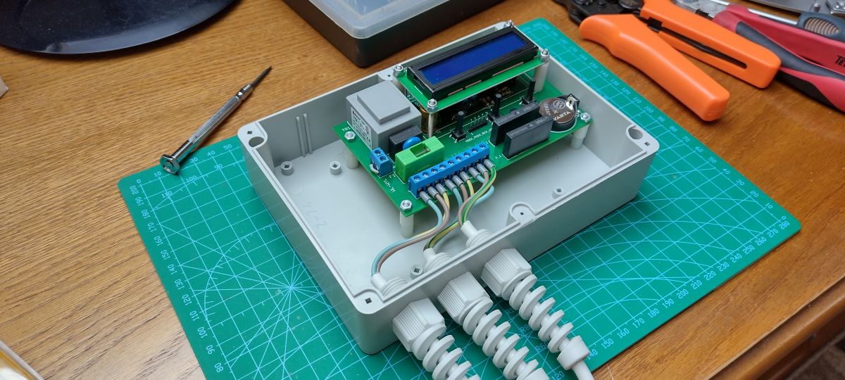

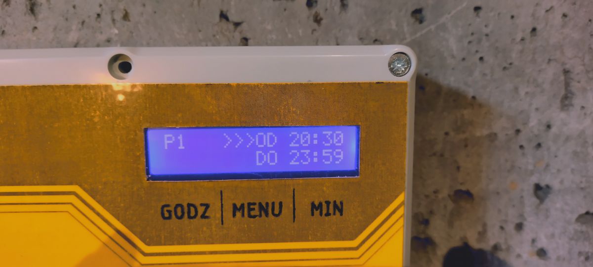

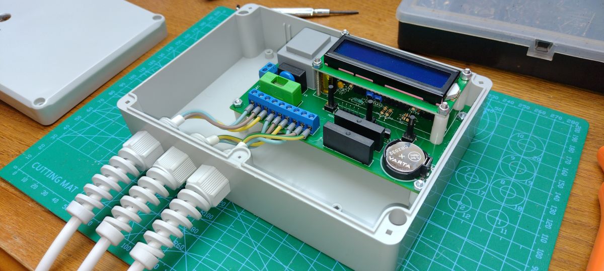

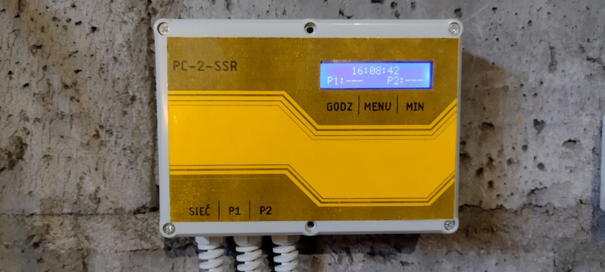

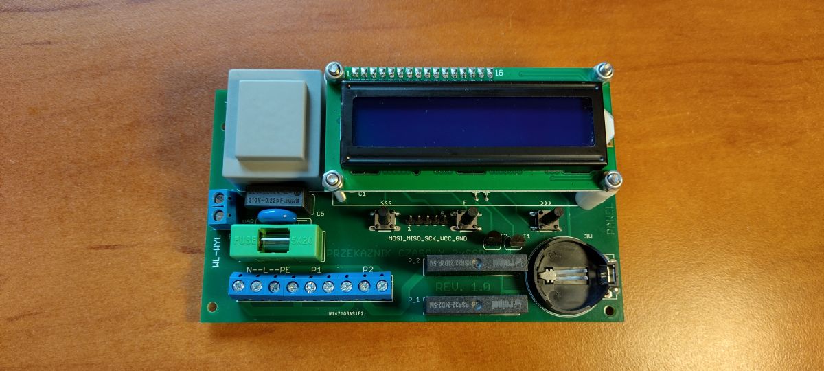

    after a Chinese timer failed (flooded with water), I decided to construct my own two-channel one. The programmer is to operate the circulation pump and the lighting in front of the building. I opted for solid-state relays because of their 'eternity' and silent operation. The rest is classic with an Atmega 328 and a DS1307 chip with battery backup.
    The software was developed in Arduino, features include:
    - two independently programmable output channels
    - PWM-controlled screen saver
    - clear and simple menu
    - settings saved to EPROM as required
    Problems with the printer and limited time did not allow me to refine the label in the area of, shall we say, aesthetics. Another thing is that a boiler room is not an industrial design exhibition. I leave it to the viewers to judge the viability of this type of design in these times of ubiquitous Chinese products.

    A beautiful classic and will go on forever. No need to update, no internet connection. It will simply do its job!

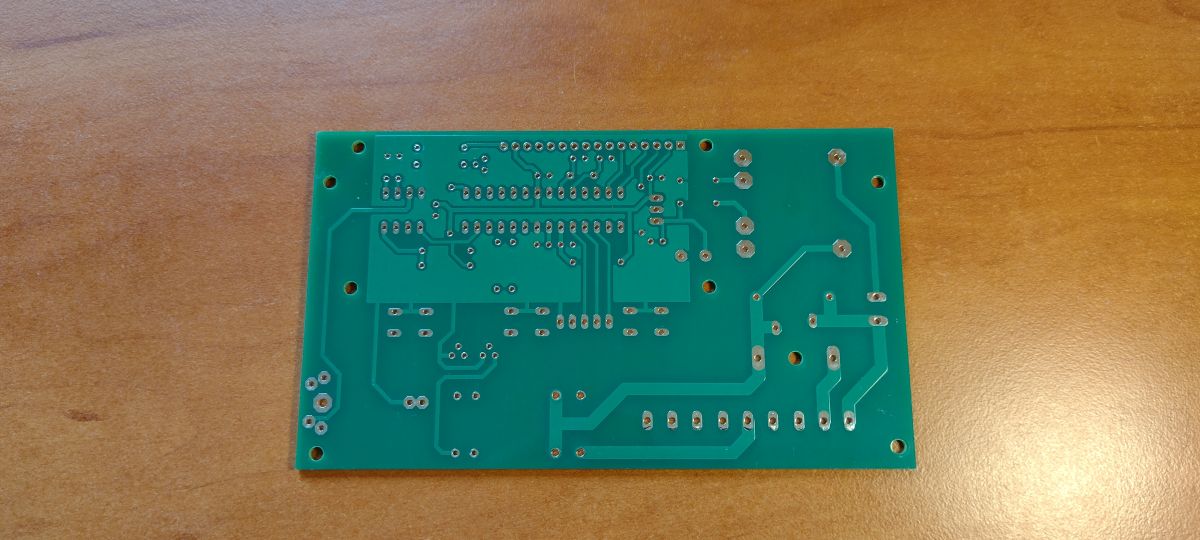

    Congratulations, and who made the board for you?
    You fit everything in nicely.
    Write me a Parcel Post please and I'll send a small gift.

    Cool, aesthetically pleasing, classic as MasterAdmin Gulson put it :) .
    Now the question: what about the clock divergence?
    Have you used an astronomical clock algorithm so that the lights switch on with sunset?
    Greetings
    Piotr
  • #4 21208760
    PadX
    Posts: 15
    Rate: 38
    The board was made by PCBWay. No, I didn't use anything like the astronomical clock algorithm. It's a boiler room clock, I decided not to worry about accuracy.

    You are wasting energy. The way I do it is that I have a temperature sensor 1m from the buffer. When the sensor detects a temperature rise (probably 5stC in 30sec) it starts the pump. The pump is therefore always switched on when the water is turned off, if it is cooled down in the pipes. That is, in the morning after the tap is first turned off. The 60W pump pushes the water through in about 5-10s. At night and during the day it does not switch on and the water in the pipes is cool (no energy loss).

    Very nice design. Can you make the schematic available? Don't worry about the delay function 😉.
