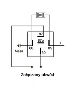

How should I wire a 5-pin relay and button so it actually cuts the car circuit instead of leaving the bulb on all the time?
With a normal 5-pin relay, 85/86 are only the coil, and 30 is switched between 87a and 87: with no power on 85/86, 30 is connected to 87a; when the coil is powered, 30 switches to 87. To use it as a cut-off, you must break the wire you want to interrupt and route that wire through 30 and 87a or 30 and 87, depending on whether the circuit should be closed by default or when energized [#16769140][#20158951] A momentary pushbutton by itself will not latch a standard relay, so if you want one press to toggle the pump/ignition on and off, you need a bistable/impulse relay or an ON/OFF latch type relay, not an ordinary car relay [#16769406][#16769538] The coil should be driven from the button/ignition side, and a fuse of about 5A–7.5A is suggested on the + feed to 85/86 [#16769219] If you add a flyback diode across the coil, connect its cathode to + and its anode to - [#20161884][#20162079]

    I have a 5-pin relay as in the picture + a button. I want to cut myself off in the car, but I wanted to do a test run first. I connected the button to pins 85 and 86, pin 30 led to the battery to +, 87a to + in the bulb, and from the bulb - to - on the battery. Unfortunately it does not work. The light bulb stays on all the time. How to connect it properly?

    The button is as I see further under 85.86, or as a cutoff? Or otherwise? I have something like in the picture and how to connect it?

    What do you want to cut off? You connect the fuel pump, ignition, etc. to 30 and 87-87a depending on the configuration. So you take a break on the cable you want to cut off and connect to these pins. I don't know what your ideas are, this is one of them. these pins act as if you cut the wire and combined action- combined action doesn't work. 85-86 are the pins from the coil that must have power to change the position of the pins between 87-87a

    I thought that if, for example, I want to make a cut-off on the pump, it is a plus, I plug the cut-off cable under 30 and, for example, 87a, and under 85.86 I connect the button and play. But it's not as simple as I thought

    Now everything is clear. On the "scheme" it is already cut - and can I cut + and connect it the same way? Will it work differently?

    You can ground minus most of it is on the bodywork.

    Set the relay to "pull" when the motor is running
    The reason for this.
    - battery saving
    -security is at rest when there is no one in the car.
    - a fuse in the power circuit would also be needed.

    kamilo1409 wrote:
    And as for the fuse, where in the diagram is it best to put it and how durable?
    On the plus side going to pin 85 or 86, i.e. to the coil, the size of 5A-7.5A is enough.
    And don't put the switch under the gear shift bellows because it's the most popular place. :D
    Solder all connections and check after making if anything heats up or melts.

    Yes, I am looking for schematics and here is a one-way diode still used? Does she matter?
    The diode is connected in parallel to the relay coil so that breaking the connection does not generate high voltages on the coil. This is especially important if the coil is controlled by a transistor - it can burn out if there is no diode. But also when controlling the button without the diode, the button contacts burn out faster.
    Will the button in the picture be on pins 2 and 3 of the transistor, and pin 86 of the relay connected to pin 1 of the transistor?
    Do not use the terms pin 1/2/3, only emitter/base/collector - someone will look at another catalog note and there may be a different numbering, and besides, the terms are illegible without information about the adopted pin numbering; in this note pin 1 is base, 2 is collector, 3 is emitter.
    Pin 86 of the relay is connected to the +battery - definitely do not connect the base of the NPN transistor to the +supply. But I don't know how to connect it, because you didn't write what you want to achieve, what role this transistor should play, how it should be connected to the microcontroller/555.

    If the circuit 86 85 is open, the relay does not give current at all to either 87 or 87a, and if it is closed, it gives both 87 and 87a?
    Is it simply depending on whether the circuit 86 85 is open or closed, the relay gives current either to 87 or to 87a?
    Yes. Without power to coil (85 86) 30 is shorted to 87a. When applied, power 30 shorts to 87.
    Hello, taking the opportunity that such a topic was created, I will ask, that is, in any case, regardless of how we use such a relay, whether it's to start some additional halogens, or to cut off the pump, starter or ignition, or everything at once on several relays, then on each relay, such a diode is indicated on the power supply (I understand that rectifying or indifferent) connected with the cathode always to plus, and the anode to minus (as in the picture?) And it will not do any harm, on the contrary, it will be beneficial for the relay?
    5-Pin Relay Connection Guide: Car Cut-Off Test, Button Setup, Pins 85, 86, 30, 87a, Bulb Wiring
    By the way, I will ask again, it is indifferent whether we give + 85 or 86 to the coil?

    kp. wrote:
    will it be beneficial for the relay?
    It's not about the benefit for the relay, but about the benefit for the power source.
    Due to the inductance of the coil and the sudden power failure, a very high voltage (opposite to the supply voltage) will appear across the coil.
    kp. wrote:
    it is indifferent whether we put + on the output 85 or 86 on the coil?
    It is not indifferent in the case of the mounted diode, which, as a colleague mentioned - must always be connected in the same way.
